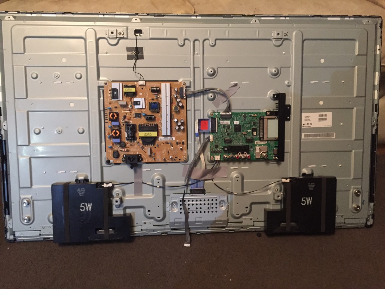

Standby light only LG LG42LB5500
  • StephenU
    • Dec 2013
    • 230
    • United Kingdom

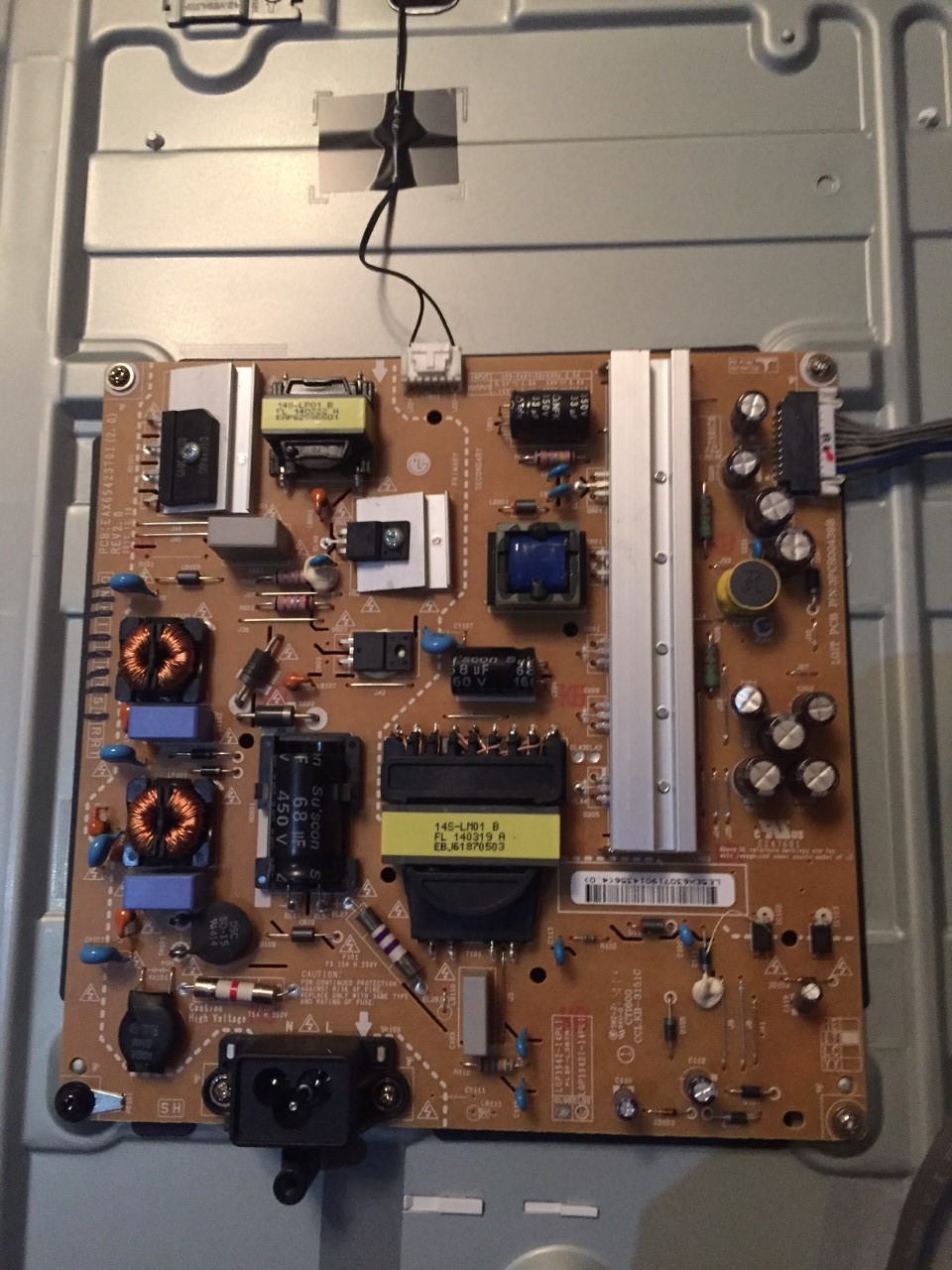

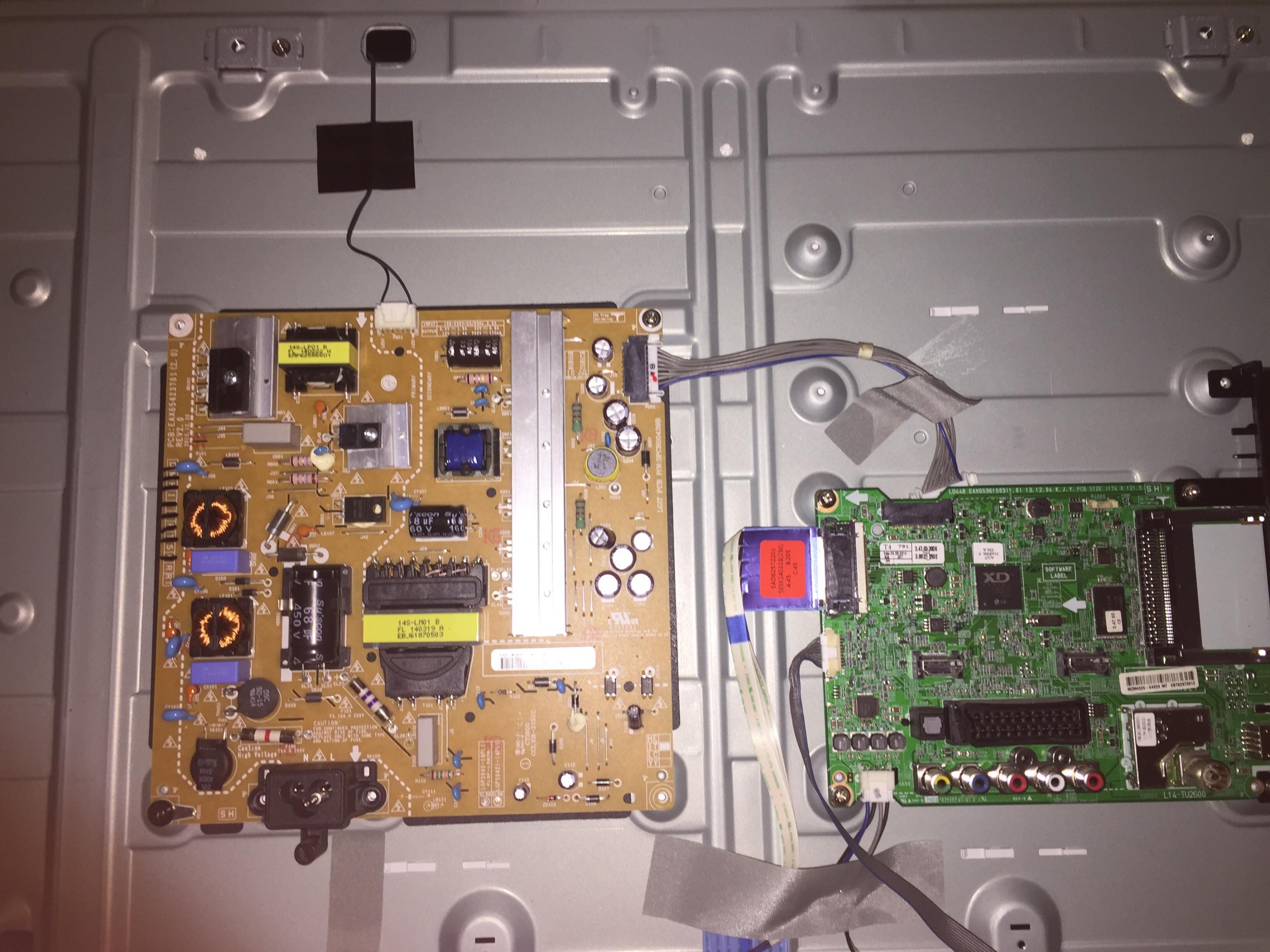

    Picked this unit up cheap and thought it would be an easy repair, (Panel looks fine and undamaged) unsure of history only going on the words of the seller. Seller says he had a power cut and the TV never came out of standby after that.
    So, the TV powers onto standby only and will go no further my first thoughts the Mainboard has become corrupt, just wondering if anyone has any advice to throw out there. Will add better pics ASAP, but the Mainboard, PSU and Panel numbers are as follows:

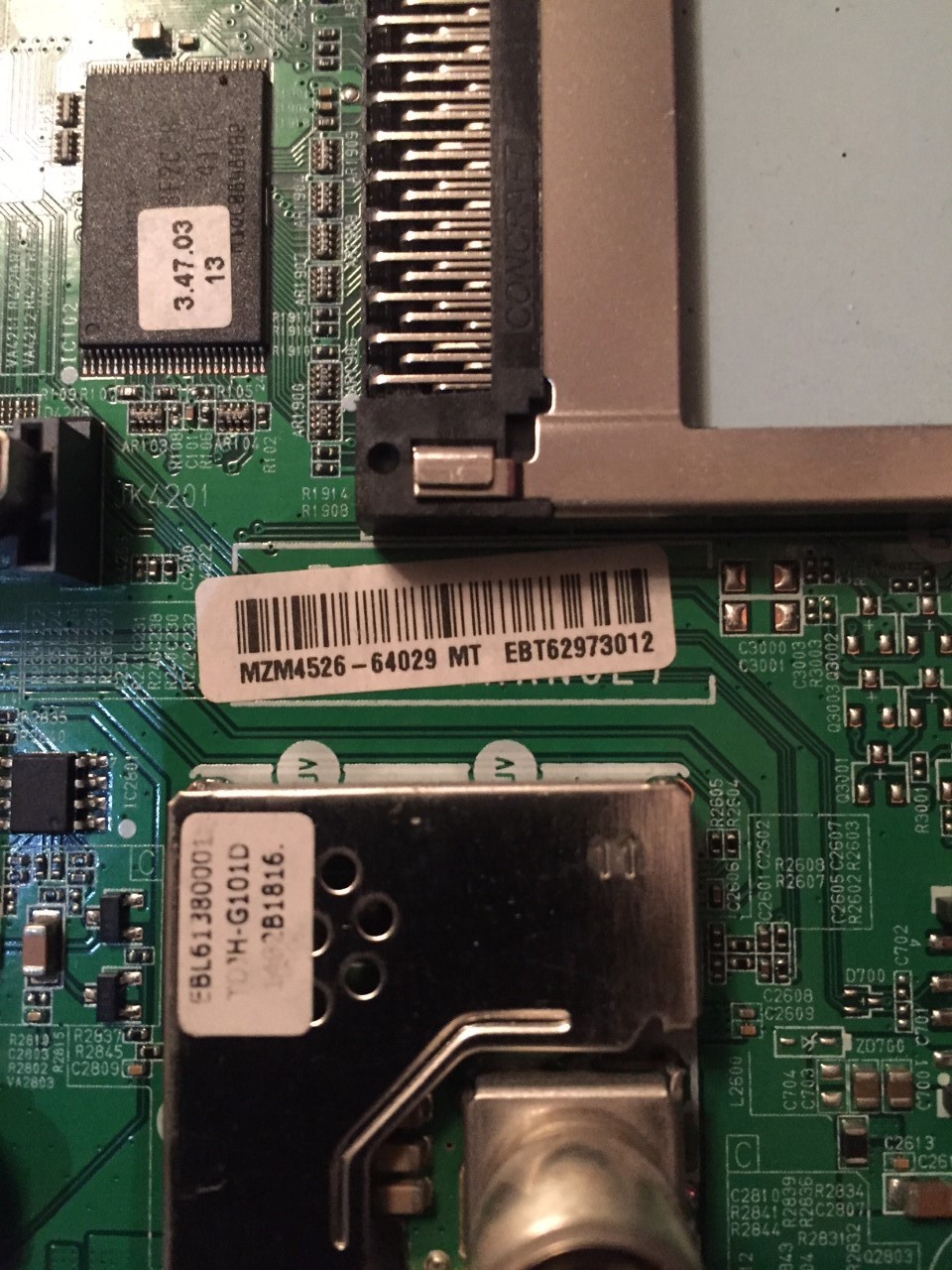

    MB
    MZM4526-64029 MT EBT62973012
    LD44B EAX65361503 (1.0)

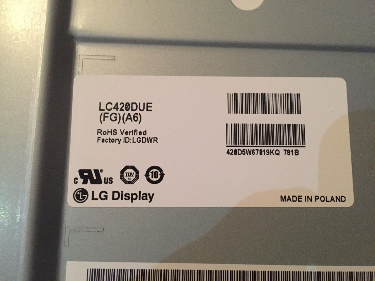

    DISPLAY
    LC420DUE (FG)(A6)

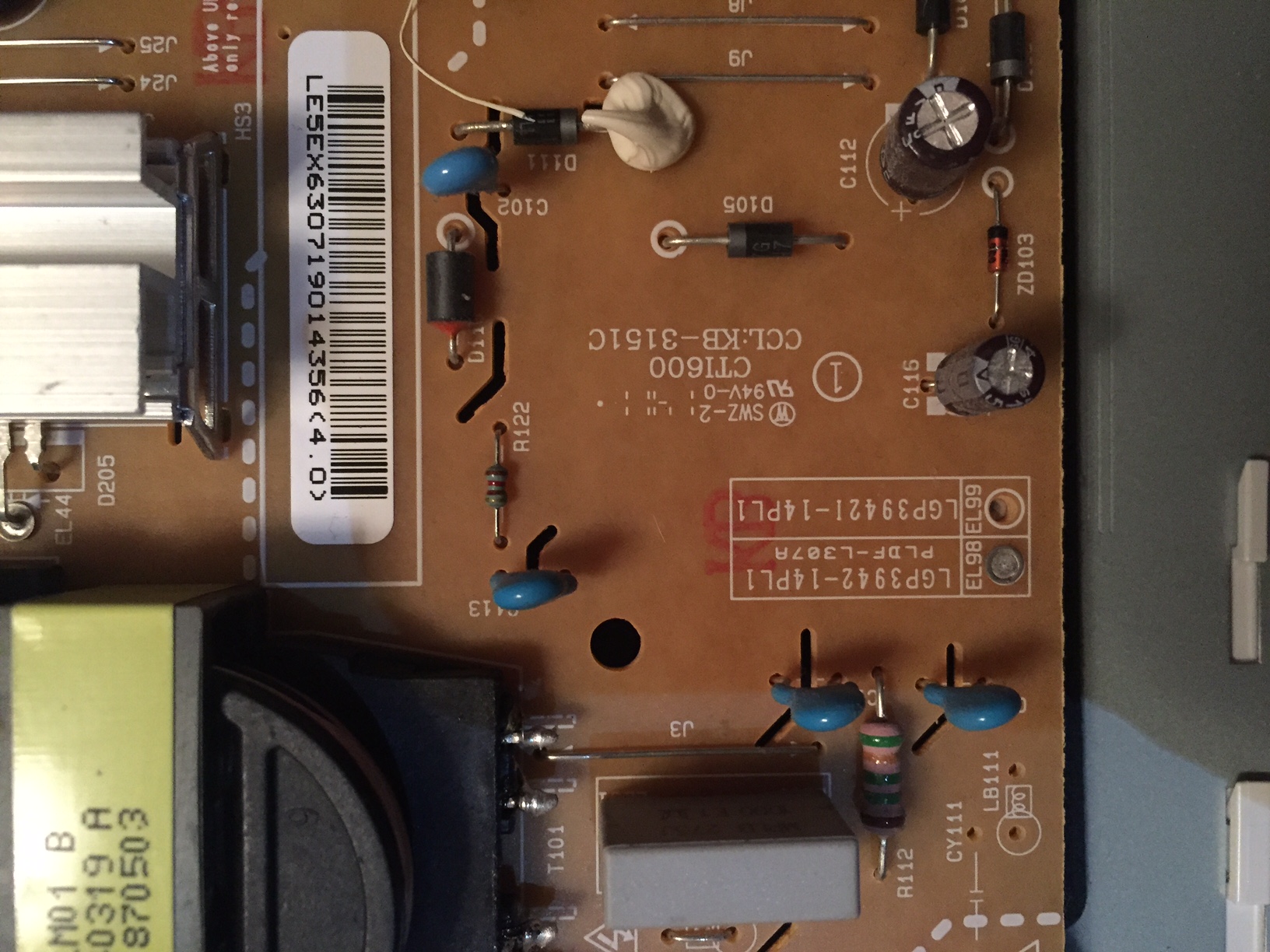

    PSU
    EAX65423701 (2.0)
    LGP3942-14PL1
    Thanks in advance.

    Re: Standby light only LG LG42LB5500
    maybe you can dissconnect the mainboard and test the voltages are all there ie 12v and 24v etc that way it will rule out a bad psu
      To test Psu unplug Mb and it turns on then test voltages let us know.

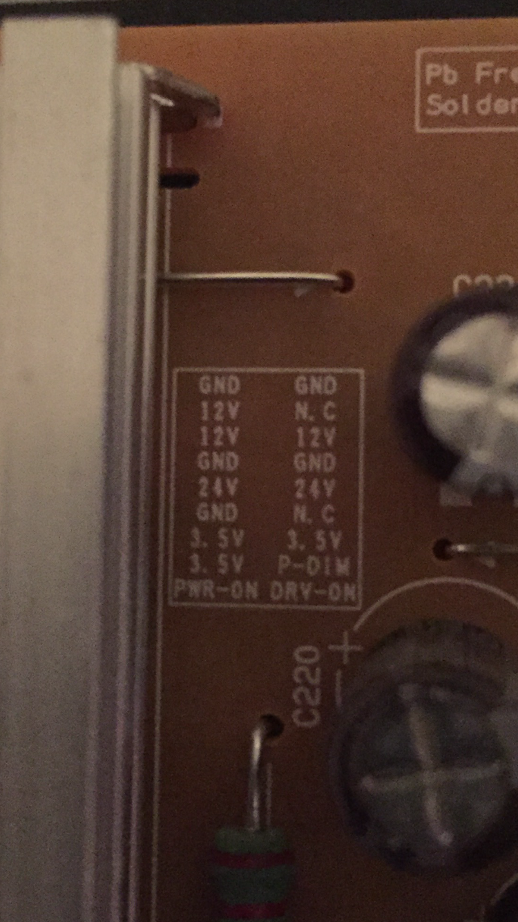

            When plugged in and checked output from psu I only get the 3.5v, no 12v or 24v

              It might require you to force it on normally they dont on these Lg Leds, do what Vince says.
                if there is no PS-ON signal from the main board to turn on the power supply/LED driver board then there will be no switched 12V/24V.
                    Hi budm I've shorted the PWR-ON to 3.5v rail on the connecter of the PSU and the PSU gave me the 12v and 24v. I'm thinking mainboard issue.??
                      If you can force on the power supply then the power supply is OK.
                      You should report the DCV reading of the pins of the connector of the power supply board that goes to the main board, make sure to give the pin names and floow by the DCV reading so we can see what are missing.
                          Originally posted by Andrew F. Ali
                          +1
                          Lol plus 1 your own comment, also I agree replace mb. But he could try a new flash Ic or reflowing it.
                                  Thanks to all for there input and help, managed to pick up a new MB and problem solved.
