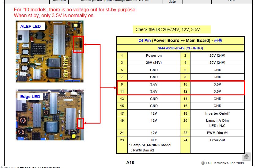

                  The attached picture looks like your power supply and if from an LG-47LW5700 model.
                  Can you check you have the voltages shown in the table.
                    Yes I can but before I will return the thermistors also must i plug the 230v in it ? i had the down model of board so i will check it but i think the leds work because my tv turn on for second and then turn of like she found short circuit

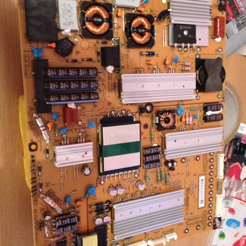

                                  Okey guys So I make big progresws today I check the big capacitors and no voltage on them the voltage stops on part INR or LNR next to main gray CAP so this part is definitly damaged does anyone know which one i need to replace ? it looks like Varistor but i dont know nothing about it
                                    Re: LG 42LW4500-LB Need help with repair of PSU
                                    https://www.badcaps.net/forum/attach...7&d=1479570017
                                    So the fuse to left of the line filter cap (grey cap) is good for sure?
                                    Are you getting 230VAC between the two legs of that grey cap?
                                      Yes 250VAC on gray cap on right side of it its some type of varistor or part (i dont know what it is and which one i need to replace) this part has voltage on + but if you try + and - no voltage everything after that it has no or bad voltage in miliamperes
                                        We need clear straight shot pictures of the whole board.
                                        There is a bridge rectifier (4-pin black device) mounted on the heatsink, you need to check the ACV between the two inner legs, it should have 230VAC between those two legs.
                                        https://www.badcaps.net/forum/attach...8&d=1479570017
