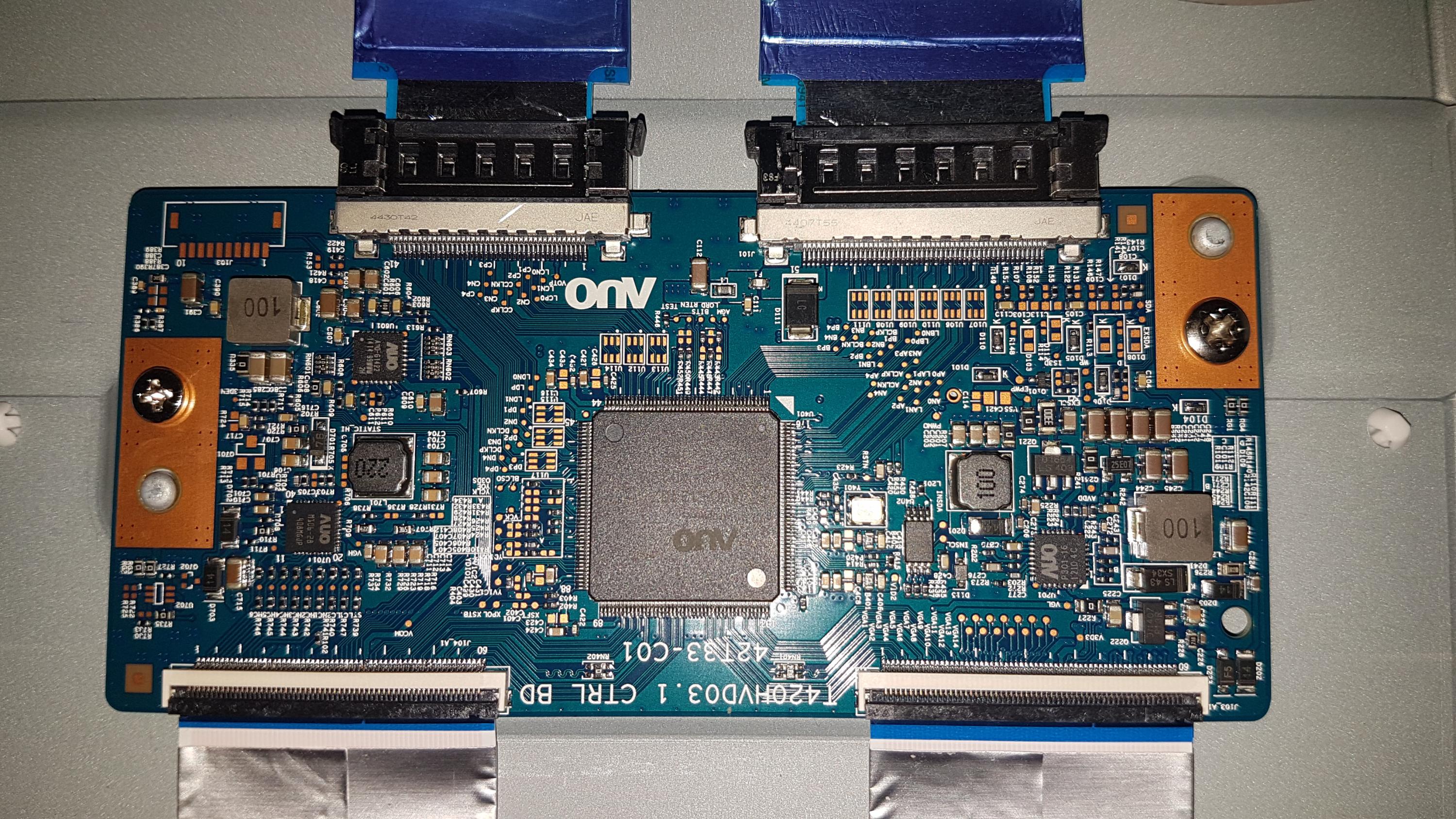

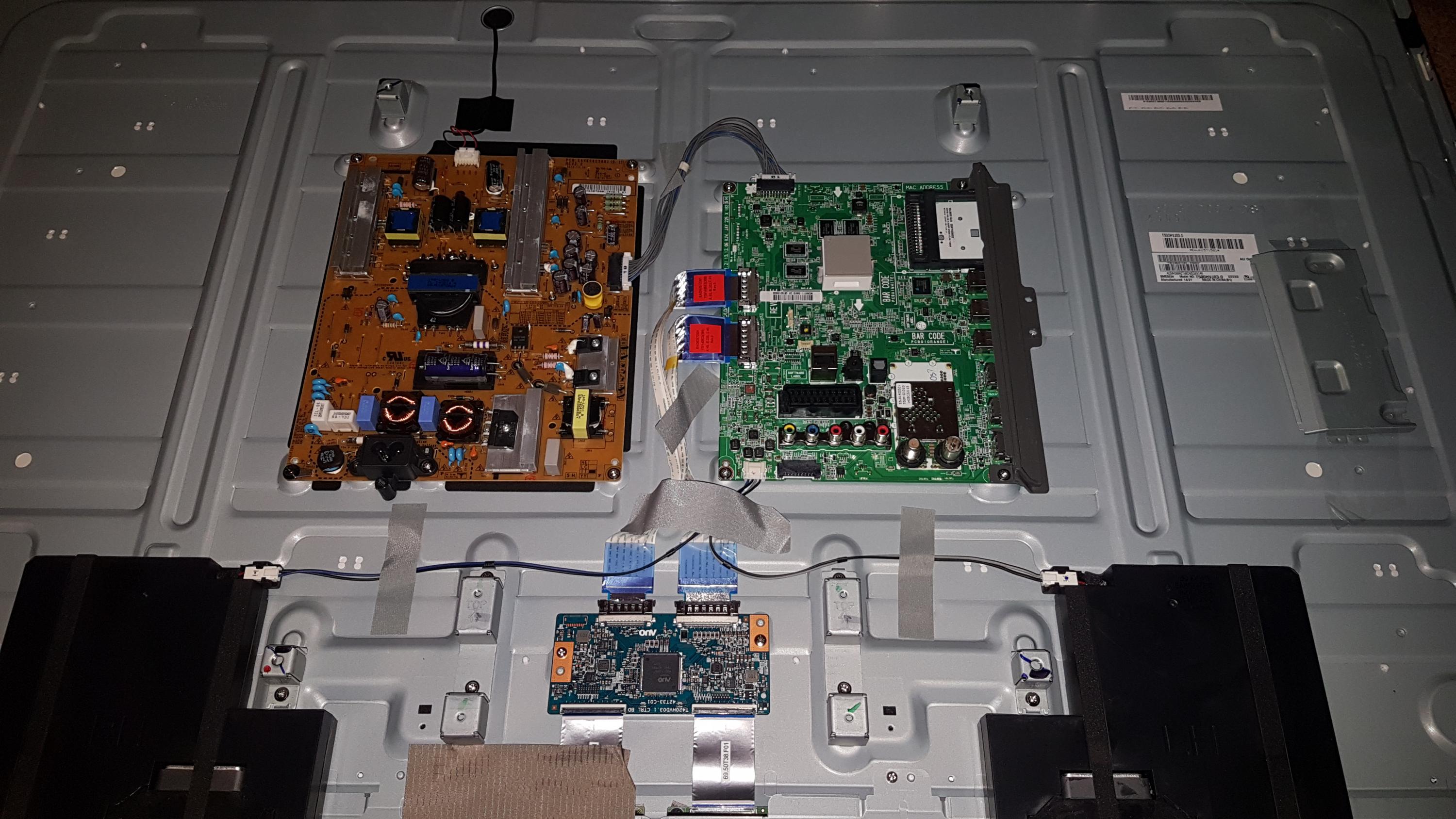

    hello
    tv is just displaying a bright screen no image at all backlights are working
    checked fuse voltages on tcon board 11.91 volts
    no gamma voltages totally dead
    and also tried disconnecting tcon lvds cable one at a time and still no display
    anyone else come across this fault ?
    thanks

    Ive had that Tcon blow up on a 42" Sony, one of the small power reg Ic's near the DCDC converters was destroyed. If I remember these are cheap to replace bud.

      Update :
      Tcon replacement fixed the fault
