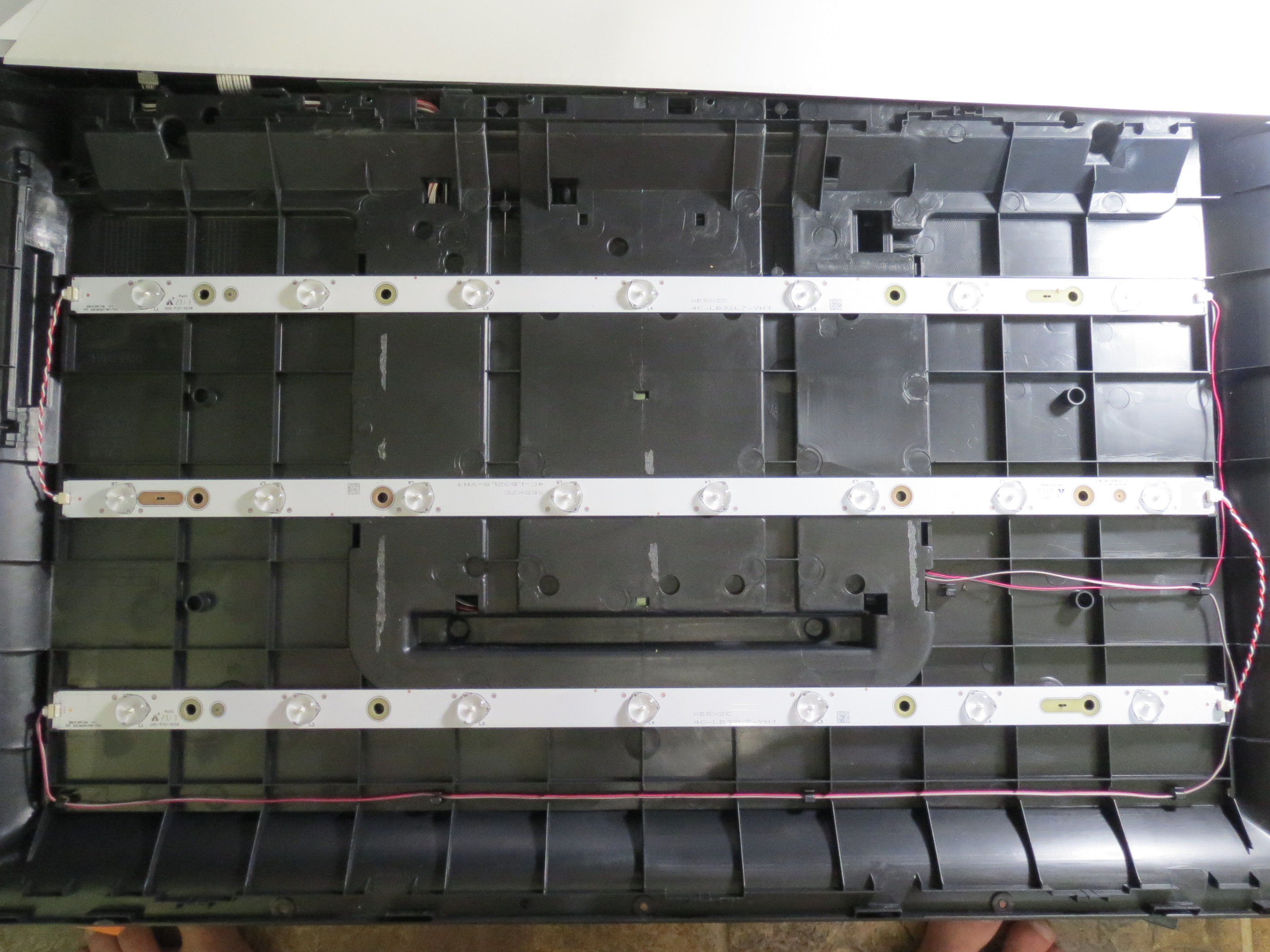

        BTW, the panel is still apart so you can actually see the LEDs?
        • Alex9
          • Sep 2016
          • 18
          Re: TCL LED backlight voltage drop
          Sorry, I had the tv put together due to lack of working space. I just took it apart though.
          strip 1 is 19.3v with 7 LEDs
          strip 2 is 22v with 8 LEDs
          strip 3 is 19.3v with 7 LEDs
          They appear to be connected in Series.
          Soooo I put it all back together and for some reason the backlight is staying on now. It's been 10 minutes already without turning off. The only thing I can think of is that I disconnected each LED strip from each other to test them individually just now and maybe reconnecting one of them fixed a loose connection problem? I don't know what to say except that I'll post back if it stops working?

              i would suggest you to connect all the Cable direct on the LED strips jump the sockets .. , its more safe for future and best way to be sure all connection exist.
