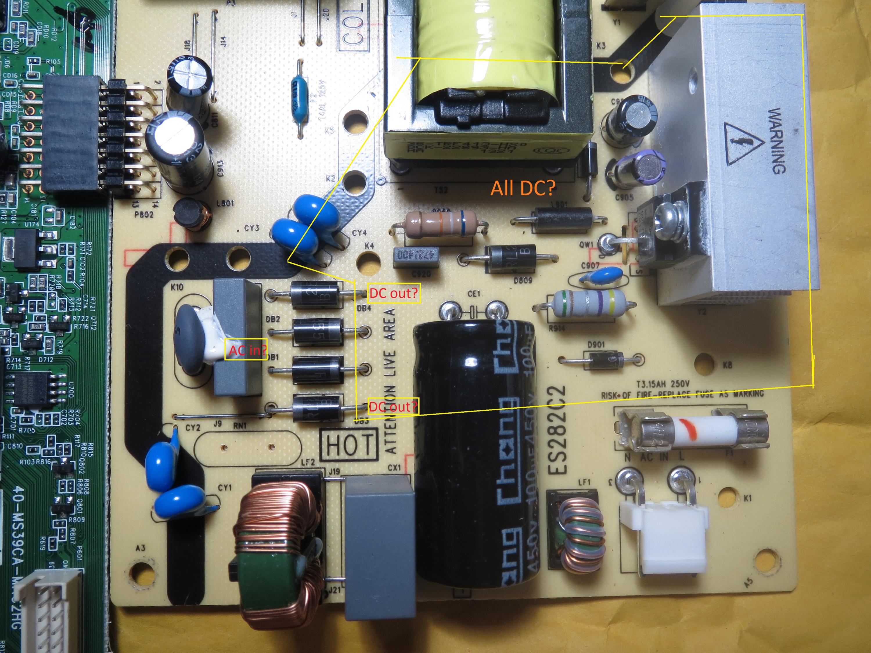

    Re: TCL LED backlight voltage drop

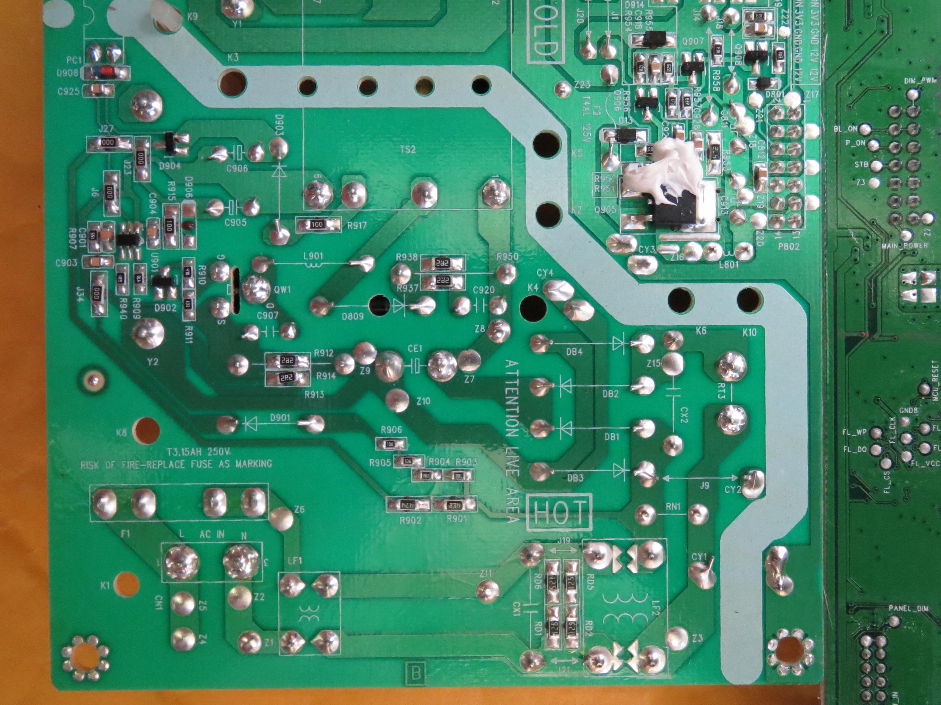

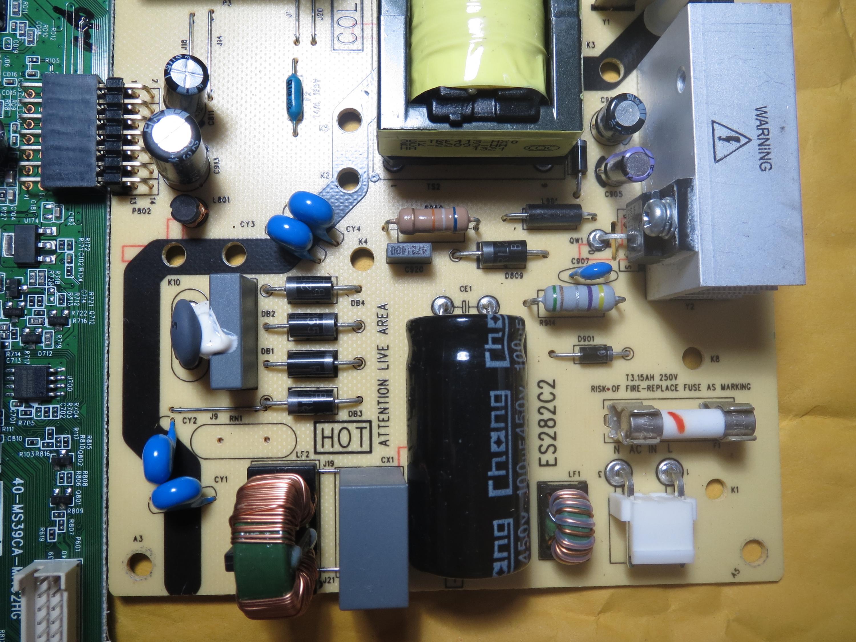

    The bridge rectifier is made up of the 4 diodes alongside each other. The area marked live is the HOT side of the power supply where you make your measurement with caution.
    The COLD side is the safe side which then connects power to the main board and other circuits where applicable.
    There's a thick black line that clearly separates the HOT and COLD side of the circuitry.
    Photo's of both sides of your power supply could prove helpful.

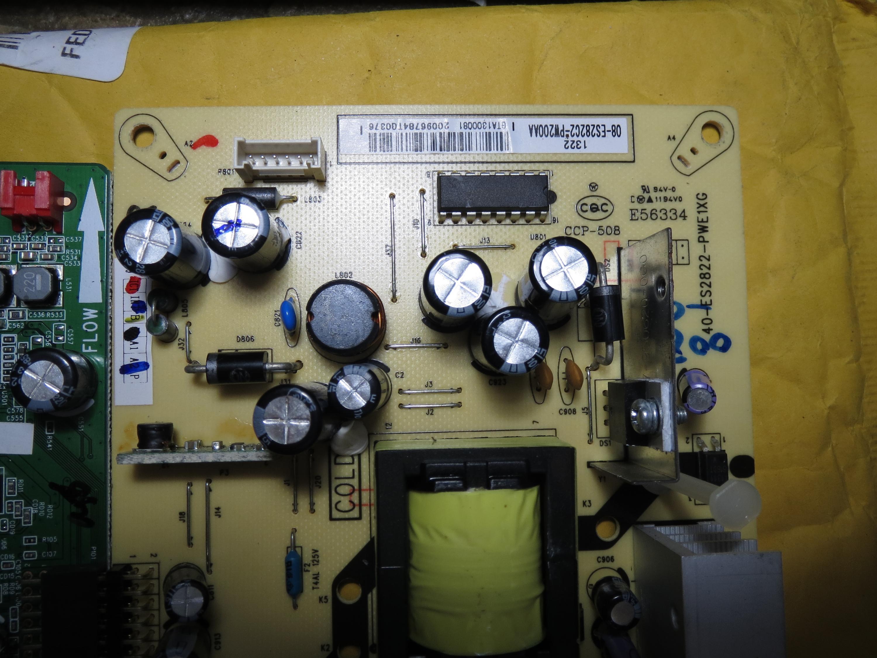

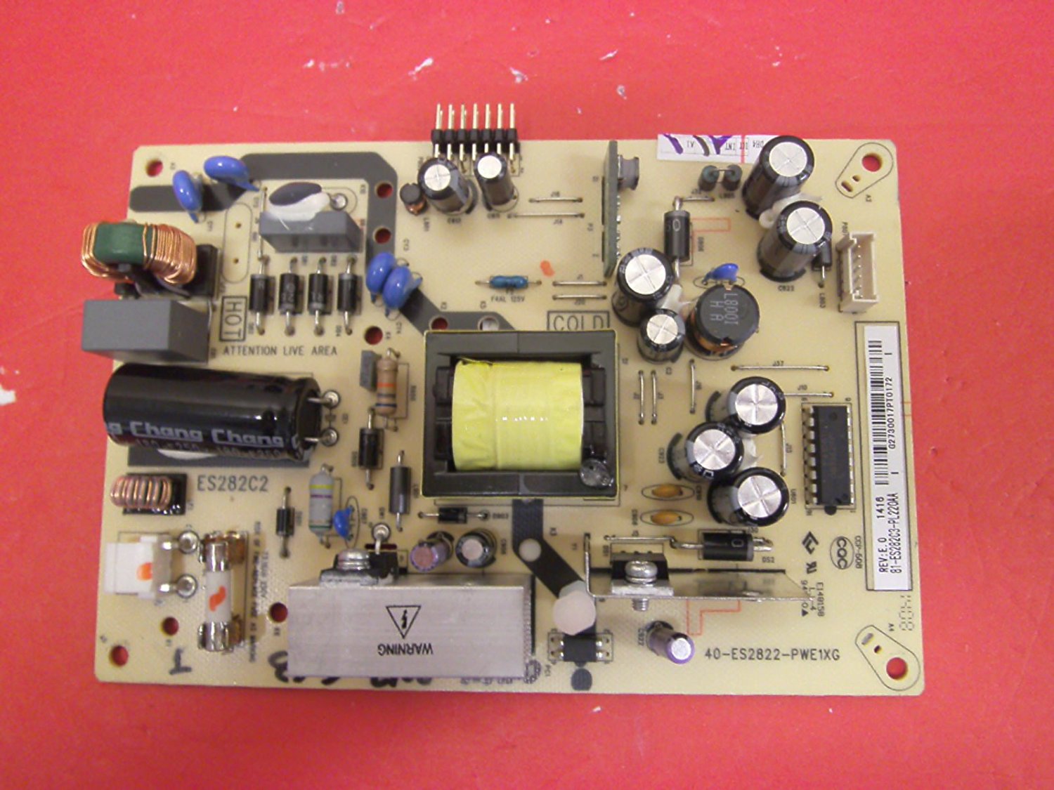

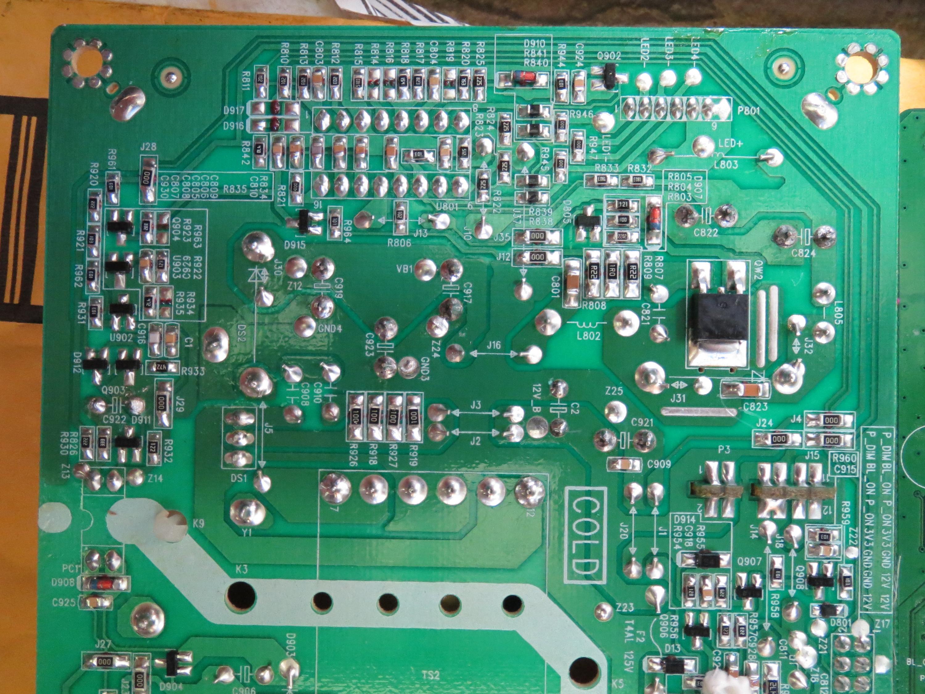

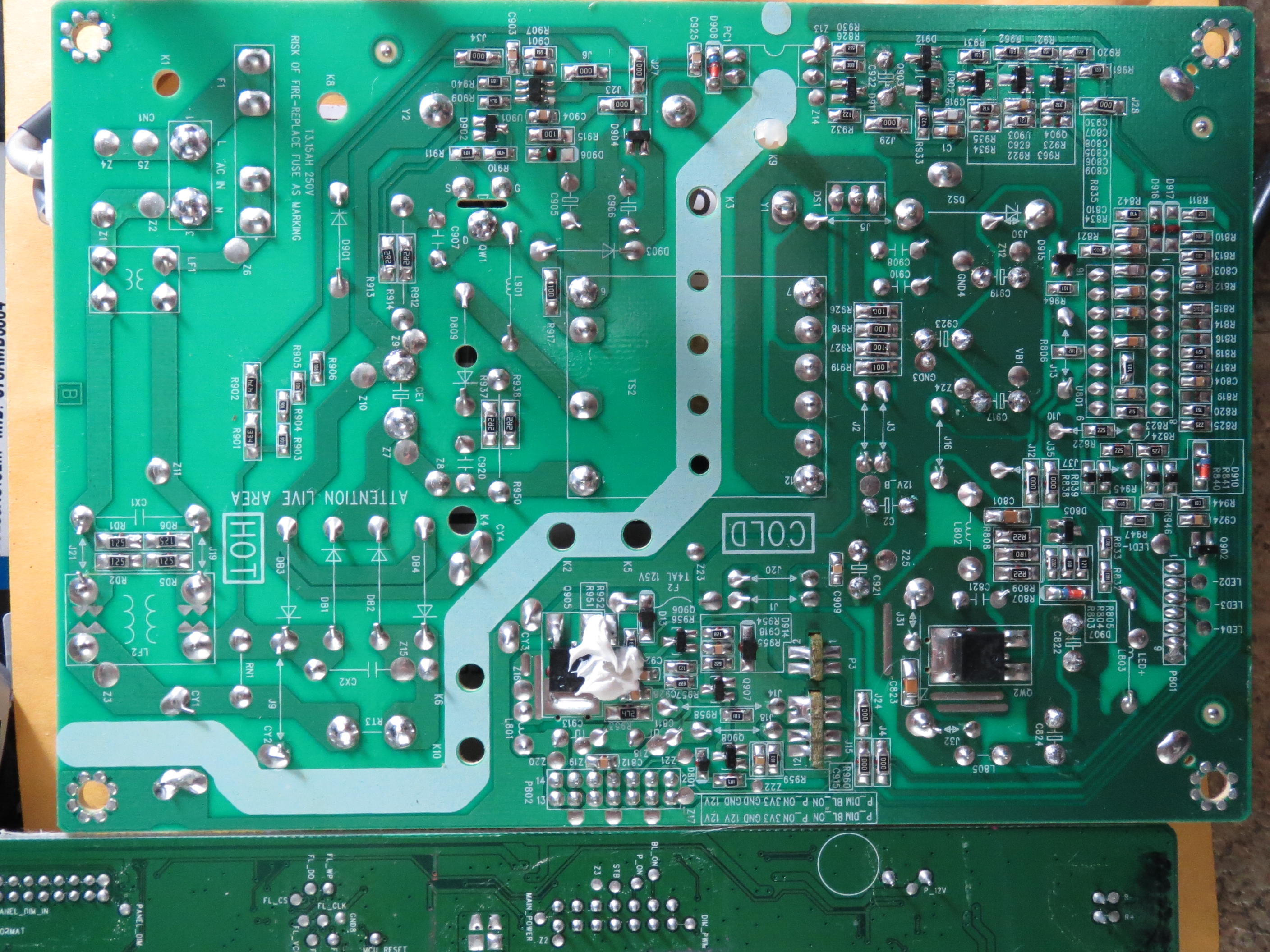

      Ok I see the diodes now. Here are pictures of both sides of the board. The last one is my assumptions about the bridge rectifier. Thanks.

        You may want to inspect the solder joints of all those pins of the black connector, they are solder to single-sided board with not much mechanical support.
        It can be that the BL-ON is not present so the it is stuck at 46VDC, I am not 100% sure yet until I can trace out the circuit on the bottom side of the board.

            I believe Budm may be referring to P802. (black connector)

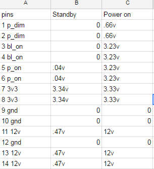

            If you could measure the DC voltage at connector P802 - pin marked BL_ON to chassis when you switch on out of standby.

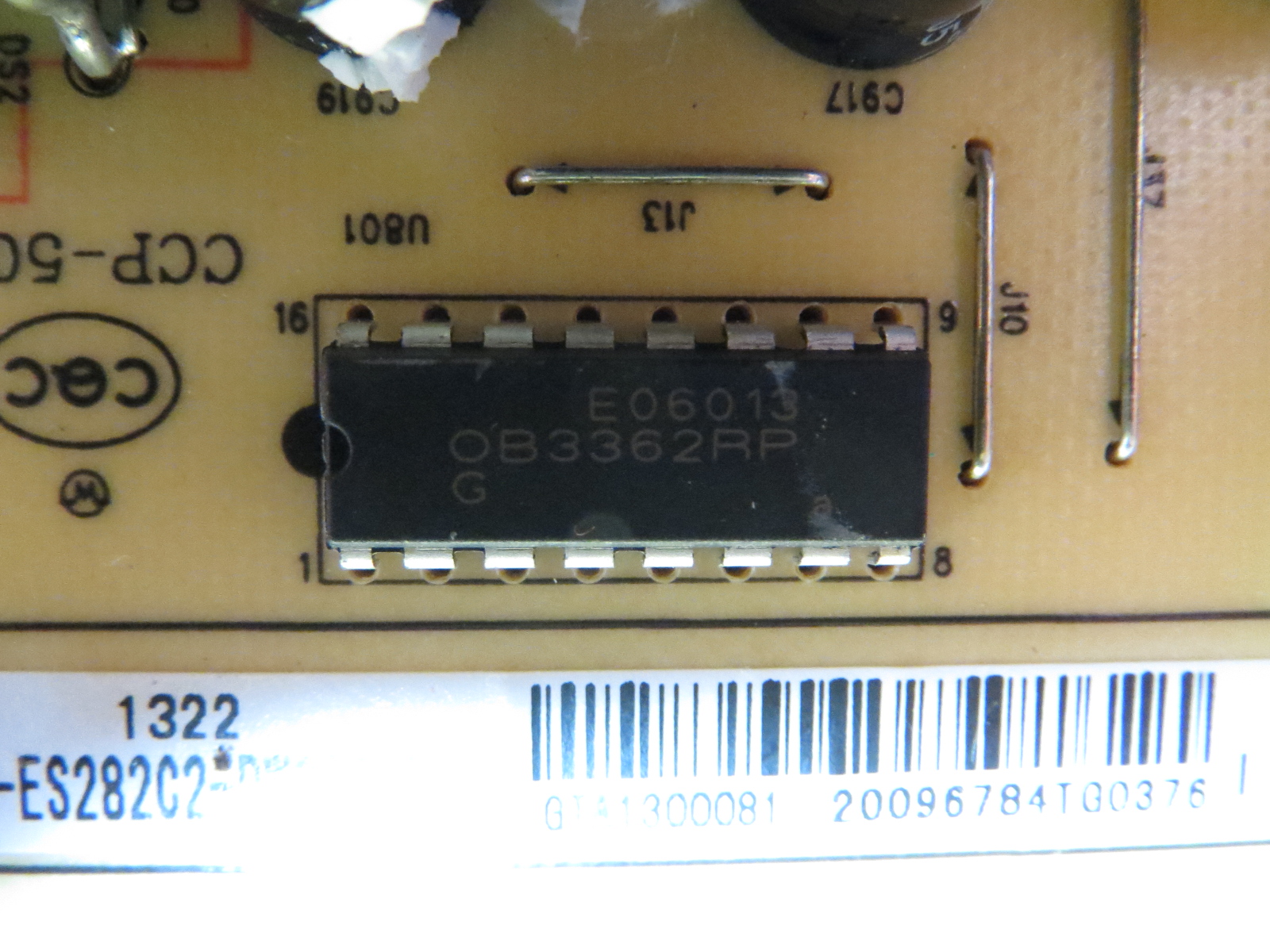

            What is the number written on U801

              3.232v on both.
              Attached a picture.

                Sorry but are you saying that the "Backlight On" voltage is 3.232V when in standby and out when of standby.
                If that's the case what is the voltage on the STB pin when in standby and when taken out of standby?
                    Sorry. I'll be specific

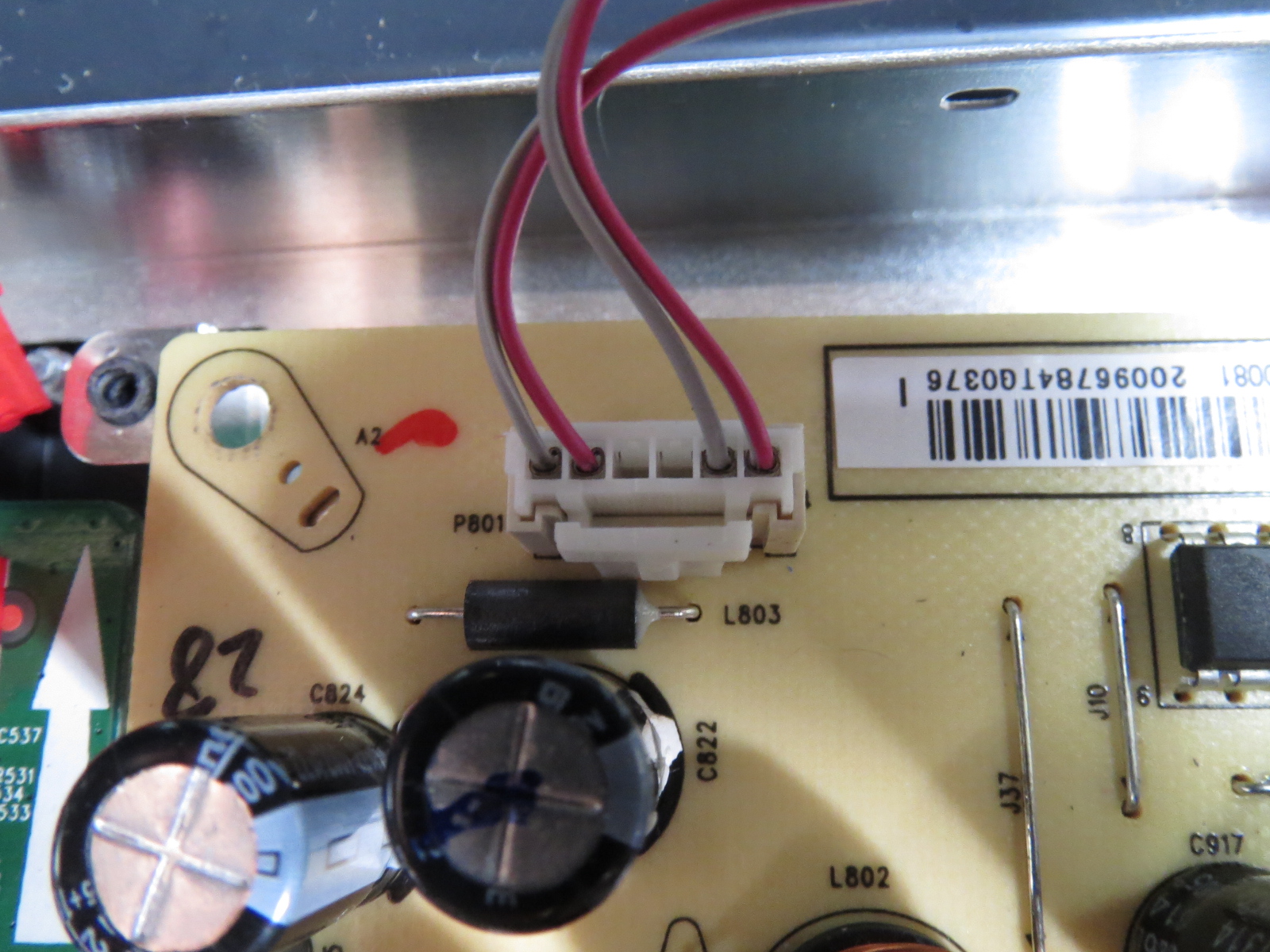

                        I'm a bit confused about this question. P801 has only 6 pins and I'm pretty sure 1 & 2 are Negative and 5 & 6 are Positive. 0vdc from pins 1 & 2 and 46v from pins 5 & 6.

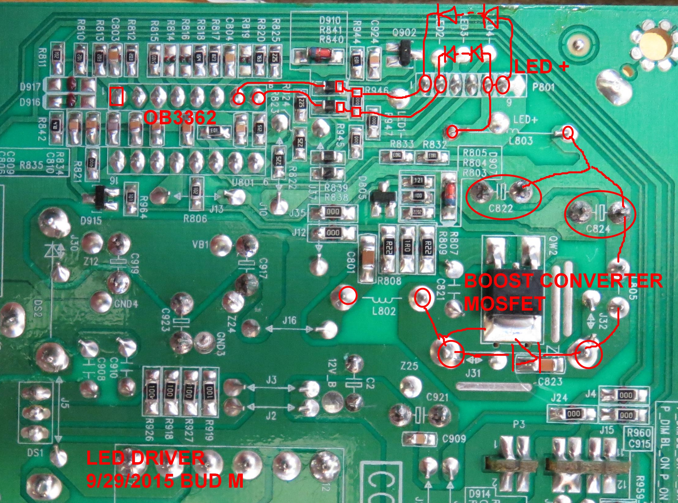

                            Sorry my mistake, P801 only has 6 pins.
                            Pin 1, 2, 3, and 4 are the Cathode return pin of each LED strips, since you only has 3 LED strips so that means one of the 4 pin is not used (yhat is why I want to see the pictures of the LED connector to see which pin is not being used). The return current through the LEDs go through the internal circuit that control the constant current through each LED string and then return to the GND pin of the IC.
                            Pin 5 & 6 is where the LED+ Voltage is fed to the Anode pin of all 3 LED string.
                            75~80V feeding the LED strings is about right, something is telling the circuit to go into shutdown that is why it drops back down to standby Voltage of around 40V.
                            Can you take the reading of pin 1~4 of P801 one at a time each time you turn on the TV? I want to see what dcv you have on each Cathode pin of each LED string before it goes to standby mode.
                              https://www.badcaps.net/forum/attach...5&d=1475203204

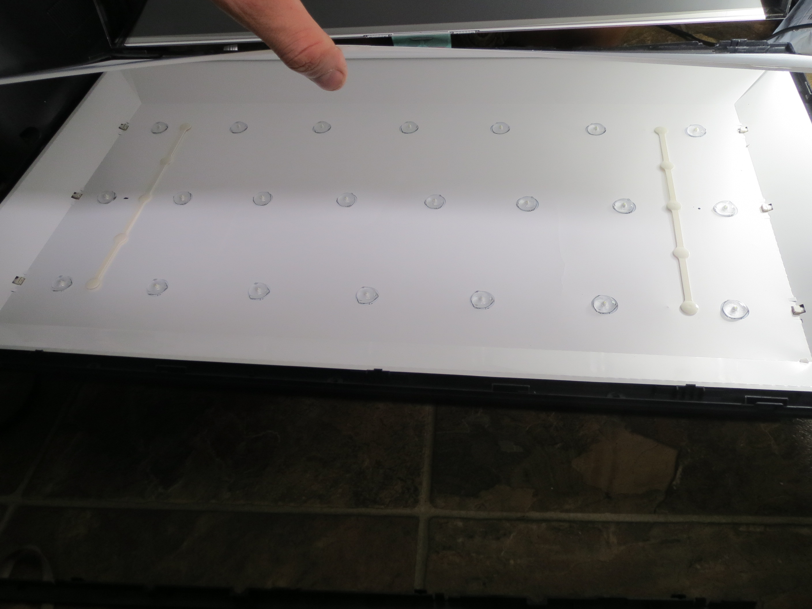

                              That does not make sense top have only 4 wires for 3 LED strings. I wonder how the LED strips are wired up inside the panel. Pin 5 and 6 are tied together for the LED +.
                              I see 6 connectors total on the LED strips. 22 LEDs total so you have two strings of LED, each string has 11 LEDS based on the wiring of the connector P801.
                              You said using you tester you get about 60V, how did you hook up the tester to the LED strings?
                              22 LEDs *3V = 66V if they are connected as one big string, but looking at the connetor wire termination it does not look like they are connected as one big string.
                                https://www.badcaps.net/forum/attach...9&d=1475179297
                                OK, I see it now, pin 1 and pin 2 of P801 are shorted together through R946 0 Ohm jumper so the IC sink pin 8 and 9 are tied together.
                                So the LED strips are connected in parallel, and they may be 6V LED (Dual LED in one body) not 3V LED.
                                So I need to know how the LED is connected to test the LED strips. All the LEDs light up brightly when using the tester?

                                      Every LED lit up nice and bright with the tester connected. The other way I connected it was to the connector at pins 1 and 6.
                                      If you don't need me to open it up again please let me know. I'd be happy to do it all the same.
