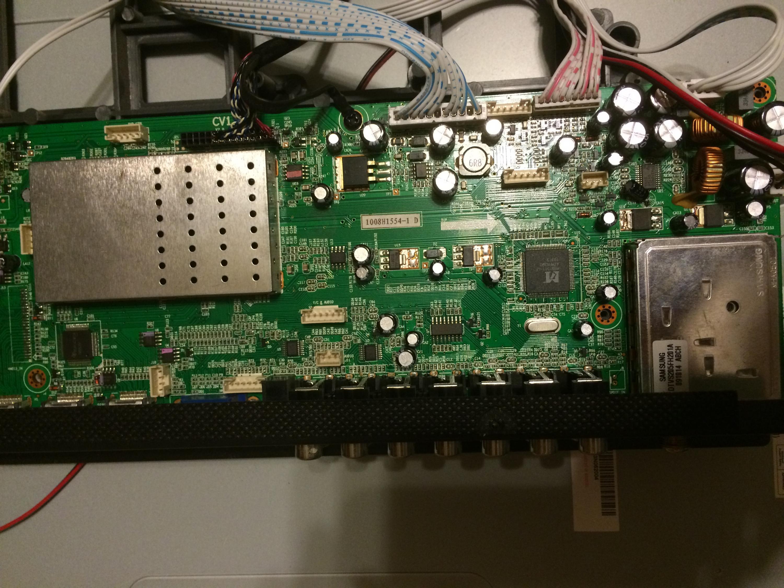

    Curtis 3227A no Audio Issues
    Hello, I acquired a Curtis 3227A LCD that has video and no audio. I ran through the basic voltage testing and capacitor evaluation with my ESR meter and did not find anything obvious. I was wondering what could be the issue with this type of symptom? I will have photos of the main board and power supply when the server is not as busy..
    Thanks Mike
  • mike123333
    • Oct 2011
    • 196
    Re: Curtis 3227A no Audio Issues
    Here are the photos..

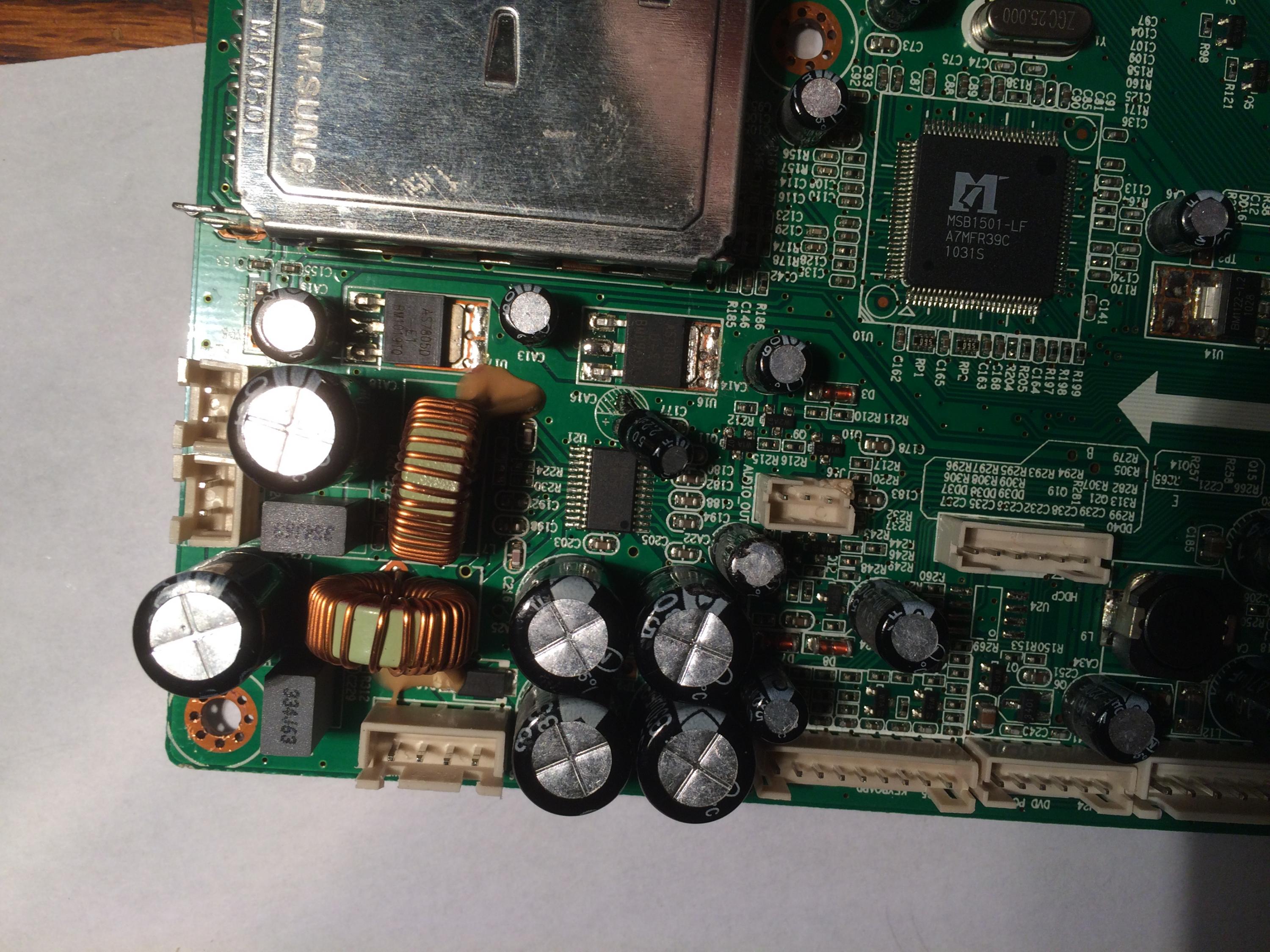

          What are U10 & U21.
          As CapLeaker suggests there may be a problem with the headphone socket otherwise you may not have the correct voltage supply for the Audio Amplifier.
                I would first check in the menu,to see if tv speakers are disabled?
                Then try and see if you get sound out of the headphone jack.
                U17 and U18 look like voltage regulators,guessing U17 regulates the power for U21 which is your audio driver IC.
                You can find specs on U17/18 and see if they are correct in voltage output.
                BTW,what happened to Ca16,it looks like it got messed with.

                      I did look for the obvious as to whether the internal speakers were on or off, everything was good from there. There is no head phone jack so I cannot test that. I am presently using the rca audio jack to run from a dvd player.
                      As for the IC chips U16 and U17 ( that is the correct number on the boards) one is a 7808 and the other is 7805 , 7808 is outputting an 8 volt and the 7805 is at 5 v so both of them are good.
                      CA16 I had to take it out to test it offline with my ESR meter and had difficulties putting it back into the holes so I soldered it from the top.
                      As for U10 the number on IC is MSB1501-LF, A7MFR39C and U21 is TPA3124D2, O4TGA

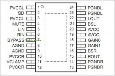

                          What is the supply voltage on Pins 1, 3, 10, 12, 19 & 20 on the TPA3124D2 audio amplifier.
                              All the voltages are reading 23.55 VDC
                                Since you are NOT getting any audio at the pre-amplify RCA line out which the circuit is BEFORE the power amplifier section then the problem cannot be in the power amp section.

                                  I was do more troubleshooting and have a question, if you can see in the picture the 2 large capacitors next to the speaker plugs. when I check the voltage from ground to the speaker plugs I get 12-13V, even if I check across the neg and pos leads of the plugs. If I check the capacitors from ground to + of capacitor I get the same voltage, however if I check the voltage across the capacitor leads it is ~0.7V. If I check the resistance of the ground to the neg lead of the caps I do not get continuity, does this sound correct?or should there be a ground continuity to the neg side of the caps? hopefully you can follow what I am asking
                                  • mike123333
                                    • Oct 2011
                                    • 196
                                    forgot to mention, the voltage of the caps from gnd to either lead of the cap is measuring at 12-13V, so its not only the positive lead of the cap its also the neg
                                      If you look at how the amplify is setup in the spec sheet of the IC, you will see that there is DC BLOCKING/COUPLING cap between the output pin of the IC and the positive pin of the speaker. So the DCV on one side of that coupling cap that is connected to the output pin should be = 1/2 of the VCC supplied to the IC, the other side of the cap that is connected to the speaker + wire should be 0VDC, you should check the DCV the two legs of the speaker (speaker has to be connected to the connector).
