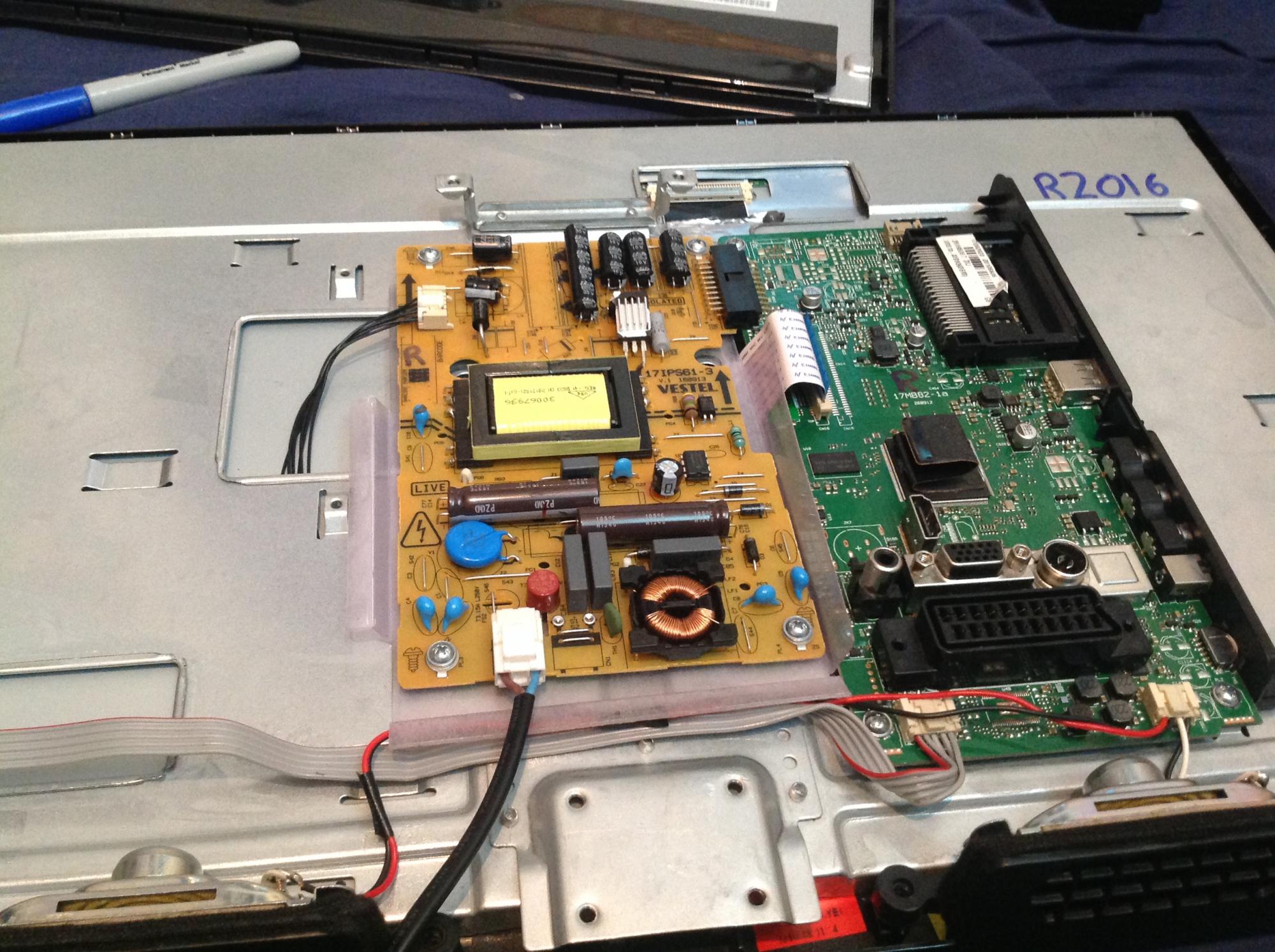

    Hi everyone!
    I've got a 22 inch Toshiba TV which is really just a rebaged Vestel and like so many of these things the PSU has got a shorted diode on the 12v rail preventing it from working.
    Now replacing the diode is simple enough but having read this thread https://www.badcaps.net/forum/showthread.php?t=42137 I'm leaning towards fitting a high voltage fast recovery diode instead but my concern is how hot would such a diode get with the increased voltage drop? Should I parallel multiple diodes up like Vestel did?
    The back of the TV reveals a power draw of 50w max which is just over 4.1 amps @ 12v.
    The PSU is a VESTEL 17IPS61-3 and can only accept DO-201 diodes but I can't find any suitable 300v+ 5 amp schottkys in that package which is why I'm considering a regular fast recovery diode instead.
    The 24v rail currently has a single 200v UF5402 installed which I plan to upgrade to the 400v UF5404 in order to cater for the increased reflected voltage spike which the 12v rails underrated schottky used to clamp.
    If anyone has repaired one of this PSU's before I would be interested in knowing what replacement part you fitted and how long the repair has lasted, I know these boards are infamous for being junk but I'm trying to avoid a repeat diode failure in future from selecting an under rated part.
    Thanks!

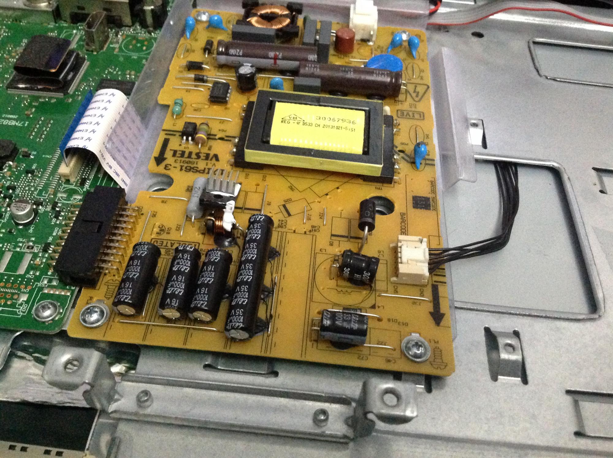

    Update: Well I got no replies so I went ahead and installed 3x STTH5L06 for the 12v rail in place of the 2x SB5100 and 1x SR5010 trio whilst for the 24 rail I installed a UF5404 instead of the UF5402.
    The SR5010 is the one that originally failed.
    In hindsight I probably could have gotten away with just installing one or two STTH5L06 but I chickened out just in case they get too hot once the TV goes back to its owner, I made sure to bunch them all together to help with thermal balancing issues.
    The TV now works and is now being tested for a few hours.

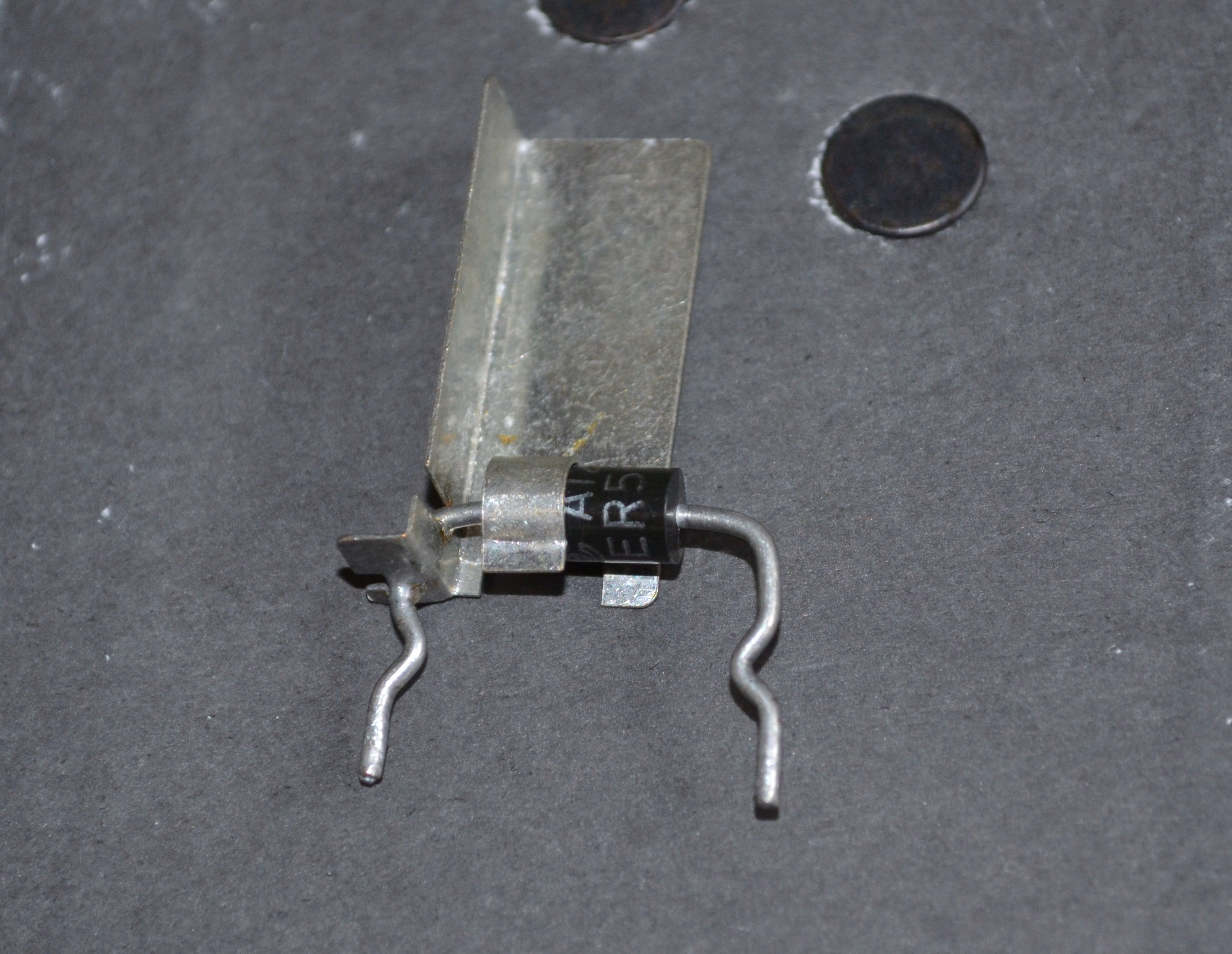

            Hmm well I just tested by spreading the legs of a TO-220 device and compared it to the shorted diode and it could certainly fit into the DO-201 holes at a push, but I don't think it would last in this application as the voltage spikes across the diode when the TV is first turned on reach nearly 300V!
            And would you believe it I just came across this cute little DO-201 heatsink in my parts box after I had already screwed the TV back together.

                  btw, you probably dont need a heatsink - the original diodes didnt,
                  and if you mount it vertical or upside-down it already has a copper plate.
