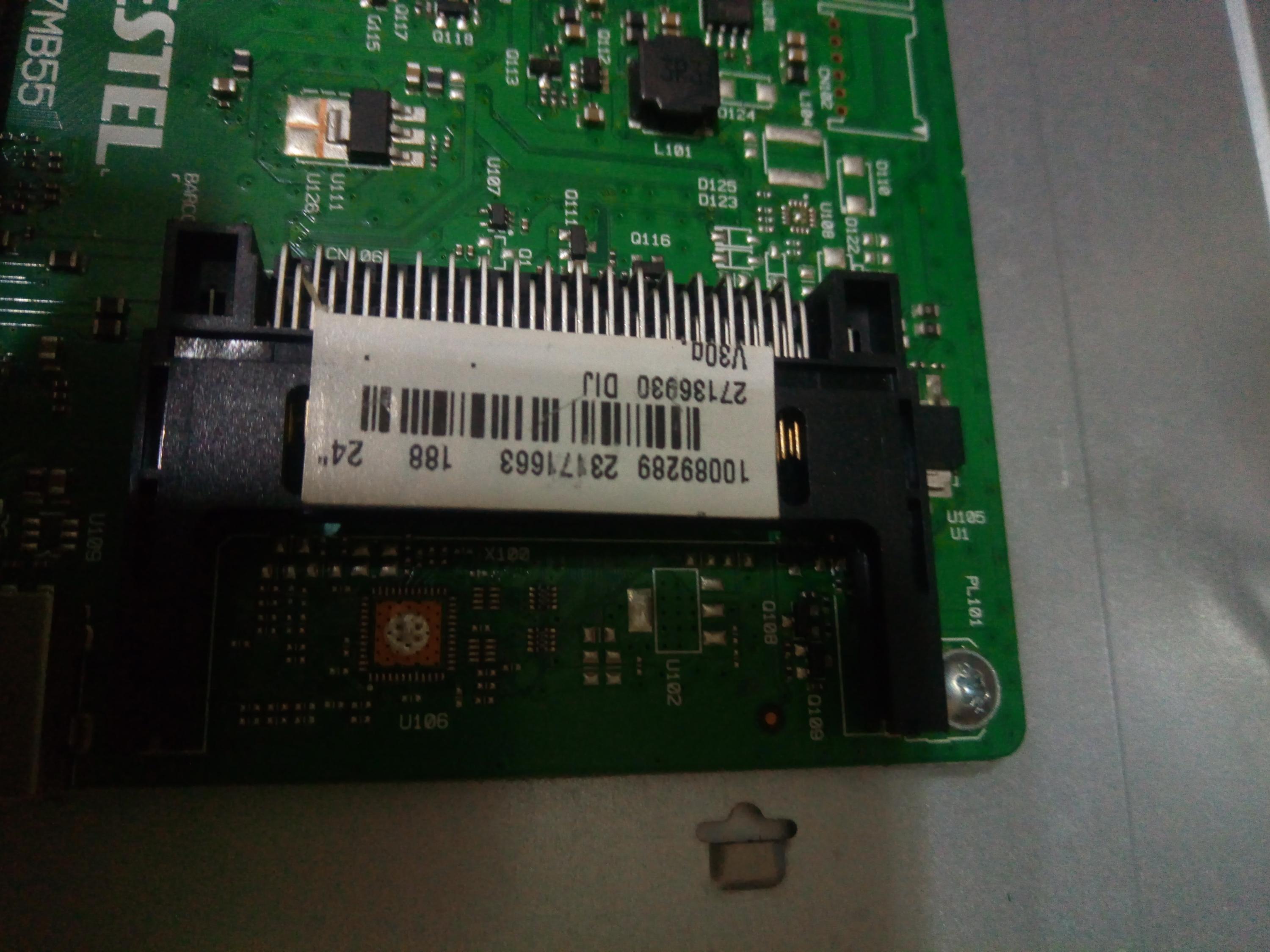

          i have one of those vestel 17IPS61-3 power boards
          odd is the conector to the logic board as only 12 pins and i cant find where the standby power is..
          fact is i do have a blinking red light and nothing else anyone saw one like this?

              #46
              Re: VESTEL 17IPS61-3 shorted output diodes
              This looks like a toshiba set i worked on a while ago i had same blinking standy light it turned out too be a eeprom fault what make is the tv and what lcd panel is used in it
              its a lousy Branded Electronia but everything inside is Vestel that file you posted there is what i got but i dont have any standby light only 12v on 12 pin of the connector to the logic board
              there is any way i can put the files inside the flash without removing them?
              the tv tries to read the usb pen cos it lights up but i dont think i have a firmware to put there
              anyone have those files the file talks about so i can try them
              thank you

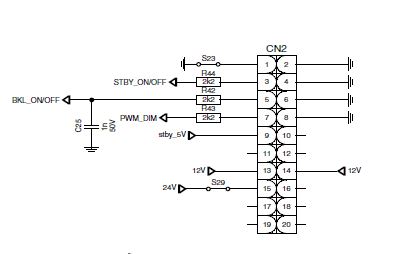

                          #52
                          if you look at the schematic in post 45 what voltages do you get on the connector cn2

                              #54
                              Hi and first of all thanks for your prompt and kind replies! Right now I haven't still fitted the diodes back on the board so I can't take any voltage measurement but I'll do it ASAP, I hope in a couple of days or so.
                              What I would do even sooner is taking an actual photo of my board, both sides: Dick's advice is absolutely correct.
                              I thank you both for the advice about the schematic and giving me also a detail image from it. I apologize for not thinking about it by myself and I apologize again because I'm sure I'm going to make a super-dumb question.
                              If I read that schematic well (probably not or at least not completely), from that connector I could take the measurements for:
                              • 12V between 13/14 and 2
                              • 5V between 9 and 2
                              • 24V between 15 and 2
                              Am I completely wrong or am I missing something? I miss 3.3V for example... Please forgive me: I've told you this was going to be a super-dumb question!

                                      #58
                                      What about the voltage between pins 3 to 2, pins 5 and 2, pins 7 and 2

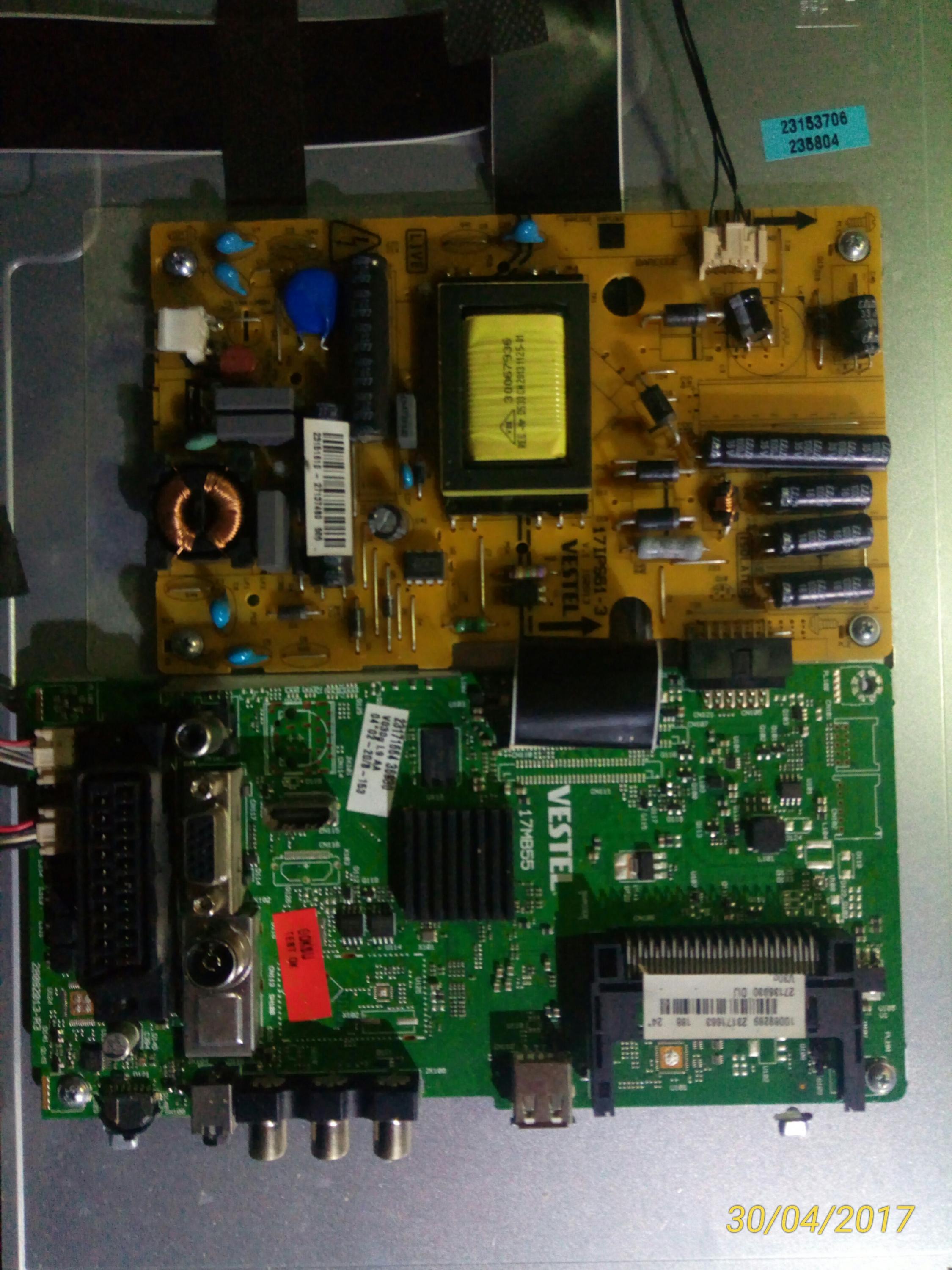

                                          #60
                                          Hello to everyone and first of all please excuse me for not coming back before.
                                          First of all, here are the actual photos for my PSU:
                                          the third one being a detail of a thermistor with a black mark on it: it doesn't seem a burning sign though, just some kind of glue.
                                          The readings are very strange, here they are:
                                          3 -0.02V
                                          5 0.00V
                                          7 0.06V
                                          9 0.00V
                                          11/13/14 11.18V
                                          15 0.00V
                                          I know that according to the schematics for the board I'm supposed not to be getting any voltage reading on pin 11 but I've double checked. Also, pin 11 isn't NC as in the schematics but connected to a resistor.
                                          Another difference is that pin 14 and 18 are bridged.
                                          For what concernes the screws, yes I had noticed they were somewhat loose.
