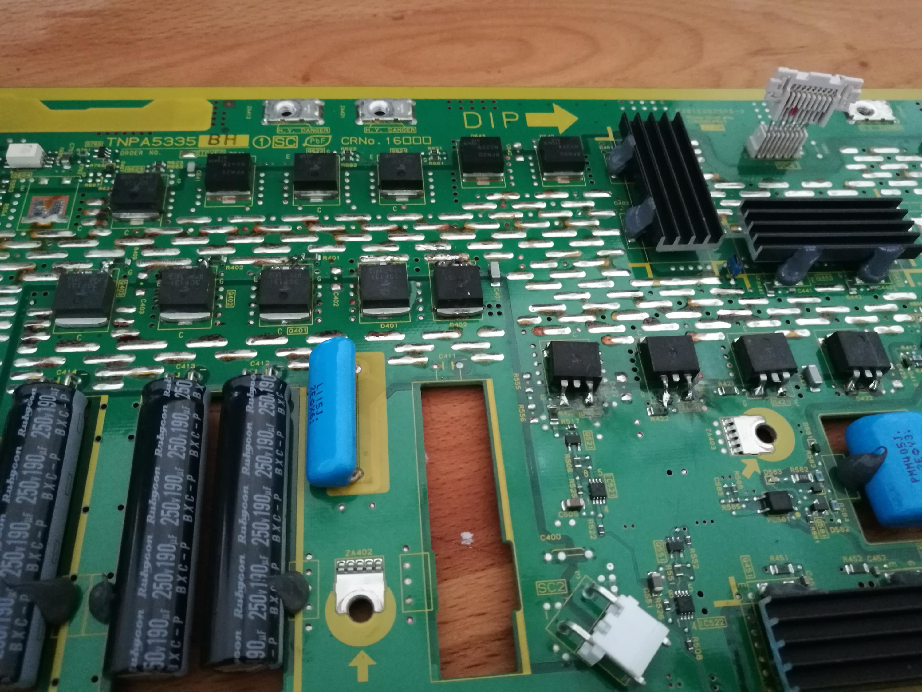

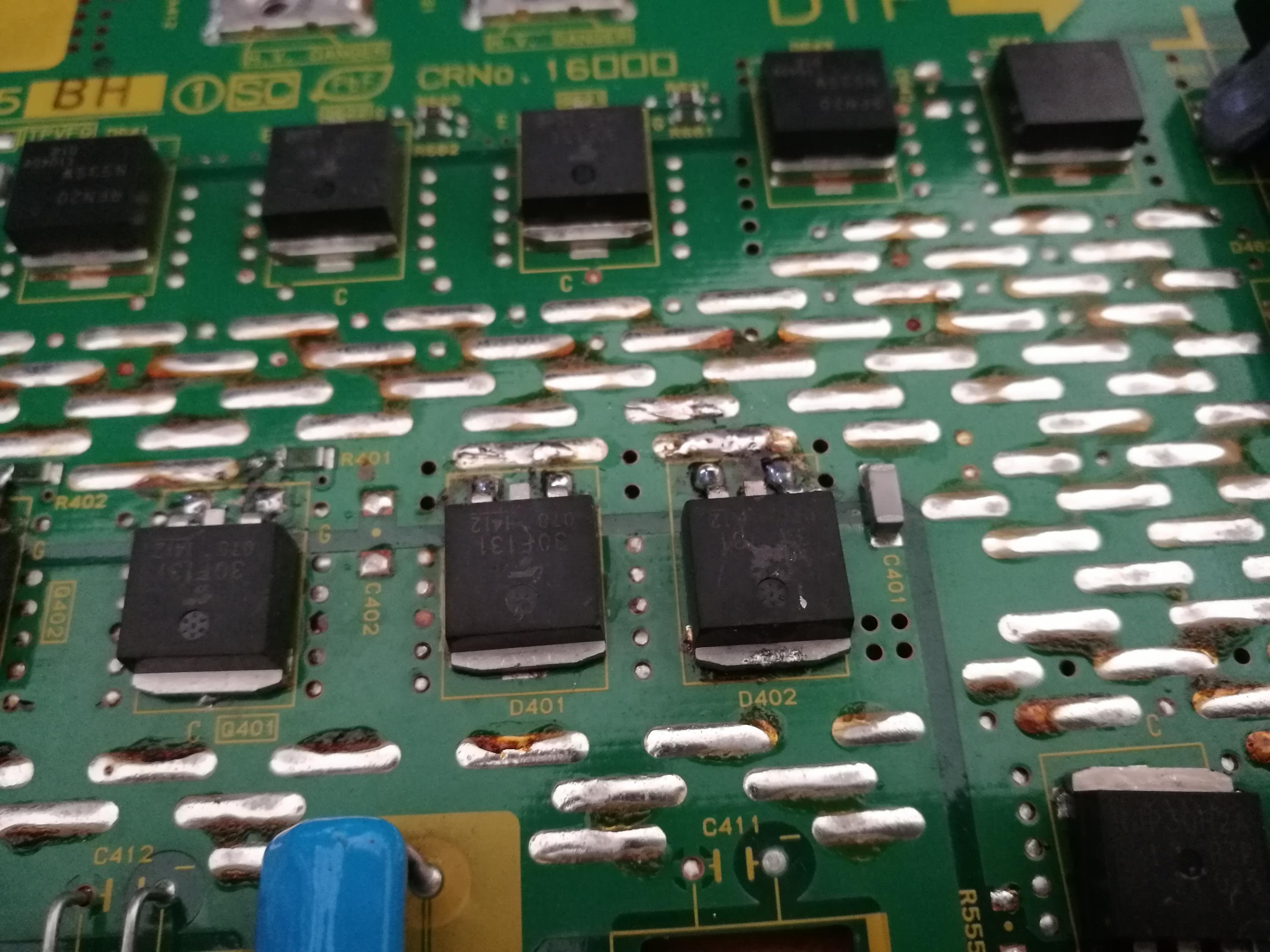

    I opened the back cover and immediately saw the bad soldering on the y-sus board. ( See pictures ).
    The tv had no standby so i checked the fuses but they were all ok. Removed both power supply's , It has a small and big one , and looked at the back of the boards and again soldering......
    I have a 50VT30 ( And other Panasonic's ) in parts so i slowly started to replace boards. Replaced both power supply's and still dead! Replaced mainboard and AAAHH , Its alive but cripple. 7 blinks as i expected with the soldering.
    So i took a closer look at the TNPA5335 and i was like , Owww boy if this tv is ever gonna work with this board i'll eat my shoes haha. First of all , the soldering. I mean seriously? If you solder like this , please quit! This is barbecuing tbh!
    This guy replaced ALL parts with 30F131 , even the part where originally was NO PART SOLDERED , he soldered a 30F131.
    He replaced RF1501 with a 30F131 <---
    Eventually , it took me the whole evening rebuilding this board with scrap boards. I replaced all bad parts with original replacement parts and i had to replace ALL driver ic's. ( IC501 / IC502 + 5 legged transistors ). I still got 6 blinks after 3 or 4 repairing attempts.
    In the end i found a short between ground and C813 , its the energy recovery circuit. Diodes 674/673 + Q661 were short. Removed Q661 and short was gone on both diodes and capacitor.
    I also replaced the small resistor in front of Q661 and finally the tv turned on! Picture is perfect.
    Will give it its first test run tomorrow and clean up the board + extra cooling. Just look at the pictures. This guy managed to get a 7 blinker so dead that i had to rebuild the y-sus board + replace power supply and mainboard.

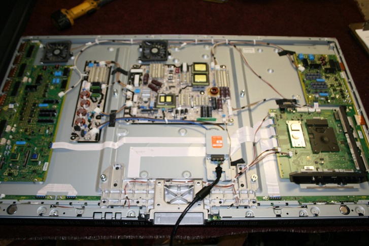

    Good work matey Got a pic of the whole back of the set ?
    • Moreno83
      • Jun 2014
      • 2008
      • The Netherlands
      Re: Panasonic TX-P46GT30 Saved from the beasts.
      Thanks m8!
      It looks a bit like this. The panel is smaller. On my tv the SC20 cable is hidden under the power supply. Will post some pictures tomorrow!

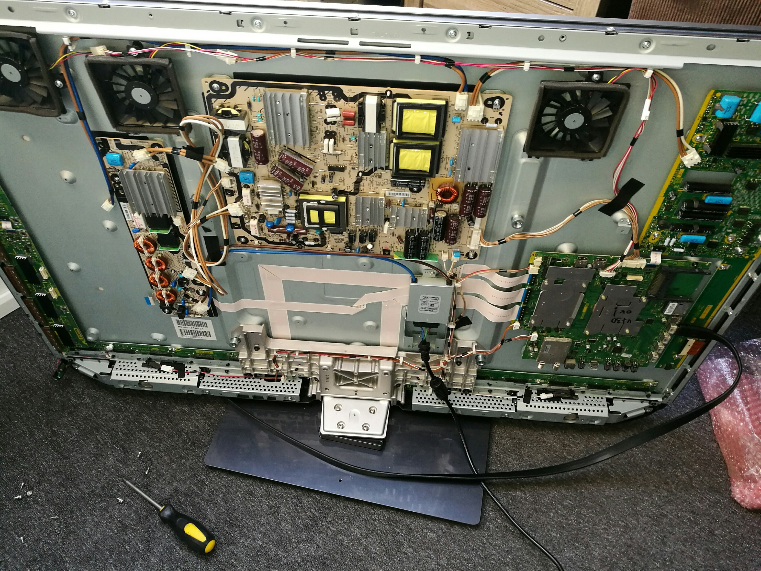

                  My
                  TX-P46GT30 has three fans, the other one being over
                  the SS board
                  Alan.

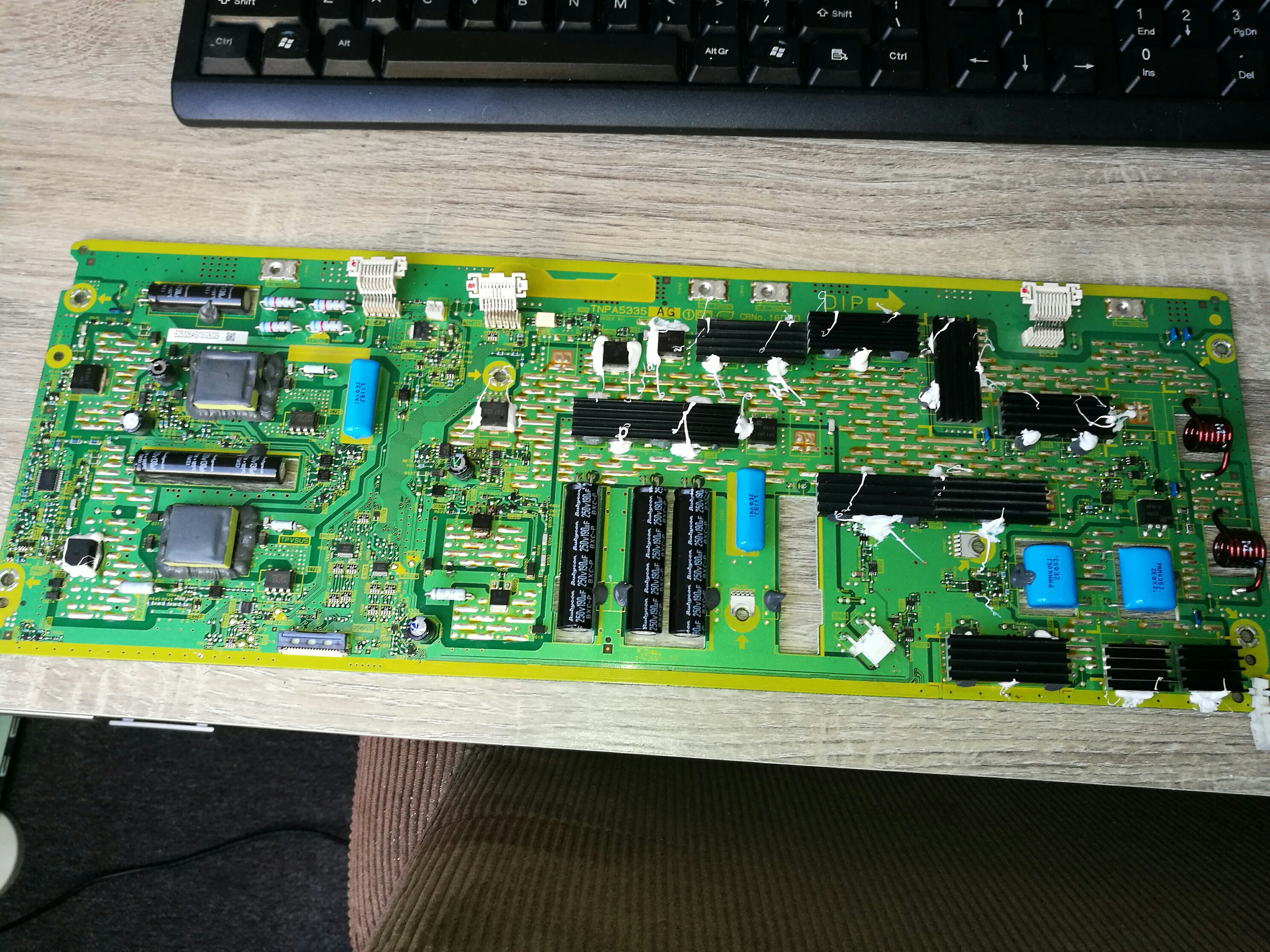

                    Picture of the final board and the back of the tv. Board was butchered but in the end i cleaned it as much as i could. Added heatsinks with thermal plaster.
                    The wire between the powersupply's was damaged also , replaced it with a longer one.
                    The plaster and heatsinks on the board does not look pretty but its very effective. Tv runs very cool compared with the original board.
                    Anyways , tv runs perfectly.

                      I think you were conservative with the word "longer".
                      • Moreno83
                        • Jun 2014
                        • 2008
                        • The Netherlands
                        Did not have a shorter cable and the original was damaged. This works fine though.
                        Just looking at the board ..... i could have done this a bit cleaner. To much plaster , ow well next time.
                          I am trying to workout how you repaired the TNPA5335 BH board in the first photo but made it into into a TNPA5335 AGin the last ? now that is a good trick,got me beat how you did that . I know we all get magic smoke from time to time, but it has never done that for me ,and I have seen a lot of it ( magic smoke that is ) when i first started repairing some of these boards
                          Flocko
                          • Moreno83
                            • Jun 2014
                            • 2008
                            • The Netherlands
                            Then i uploaded the wrong picture haha! Will upload the right one tonight
                            I got like 8 of these boards which i take pictures off! Haha ooops
