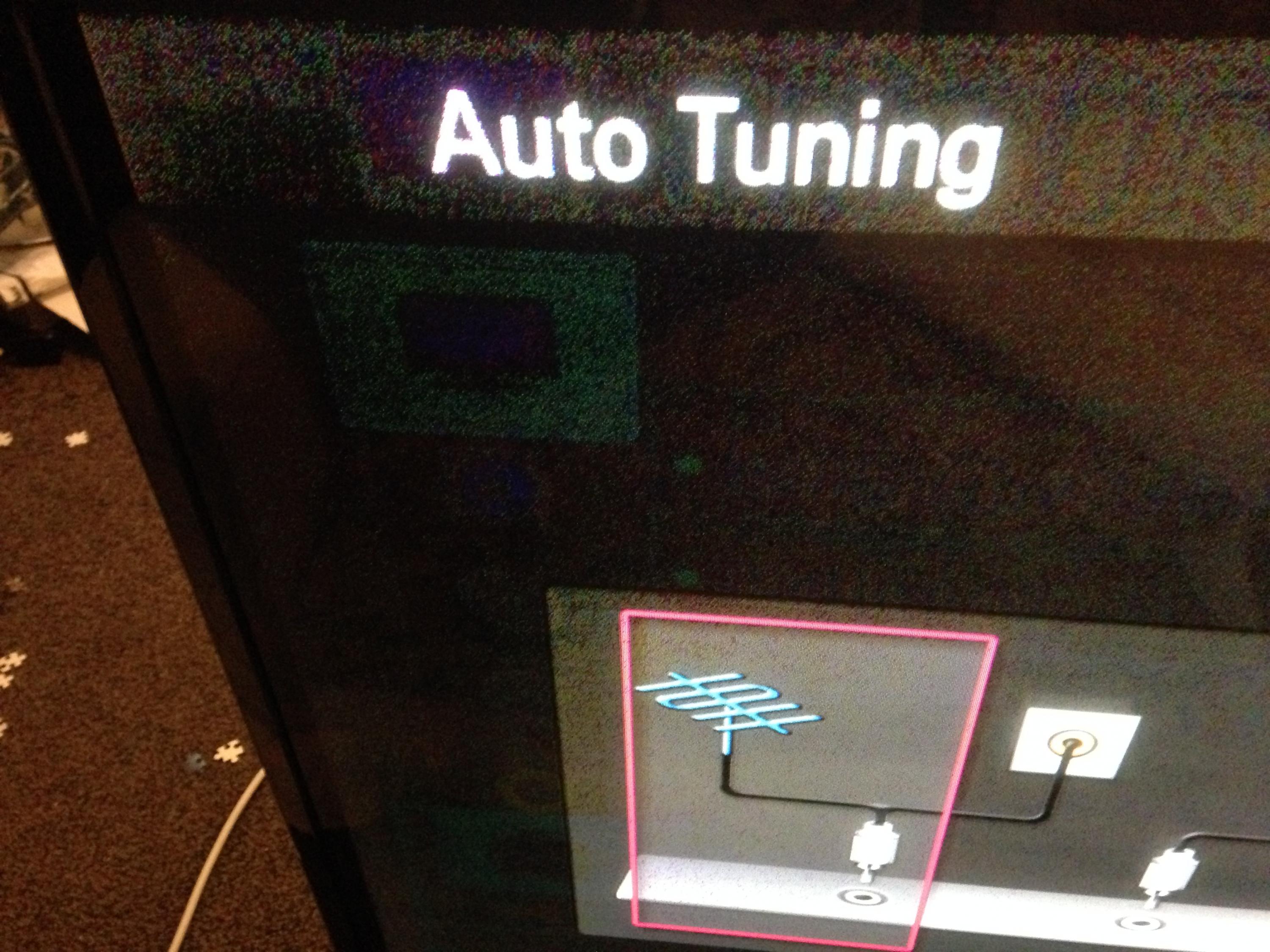

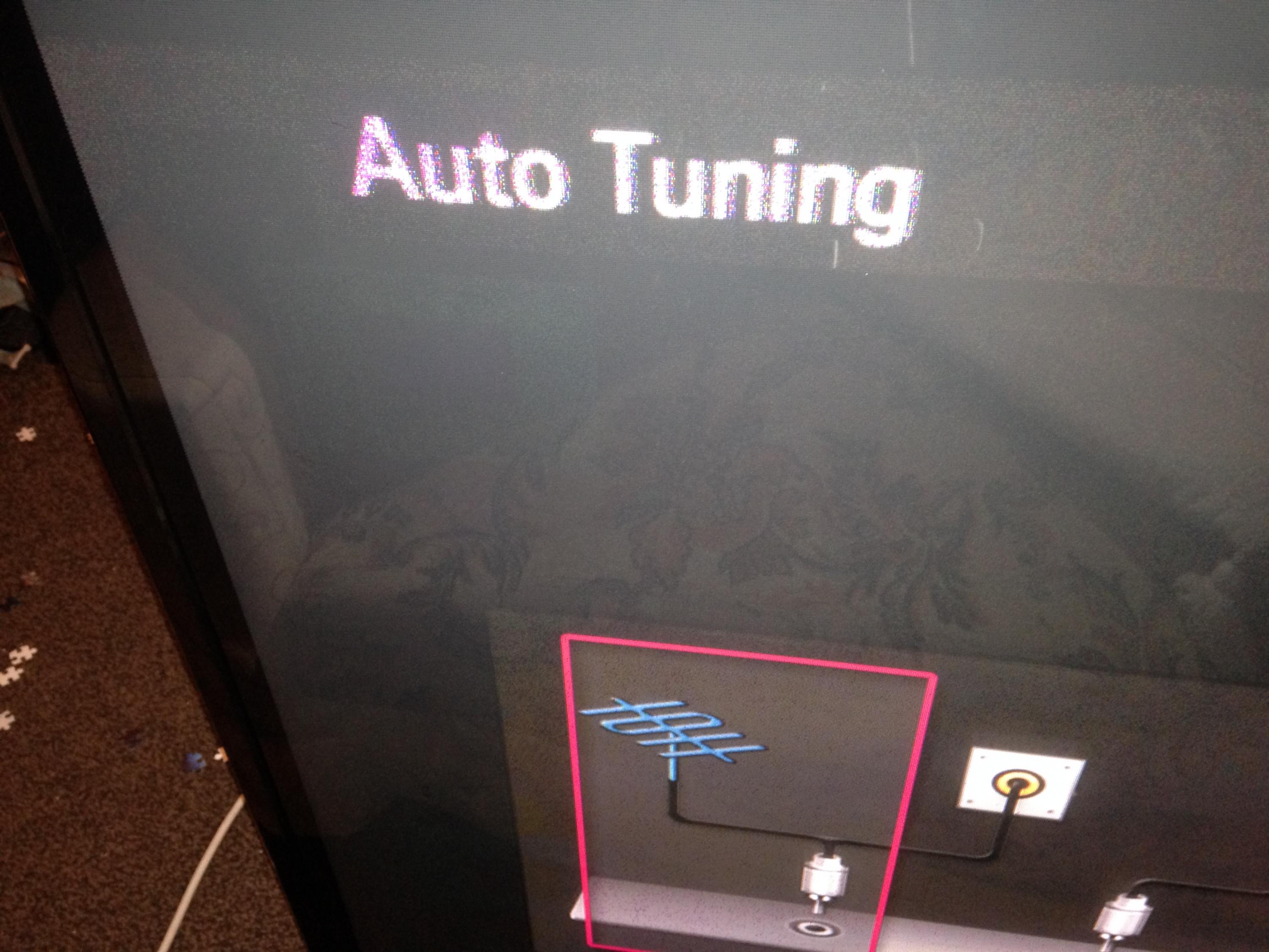

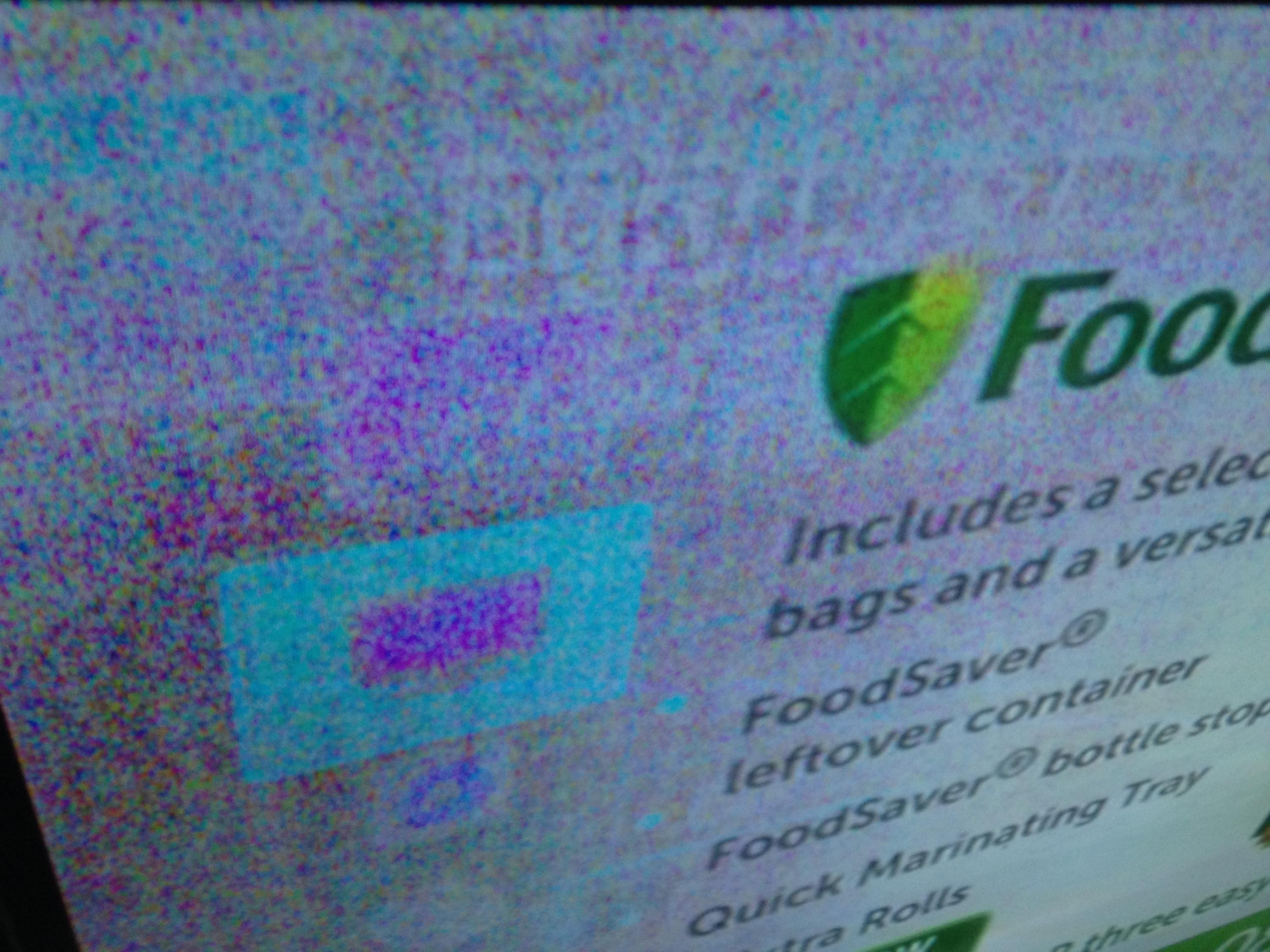

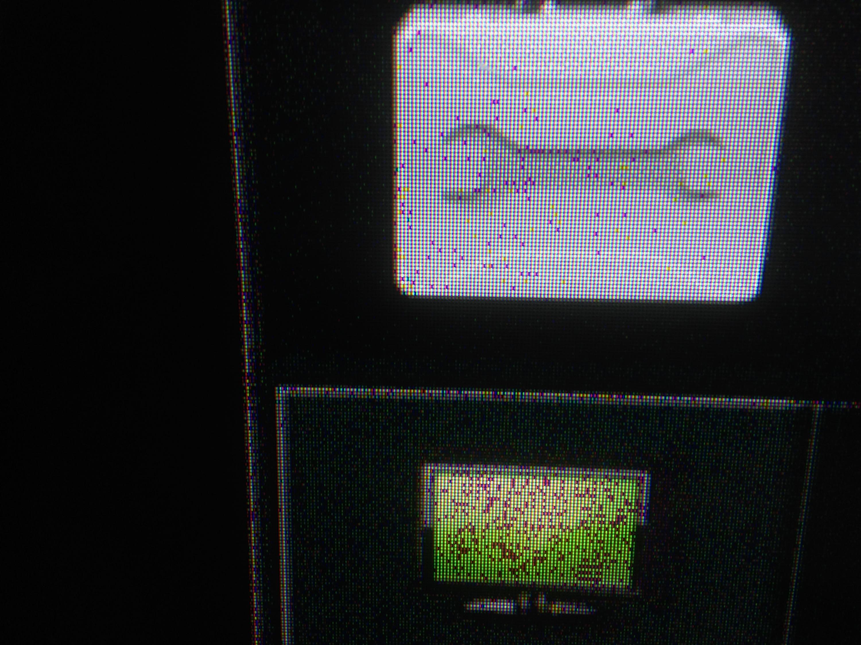

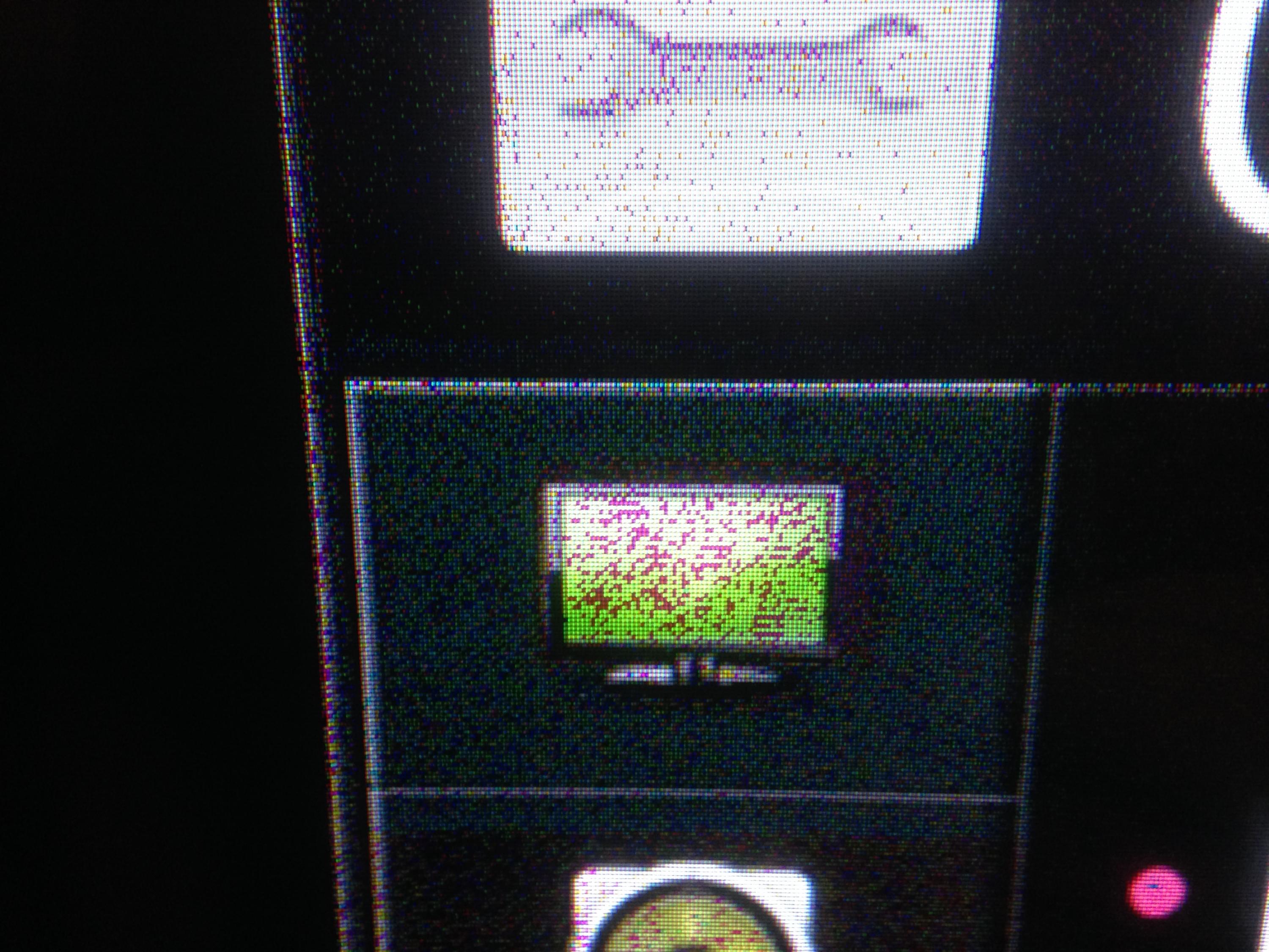

    The above tv stays on now thanks to help from some badcap members . But after the Y sus repair I am getting pixels that take a couple of seconds to go and are several different colours -please have a look at the photos I have attached.
    I have run the test patterns and its evident to a degree.
    I have adjusted the set up and dn without any success and all the voltages are as follows
    va 55
    vs 205
    vy 181
    vzb 135
    Any help would be appreciated (I have reseated the ribbon from the main board to the tcon several times, tvs still the same)

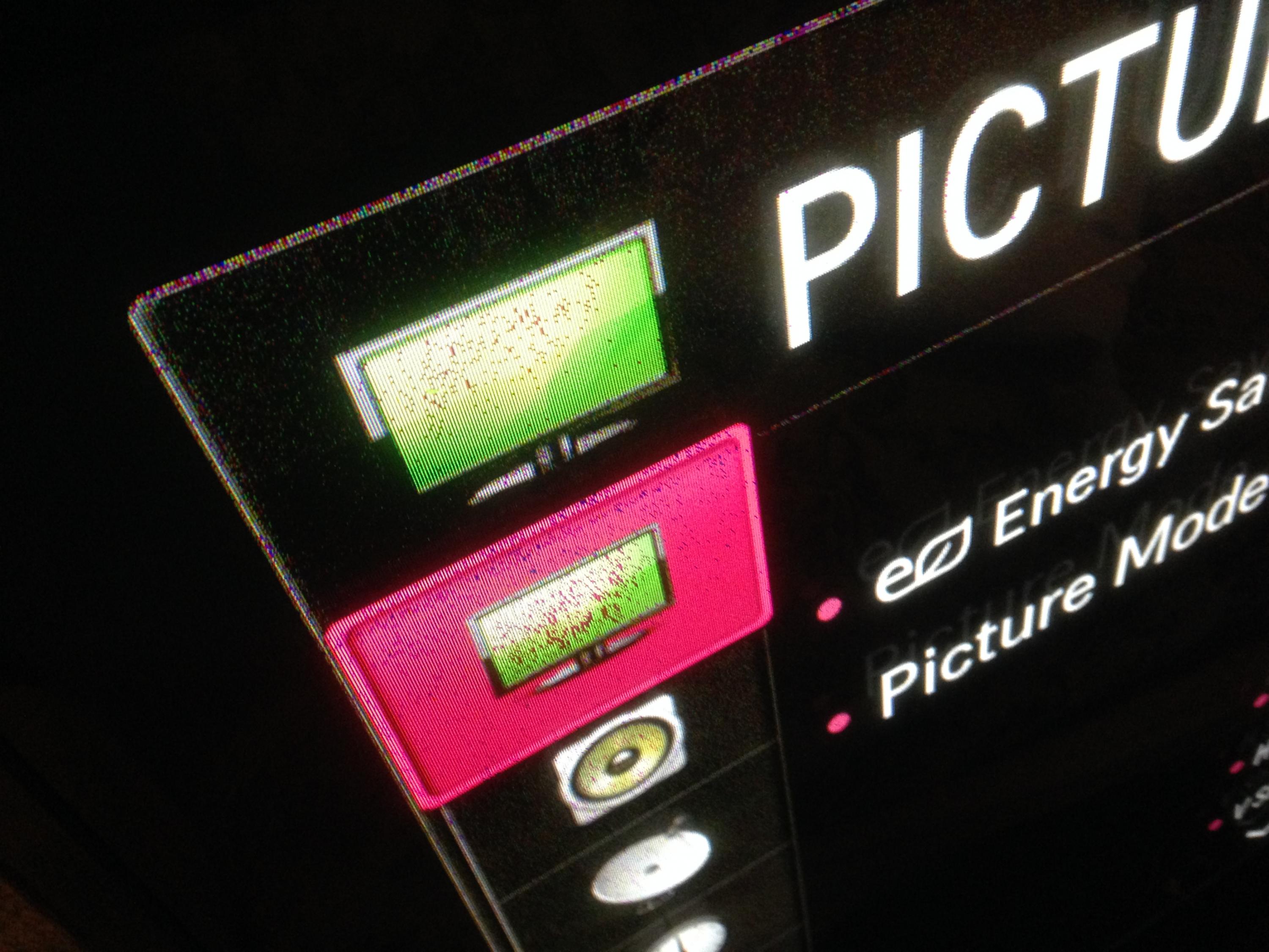

    What I found strange how the tv retains image of the tv settings menu please see last two photos

  • maxvalutech
    • Dec 2014
    • 804
    • australia
    Re: lg 60pb660v plasma tv
    Image retention (IR). Turn down contrast brightness etc and display only moving pictures not static images. A web search of this problem will assist you. Are there any other adjustment buttons on board other than vs va as a minor tweak can quickly affect pixel display. Plasma burn-in period recommended anywhere from 100-250 hours operation without static images or lots of black screen.

      • ReeceyBurger123
        Never Give Up !
        • May 2014
        • 7325
        • Britain
        Looks like Zsus issue to me, whats Zbias running at ?
        Edit: my bad just seen Vz is good, remove the Zsus and check for cold solder joints on the ERC coils.
        • ReeceyBurger123
          Never Give Up !
          • May 2014
          • 7325
          • Britain
          Thats not Ir at all thats improperly charged cells meaning Sus board issue.

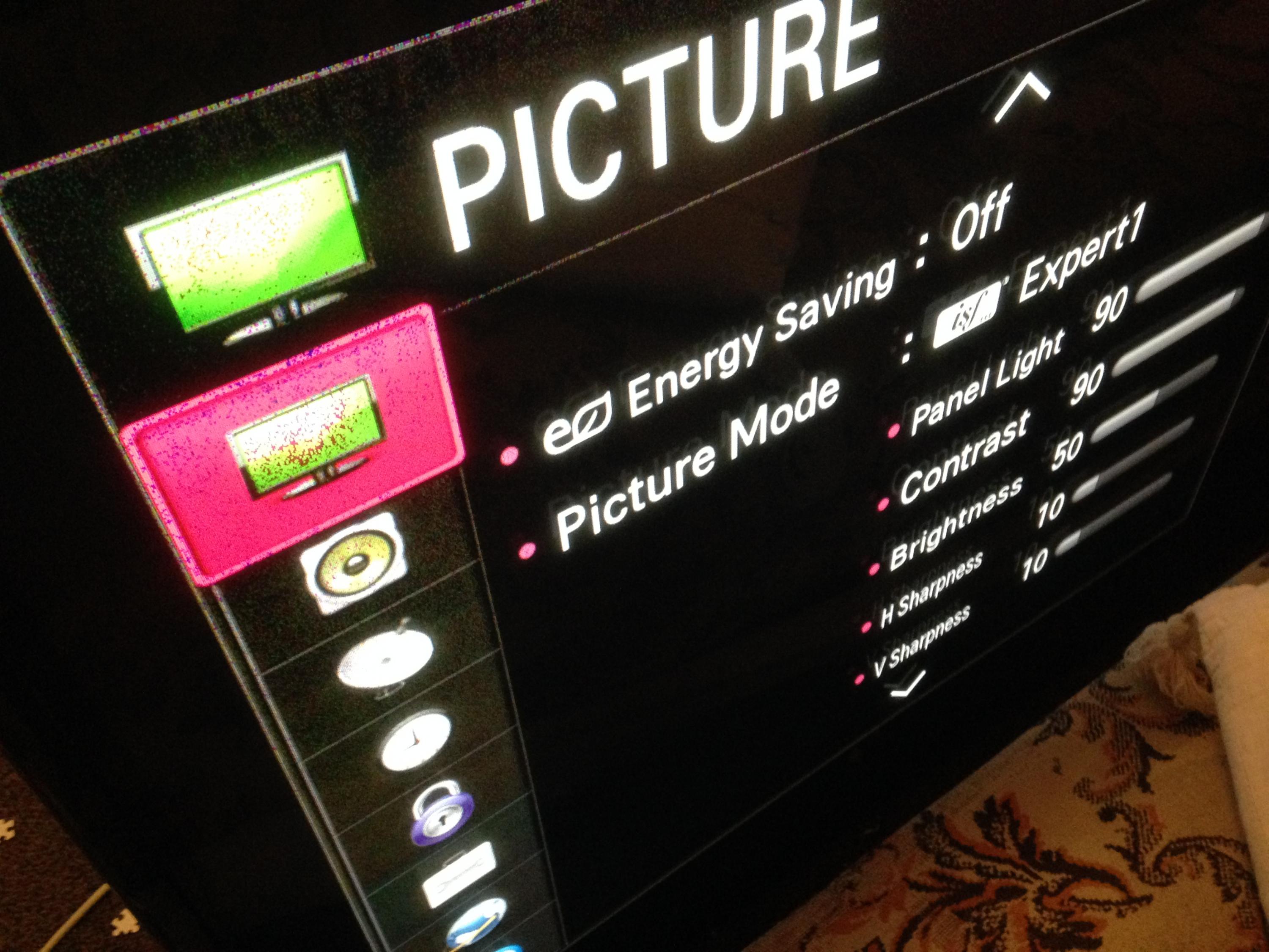

              Respect other comments but your pic shows contrast set at 90 to start with and energy save is off. Suggest factory reset as a starting point for settings and then analyse. How old is the set?

                • thuss
                  • Jul 2012
                  • 321
                  • uk
                  Those were just an initial couple of photos, I did a factory reset, I also software updated it and resoldered the joints on the z sus there was only one coil but everything looked fine.
                  The contrast, brightness have all been decreased but still no difference.
                  I think I will change all the mosfets on the y sus/replacing the y sus failing that I'm stumped any ideas would be appreciated?

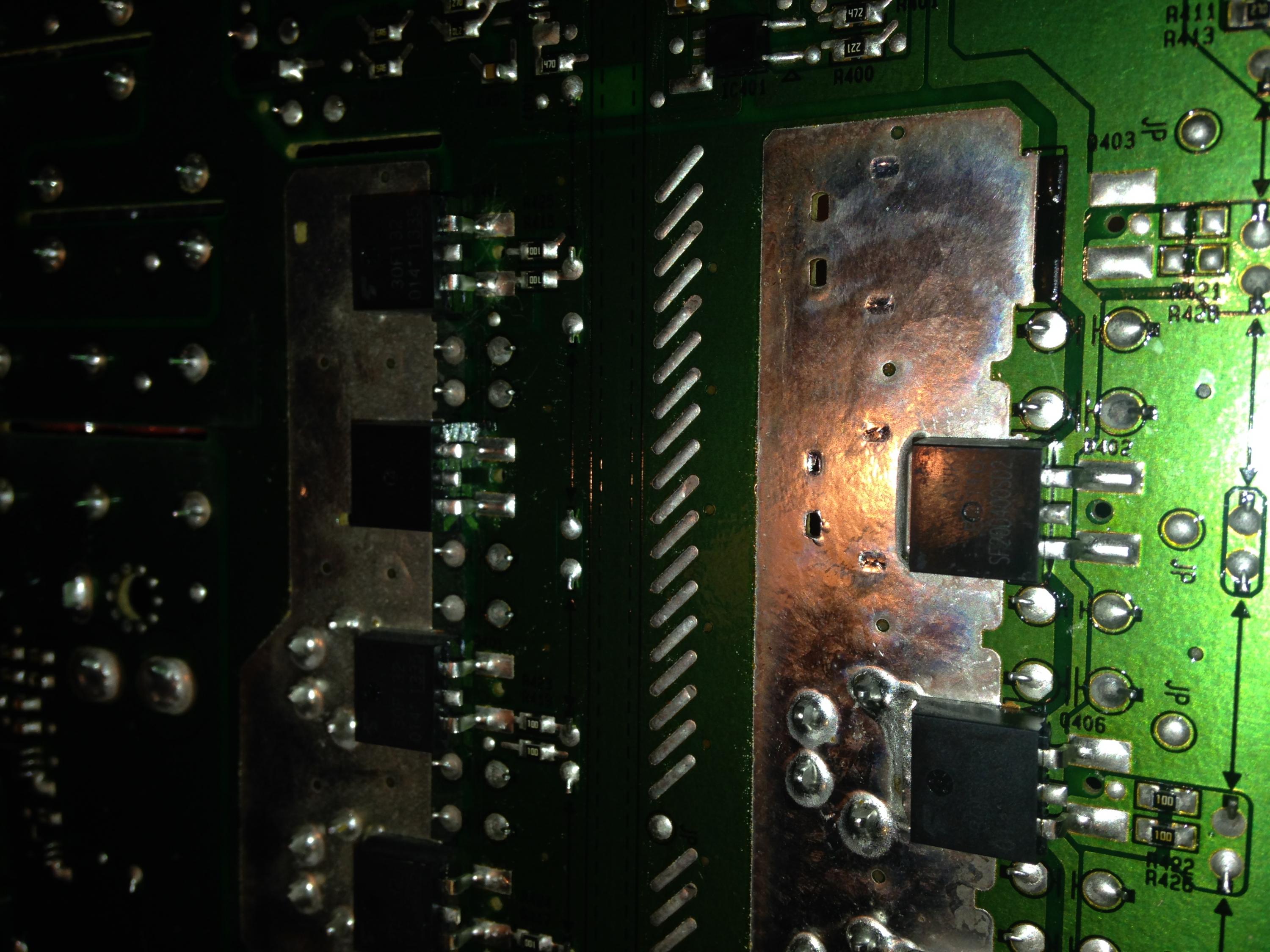

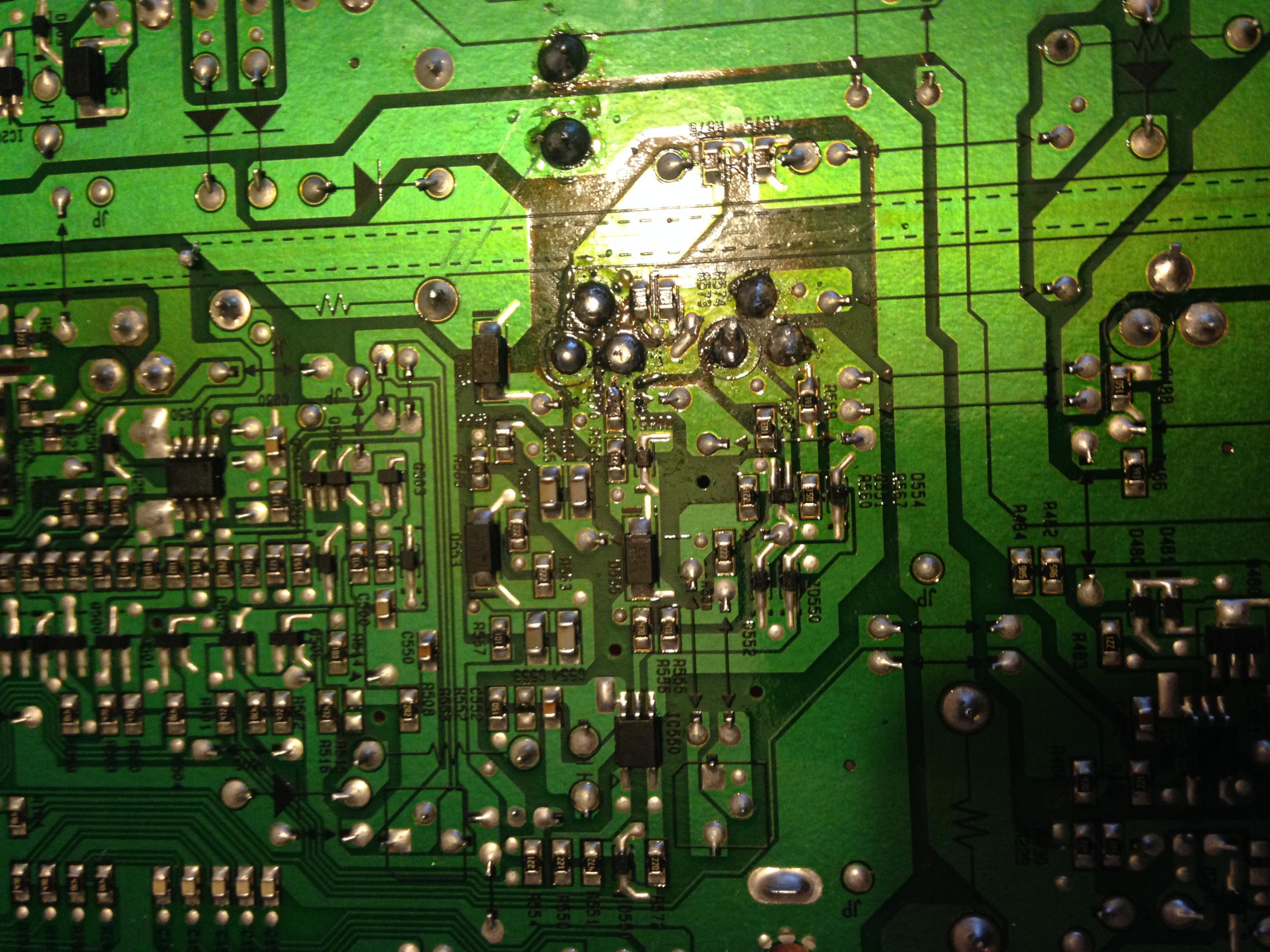

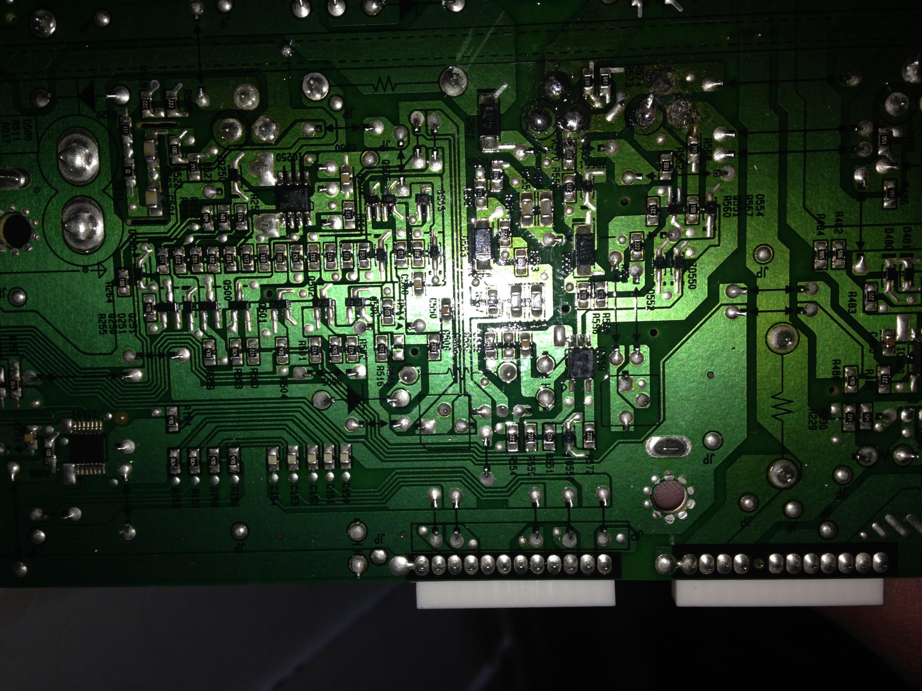

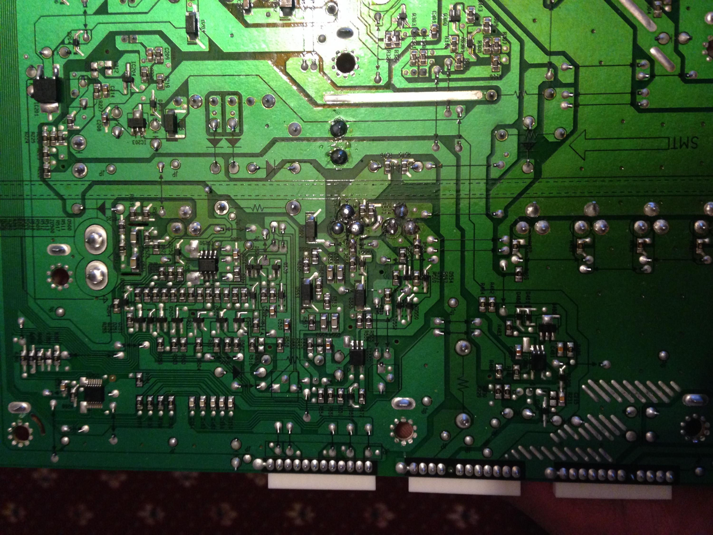

                                    • Hamie
                                      • Apr 2014
                                      • 1383

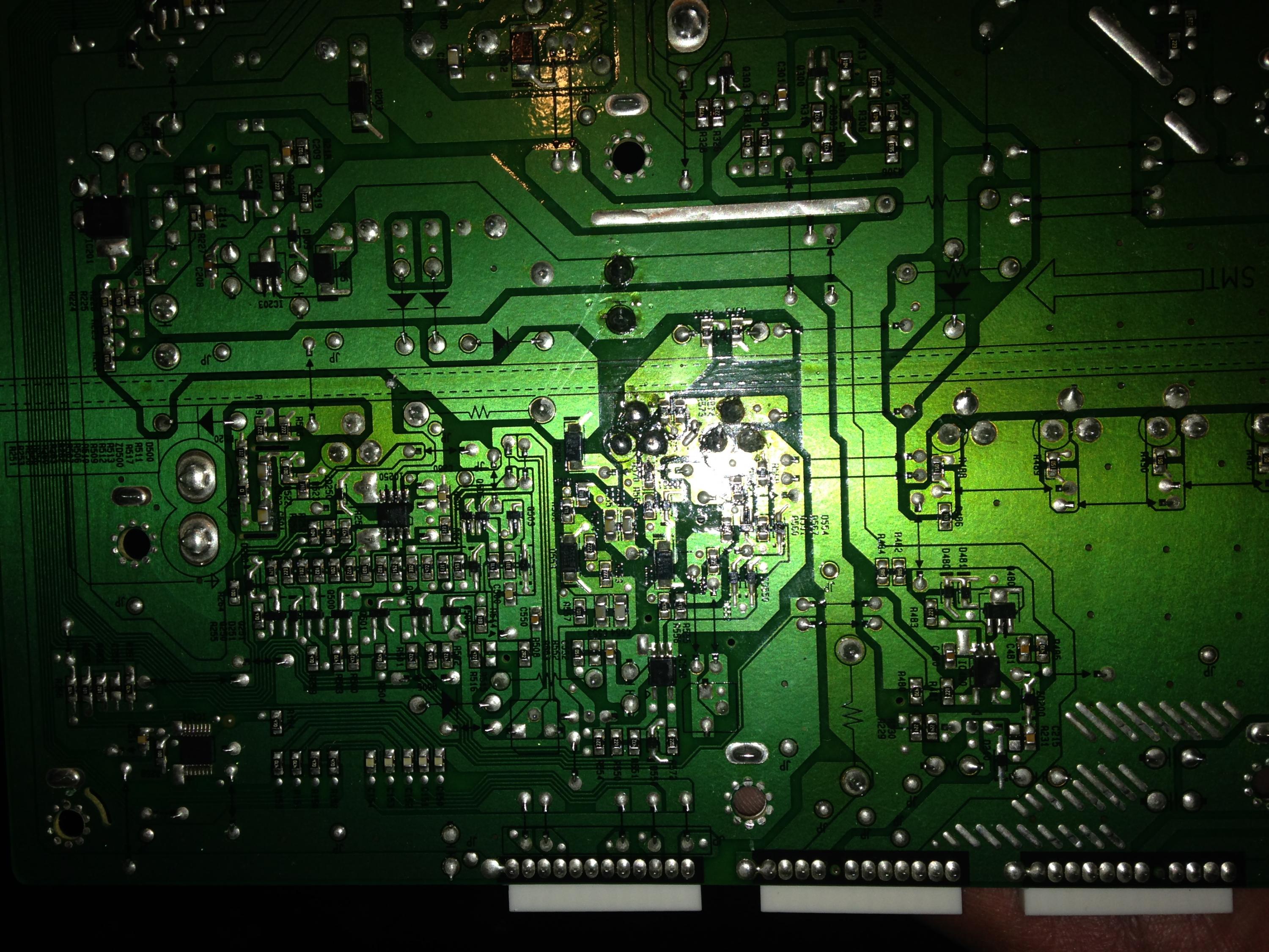

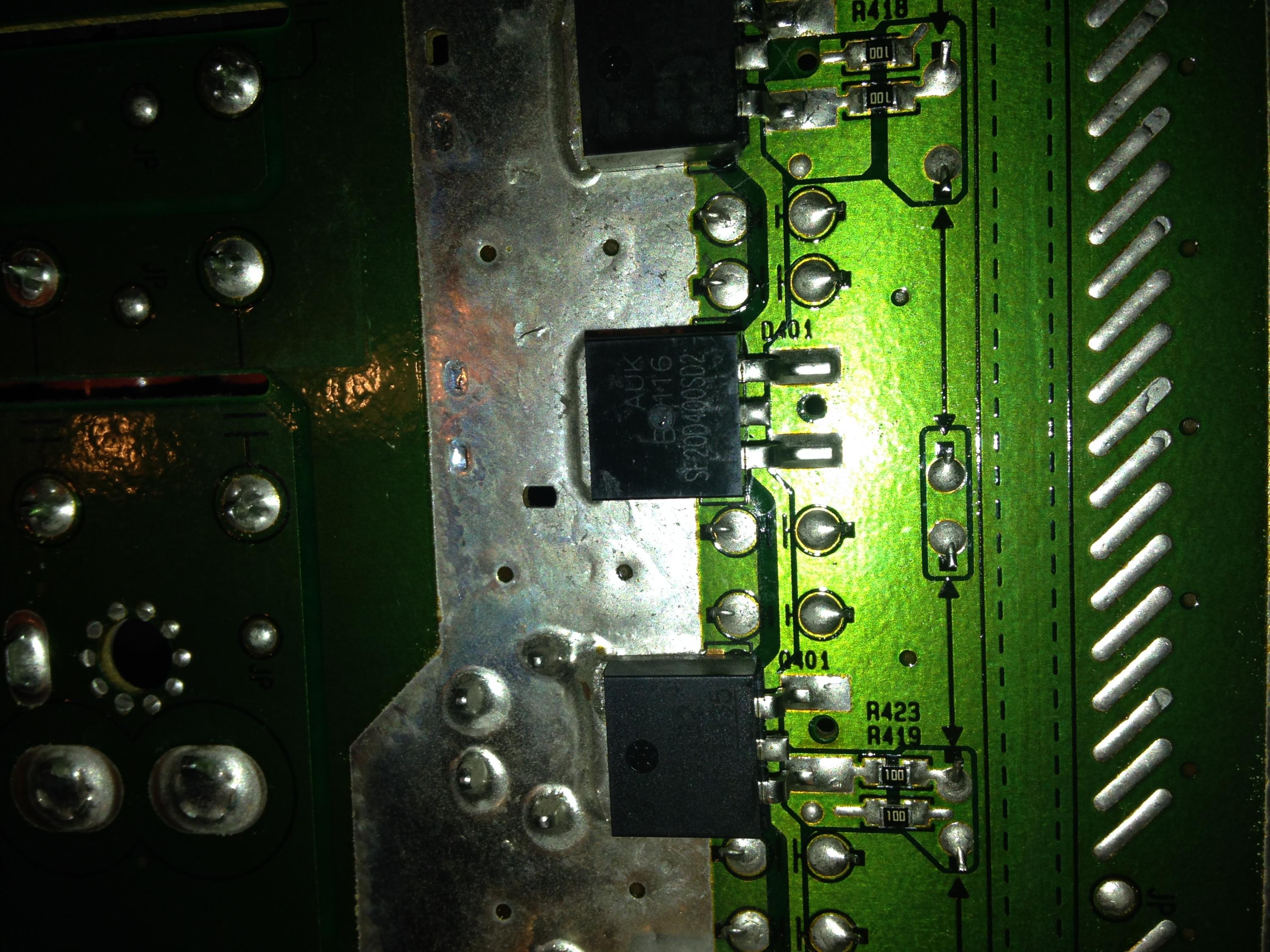

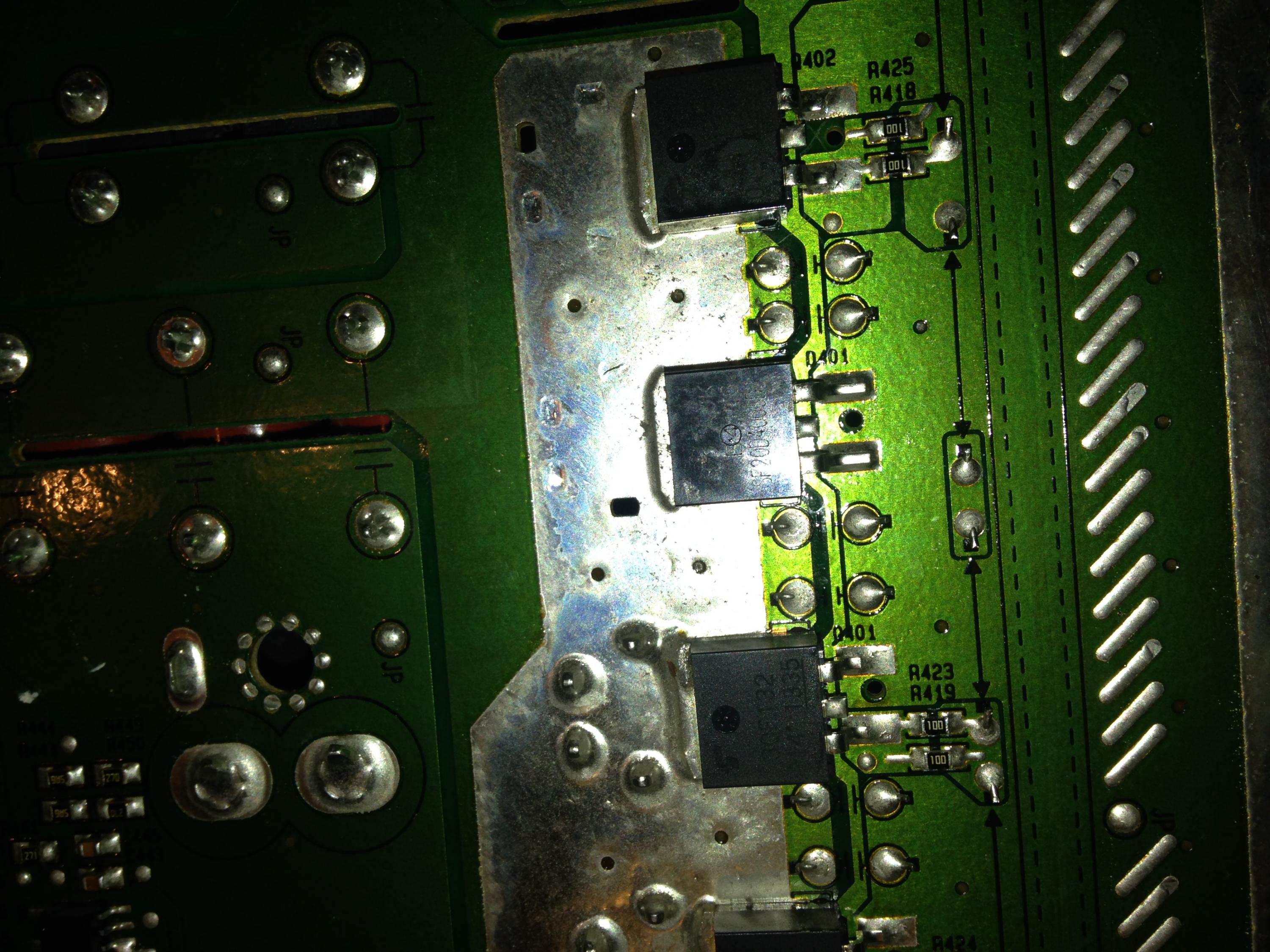

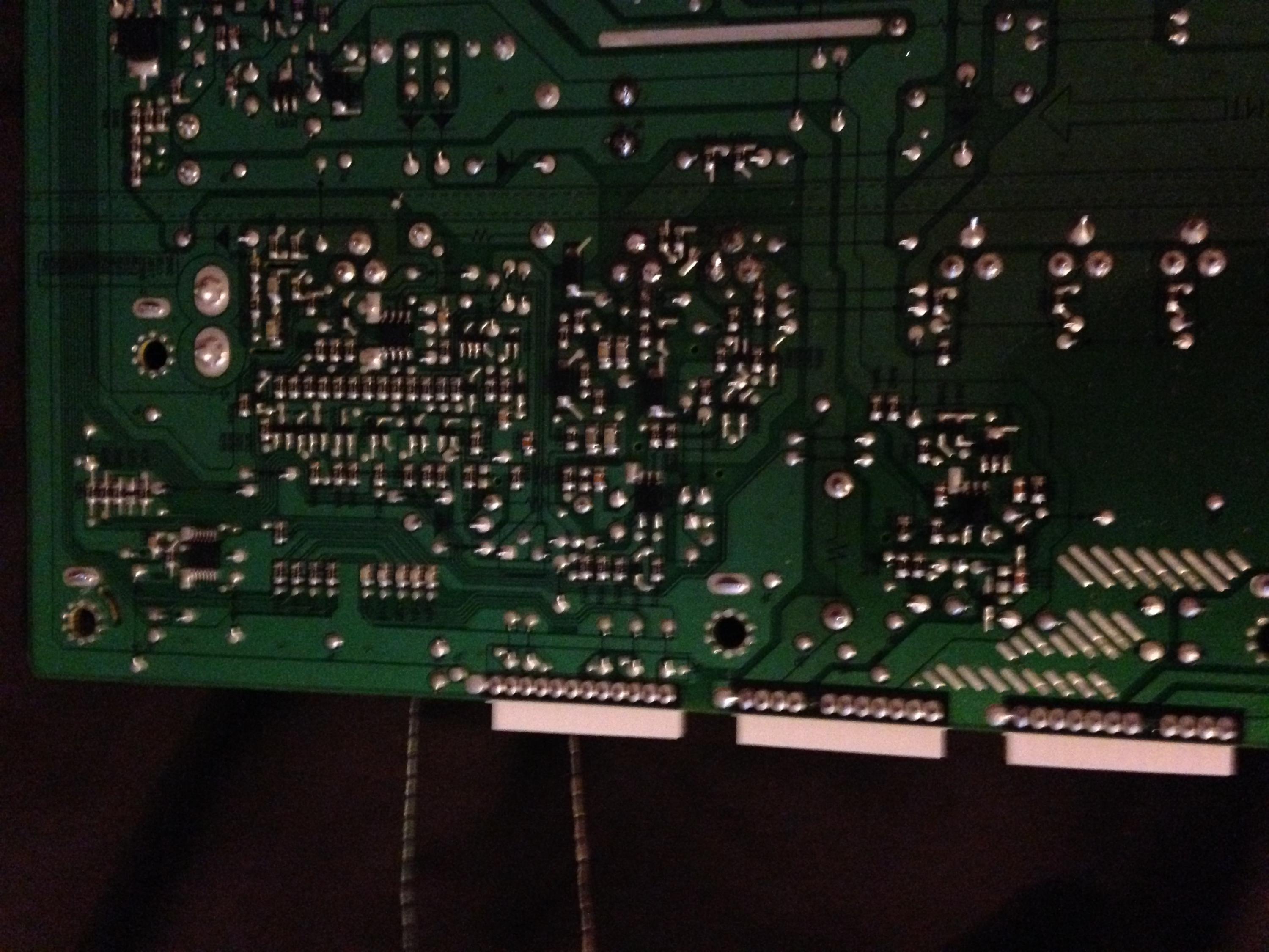

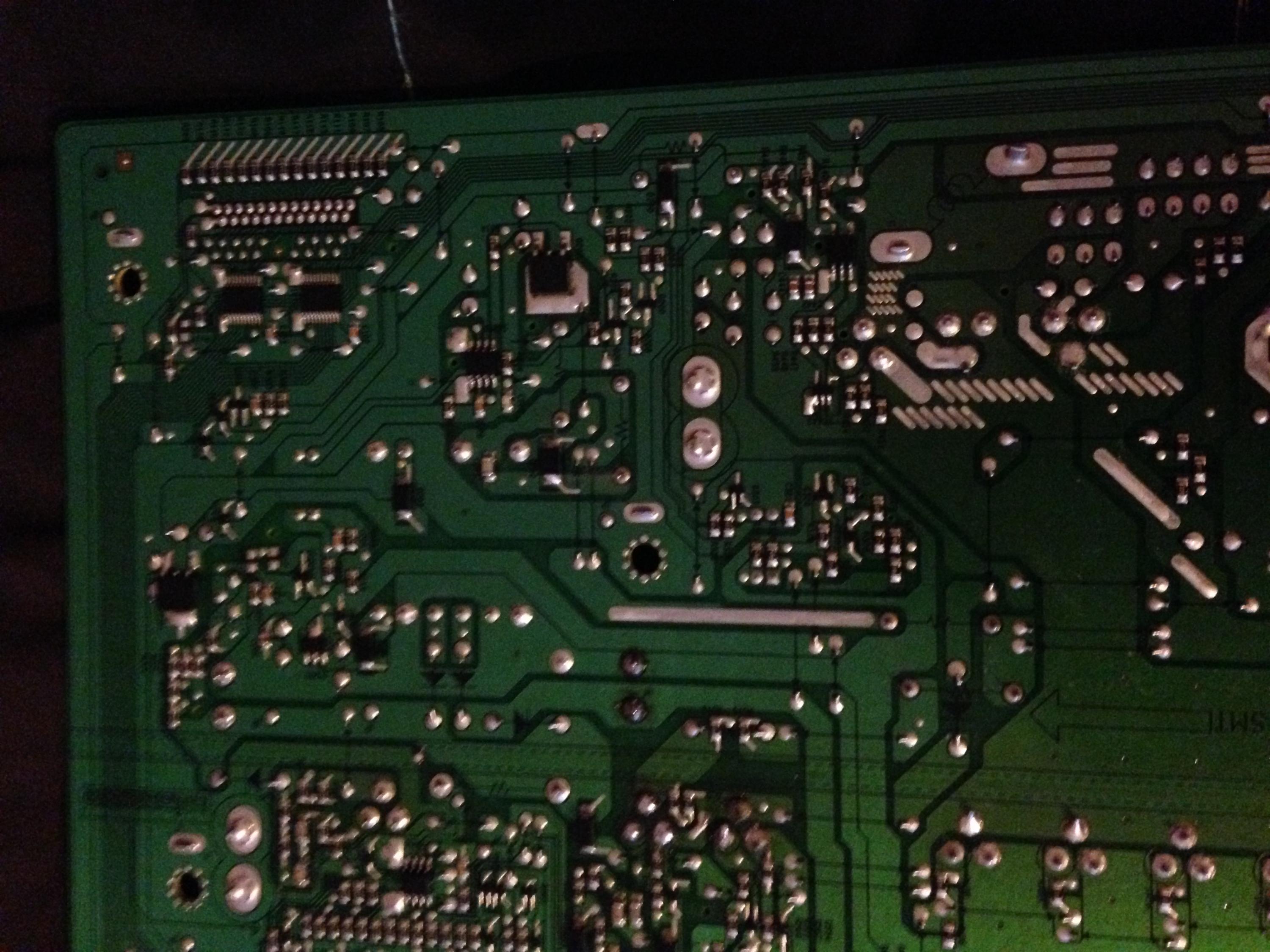

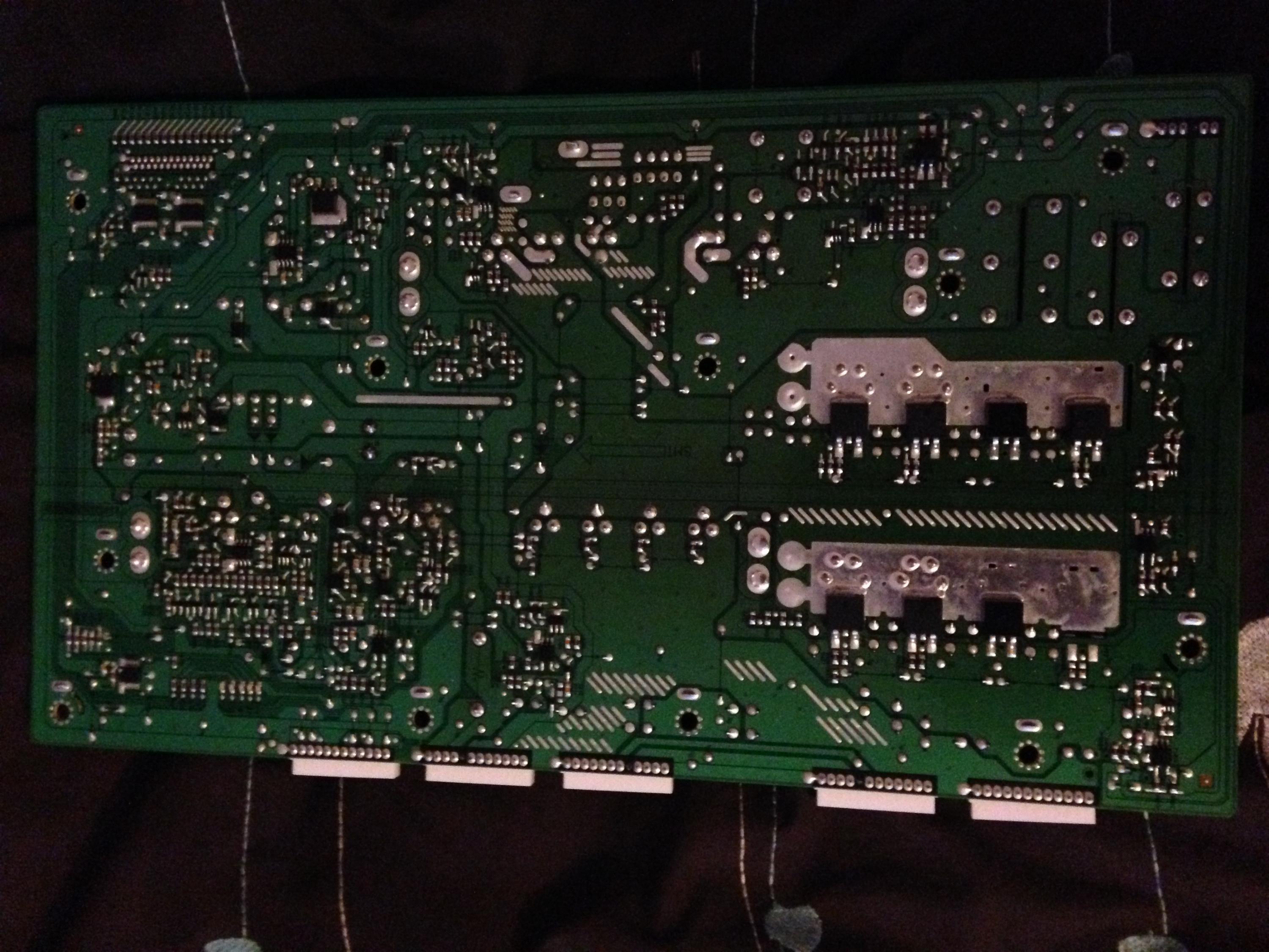

                                      Take a photo of the circuit where you have replaced the FETS (underside of the board)
                                      • thuss
                                        • Jul 2012
                                        • 321
                                        • uk
                                        Sorry about the poor soldering -genuine soldering iron failure, heating it upon a cooker.
                                        Its not q402 etc. YD.they look ok.
                                        I'm not sure on this. I replaced q552 and q553.
