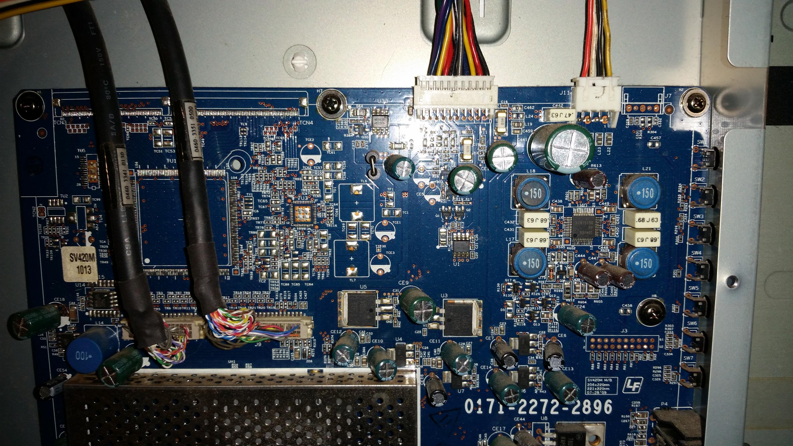

    Im working on a VIZIO model SV420M, according to my buddy it just quit working and never had any warning signs before it failed. I opened it up and when plugged in it has 5.1v standby voltage, but when the power button is pressed the power supply doesn't fire up. Can anyone point out some possible problem areas for me to check? When i force the power supply on all voltages are present, so i think this may be a main board issue. Thanks for any and all help.

    Heres the board in question.

      Check if the main board returns PSon on the PSU. No PSon = main board problem.
      These sets are known for bad voltage regulators on the main board. So check those if they are putting proper voltages out.

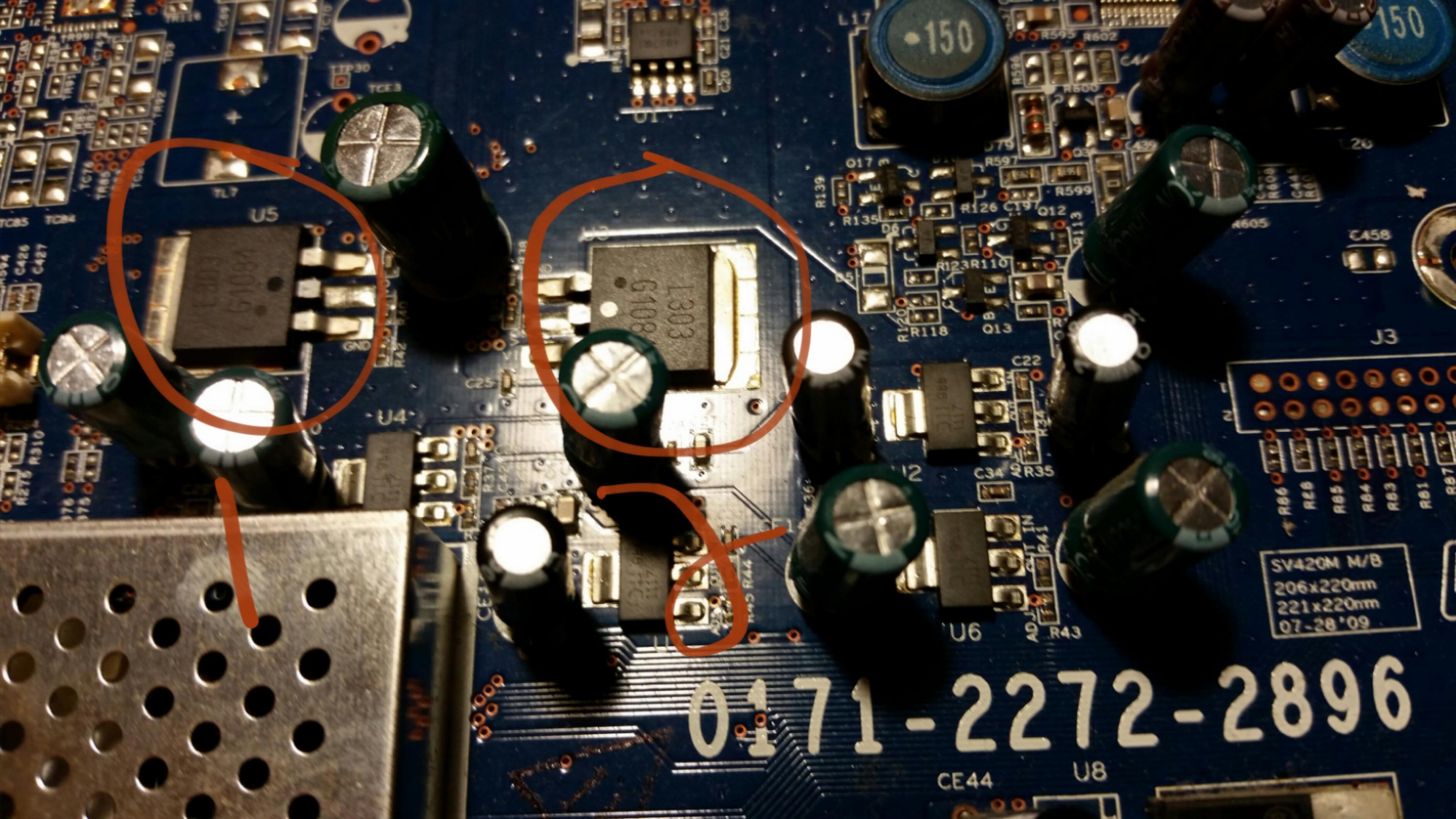

          I can't see what like U6 or U3 is. Anyhow, get the numbers off them, get the spec sheet so you can see the pin out and post the stuff here which regulator, the number printed on the regulator and the 3 pin names you measured (in, out, adj).

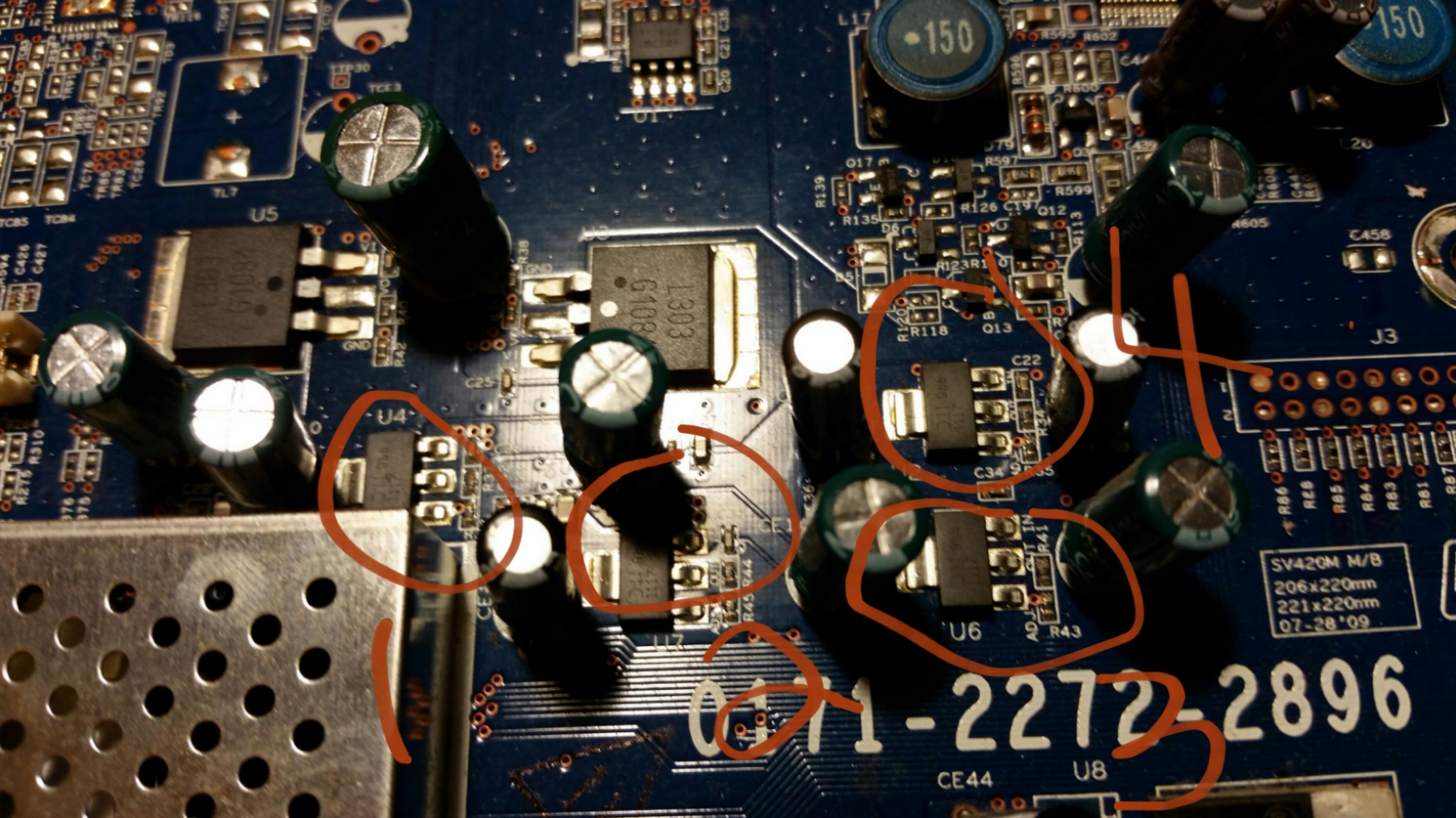

                  I cannot identify the components in u2 u4 u6 and u7 they are all the same, and appear to have 1117 966 D11 printed on them

                    Those are 1117 voltage regulators.

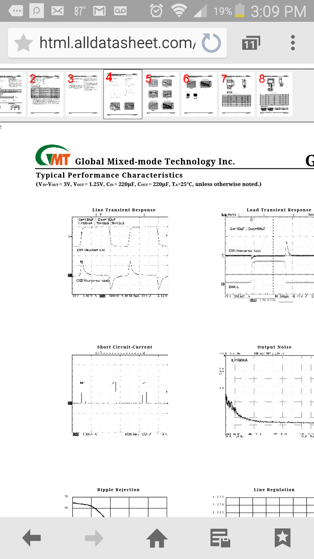

                      https://www.badcaps.net/forum/showth...999#post300999

                        Can you give the readings on the pins of each of the regulators.

                            Gnd/adj 4.3 mv
                            Out 1.42v
                            In 3.29v
                            Gnd/adj 2.07v
                            Out 3.32v
                            In 5.012v
                            Gnd/adj 6.91v
                            Out 8.17
                            In 12.20v
                            Gnd/adj 2.05v
                            Out 3.305
                            In 5.86v

                                  Gnd/adj 4.3 mv
                                  Out 1.42v
                                  In 3.29v
                                  VOUT is normally GND/ADJ +1.25V which for the others (2, 3 & 4) is correct.
                                  I would expect this to be 1.25V out

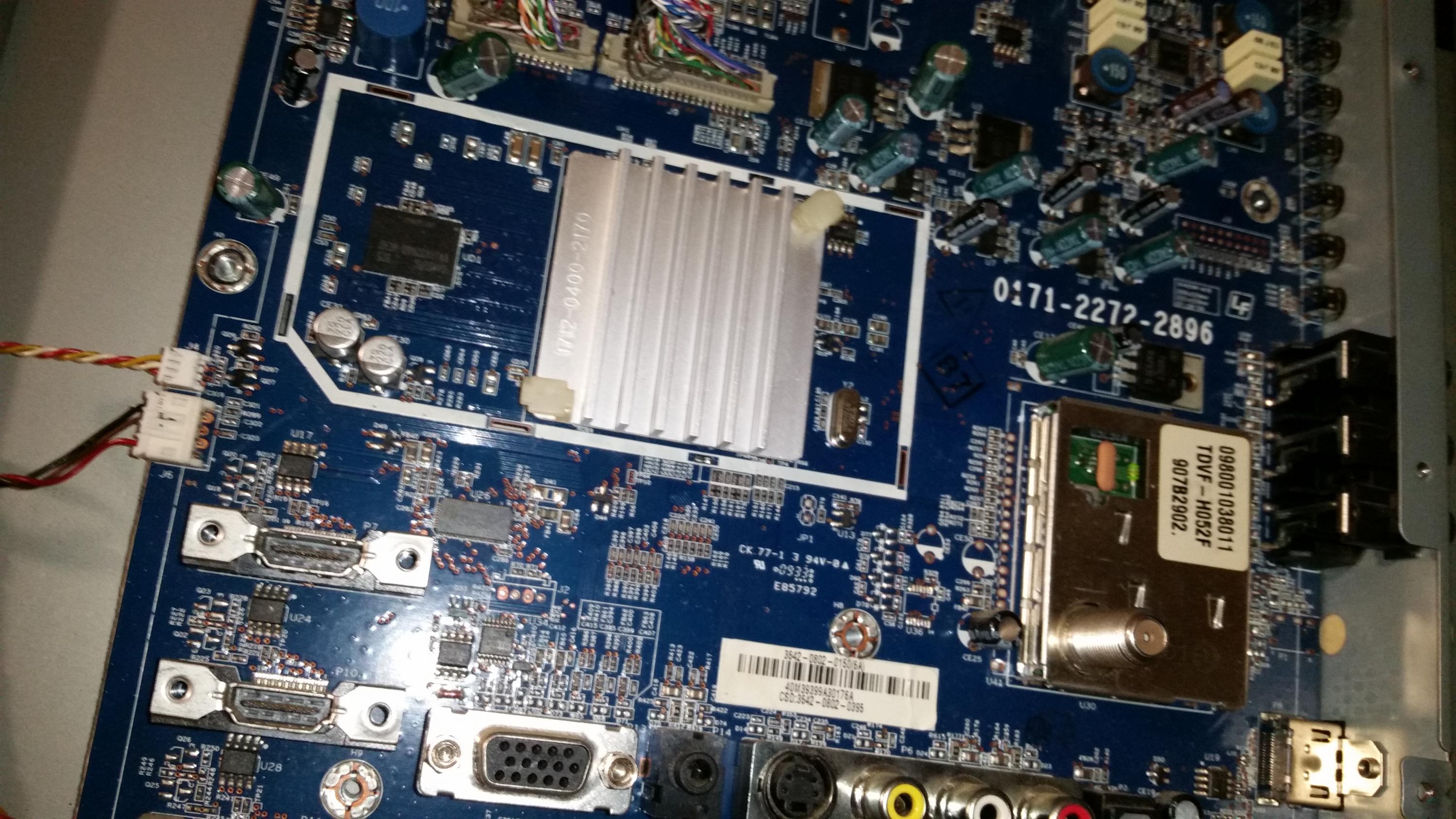

                                    I did also notice that the bga chip on this set gets smoldering hot even though the set can't power on. Is this a sign that there might be a bga issue?

                                      My friend decided to buy the board istead of repairing, but i'm asking for future reference, i always assumed that such a chip should be inactive untill the set is booted. Its the chip under the cooling fin in the pic.

                                        Quite possible that the bga chip has gone north. If it's that hot it may have lost some of it's connections to the main board which is one of the problems that is discussed quite often on the forum.
