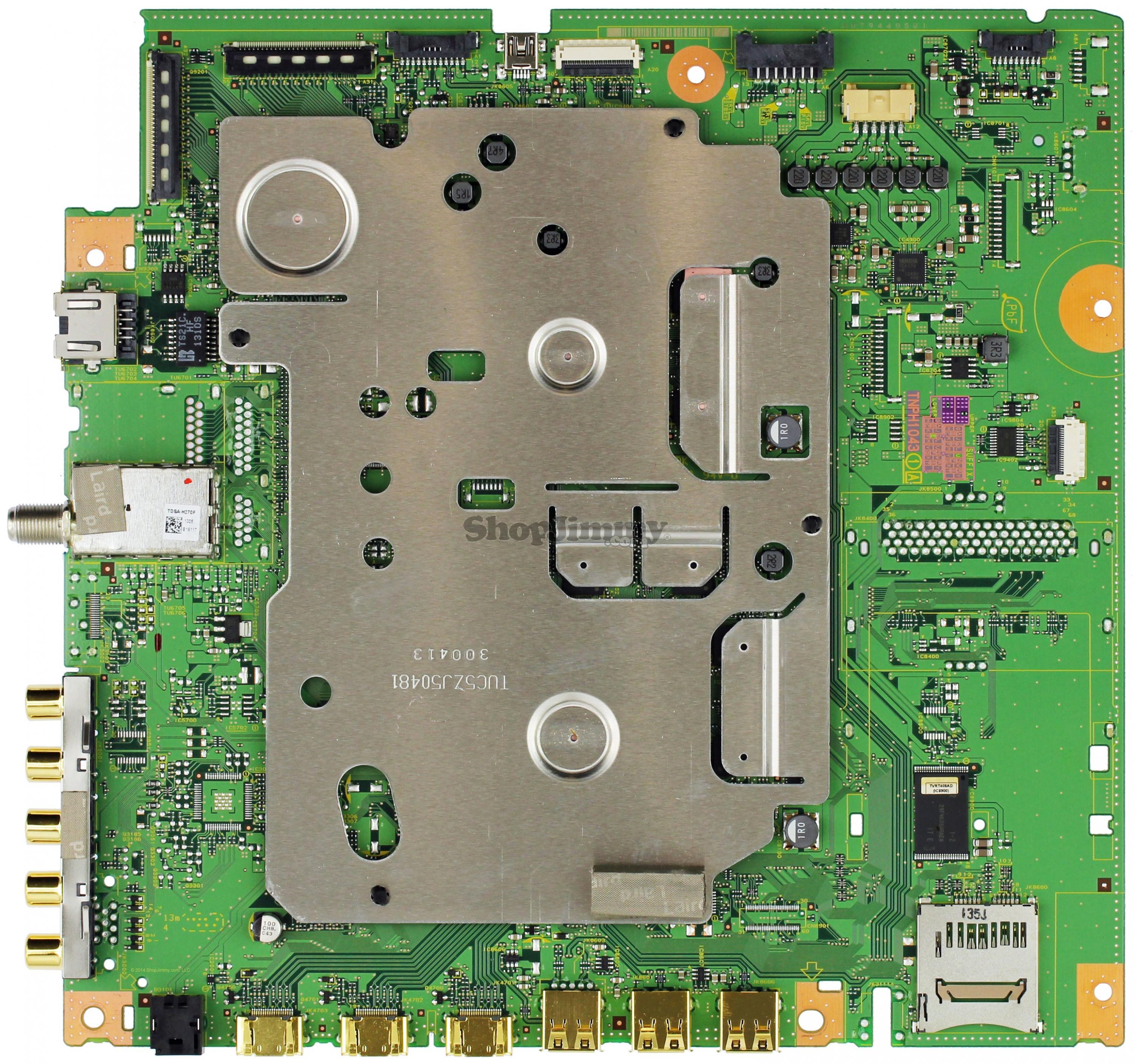

    Here you go! It's from a friend of mine , he has 2. Suffix sticker might be different.
    https://www.tvonderdelen.nl/detail.p...3%20&language=
    Thank you Moreno83!
    But i am afraid there are to many physical differences for this card to be compatible

      Re: Help! My Panasonic TC-P65ZT60 wont turn on!
      Ok , so the board on the right from shop jimmy is the exact board you need?

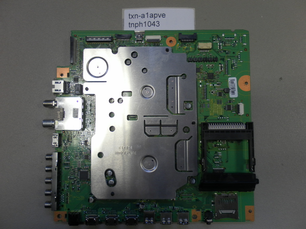

        I can't find the ZT60 board , only the VT60.
        http://www.ebay.com/itm/TNPH1043-TXN...QAAOSw0fhXkoXC
        The ZT60 might have some extra options but the VT60 board should work. There is no different audio system , just speakers connected to the board. Maybe the Vt60 board is bad?
