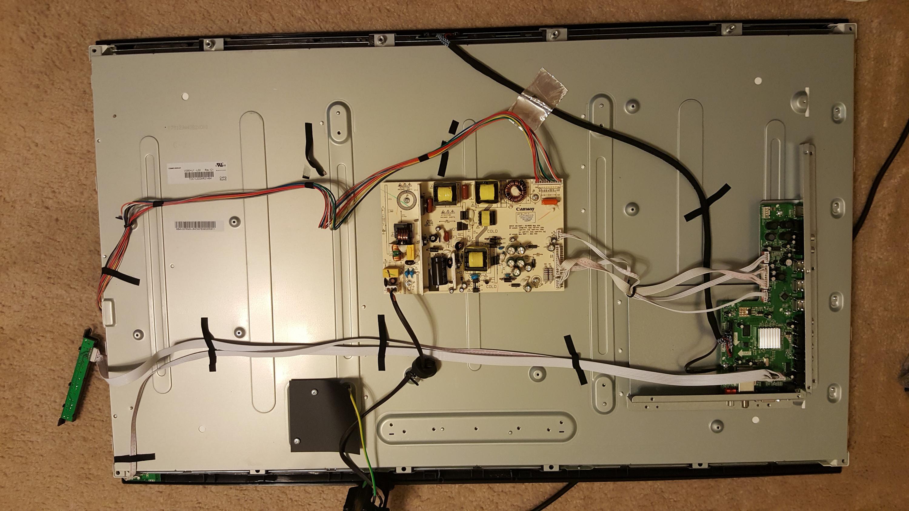

                  Re: Sceptre 409BV-FHDU8HJ1L02 dead
                  Can we see the whole back side of the TV showing ALL the boards?
                  I believe the inverter board for the CCFL is INSIDE the panel.
                      Here is a picture of the whole back. The individual boards can be seen in one of the first posts, but if you'd like, I can take additional ones.
                      Between VBL +/-, there is 0V registered with me turning it on and off.
                        Well... you have to get at that inverter board on the left.

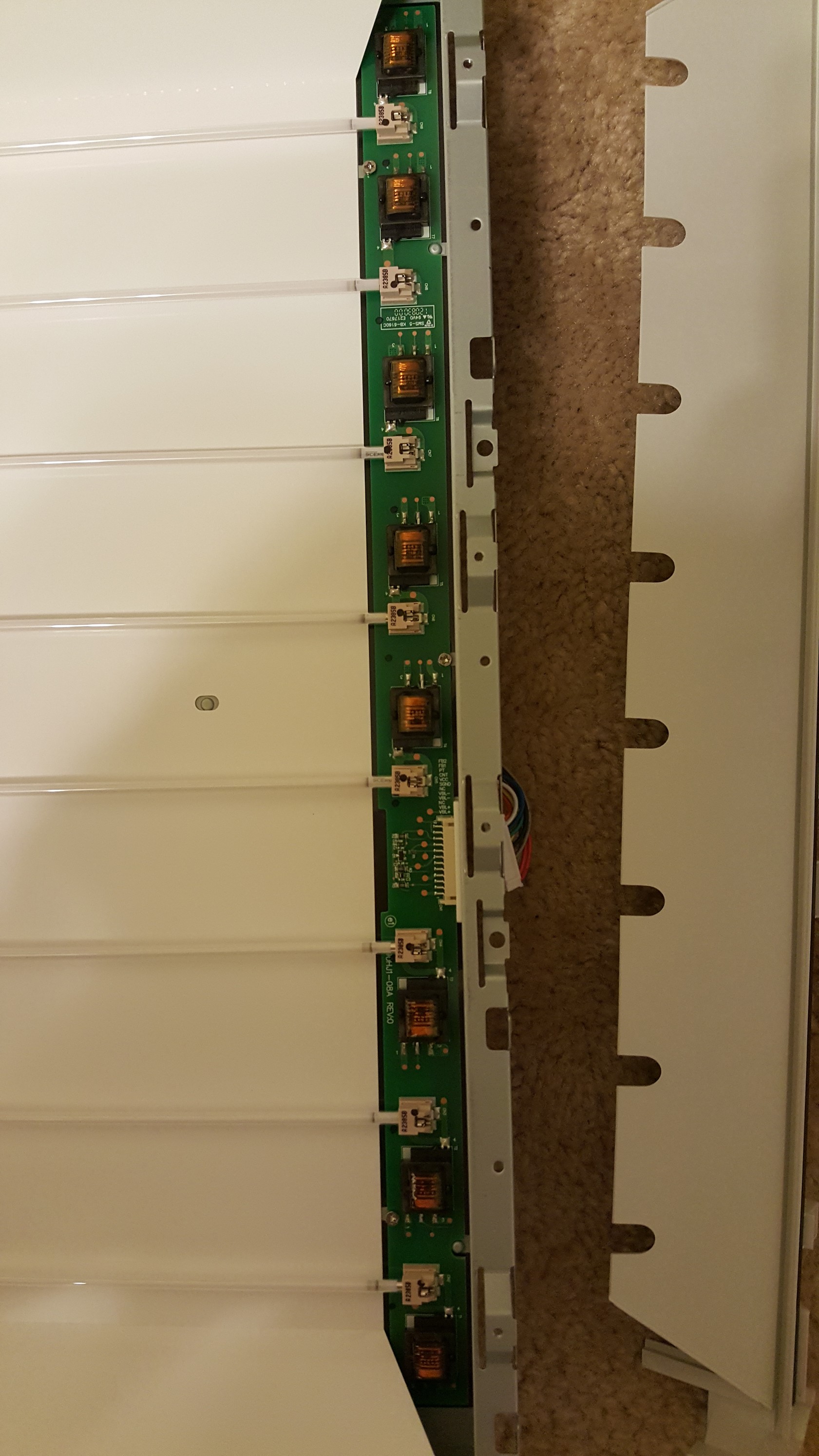

                              Here is that board on the inside
                                You can compare the secondary's on each transformer that they are within 3%. DMM in ohm setting.
                                  I am not sure how to test for this. There are 4 connections on those transformers, which ones are the secondary?
                                  • bigmatt0211
                                    • Dec 2015
                                    • 44
                                    #37
                                    It seems pins 1 and 3 are connected, but I can't find what 2 and 4 connect to.
                                      is there any numbers on the transformers we maybe able to get a pinout etc
                                        There are some numbers/letters:
                                        t51.8292.291
                                        b2f 1235
                                        00 4 C A 5
                                          a new inverter board is $14. You gonna need one anyway if one of these transformers is bad.
