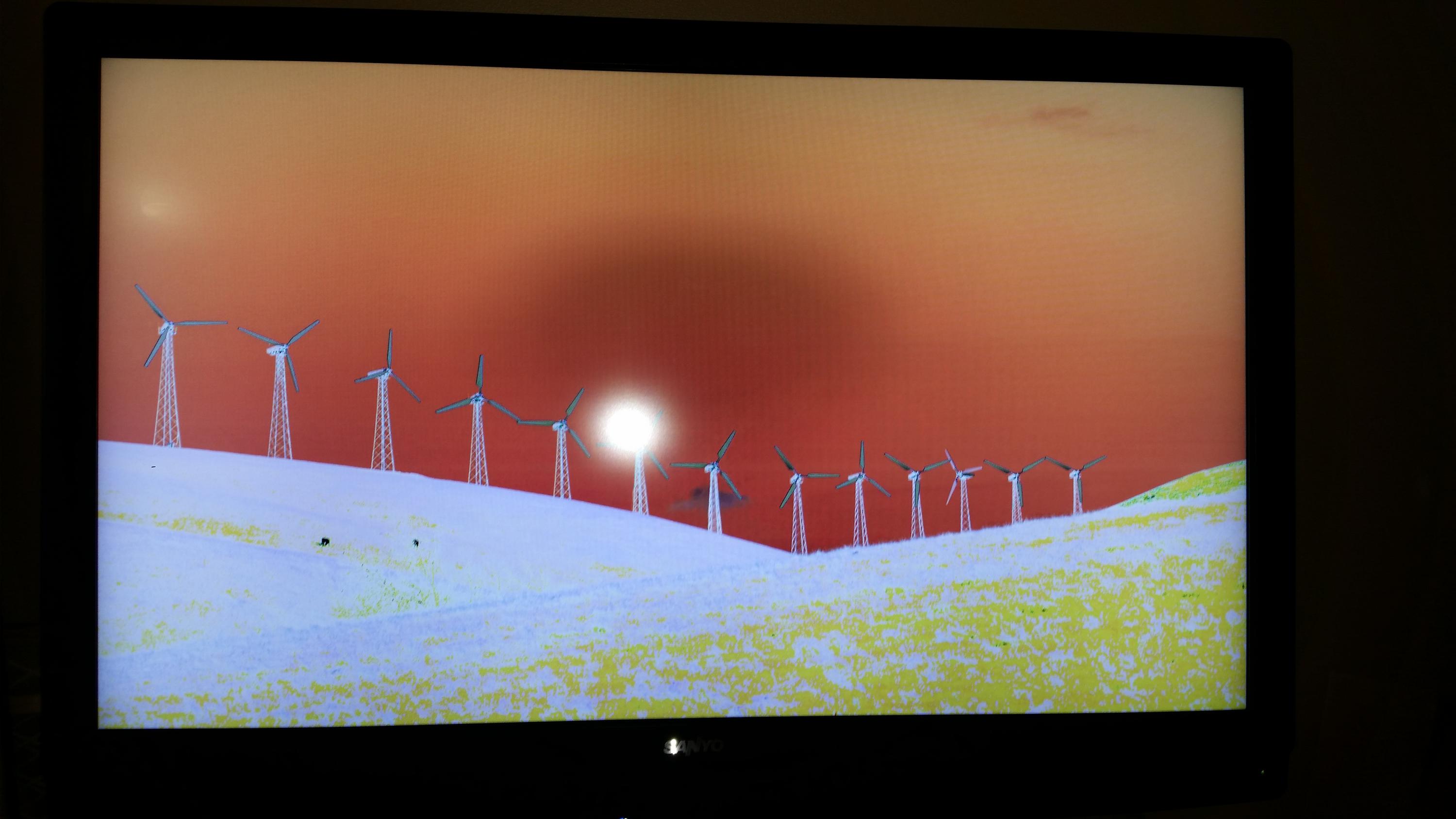

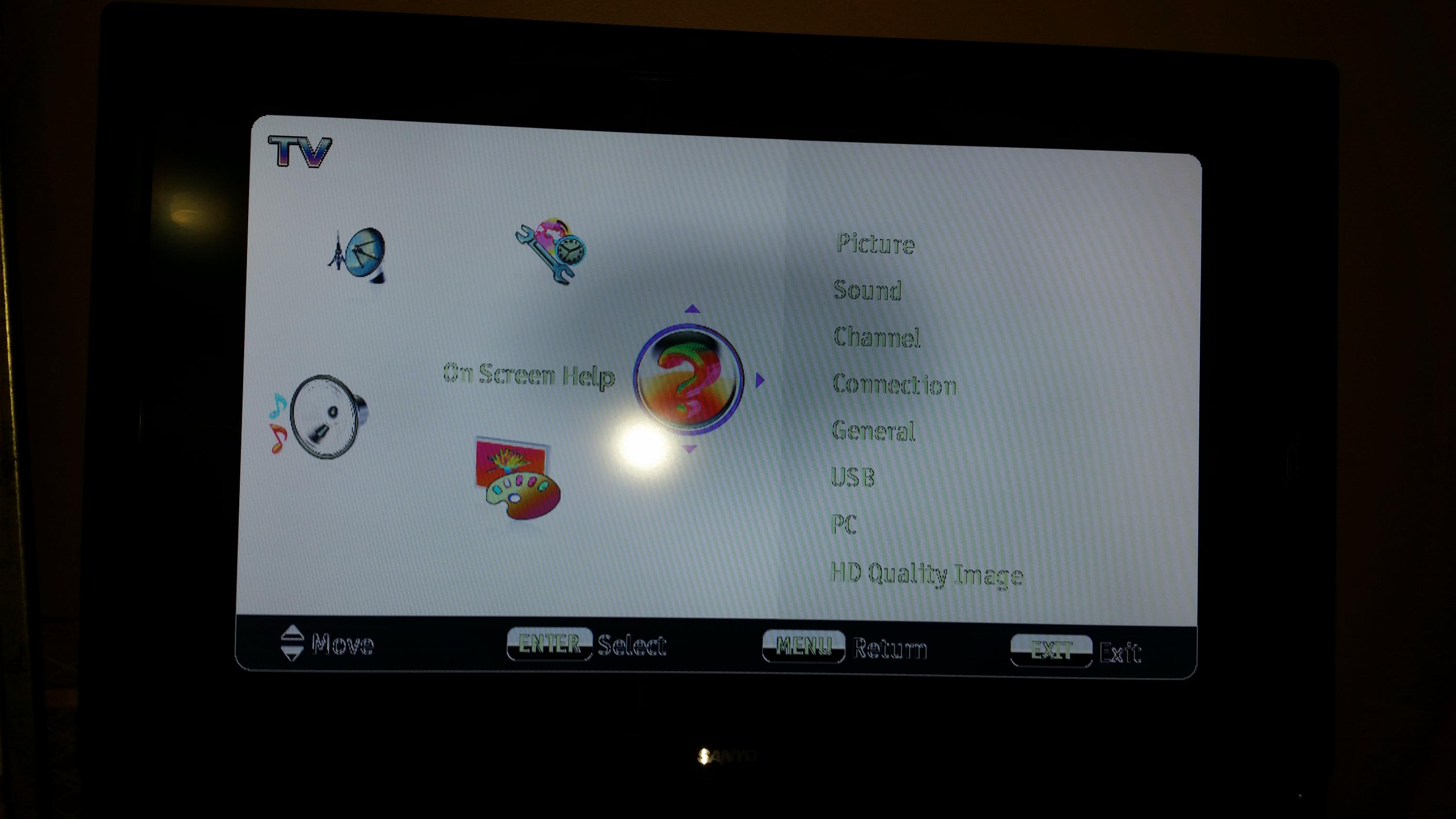

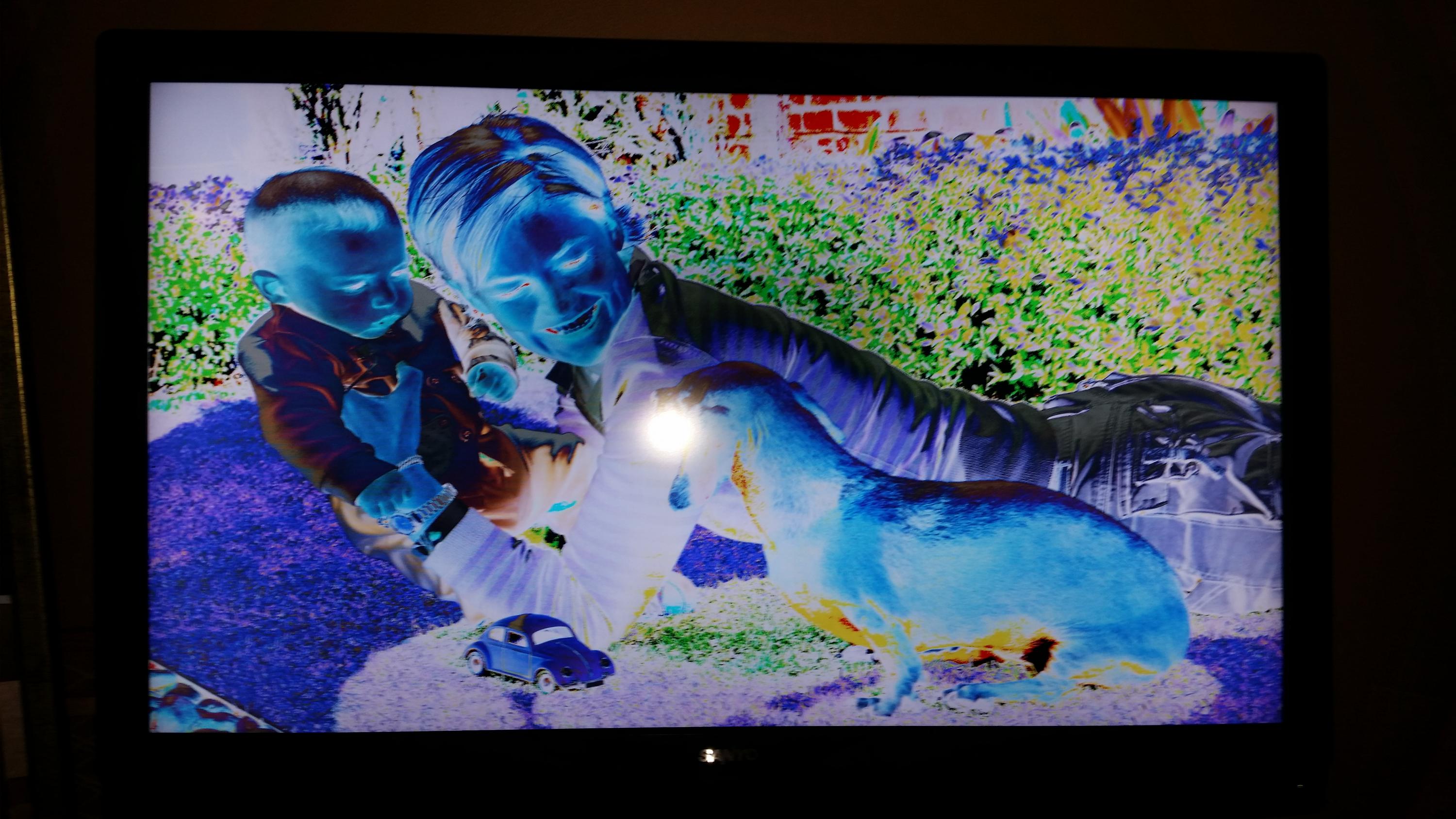

    Hey guys I'm working on a sanyo model # dps46819, the issue im having is distorted picture, i think the term is "solarized" i have visually inspected all components and boards, i have tested the power supply to rule it out, all voltages are correct. I cleaned and reset all conections on the set, and resoldered the ground on the tcon connector, and the problem still persists. It is solarized even when the menu is pulled up. Im wondering if anyone might be able to point out which chip would be responsible for causing this issue.

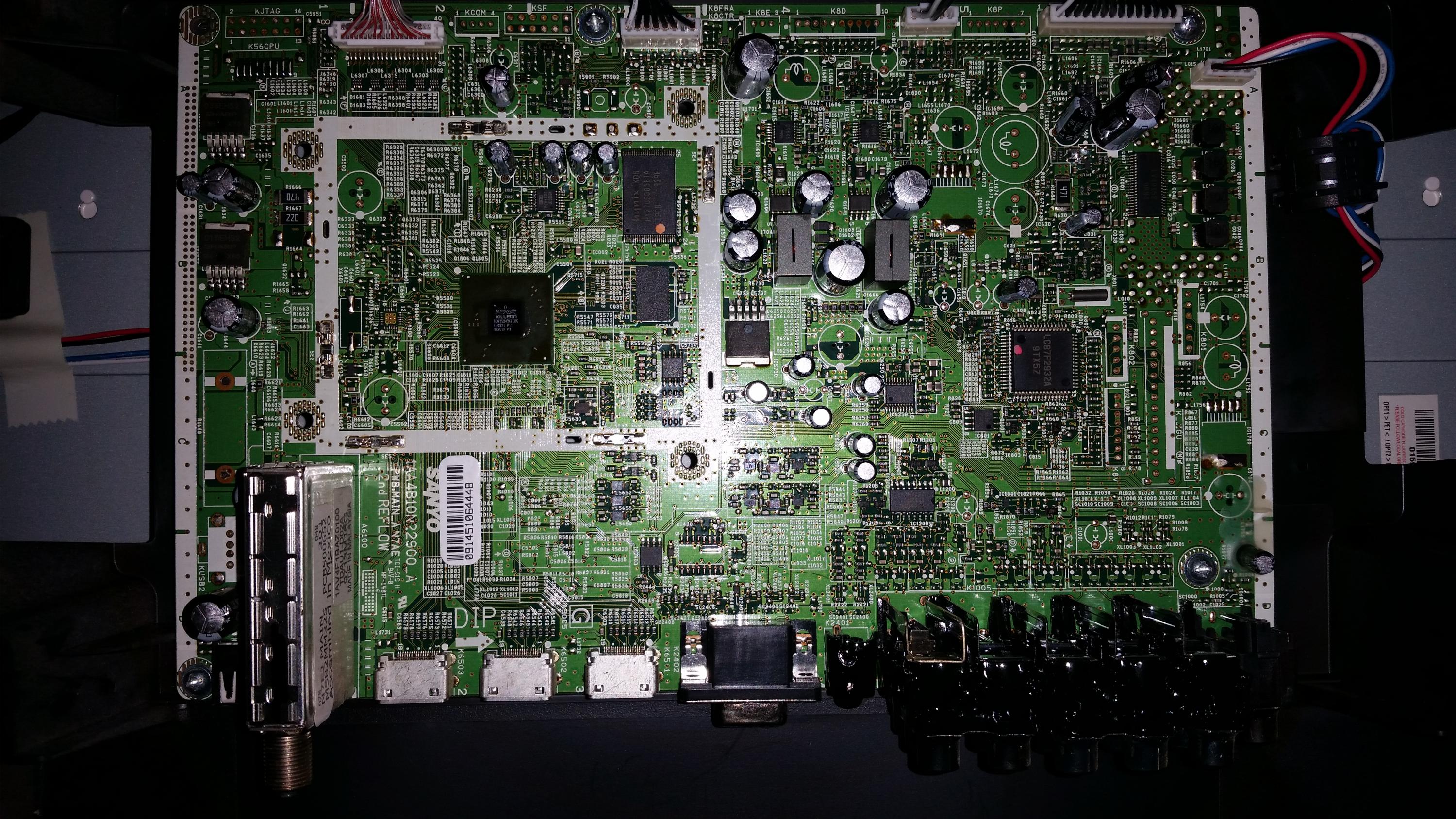

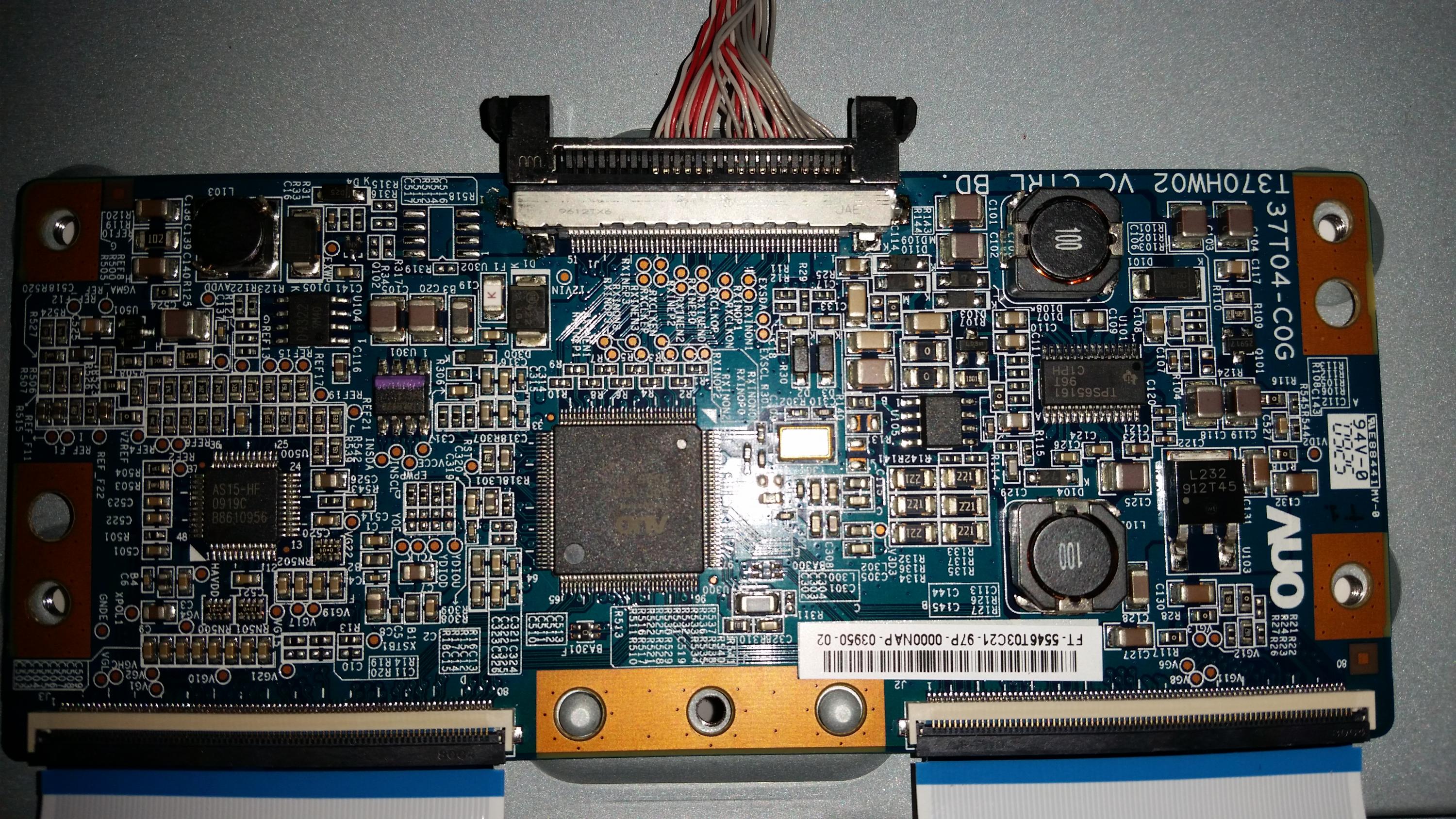

    1st picture, left side, AS15, 48 pin chip.

      Forgot to mention this is an intermittent problem, after the set is on for about 15 mins sometimes the screen will go back to normal, but will return to solarized after a couple minutes. There is also a buzzing noise coming throught the speakers, i figured it was related to the solarization issue.

          Pictures of the "solarization"?
          Try freeze spray on that AS15 to see if it changes.

            Record the voltages on the "VG"(anything labeled VGxx) test points beneath the AS15 chip
            when the picture is bad vs good. Let us know the values. In table form, ie
            VG01 - xx Volts
            VG02 - xx Volts
            and so on.

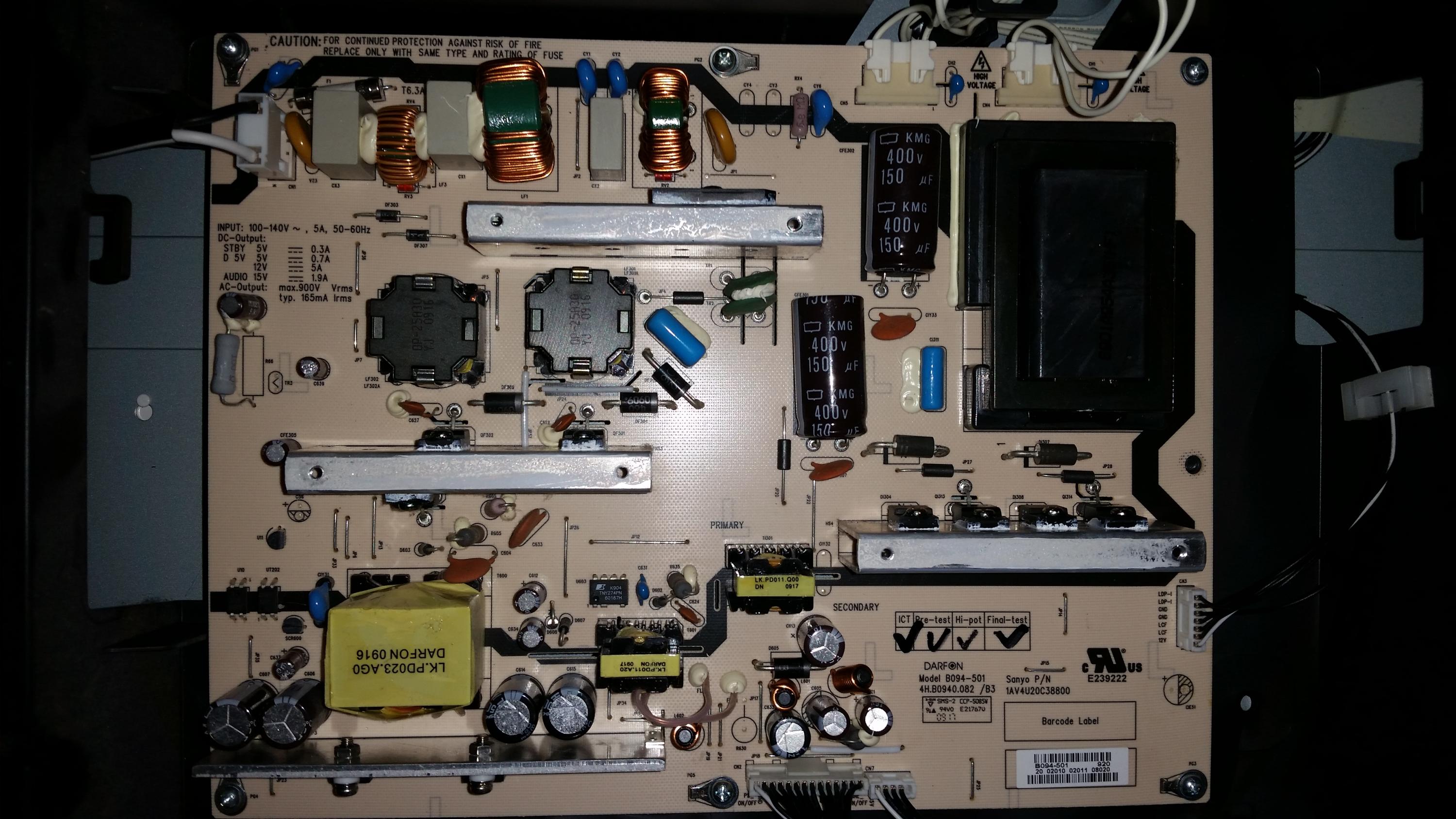

                  I have to figure out how to fire this set up with the back removed, i cannot access the t-con board with everything hooked up.

                    That does look like a classic gamma chip fault.

                      The chip in question is also extremely hot to the touch, and freeze spray seems to have no affect on its performance.

                        Bad.

                          Thanks a million, i will report back once i get a replacement board, my soldering skills are good, but i don't think i could pull that chip off. Thanks cliff and budm, I hope to learn more from you in the future.

                              The voltages should be linear. Decreasing (or increasing) little by little.
                              Vg1 15.32
                              Vg2 11.47-11.61
                              Vg4 10.47
                              Vg6 10.23
                              Vg8 10.21
                              Vg10 8.76
                              Vg12 1.707 BAD
                              Vg13 7.53
                              Vg15 1.16 BAD
                              Vg17 5.27 BAD
                              Vg19 14.73
                              Vg21 13.56
                              Vghc 26.81
                              Vgl 5.992
                              Vgma 15.35

                                    This set is repaired, thanks for the help guys, it was the t-con board.
