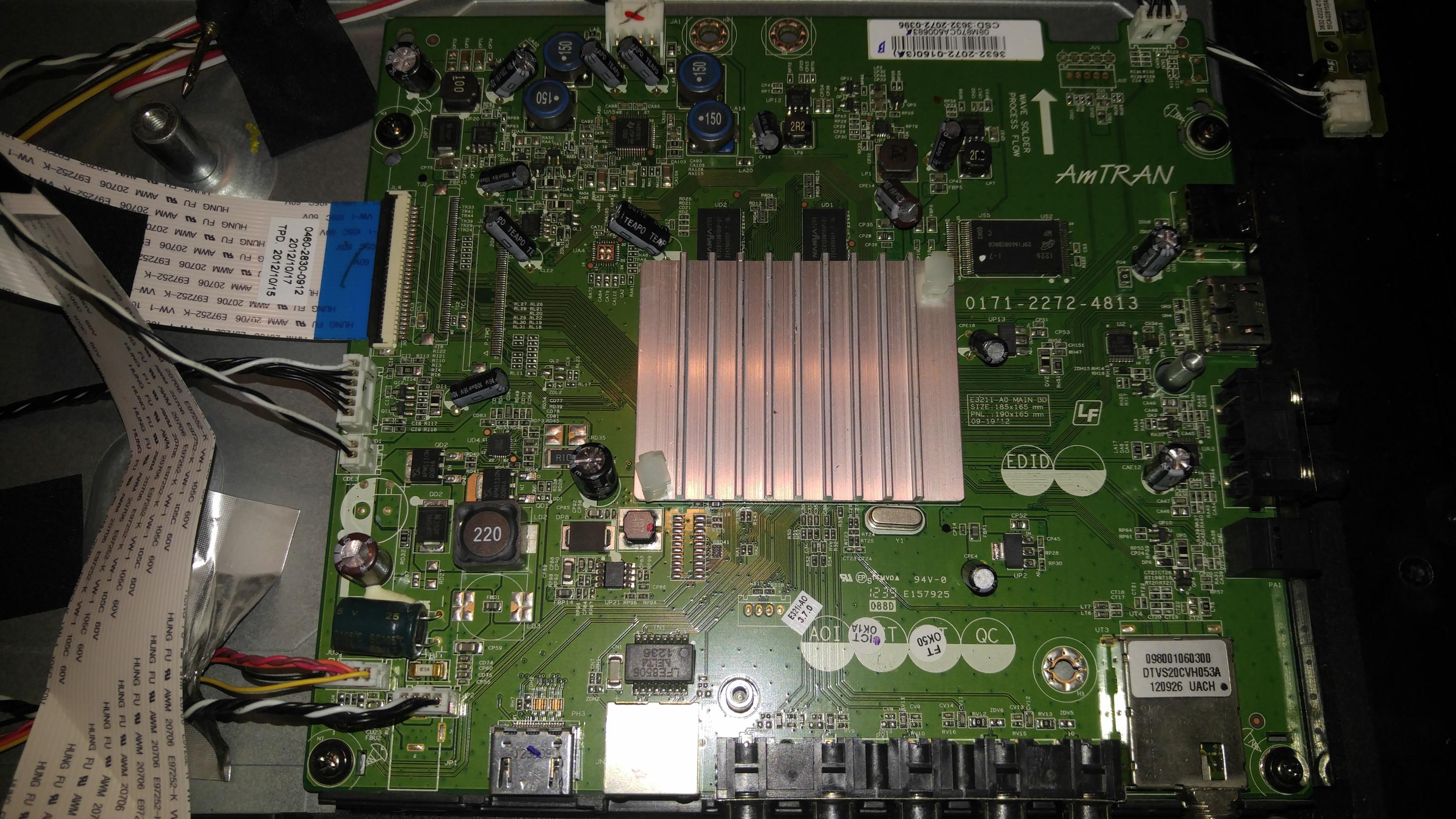

    ok all here is my issues with this set backlights come on nothing comes on sceen like no menu no vizo logo no bootscreen

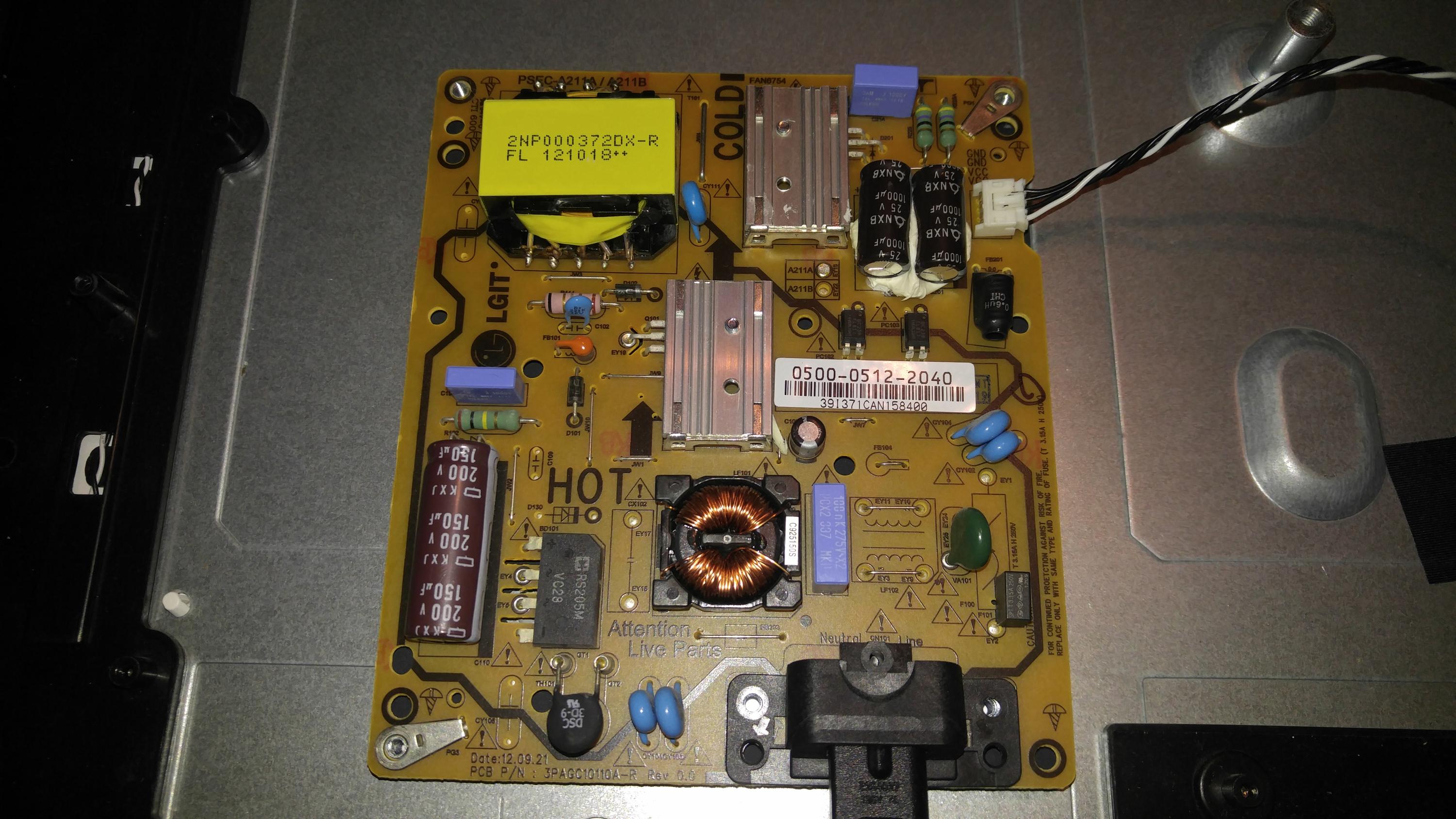

    i have test power board i i get 19v out very simple borad just one volt out
    have been reading up on vizo eeprom an volt reg seam to big issues maker on these sets
    so far i check the volts on reg at loction vp2 or up2 cant really tell
    line 1 is 1117
    pin 1 =2.0
    pin 2=3.34
    pin 3= 5.0
    so i read online that you ad 1.25 to pin 1 so its close to 3.34
    i just need an little help from yall to see where to go next thanks brandon

      Re: vizo e320i-ao
      i check the fues on the pannle borad if this is what your asking
      i think you are asking this because the main has t-con built in it
      the borad that goes to the pannel on bottom of tv is where i am checking now right
      yes 12.09 on both sides when on an 0 when off
      i check the vollt reg on the labe location ic5 i belive thats what it says
      line1 =1117
      pin1=.61
      pin2=1.87
      pin3=3.32
      from reading about these volt reg it look right on
      i am lost after that thanks

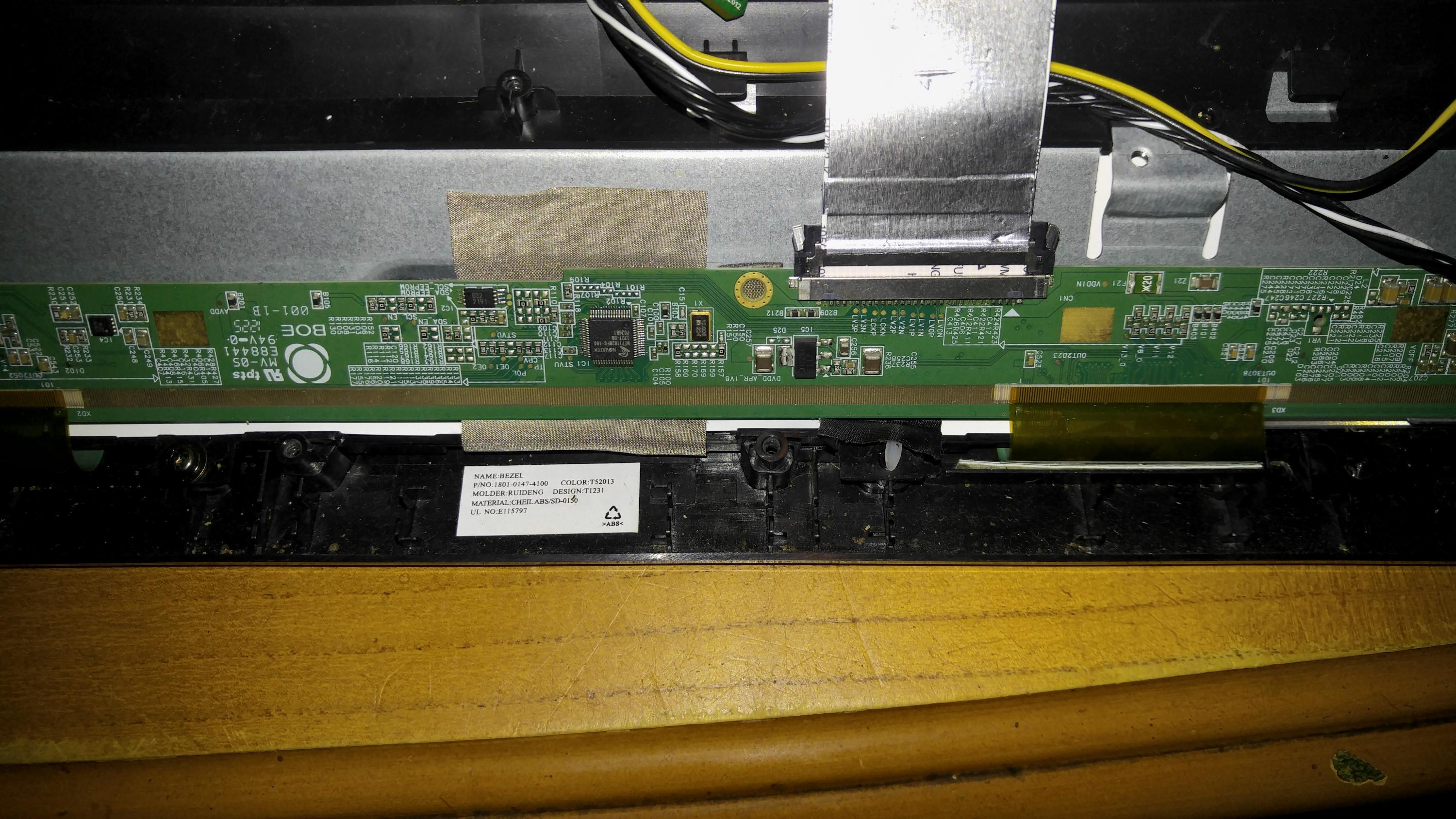

              • 7325
              • Britain
              Re: vizo e320i-ao
              Have you an Os scope to check the Lvds signals going to the panel ? Thats where I would start to see if the Mb is working.

                Re: vizo e320i-ao
                well i just got in a new/used main for this set an its doing the same thing
                so i guess its in the pannel board
                i have to look in to it so more
                i do not have an scope so all i can do is check for volts on lvds cable an some are there i have no idea what volts should be there so i guess thats where i am at with this set i have the will to learn an if anyone know a way i shall try it

                  Re: vizo e320i-ao
                  Ok deffo panel then, going to be hard with no scope sorry. My guess is possibly shorted tab bond drive though

                    Re: vizo e320i-ao
                    i wonder if i unglued the tabs half of screen should work like if i un gled the left hand tabs what u think
                    • ReeceyBurger123
                      Never Give Up !
                      • May 2014
                      • 7325
                      • Britain
                      Re: vizo e320i-ao
