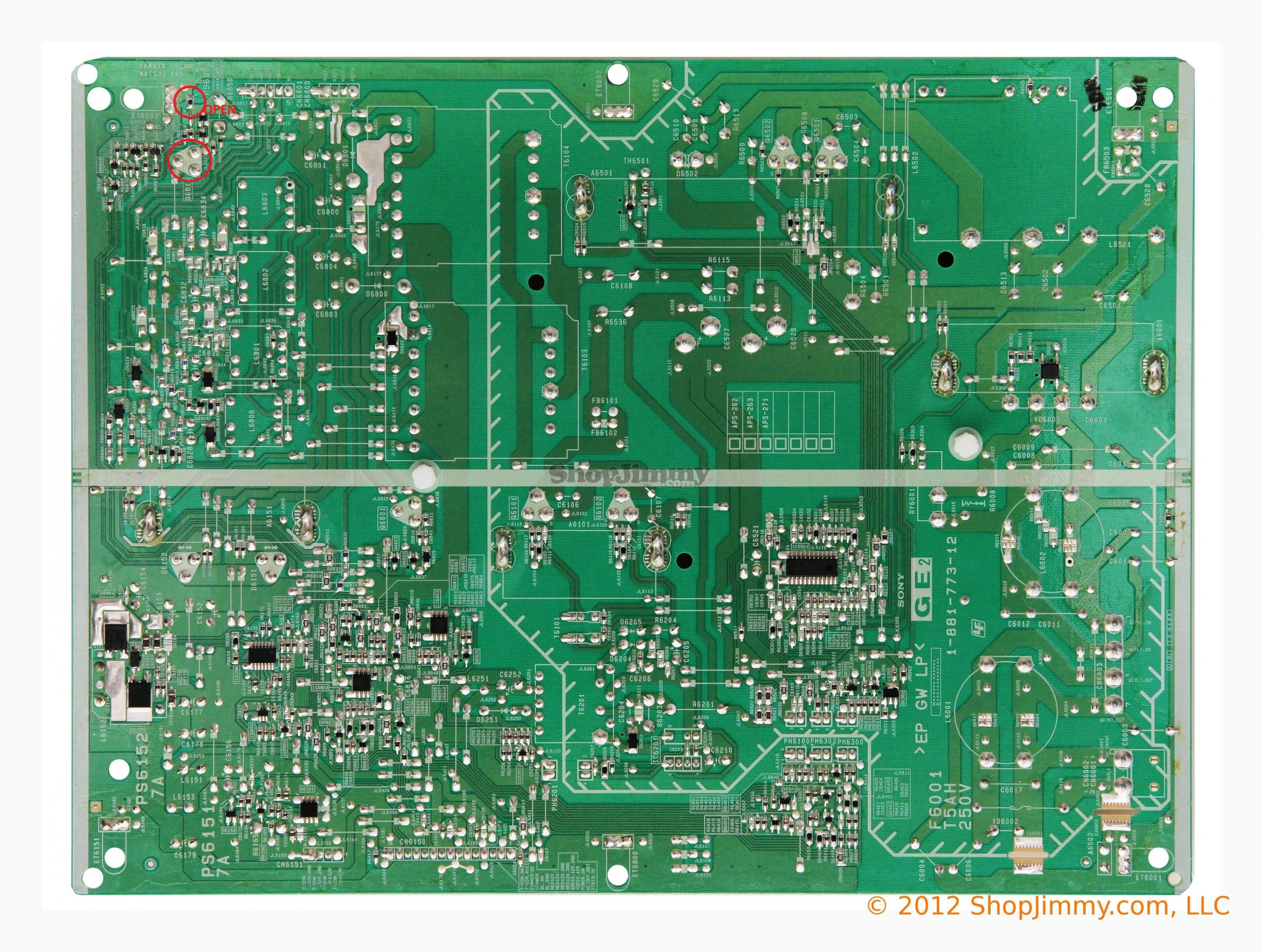

    have a kdl-52ex700 couldnt find any info on for the 6 blinks, yea backlight code, but why? LEDs tested fine, power supply looked fine(at first) main board was sending voltages to turn on BL and dimming control. but service manual says main board or panel.... well before you go throwing money at it, check out fuse to ground PS6800(circled) and Q6814(circled) replaced these 2 components and good to go. hope i saved someone a headache

        YES Sir!!...The original post really is true....I got one but in my case the fuse to ground was the problem....I temporarily connected a normal 0.5A fuse and the backlights came on....the set worked for 10hrs straight and no problem...I closed up the set and could not figure out why the fuse alone went....Returned the set to owner...this was Dec 2016....just spoke to the owner and the set working still....Great post...

              checked fuse to ground was open and Q6814 was shorted gate to source...placed 11n90 instead of k4096...and fuse shorted direct to ground...still 6 time blinking...

                  one 100ohms resistor on pin 6 of ic2904 was open due to gate to source shorting..replaced that and ..backlight came...but 2-3 led are also damaged in my case...need to replace them..

                          Thanks someone gave me a KDL-46EX701. A .5 A fuse did the trick .

                                    IC 2904 it is IC6803 but pin 6 is not connected

                                      Just replaced the fuse and now the TV works again!
                                      If i had followed the service manual - i would have replaced the BAL board and obviously this would not have fixed the problem

                                        I just fixed KDL-40EX700. Replaced led bars, ps6800 fuse and R6853. Thank you for this thread.
