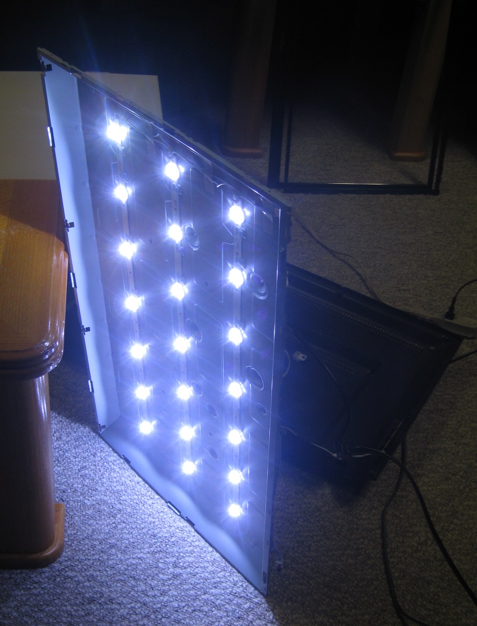

                  Pulled apart the panel last night - was pretty tricky getting the LCD panel control board unstuck from the back of the panel case. Damn double stick tape. Finally broke it free and was able to remove the LCD and took off the frame and reflector. 3 rows of LED strips, 6 lights each.
                  Tonight I'll wire up a quick bulb tester using a pair of AA batteries and some sharp probes. I'll test each bulb to track down the shorted / open diode.

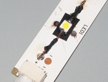

                                Okay....we've made some progress here. Using the diode function on my meter, I was able to test each of the LEDs on the 3 strips, hoping to find one that would NOT illuminate during diode testing. First two strips, all bulbs lit up no problems. One the last strip though, the LED closest to the connector would not light up no matter how hard I tried to get it to go. I double checked my connection methods on the other two strips just to make sure I was checking right - nope, no light on that bulb.
                                So, I believe I've tracked down the problem - a shorted or open LED.
                                Next steps? Should I order a replacement and solder that on? Or should I try the stacking method that Reece has showed in his video?
                                This LED is pretty close to the connector, so there's not a lot of room for stacking on the side near the connector, but it might be possible.
                                Otherwise, where's the best place to buy new LEDs? Or maybe I could find someone who has either a replacement strip or part of one?

                                  Nice find, the led is open if it was shorted the meter would show 0 ohms or beep, with shorted Leds the backlight will actually be fine but if they fail open backlight is dead instantly. Also yes you can use my method for this whichever is easiest

                                          Contacted the good folks at Cedar Grove TV in Eagan, MN. They sent me out a few LED's to tinker with. I was able to remove the failed LED from the strip and solder in a replacement. I decided to use a combination of the stacking method and the direct replacement. I completely removed the old LED, put down some electrical tape as a barrier, scratched some solder pads, and soldered jumpers. Then I glued the diffuser back on top. Success! She lives again!
                                          Much appreciation to all of you who chimed in to assist. In the end, it wasn't bad caps, but still, the diagnosis here was top notch.
