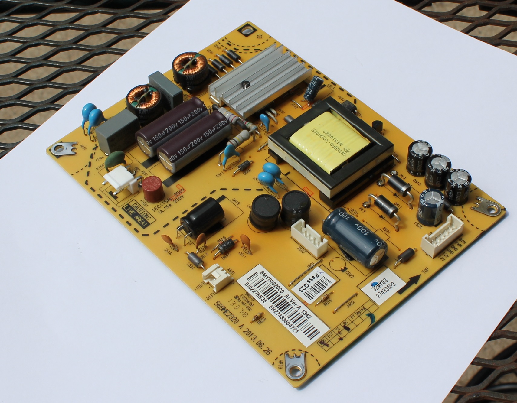

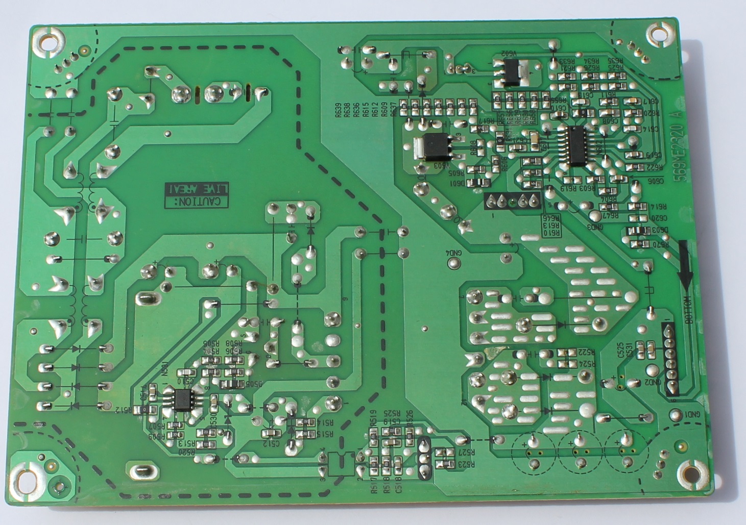

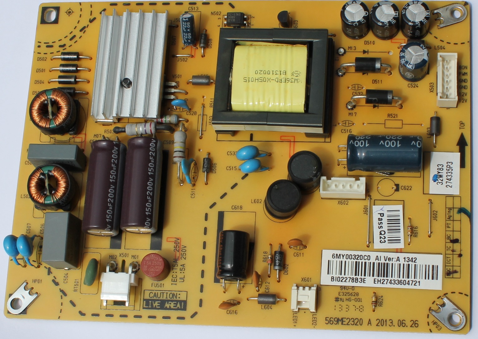

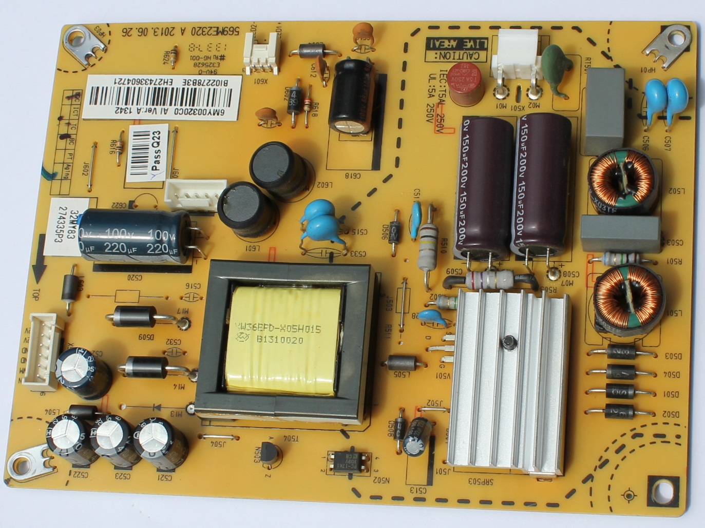

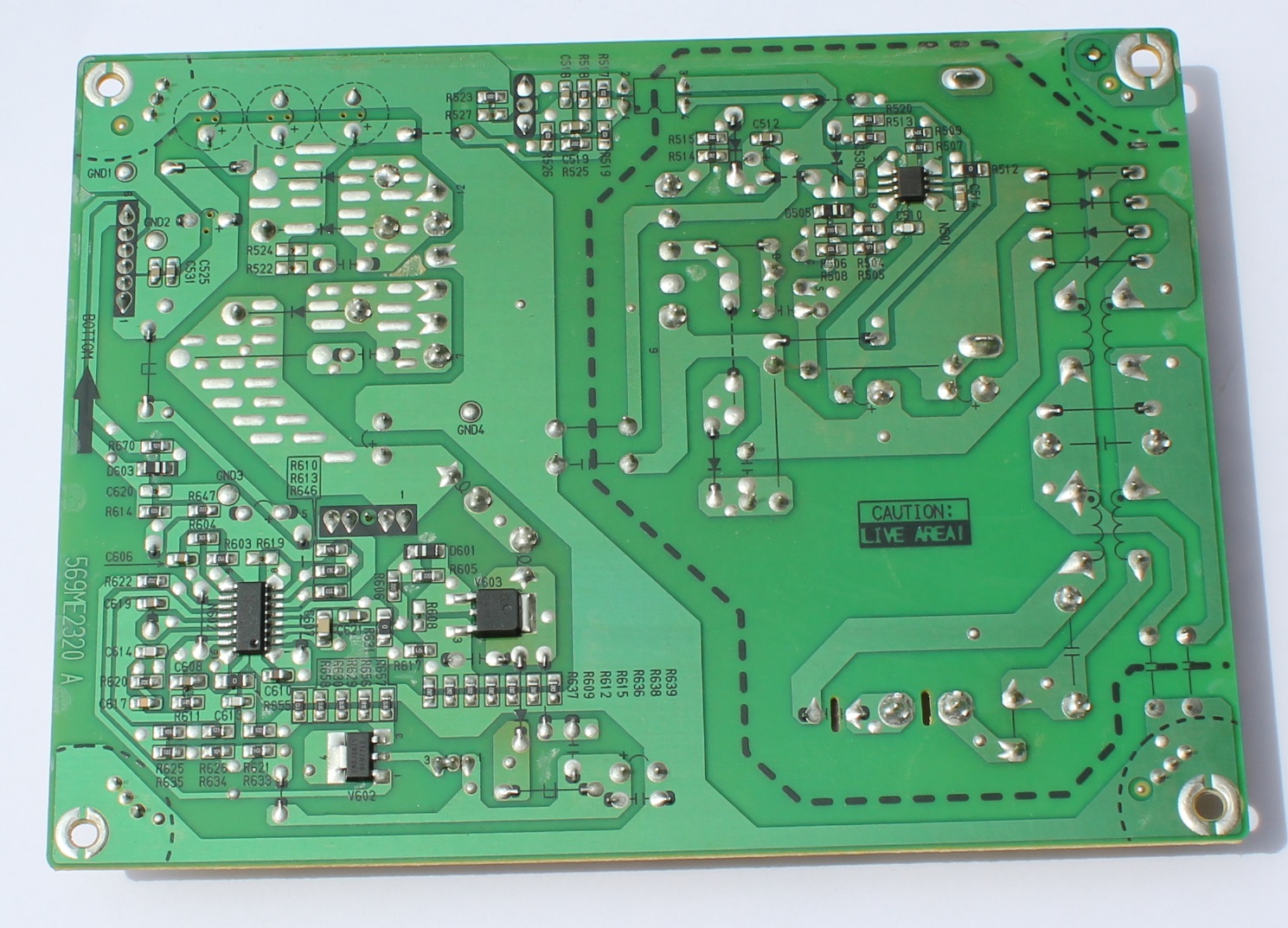

    Picked up an Insignia ns32d201na14 for free at a yard sale. Plugging in the TV, the standby light comes on red and stays red. Pushing the power button, the standby light begins to flash slowly red for 5-6 blinks, then goes out. At that point, the TV is on, because when I push the "menu" button, I can see the menu options on the screen if I shine a flashlight on it.
    So the LED's are not lighting.
    I took the back off the TV, and metered the connector for the LED's for voltage. I got nothing for DC voltage. OK, so it's a power supply problem. Check the caps, right?
    I pulled out my ESR meter and checked all the caps on the power supply board - none of them are bulging, and they are all in an acceptable range on my ESR meter.
    What next?
    Pics attached.

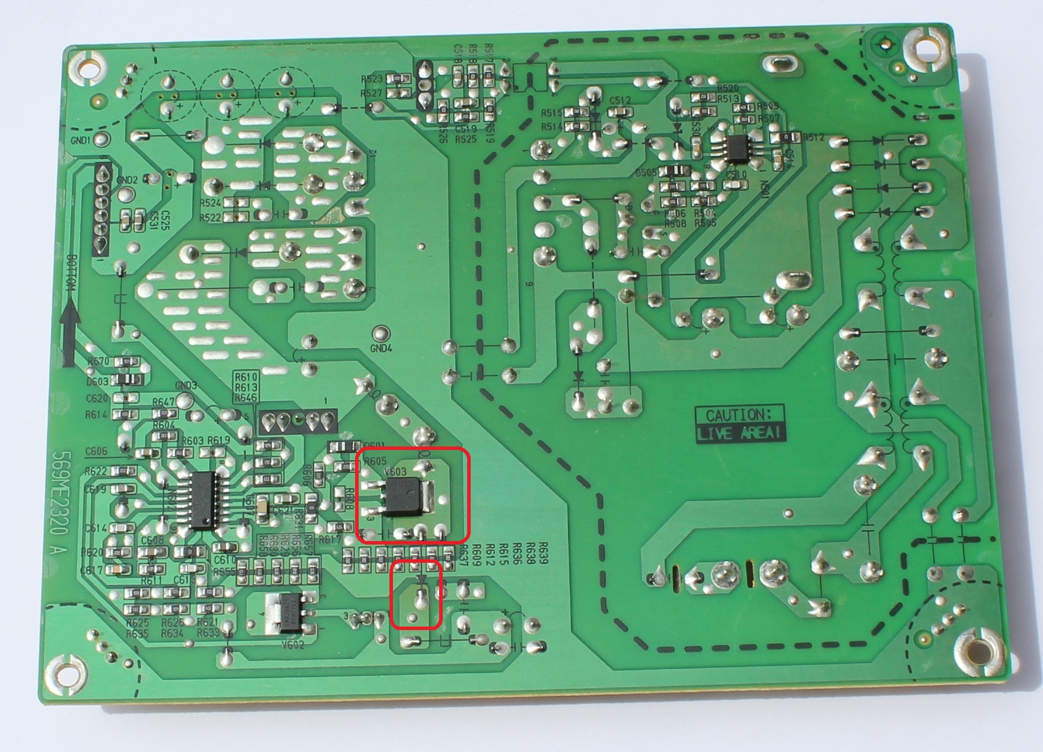

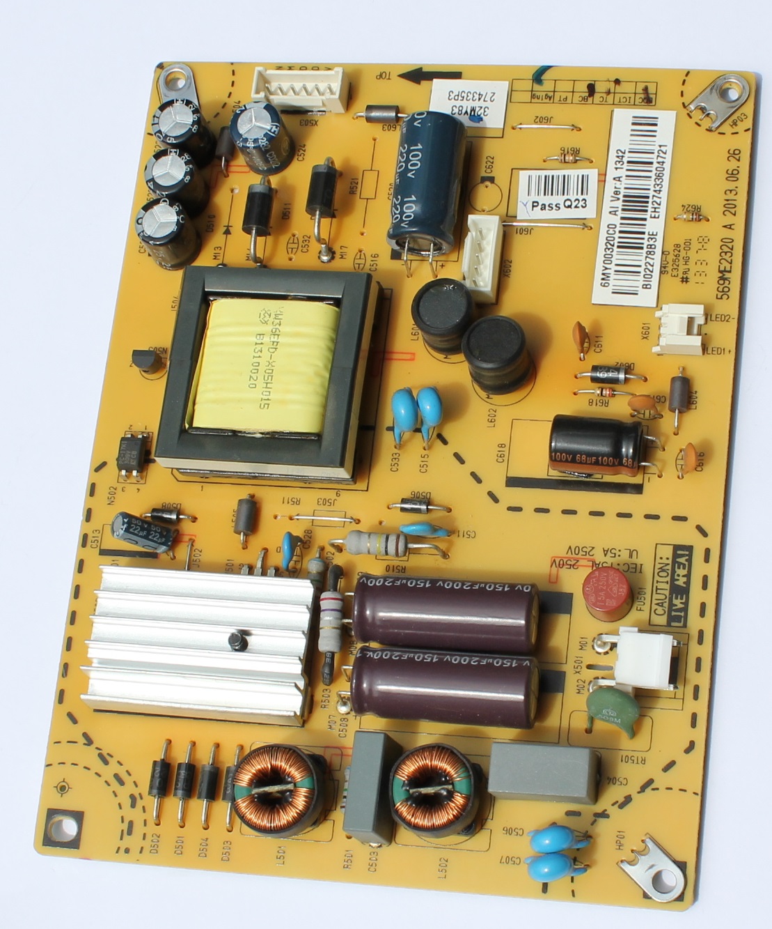

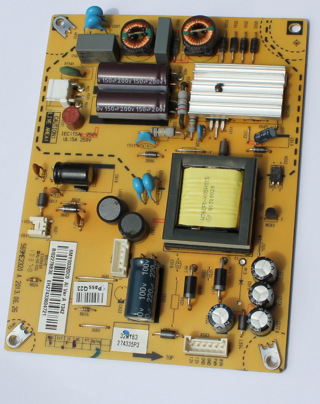

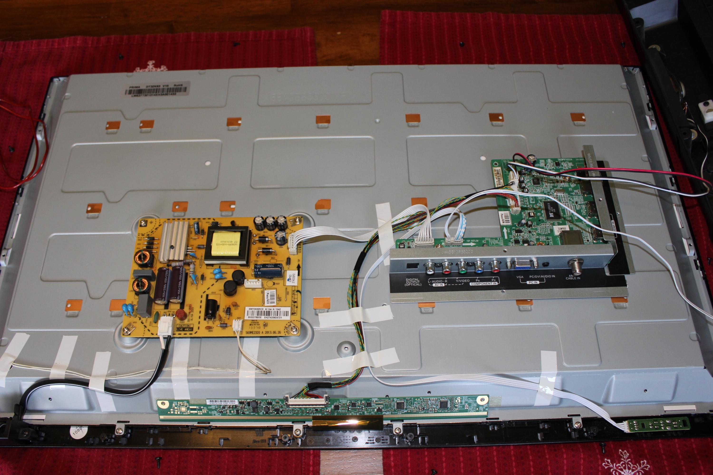

    Re: Insignia ns32d201na14 - TV works, no backlight
    Pictures of the whole back side of the TV so we can see how all the boards are connected together.
    What DCV do you have between the two legs of C520?
    What DCV do you have between the LED connector L+ and gnd?

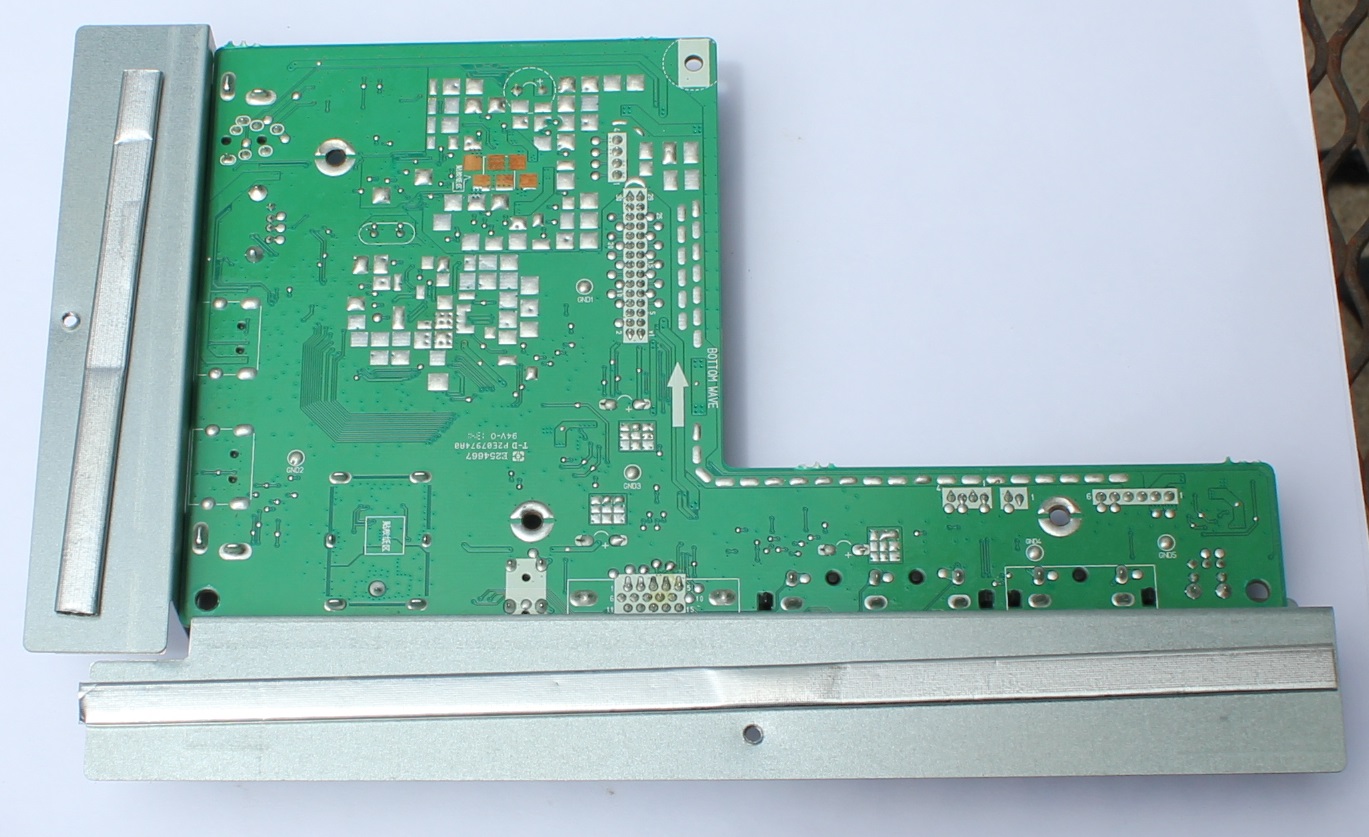

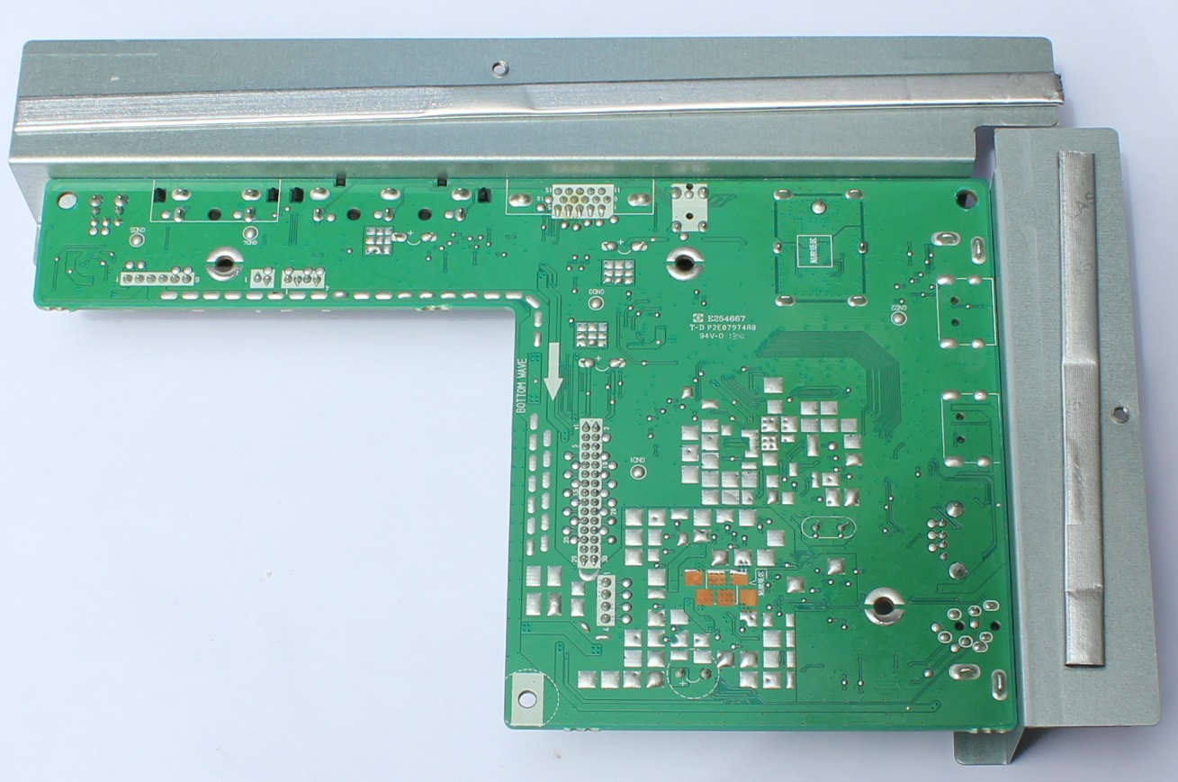

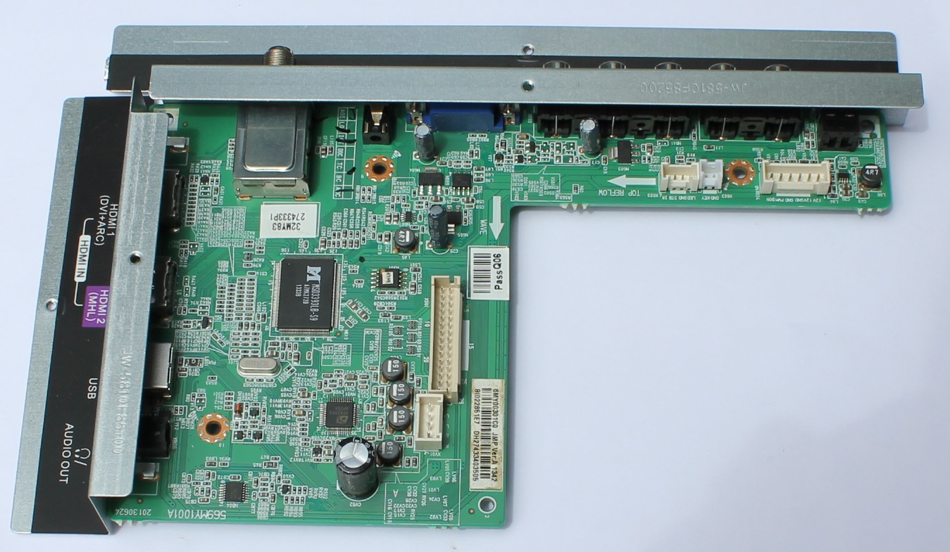

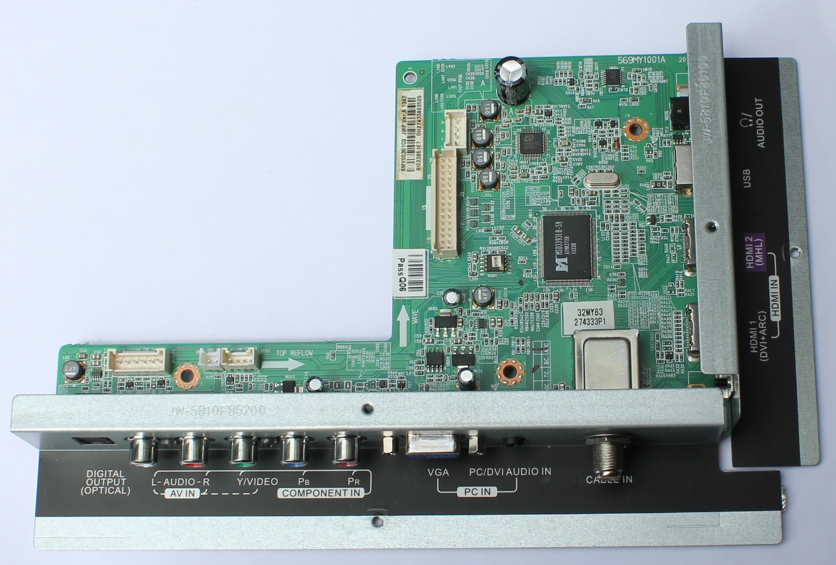

      No problem. Attached. Got some pics of the main board too.
        Holy crap, looks like Westinghouse TV.
            OK, what is the dcv rating as printed on the body of C618?
            So far it looks like you have open circuit in the LED string.
            Check the DCV between L- in GND.
                        OK, we need to find out next if the Gate of V602 is getting the drive Voltage, so check the DCV between Gate and Source pins.
                        This is where LED tester comes in handy, you can try bypassing the PWM controlled MOSFET with resistor but we do not know how many LEDs are in the string to properly calculate the value of the resistor to limit the current otherwise you can damage the LEDs.
                        It may have some shorted out LEDs so the circuit goes into shut down by not turning on the PWM MOSFET.
                        Looking at the Voltage readings
                        85V feeding the string, 35V on the MOSFET, so the Vdrops on the LED string is 85V-35V = 50V
                        50V/3V about 16 LEDs but we do not know for sure, I would expect more than 16 LEDs for 32" TV.
                                https://www.badcaps.net/forum/attach...3&d=1466702535
                                V602 by the bottom edge of the board.

                                  Okay, assuming pins 1 and 3 are the gate and source pins (with the middle pin being the drain), I get no measurable voltage across those two pins. I observed the voltage while turning the TV on and off, and I never observed anything more than a few milli-volts. So I'm assuming that means no voltage at that mosfet.
                                  Next?

                                        Have you checked D602 and V603 which looks as though they may have heated up the bottom of the board.
