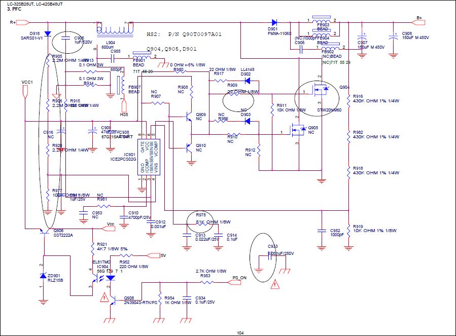

    Re: Sharp LC-42SB48UT-a no standby voltage
    Service manual attached with power supply schematic, hopefully
    Be sure to look at 42", there is also a 32".
    AcGeorgiegirl: 1st attachment wrong PS.

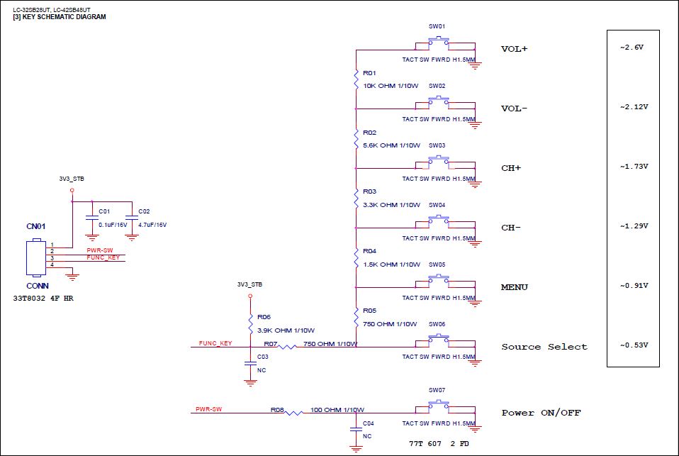

      Here are the PFC & Key Diagram, too.
        #63
        I got it from ELEKTROTANYA and it does not match the OP diagram. See post 57

          Originally posted by budm
          You have the schematic?
          OK, I download the service manual from ELEKTROTANYA.
          My manual show TNY277, your manual shows something else.
          Please look at what is actually printed on top of the IC903.
          Where did you get the manual from?
          Yes, it is printed on the ic as TNY277. My manual, pretty sure, came from ELEKTROTANYA. I'll post the manual here, too, if that helps.
            #65
            OK, your manual does not match your TV version.
            The one I download is the 'A' version and seem to match your power supply board picture.
            But any way, it uses TNY277 none the less, so I still suspect the parts in the feedback regulation circuit.
            Try having the main board connected to the power supply board to see if it will go up to 5V in case the circuit does not like to work without the load.

                #67
                Originally posted by AcGeorgiegirl
                This is weird. ELEKTROTANYA is the only site that I've found that has the manual free, and I'm pretty sure mine came from there. Don't know if it matters, but my model has "A" after the name, and the manuals don't.
                There are two manuals at ELEKTROTANYA, the one I downloaded is for the 'A'.

                    #69
                    I tested with psb connected to the main, and got a fluctuating voltage from around 2.8 to 3.8 or so.
                      #70
                      OK, so it cannot even maintain the regulated 5V output.
                      I would try replacing C969 in the primary side and the 4 cap in the cold side by the connector that goes to the main board.
