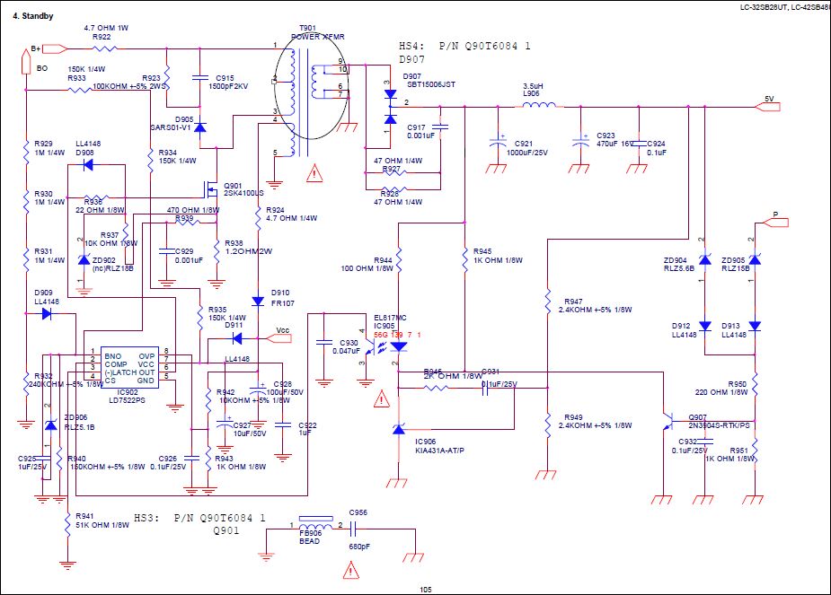

                  So it lookds like you meter is OK.
                  There are parts that are used for regulating the output of the 5VSTBY:
                  IC913 (Vref diode xx431??, IC911 (OPTO), Voltage divider for the IC913.

                        Re: Sharp LC-42SB48UT-a no standby voltage
                        Can you please verify that the SMPS for the STBY is TNY277?

                              #54
                              It was in my 42".
                              Btw I see '5V' on schematic (top of C934). Did they leave 'STB' off?

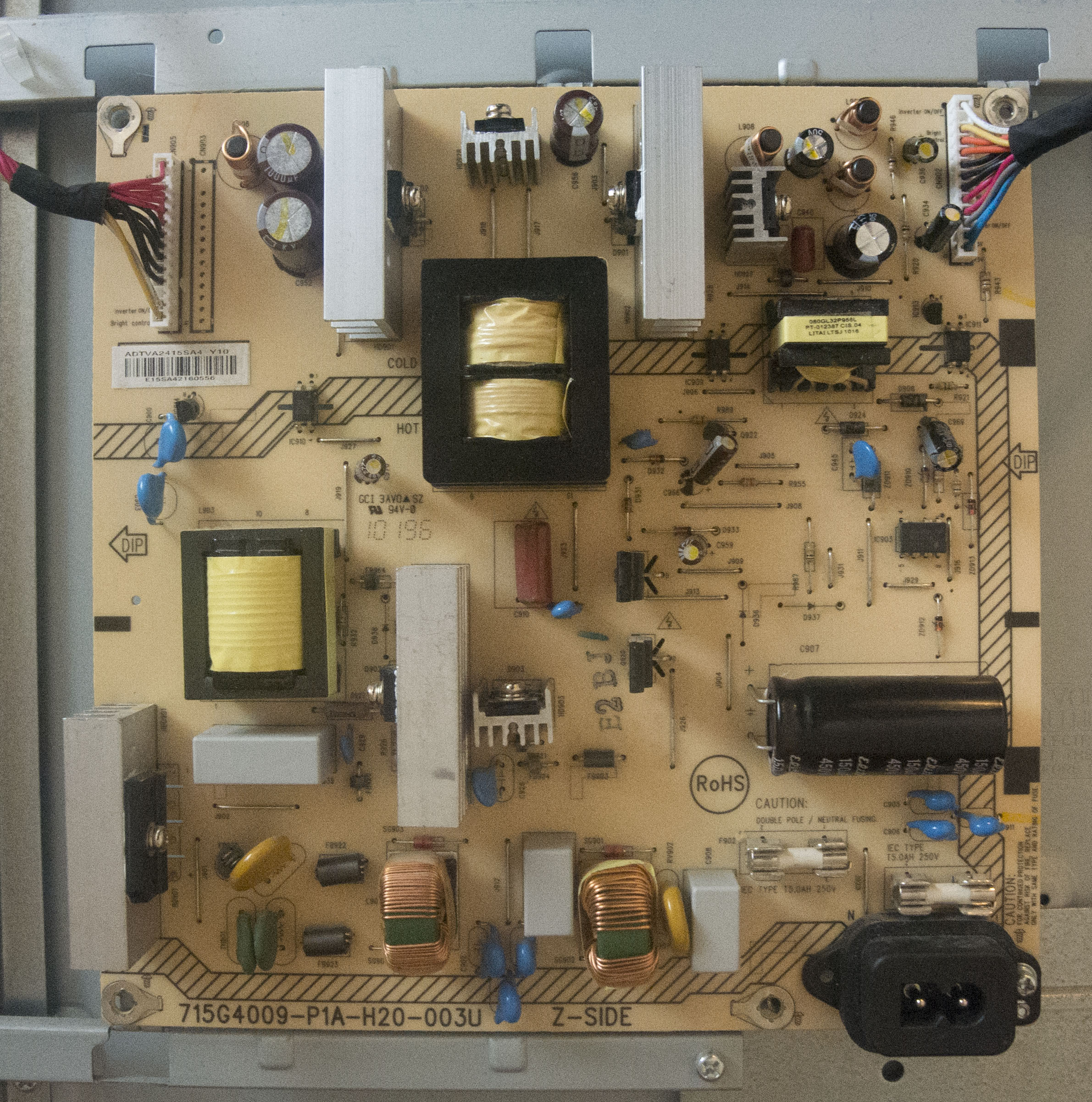

                                The P/N of the IC I got it from the pictures of the board from shopjimmy.

                                    #57
                                    Originally posted by AcGeorgiegirl
                                    I'll look at the schematic. I'll go ahead and post here, too.
                                    You have the schematic?
                                    OK, I download the service manual from ELEKTROTANYA.
                                    My manual show TNY277, your manual shows something else.
                                    Please look at what is actually printed on top of the IC903.
                                    Where did you get the manual from?

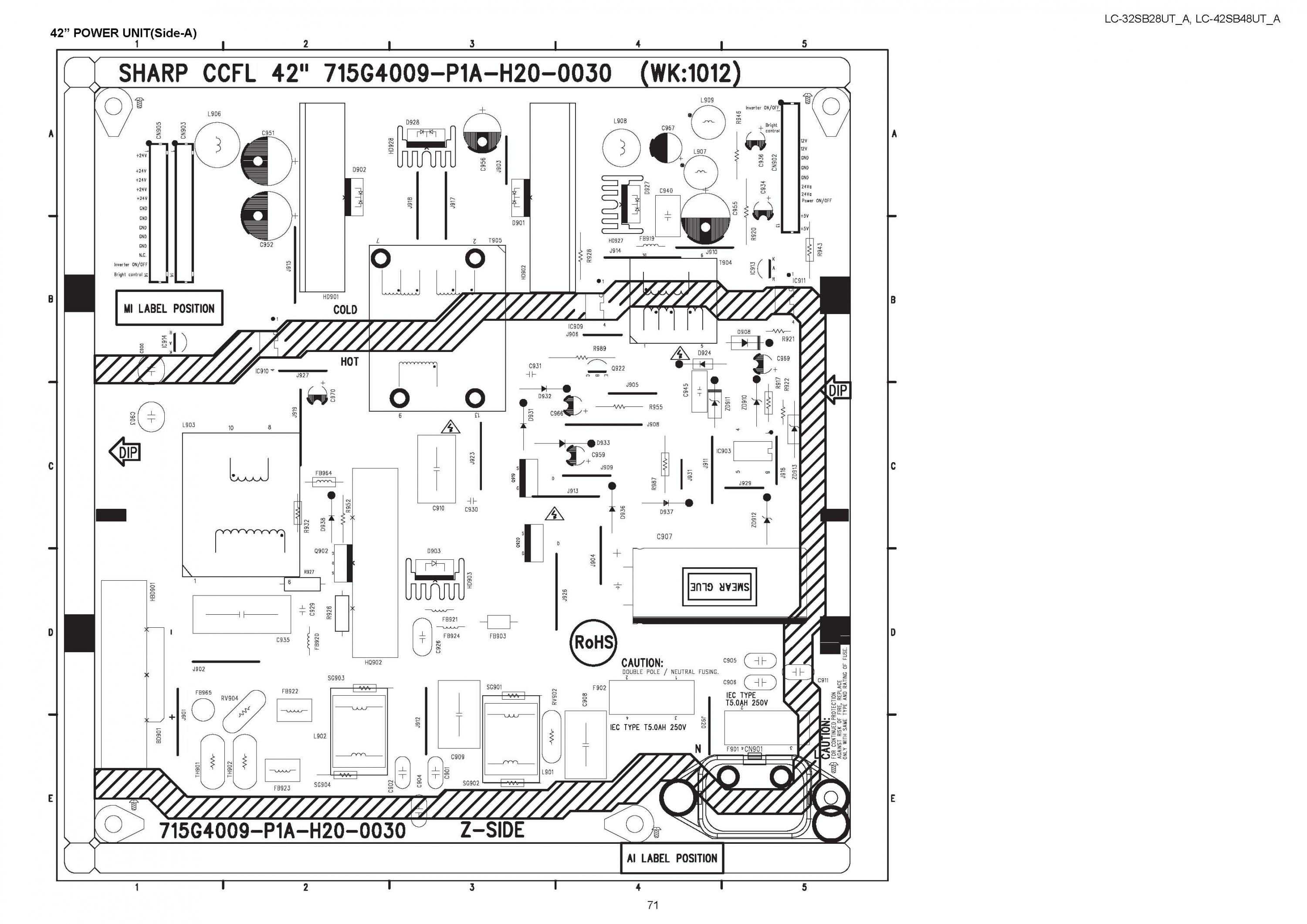

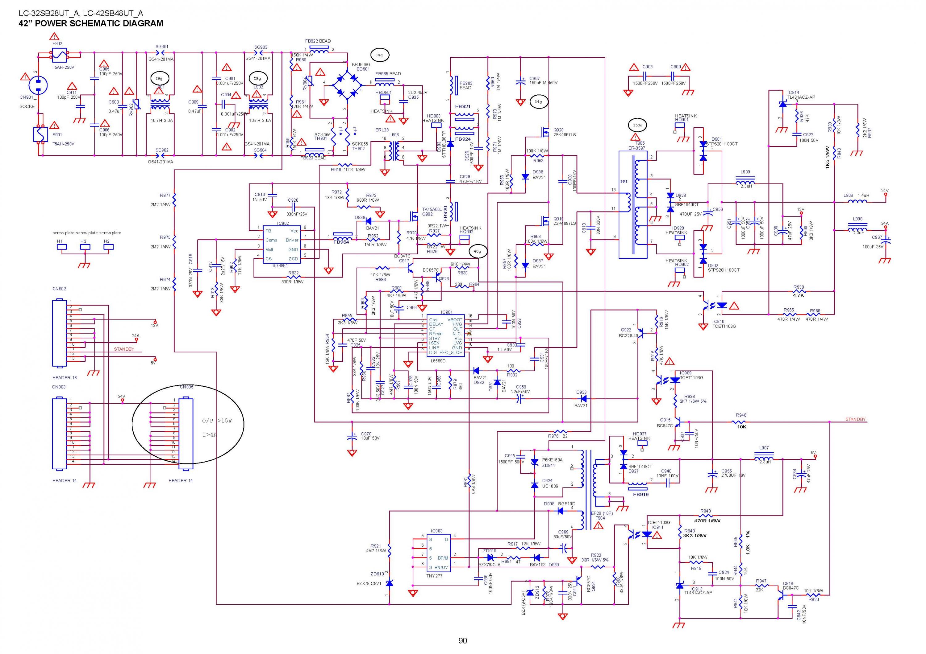

                                          #60
                                          Service manual attached with power supply schematic, hopefully
