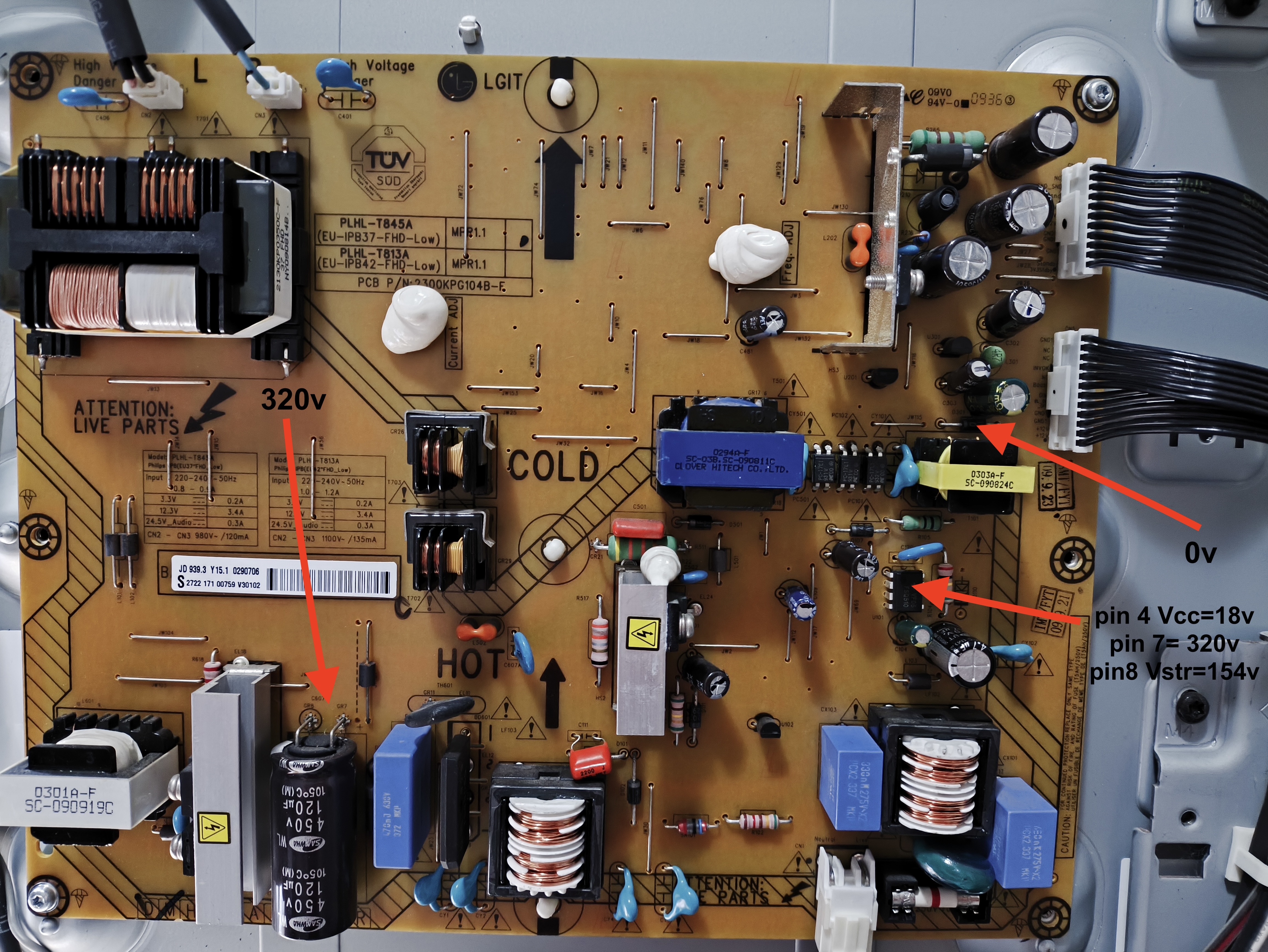

    I have a problem with this TV, the standby voltage is not present. I have checked the components around the IC fsq510's area and they seem to work, also replaced this IC but the problem persists.
    These are the voltages in some pins of IC fsq510:
    Vcc=18v
    D=320v
    Vstr=154v
    Unfortunately, I couldn't find the schematic
    What else could I check?
    Is it possible to provide standby voltage from an external source to allow the TV to turn on?
    Thank you​

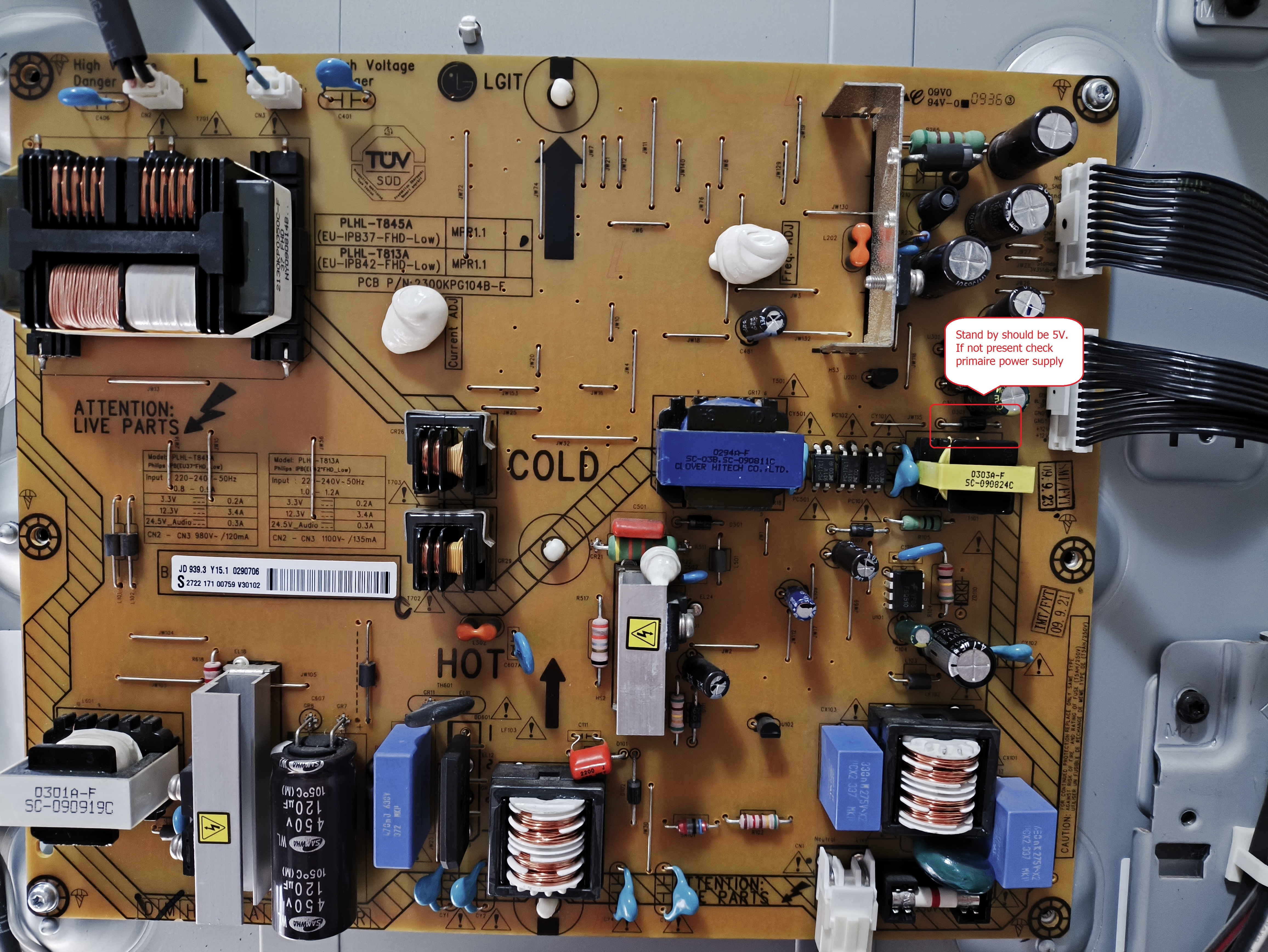

    See here.

      Hi William1967,
      thanks for your reply.
      I have done some readings, please see the attached pic
      I think the primarie power supply is working.
      • lotas
        • Jan 2016
        • 4595
        • Russia
        Is this diode on the secondary short-circuited?
        • Bad_IC
          • Aug 2021
          • 23
          • Sardinia
          I think not, because I read with the digital multimeter between anode/catode 0.217v
