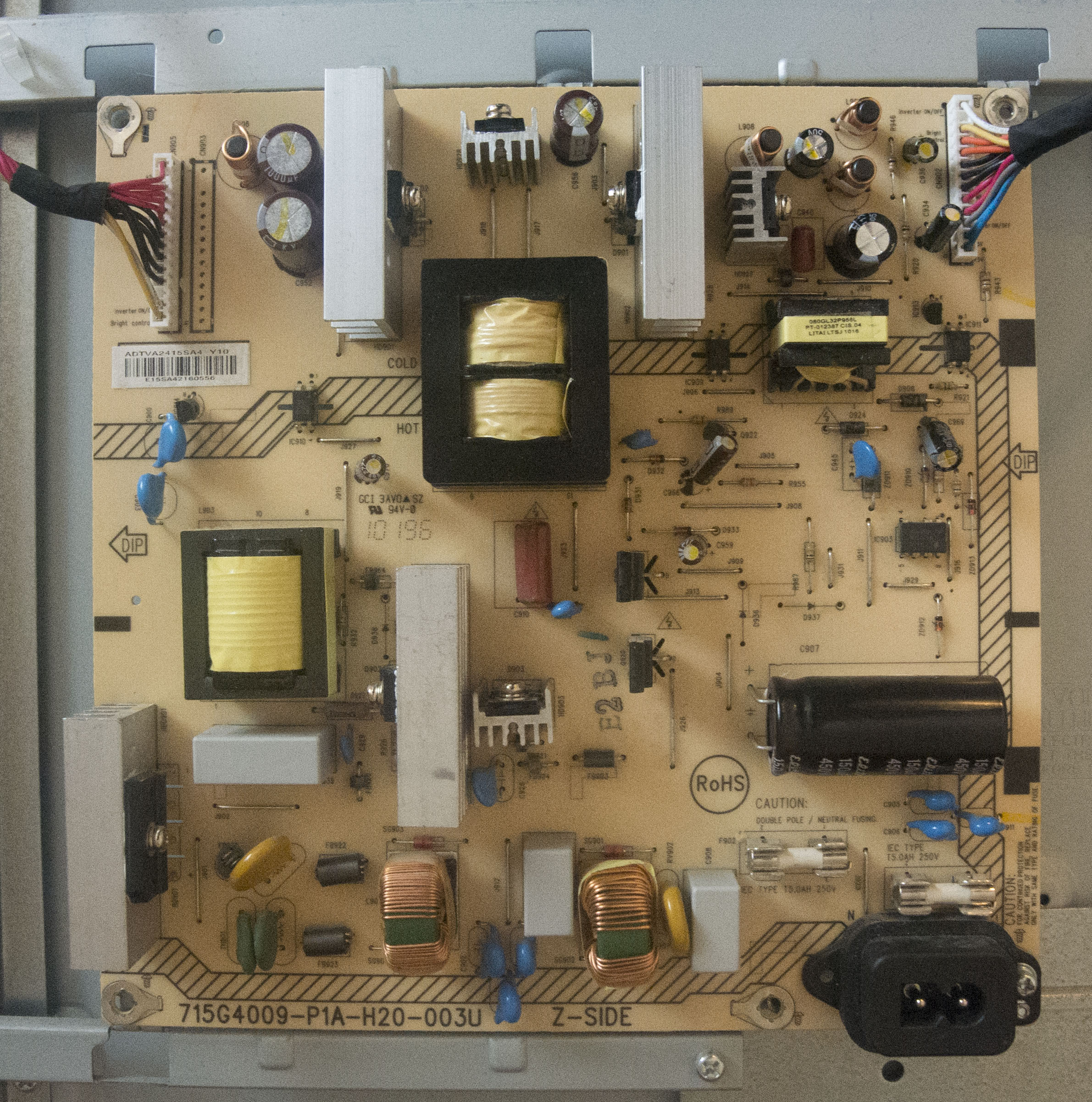

    I've looked the psb over, and find no obvious caps issues, and the 2 fuses are good. I thought of testing the ac input to start with, but haven't found how to do this. My wall outlet reads fine. Otherwise, I'm assuming I'd need to dive into testing individual components? Diodes, transistors, resistors, etc....but I can't make sense of the schematic in the service manual I've found(well, I wouldn't be able to with ANY schematic, for the most part!). Also, my service manual actually has a different psb shown for my tv. It's not even close to what mine looks like.(and, yes, I confirm it is the correct manual- but not the paper one-one I downloaded).
    I am ok in testing the components, as far as that goes...but don't know what the numbers mean, if I don't have their correct voltages, right?

    Check the DCV between the two legs of the big main filter cap in the primary side to see if you have 160~165VDC on it or not first.

          Put your meter on DC volts and place one of the meter probes on each of the legs of C907 and power the set up. What reading do you get.

                          So the meter is set to dcv when you check the Voltage between the two legs of the main filter cap C907?
                          "Sorry, I accidentally replied directly to another posting...the meter reads 2 with it set at 500v. Tv plugged in, but, of course, not powered on."
                          You need to find out if you are getting 120VAC between the two inner legs of the bridge rectifier BD901.
                          You MUST be real careful since you are working in the HOT DEADLY side of the circuit.

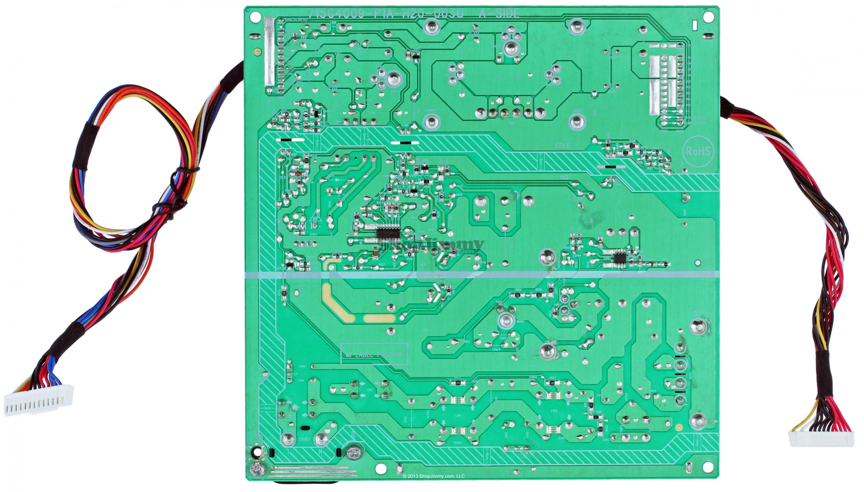

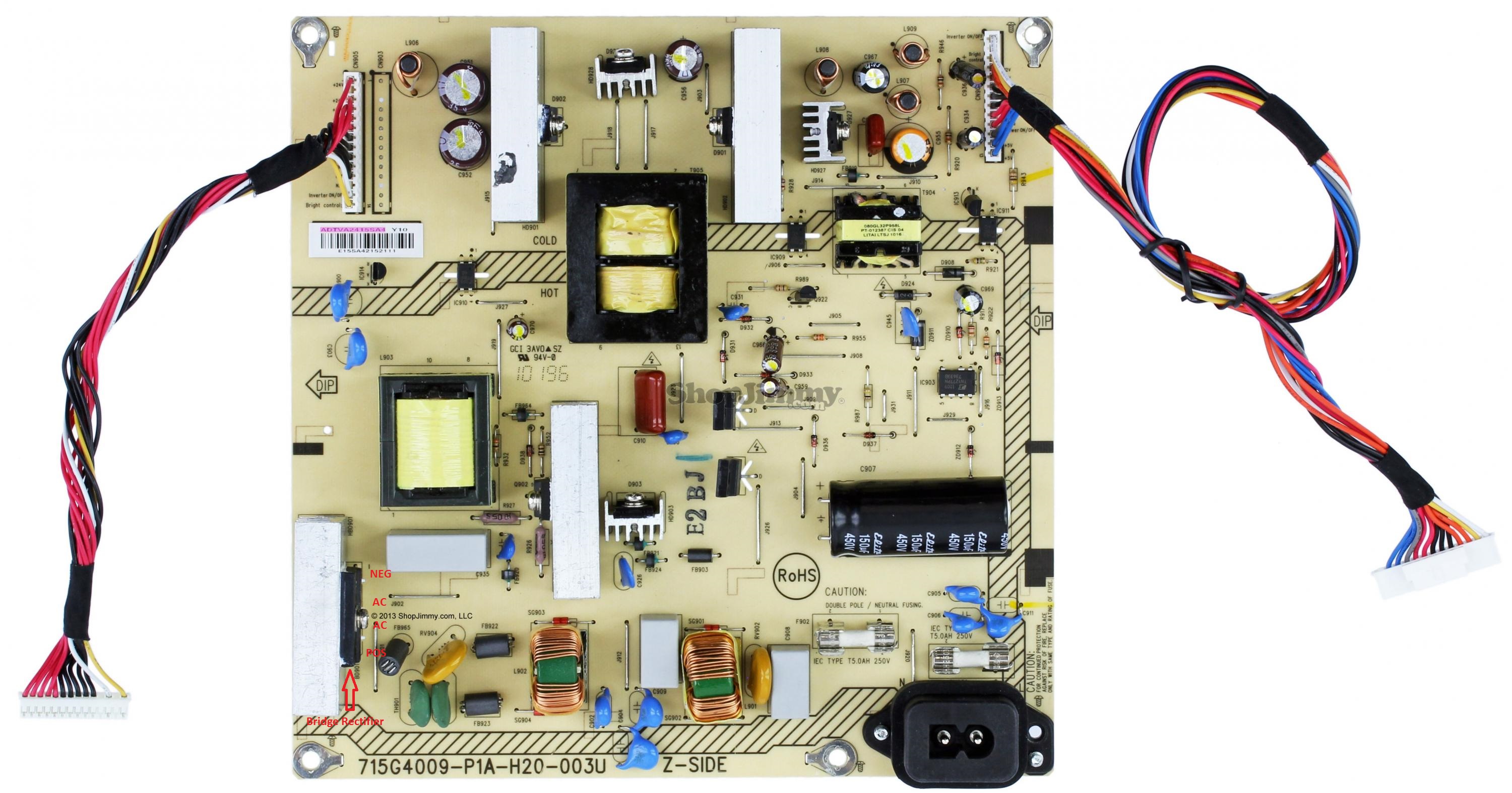

                          Sharp ADTVA2415SA4 Power Supply for LC-42SB48UT
                          Pictures provided by shopjimmy.

                            Can someone help me identify what this board's bridge rectifier is? I see nothing that looks like the ones I've seen before. I'll test it, as suggested, if I can find it!
                              Re: Sharp LC-42SB48UT-a no standby voltage
                              Look at the designator a BD901 as printed on the board.https://www.badcaps.net/forum/attach...2&d=1466534208
                              Bottom left corner of the board.
                              You just need to find out if you do have 120VAC feeding the bridge two inner pins. See post #13.

                                The bridge rectifier is BD901
