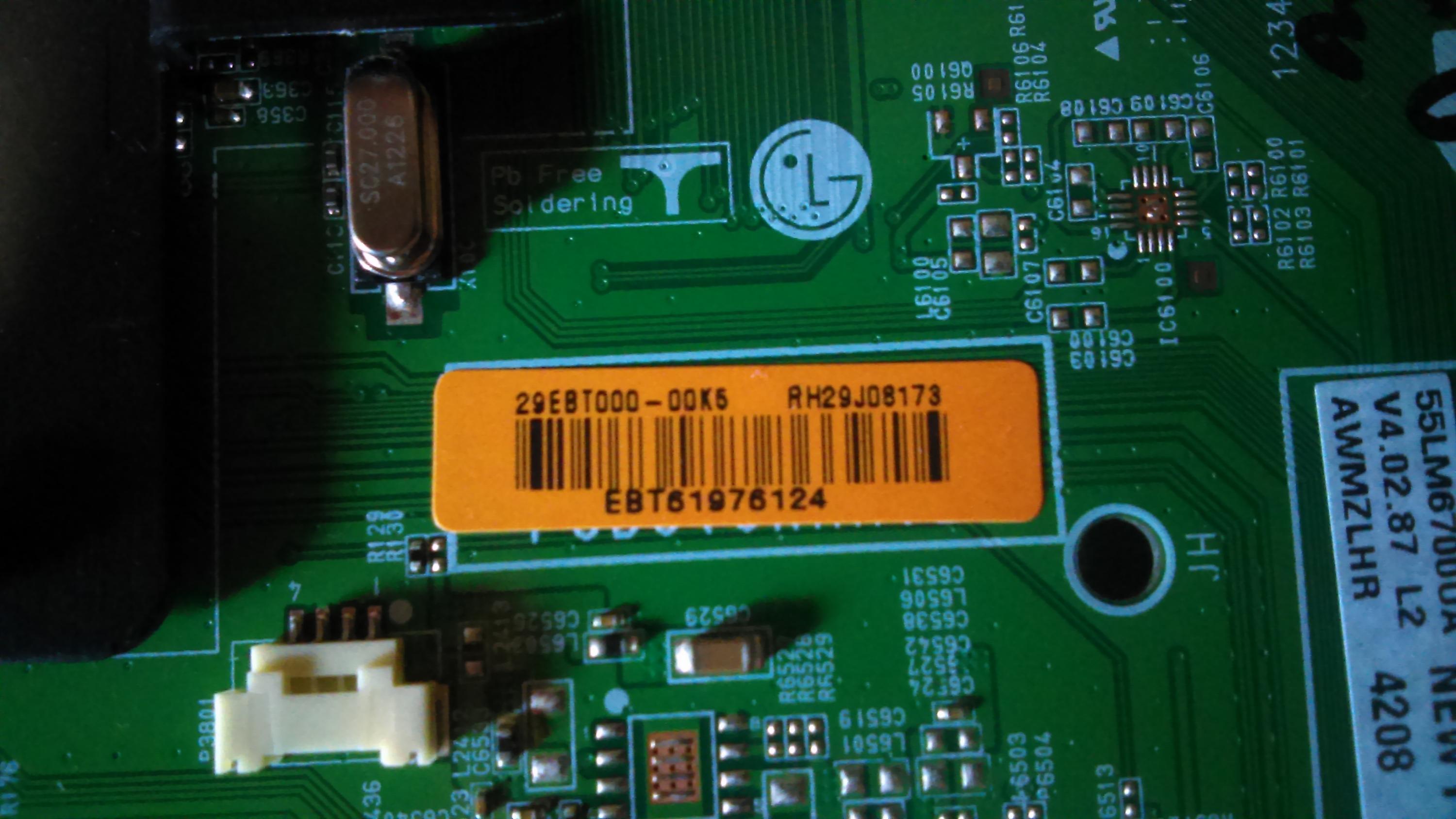

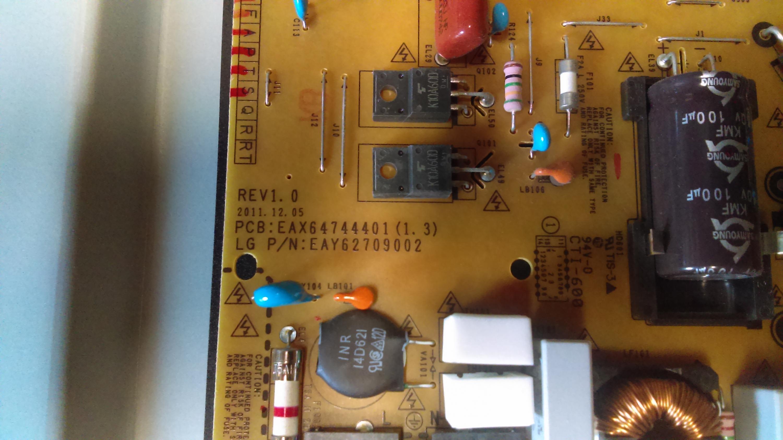

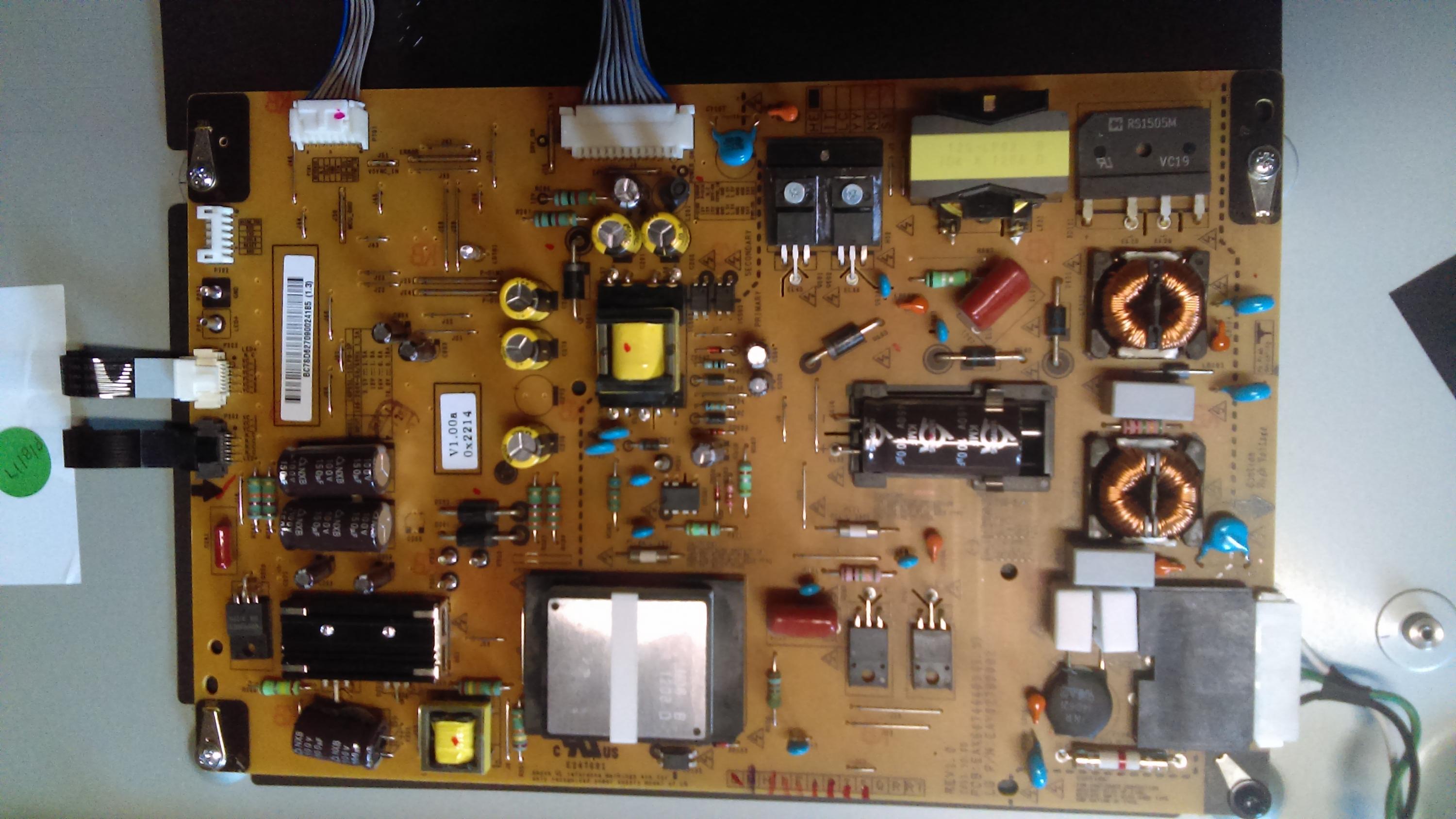

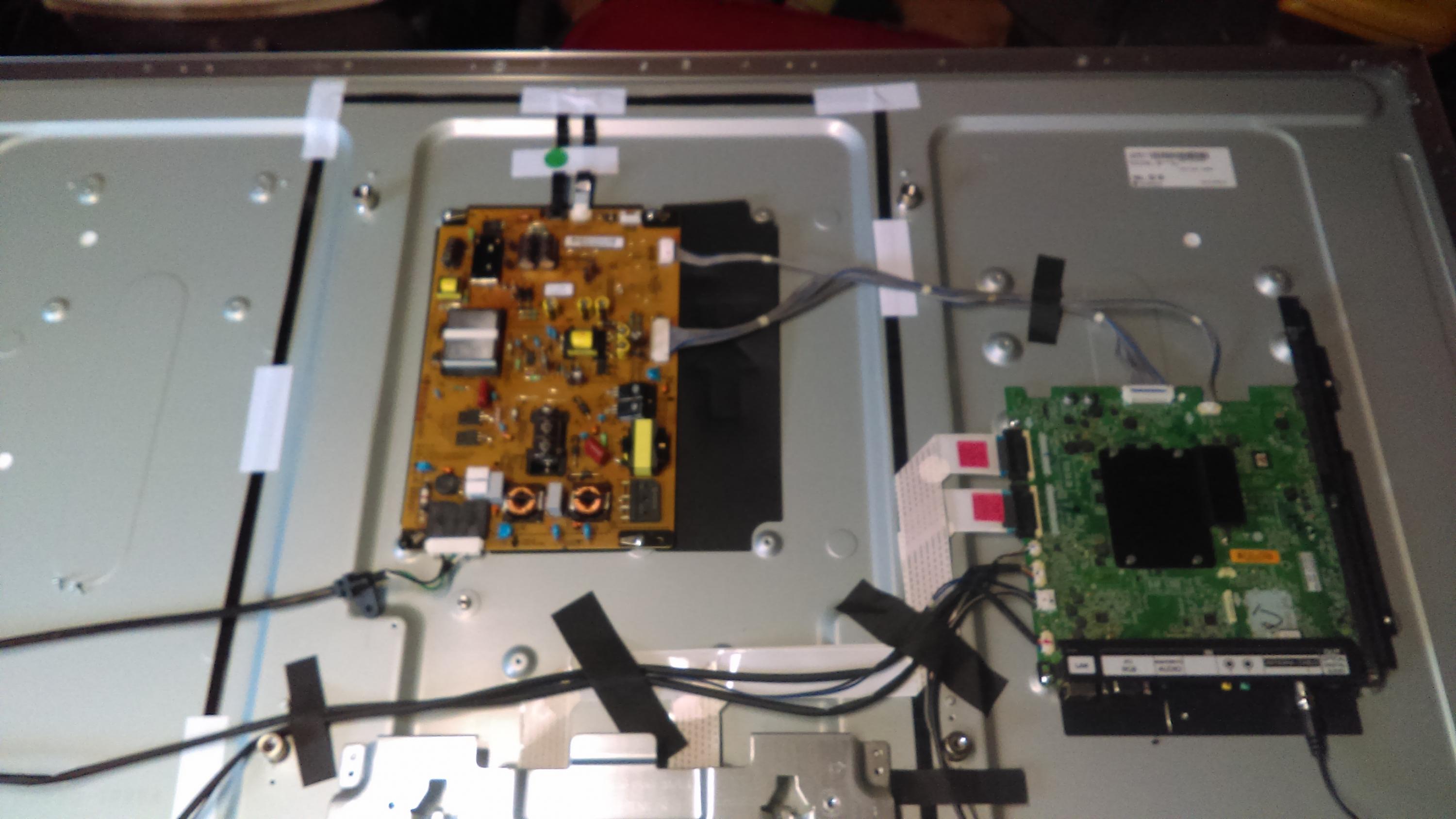

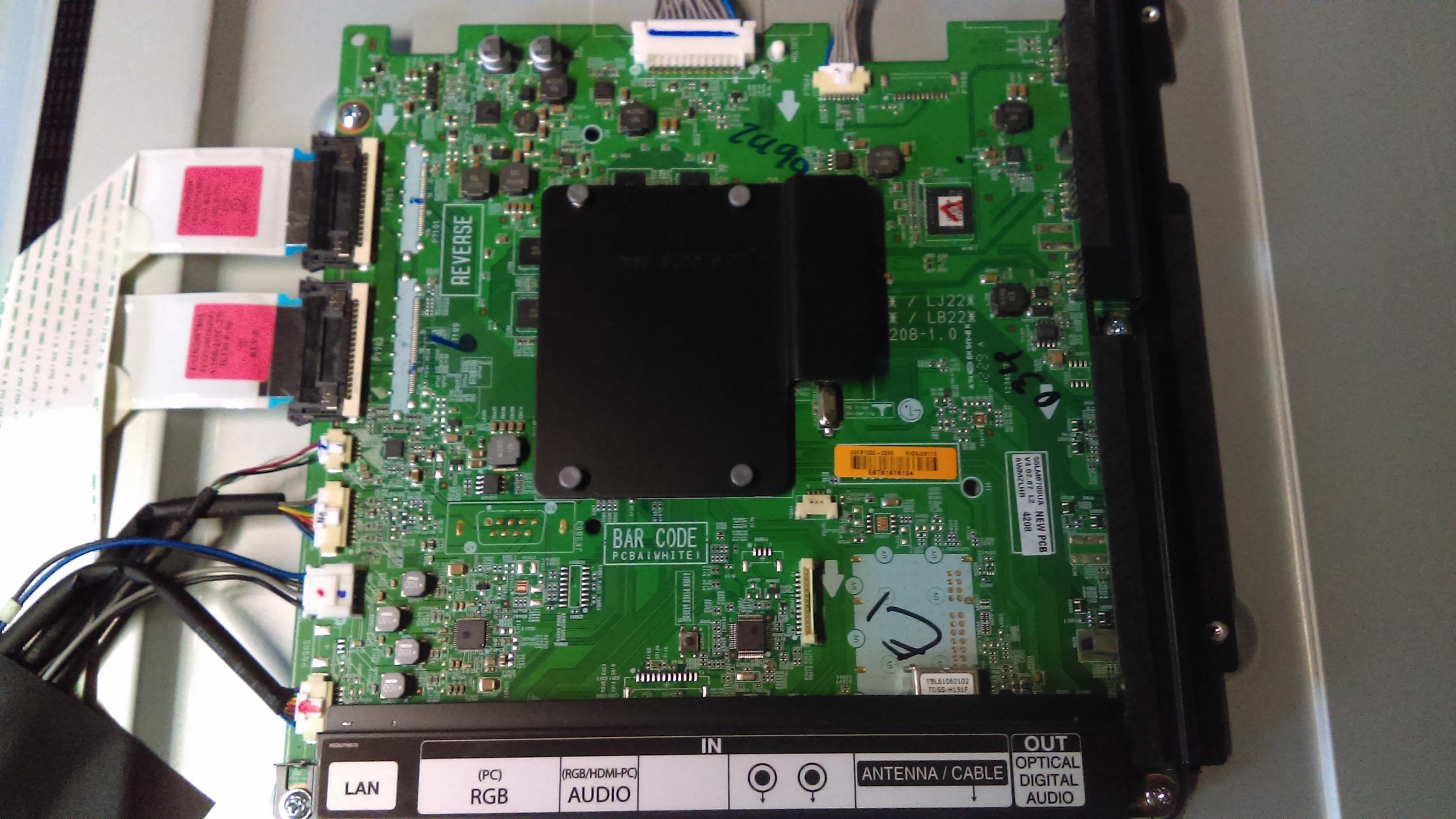

I have a LG 55lm6700 when I press power turns on like normal with a steady backlight. I have no onscreen display , pic , or sound. Below are the boards.
Lg 55LM6700 steady backlight no on screen display, pic, or sound

Do you know the history of this TV?
It uses one of those tab bonding board on the bottom edge of the panel which gets damaged when people spray cleaning fluid on the screen.
Fuse on the T-CON has 12VdC on both ends with ref. to GND?Never stop learning

TV has no tcon, 2 cables go straight from main boardComment

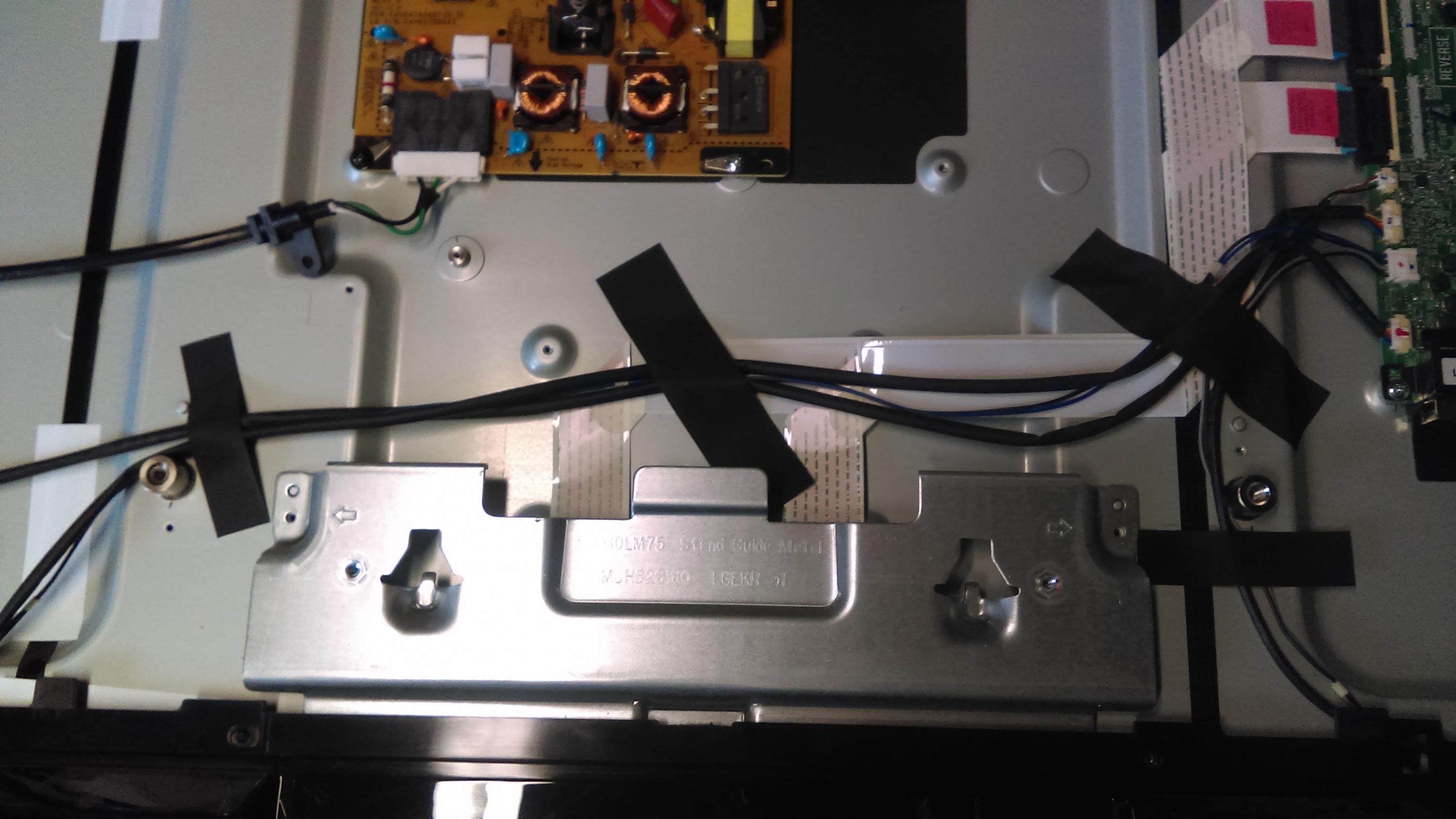

Re: Lg 55LM6700 steady backlight no on screen display, pic, or sound
It's got two cables going to two small boards on bottom of panel are those tcon or is there a separate one.Comment

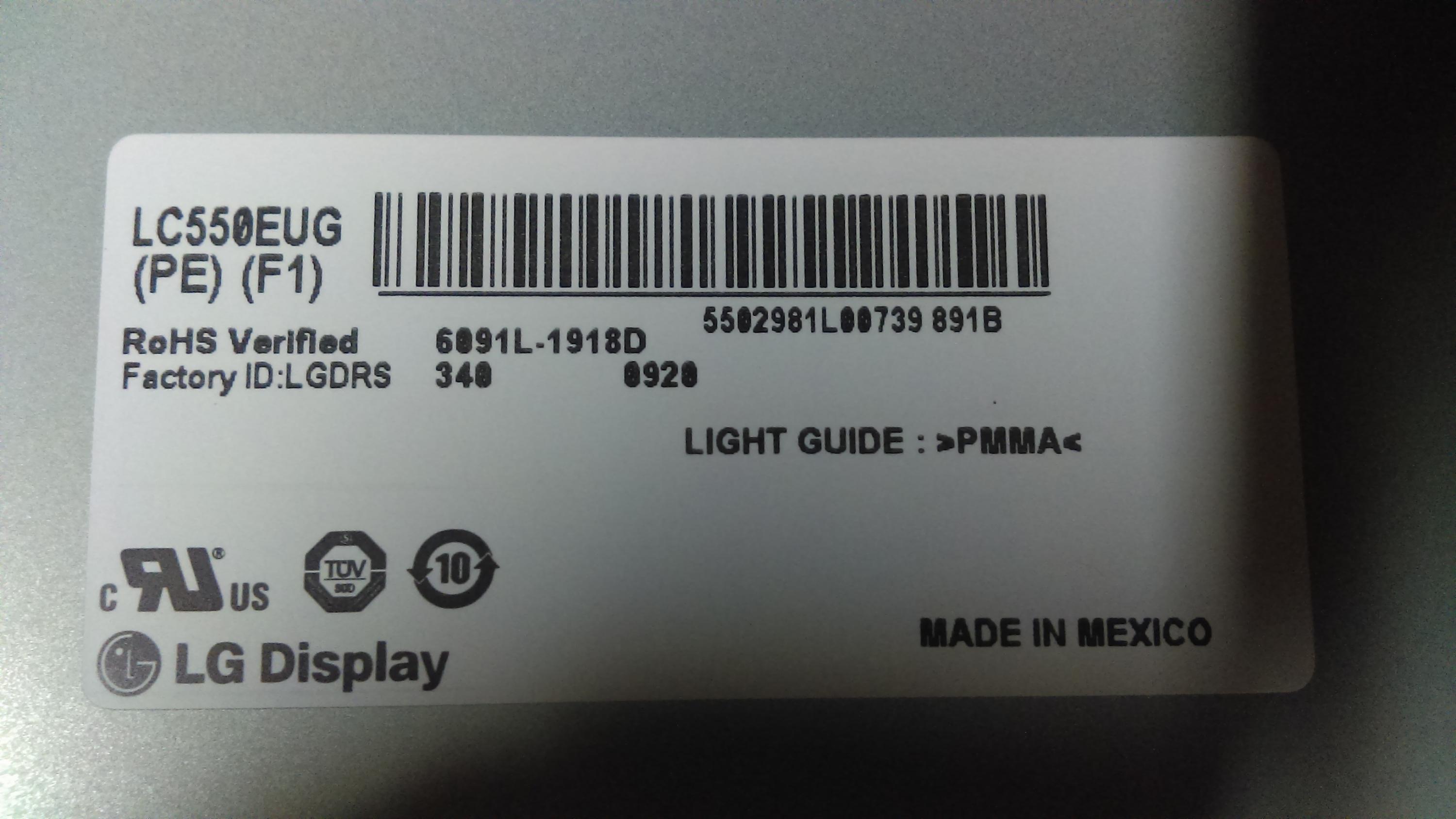

Those are the boards.
What is the LCD panel model so we can look up the spec sheet for it?Last edited by budm; 06-17-2016, 08:37 PM.Never stop learning

check to see if you get VDD at both LVDS cables to the LCD panel, you can try probing them on the main board side, at least one of those pin should show 16Vdc (typ.)Attached FilesNever stop learning

Well bad news guys I didn't follow instructions and tried probing at panel pins and shorted something. I have lines in picture now vertically everywhere. I guess this panel is toast.Comment
