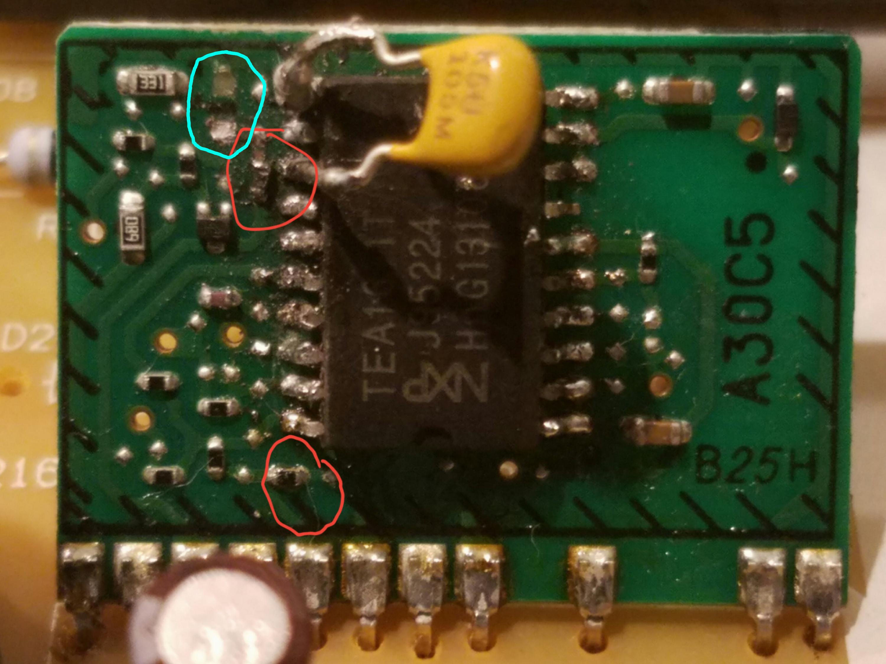

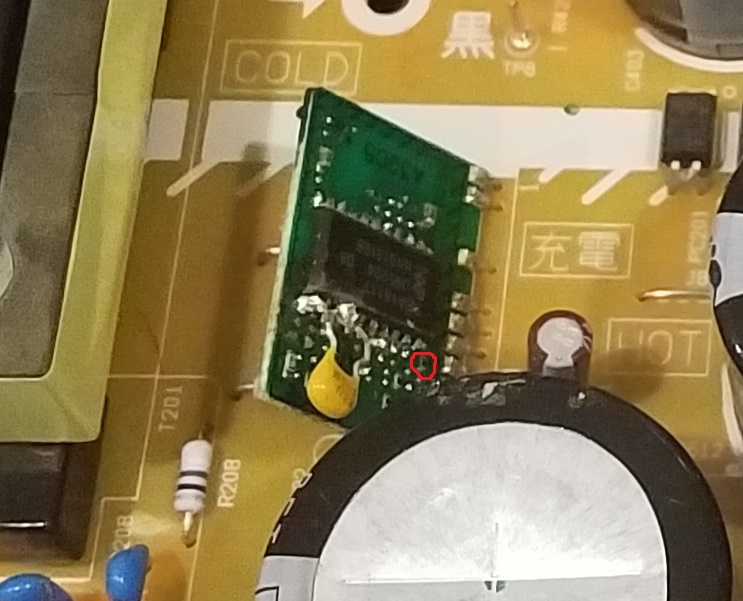

    Attached is a MC201 board from Panny TH50PZ85U. Circled in red is the item i need help with. It dislodged itself during soldering and was lost. Need to replace but not sure what to replace it with. Any help is appreciated.
    PS dont mind the poor soldering of the ceramic capacitor on the left, It has been cleaned up since.

            Check on that power supply board for another module, I know some of the panasonic power supplies did use two
            I just checked the manual and that board only has the one, Must have been thinking of a different power board
            Looks like its off pin 19 SD shut-down input but does notr list a value for the resistor

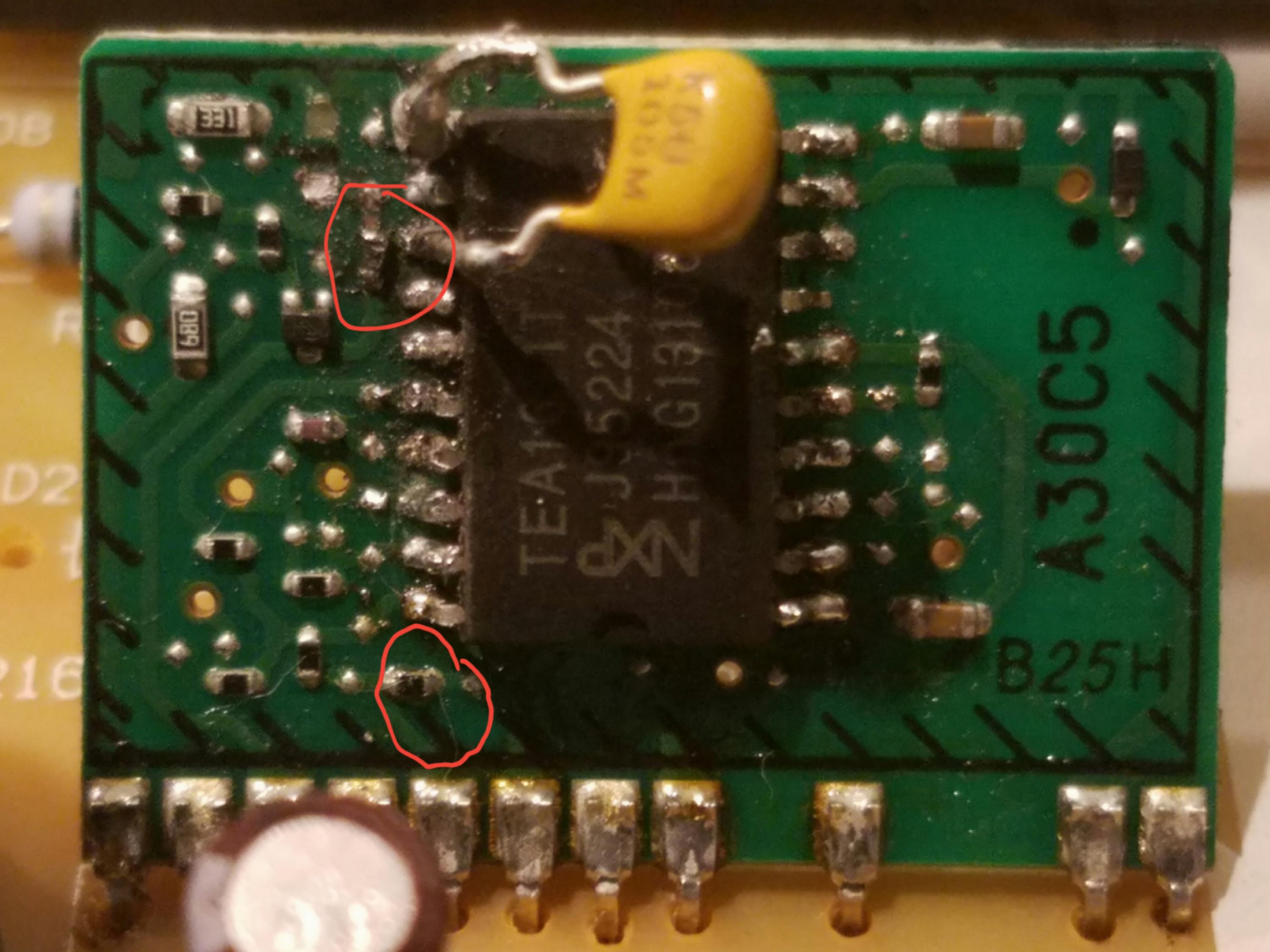

                Here is a better picture. I have searched for a datasheet but cannot find anything on this. Please help.

                  What are the part markings on the IC?
                  Edit: Is this it?

                            what about the part you knocked off that you didnt circle?
                            • Trueburton
                              • Jun 2016
                              • 49
                              Re: Help me identify this capacito/resistor
                              uh oh, where?
                              keep in mind, this is the 201 chip, The 301 is the one im missing parts for. Just easier to show locations on this one.
                                • 31191
                                here

                                  stj i think your circle is where the original 1uf cap should be ive done two of these set now i solder the cap onto the pcb pads after removal of the old smd one it looks like hes soldered the new one on to the ic legs but in the top red circle is something missing?
