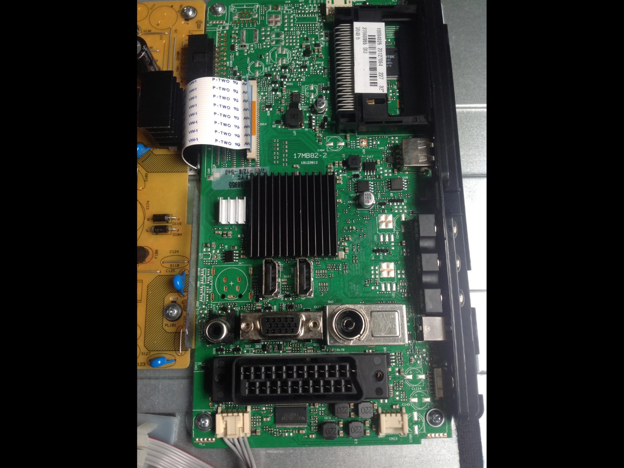

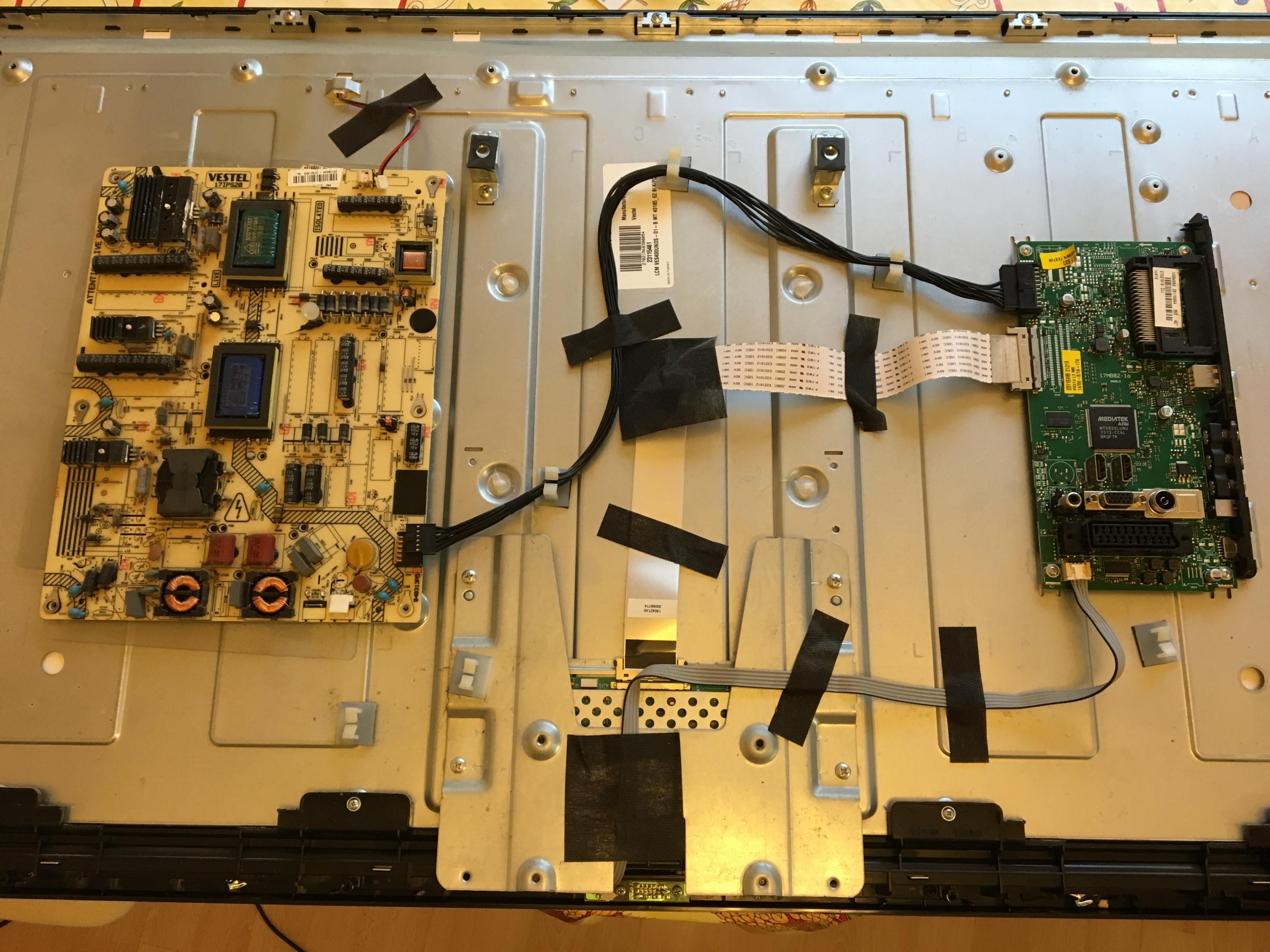

    just saved another tv from the tip, and again asking for help to fix it
    Polaroid P40LED13
    Vestel boards
    Power board 17IPS20
    When TV is powered up it starts up normally with a picture, after about 5 seconds it shuts down then restarts and shuts down as if in a loop
    Just taken the back off nothing obvious standing out as a fault
    I suspect power board fault but may be wrong, you guys know a lot more than me.
    or is it possible for a failing led on the backlight to cause this.
    will post pictures of boards in a few mins as soon as i get them off phone onto computer

      Re: Polaroid P40LED13 powers up then shuts down
      P40LED13 Pics
        back of power board
            Here is a link to the repair video should fix the fault:
            https://m.youtube.com/watch?v=kPCisa9BYkk
            Check on google for 17mb82 core update folder to download it then follow video.

                      Bit premature I still have a problem with this TV
                      Just caught it but after some time on maybe 15 20 minutes the tv is loosing its picture as shown in photo, speakers make a loud shrieking noise then it shuts down and reboots again working.
                      I have done a factory reset from menu, turned backlight and brightness down,and also rebooted from usb update again, still shutting down after some time
                      Could this still be software or some other problem.
                      When is on seems fine picture is good
                      • london-freddie
                        • May 2015
                        • 472
                        pics showing tv working and at point of shutdown
                            The Cpu might be overheating has it got the thermal pad under it ? I had one where someone removed the Cpu cooling pad causing the set to shutdown as the Cpu got too hot. Also check all screws are in and wires tightly pushed in.
                                    refitted thermal pad under board and fitted a heatsink on top of chip with thermal paste, still shutting down after 10 15 minutes
