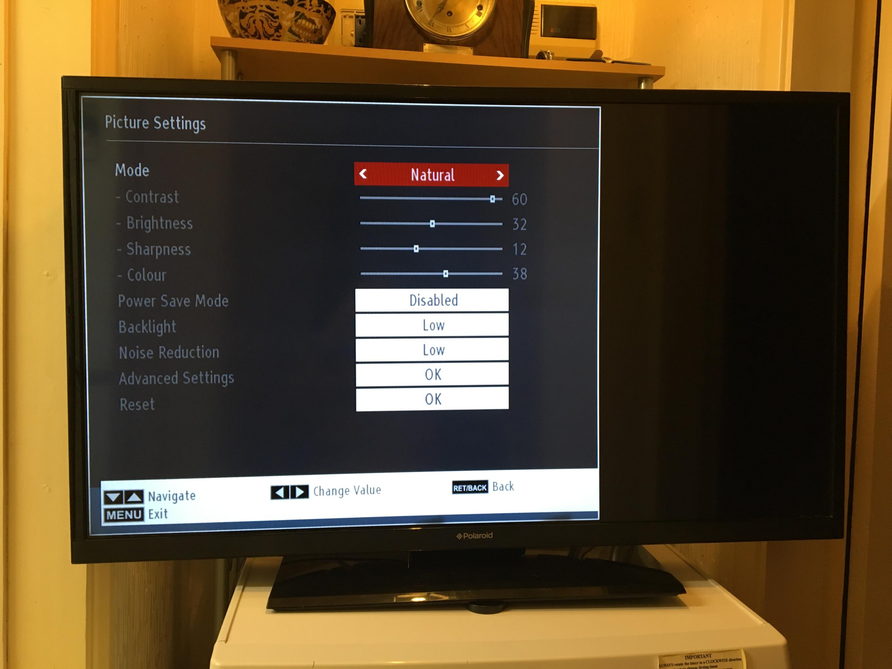

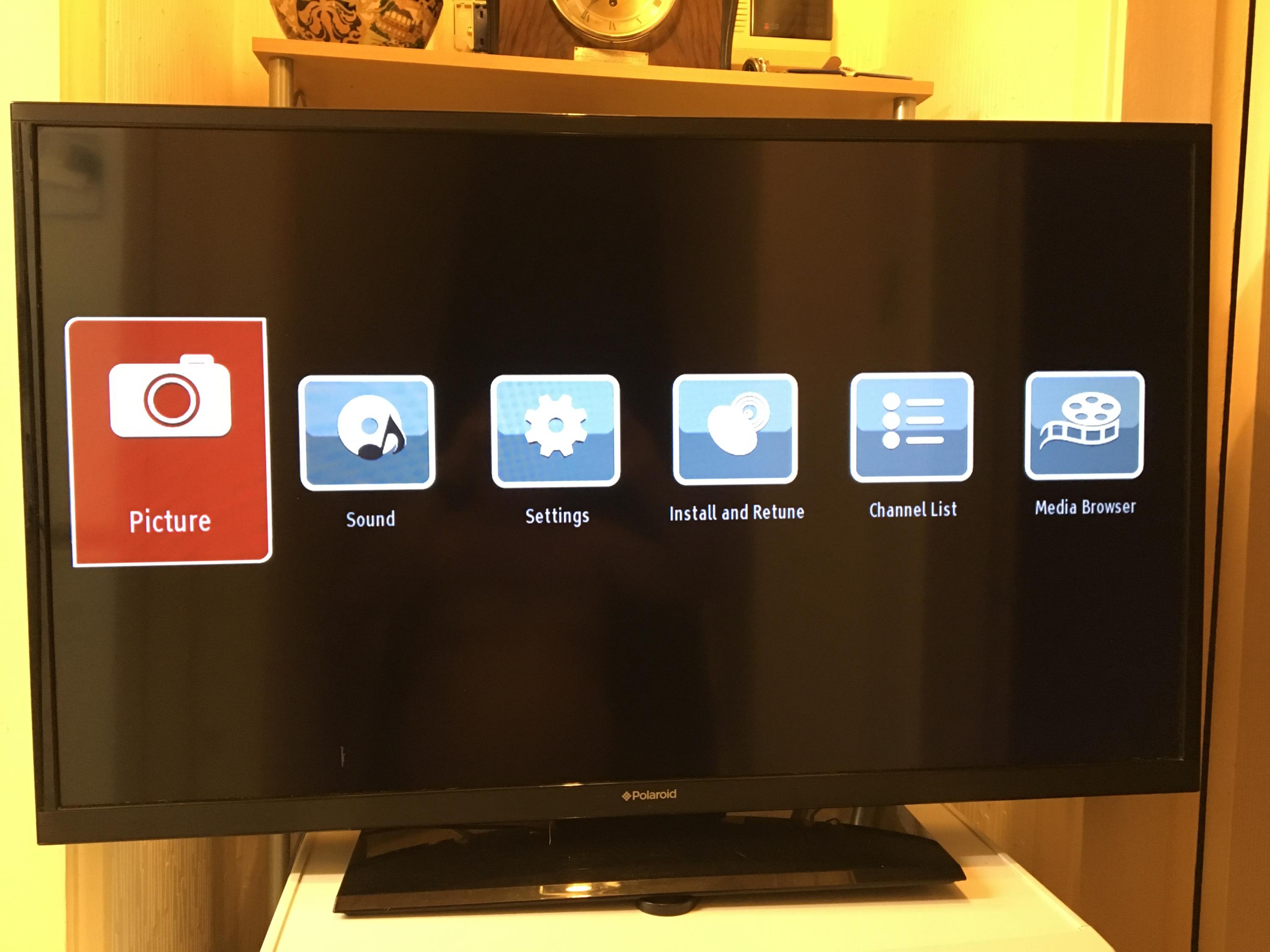

          Did you download the Vestel Driver 17mb82-2 ? Also got image of the menu system ? Also dont give up yet I wouldn't, if you do I have a board for this set for £20.
            Re: Polaroid P40LED13 powers up then shuts down
            think update i got off vesteldriver.com was 17mb80*** awkward as all in turkish, I think it is still a software fault on this tv
            mainboard number is 23115995 23115994
            do you want a picture of menu if so which page of menu
            may well have the board off you if it will sort this tv
              Just the menu in general. Also link I use:
              http://www.vesteldriver.com/TV_MB82_CORE_UPDATE.html
                Yes that is the link that i used to download from MB82 V.0.84
                just powered up the tv again to take pics of menu, while taking them tv switched off about 6 times different colours on screen each time red, green, pink etc
                will download pics in a few minutes
                  menu pics
                    #29
                    Thats really odd, at this point Im unsure whats causing it to crash like this mate with out having it in front of me Will have a check on the web and let you know if I find anything got to be firmware related unless you missed something obvious. I presume you left the Usb in till the set came back on too ?
