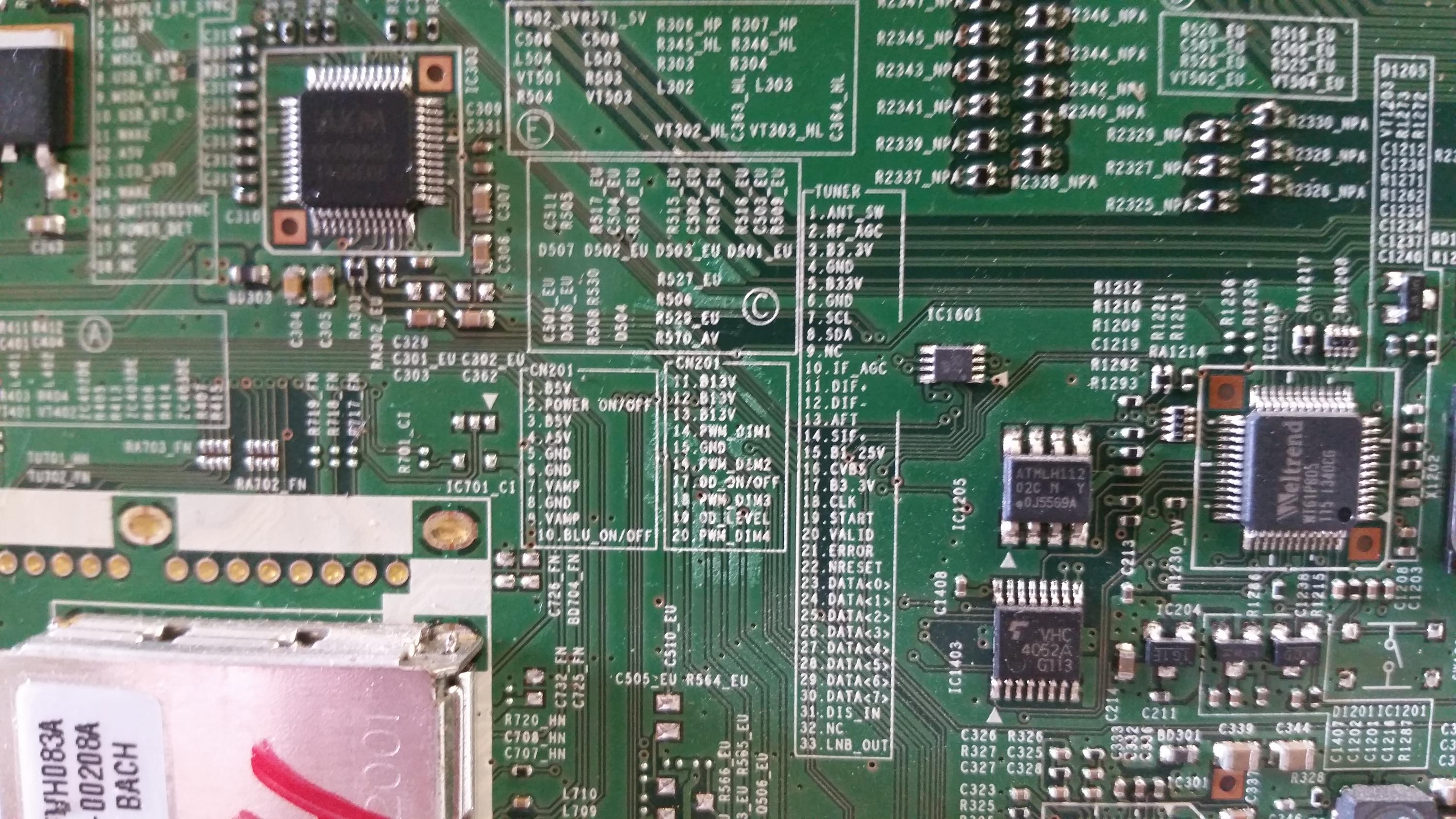

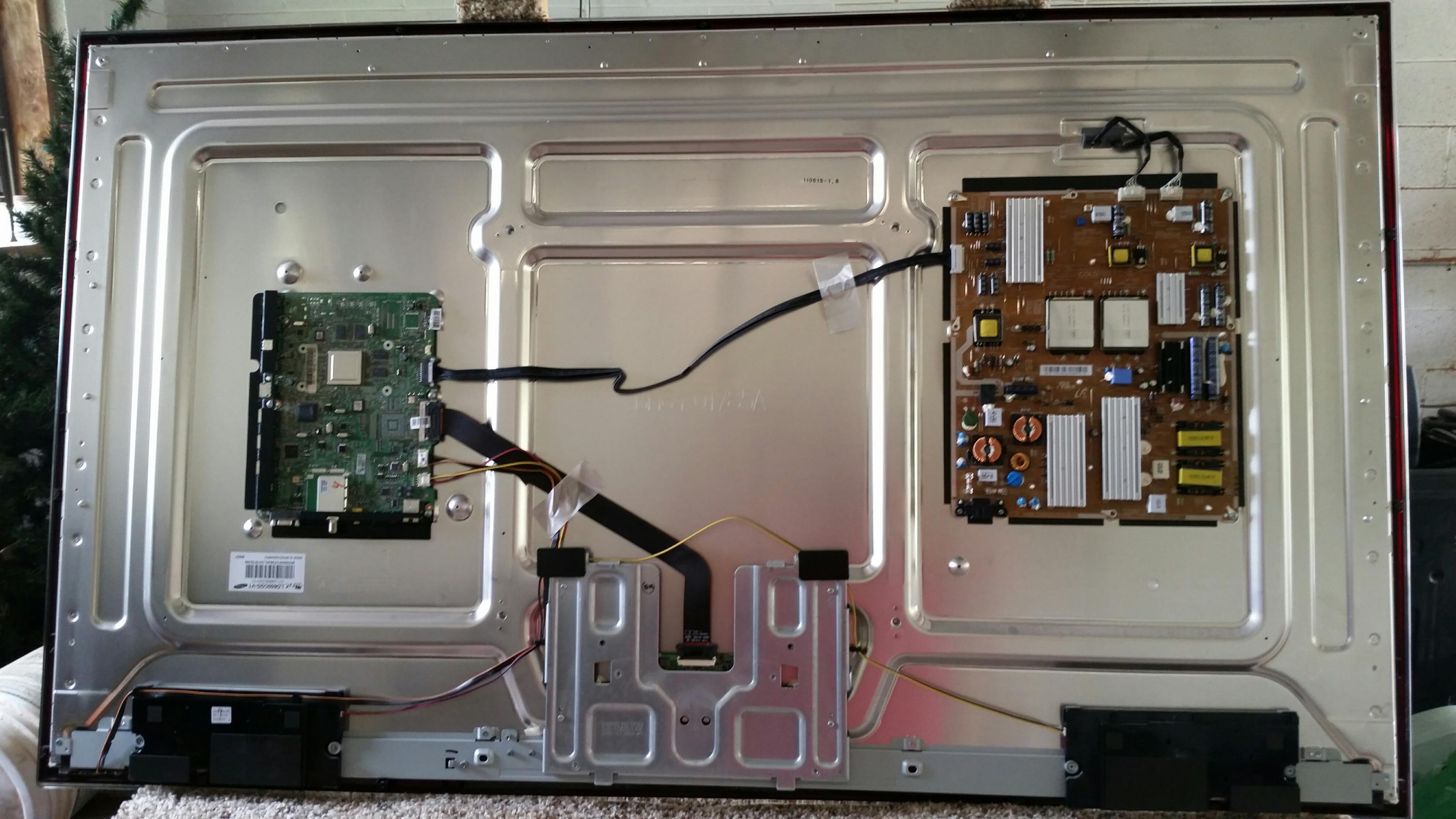

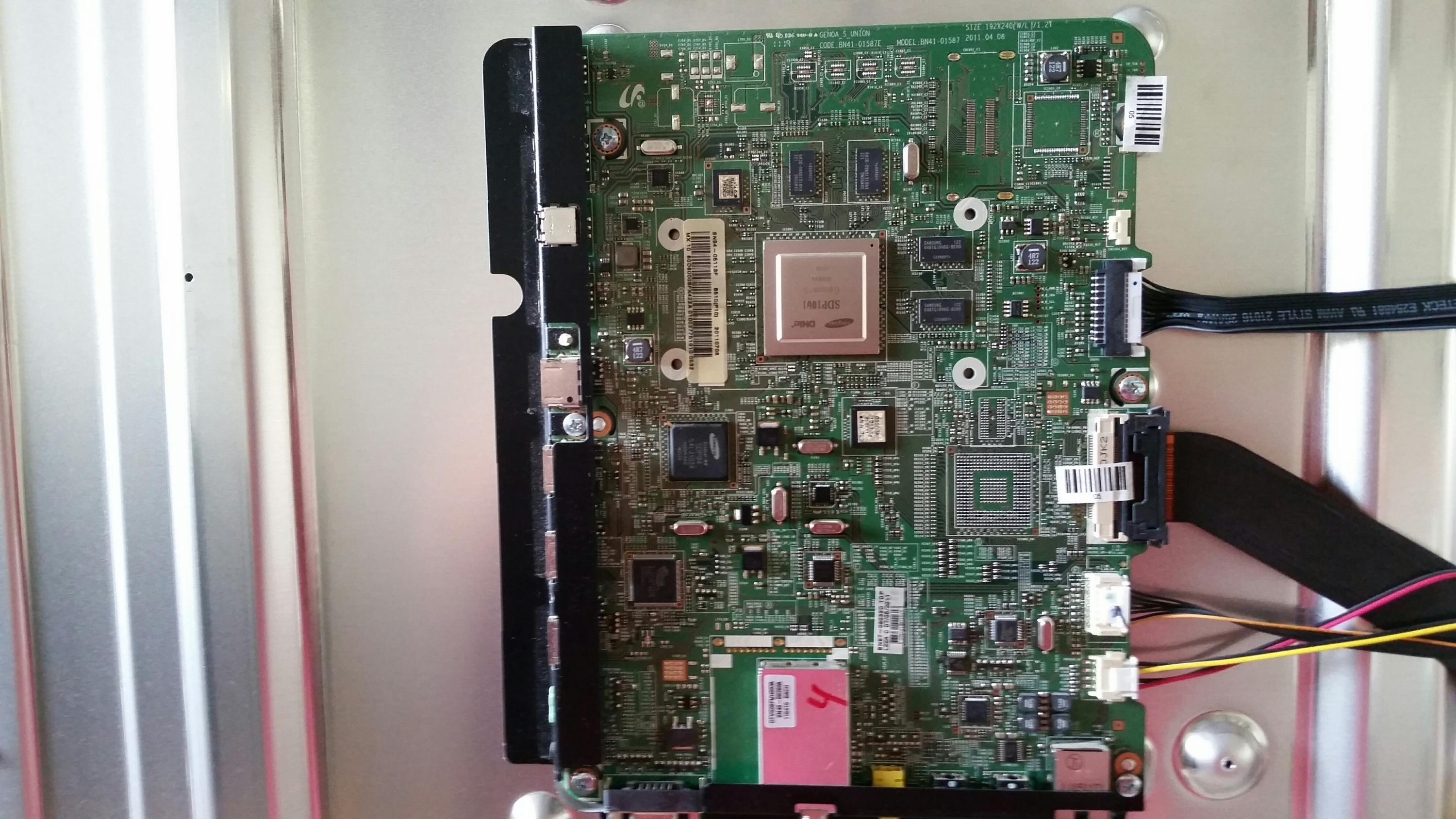

    Previous owner told of unit not starting screen just dimly flashing..When I first fired it up..it started and ran just fine..turned off and on a dozen times and fired every time. So I left it running for an hour or two to see if maybe I could reproduce the failure. after about 90 min, sure enough. Dim backlight flash like it's trying to fire but not completing the power up.. Let sit overnite and opened it up this morning..Backlight is coming on for a fraction of a second then going off..cycling over and over. Producing a clicking sound from power supply board. When I powered set down, clicking continued for four more cycles, each one further apart than the previous..I have not found alot of failure history on this model set...I welcome any sugestions.

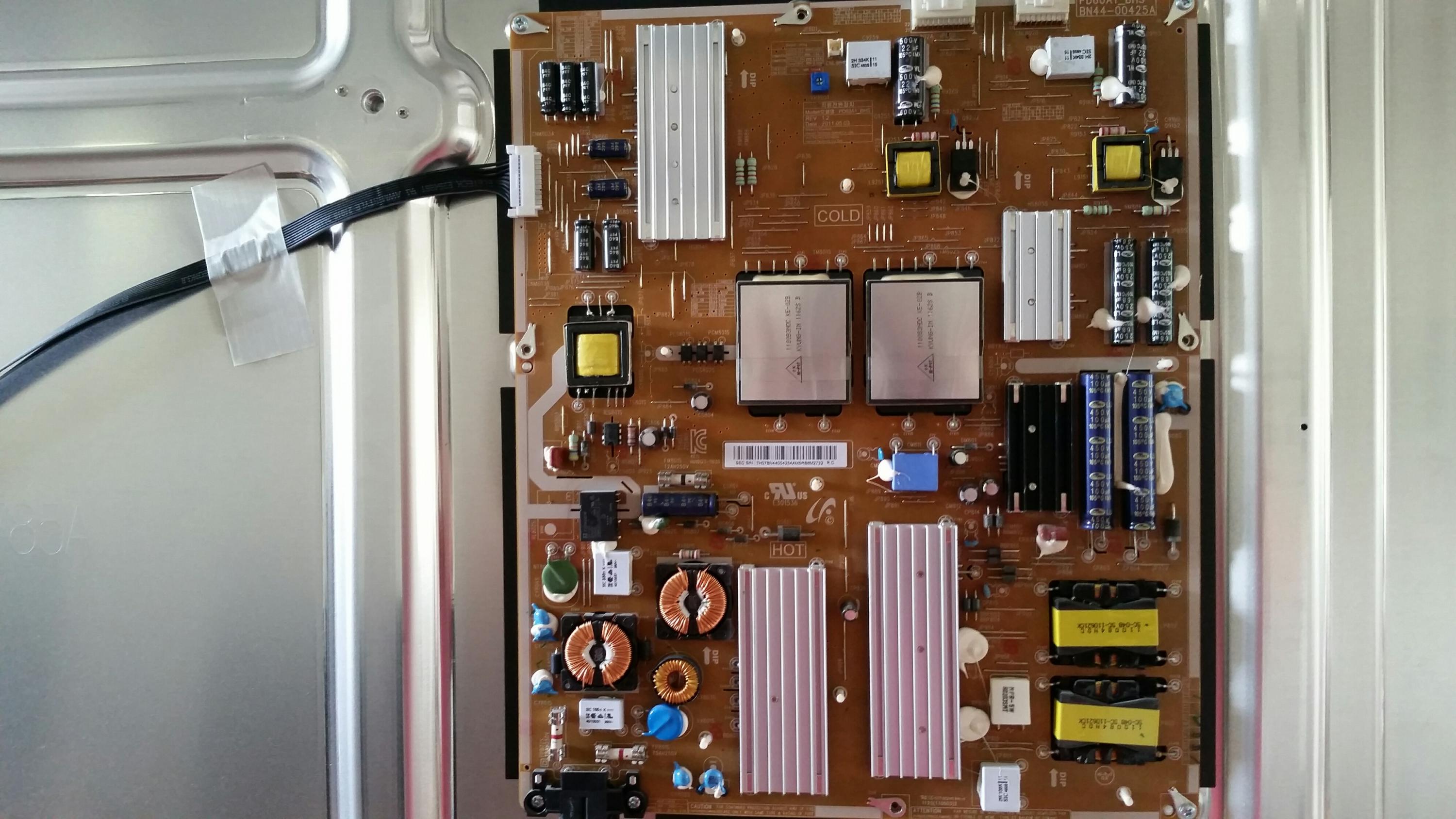

    lots of missing screws on the psu,
    they may be needed to connect the earth's together.

      I thought the same thing..in the service manual it shows only the mounting screws that I found installed. Weird. I have found many instances of this issue..There is even a repair kit for the SMPS to address the symptom I am experiencing.

            SMPS is generating all the proper voltages.

              What voltage do you have driving the leds. The board says 333V @170mA

                Probably a failed Led tripping the driver tbh. Does the Led drive voltage start off fine then collapse ?

                  One of the LED driver plugs shows just over 400 volts the other shows 335.

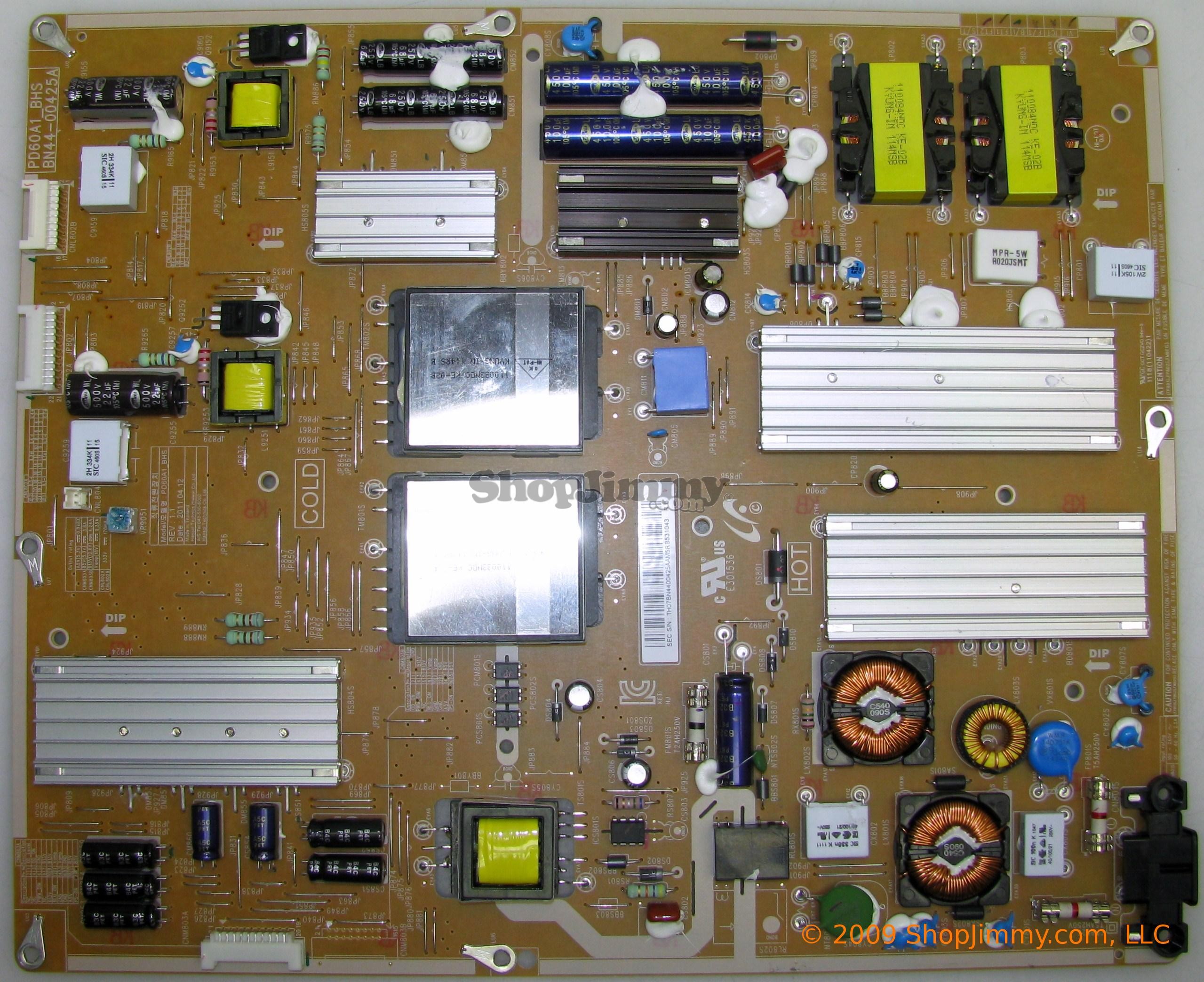

                                        Re: Samsung UN60D6000 LED Backlight flashing
                                        Here is a better picture of the power supply board!(courtesy of Shopjimmy)
                                        Mine is identical. (Pic in first post)
                                        I appreciate everyone's input!
                                        LJ
