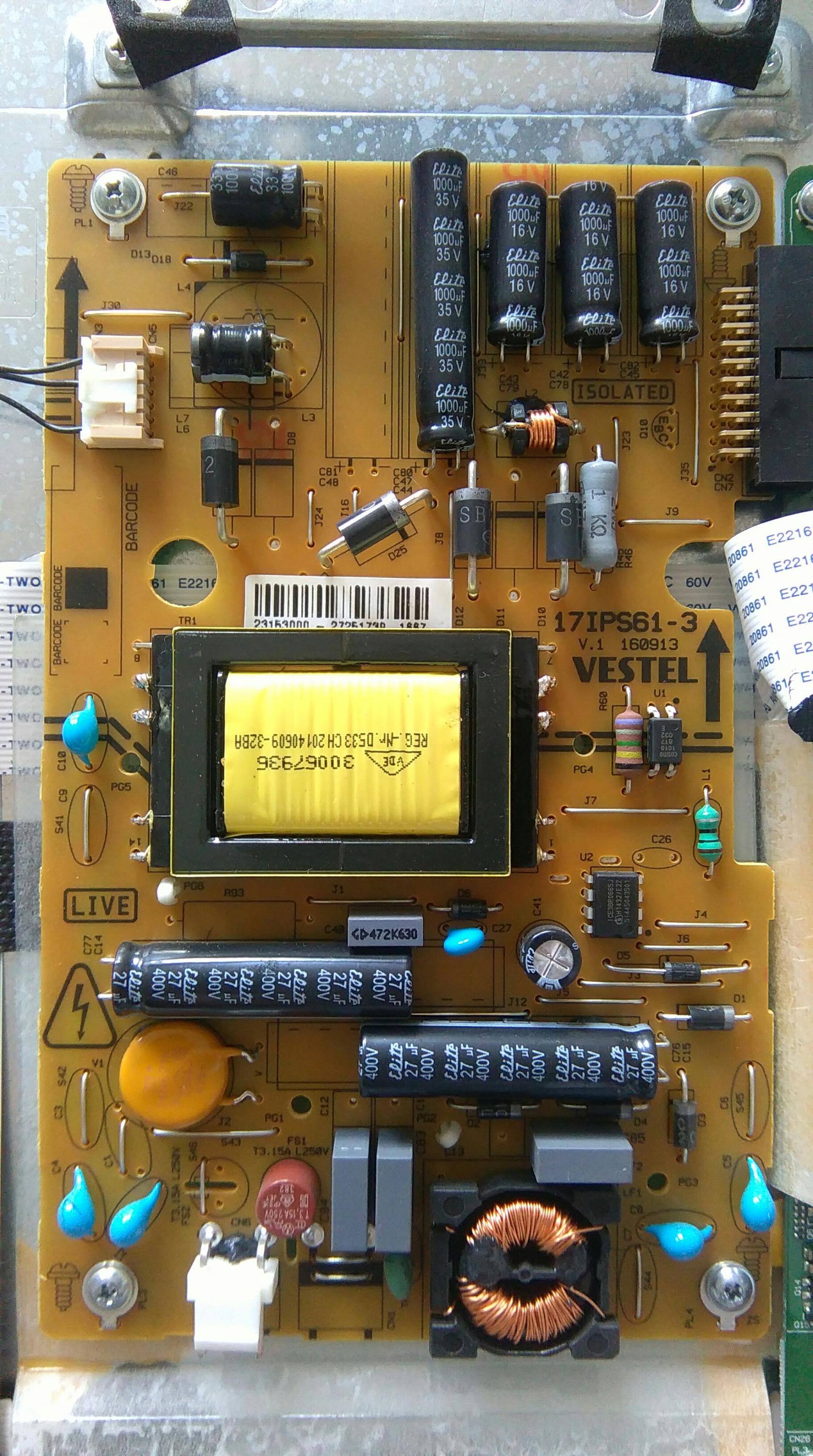

    I'm new to this so please bear with me. I've been reading plenty of threads and so I'm hoping I've tracked down my issue.
    My toshiba 24d1434db has no power, not even the standby led.
    The capacitors all look OK and there doesn't appear to be an obvious blown component from looking at the board.
    I've found threads for the Vestal boards which appear to indicate faulty diodes may be the issue.
    I've tested with a multimeter and get the following readings:
    D8 - no diode fitted
    D9 (UF5402) - 0500 and 1000 when poles reversed
    D10 (SB5B0) - 0030 and 0050 when poles reversed
    D11 - no diode fitted
    D12 (SB5B0) - 0030 and 0050 when poles reversed
    D25 (SB5B0) - 0030 and 0050 when poles reversed
    So I understand it's likely to be only one of the SB5B0 diodes but I'm best replacing them all. Can I fit a better diode? Any suggestions?
    Should I replace the UF5402 diode as well or is that reading all ok and best left as is?
    Can I fit extra diodes in D11 and D8 without any issues? (On one thread someone appeared to do this). Would this reduce the chance of a future re-occurrence as well as using thermal epoxy?
    Thanks, your help is appreciated.

    with diodes if im not sure i always unsolder and lift one side off the board and retest that way sometimes you can see if diodes are leaky too.

      Checked if you have a voltage on the other side of the diodes ?

        I thought I'd read the voltages on both sides and listed them above. Will re-check with my multi-meter later but sounds like I probably need to unsolder one side first.

          Right, so I've de-soldered the diodes and taken the readings again
          D9 (UF5402) - 0500 and OL when poles reversed
          D10 (SB5B0) - dodgy
          D12 (SB5B0) - 0300 and OL when poles reversed
          D25 (SB5B0) - 0300 and OL when poles reversed
          So, my original questions still stand
          I'll replace all the SB5B0 diodes but is there a better diode I can fit? Any suggestions?

            Re: Toshiba 24d1434db / Vestal 17IPS61-3 help
            tom66 in another thread recomends these
            http://www.ebay.co.uk/itm/UF5408-Rec...item25789d54dd
            https://www.badcaps.net/forum/showthread.php?t=41922
            But if it was my set i would replace like for like with the diodes but i would change all of them in one go
              Those, or MUR460 / HER308G.
              Needs to be a fast diode, so 1N5408 is no good. UF5408 is a fast type.

                  Just to clear up some of the information above, are we saying:
                  Replace the UF5402 with a UF5408
                  Replace the SB5B0 with a SB5100 or similar (from this post https://www.badcaps.net/forum/showpo...5&postcount=48)

                        All fixed with the new SB5100's.
