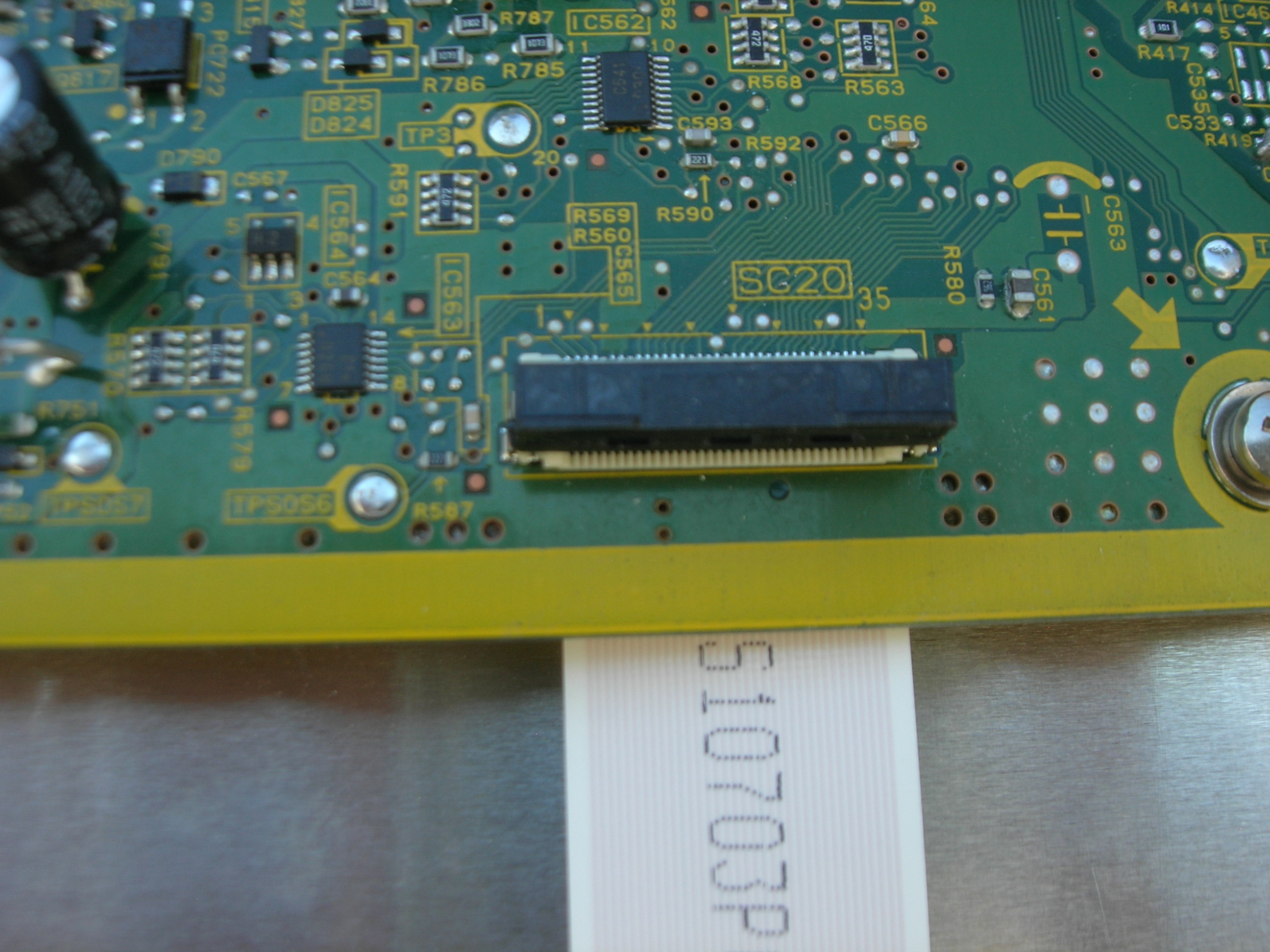

        Alrighty then- this one is kicking my butt. I took my time and replaced everything on my list. Paid close attention to soldering and inspected every part with my magnifier.

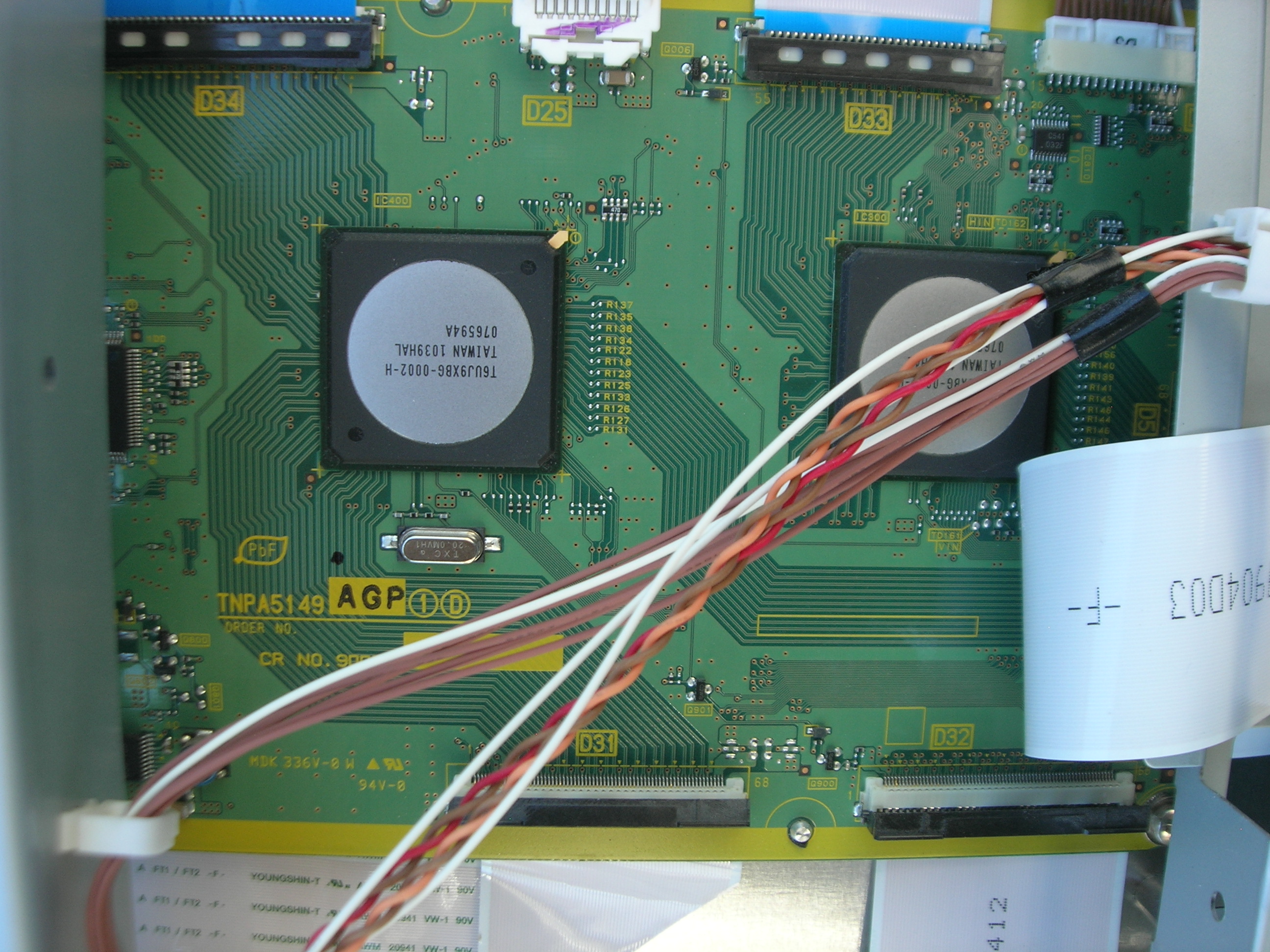

        I still get six blinks. I removed SC20 and still got six blinks. This plasma has the D board so the SC20 is connected to it.

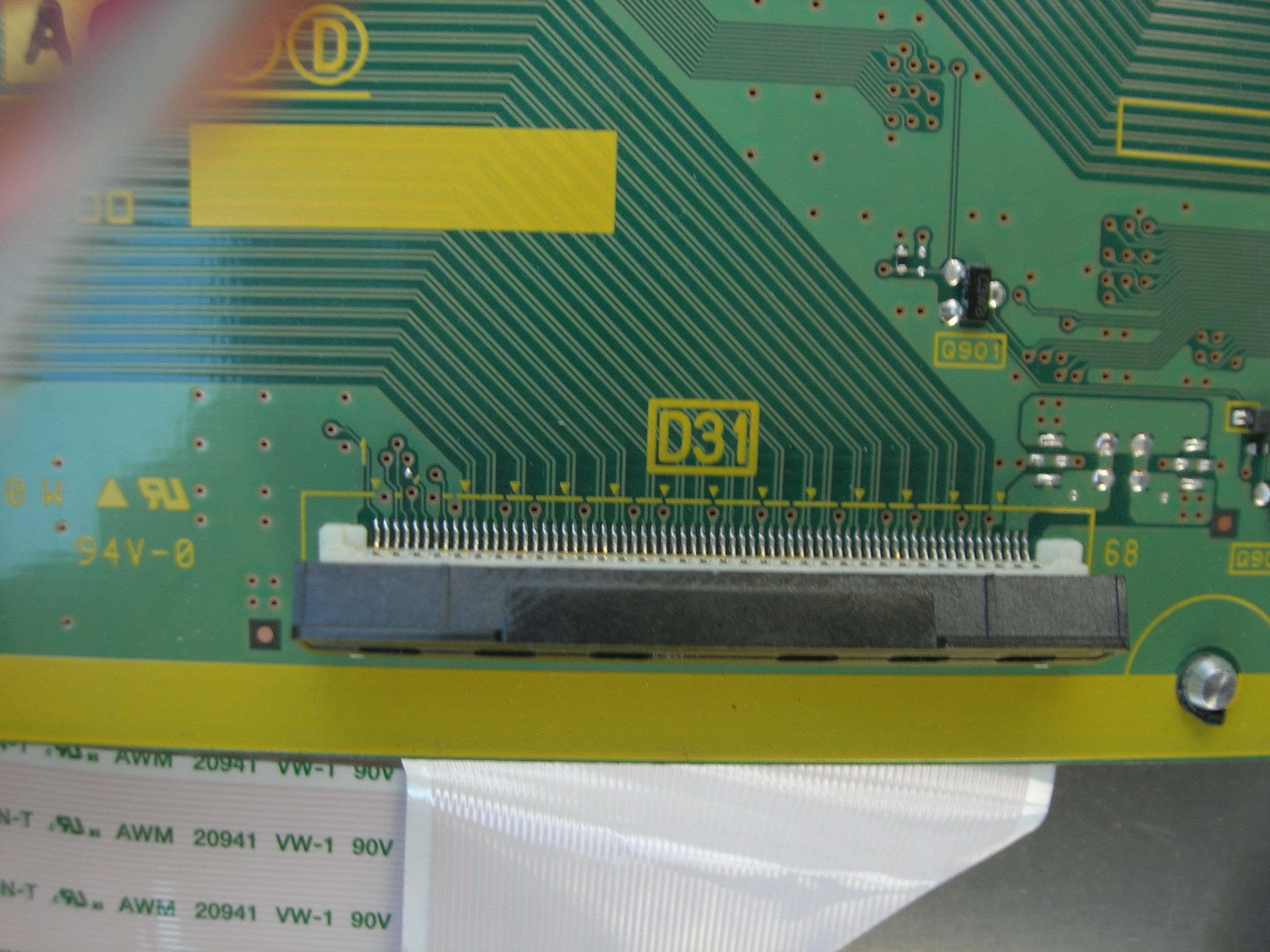

        I then removed the lower C board connectors D31, D32 from the D board with SC20 still disconnected and the tv powered up and SC led was lit and did not shut down.
        I connected D31 connector and it still did not shut down. I then isolated the lower C boards and removed C26 and connected D32 and it went to 8 blinks.
        So that's where I am at. I certainly don't want to scrape this tv, but, man it sure is getting frustrating. Any help would be greatly appreciated.
          #64
          Re: Panasonic TC-P58VT25 10 blink
          Just a note, I did not have the ribbons under the board when testing, I just did that for pictures.
          Also if the SC20 is connected at any time it shuts down with 6 blinks.

            I guess I should also add, I know its still in the SC board but did not know if the ribbon disconnected of the lower C boards would be a certain section I should be looking at.
            I spent hours on Fathers day checking every resistor and diode and all the items I replaced and everything checks.
            I installed my spare off the P58S2 and it still works with only the top half of the screen.
            I was trying to see if I could use that board but I think it's the lower buffer thats different.
            I thought about getting a lower buffer from a P58S2 and see if it would work but I dont want to do damage to that board.
            Thanks for any thoughts on that. Happy Fathers Day to all the dad's out there.

                          I think I will keep checking my SC board for the 6 blinks and see if I can figure it out.
                          It seems like it powers on for about 5 seconds before it goes 6 blinks. I do have the buffers isolated.
                          It looks like something in the Vad line from the schematic, so I will check all related items. TPSOS6 starts at 0 volts and then goes high to 4.87 volts thus the shut down.

                                Have a look at the board there is a tpsos6 pad close to sc20.safer to probe there. It may be worth watching. It is possible to have the sos cct go bad but very rare.

                                      Well back at it. I took a break so I would not go insane. The voltage on tpsos6 starts at 0 volts when plugged in and rises after I power it up.
                                      It seems to fluctuate a bit but shuts down at 3.9 volts and it drops to 0 volts.
                                      Code 6 shows related to SC energy recovery (MID) but not sure what part of the circuit is related to that.
                                      I have been all over the board checking everything and nothing looks to be shorted but sometimes its hard to tell if something is open or not working correctly.
                                      I know code 6 can be ribbon cable connections but I have checked all numerous times.
