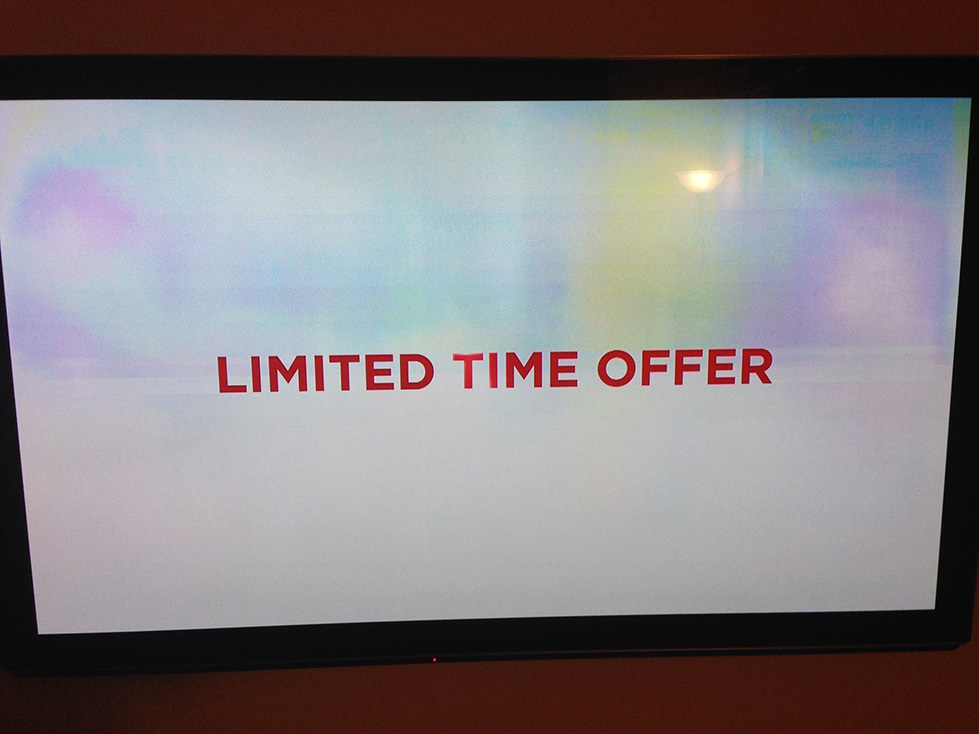

    Years ago my tv gave a 7 blink code which turned into 8 during diagnosis. I had ordered a replacement ss board but somehow the tv started working again and i never used the board. Now a week ago my tv flickered and shut off at random and gave the 8 blink error code. The same issue it had all those years ago. The only difference this time is that over the last few months there has been some purple and green tinge that comes and goes in more solid colors such as white.

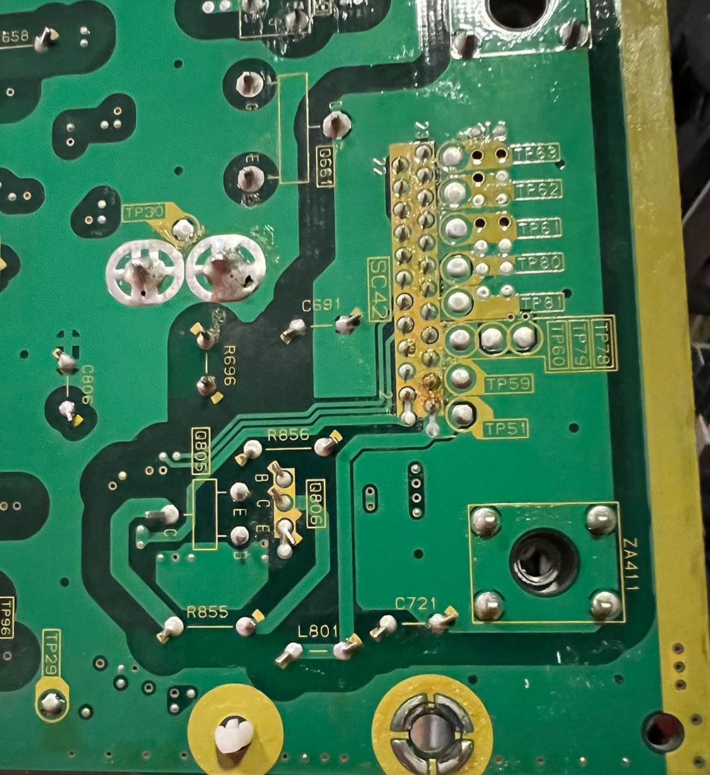

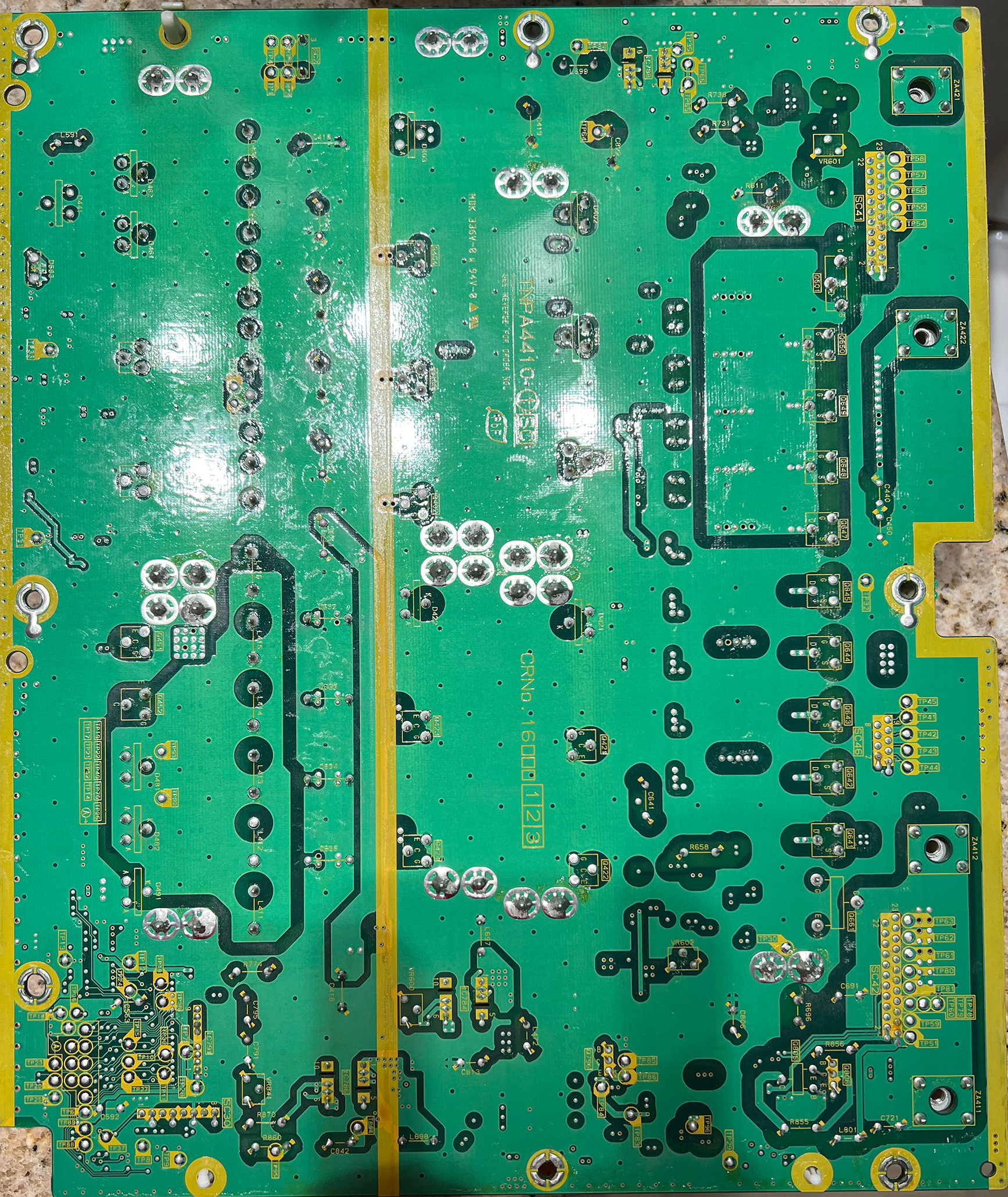

    Anyway i checked all the screws and replaced the ss board with a known good one and still got 8 blinks. I saw a post where people were discussing the purple/green color issue which usually comes with a 7 blink error. So i pulled the sc/su/sd boards. The little ones look fine. The SC there's some brown spots and one mounting screw the metal is sort of chipped a bit but im not sure if this would cause such an issue. After cleaning and putting the tv together i ended up with the same 8 blink error. Tried turning the tv on a few more times with the same result and then one last time and its been on for 3 hours running fine. The purple and green tinge hasn't shown up yet either.
    I attached pictures to give an idea of what im seeing and what the sc board looks like. Who knows if it will stay working tomorrow but any idea what could be causing the problem? And a side question, when replacing the ss board you shouldn't have to touch the pot adjustment correct?
    Any help is greatly appreciated.
    What the flicker looks like
