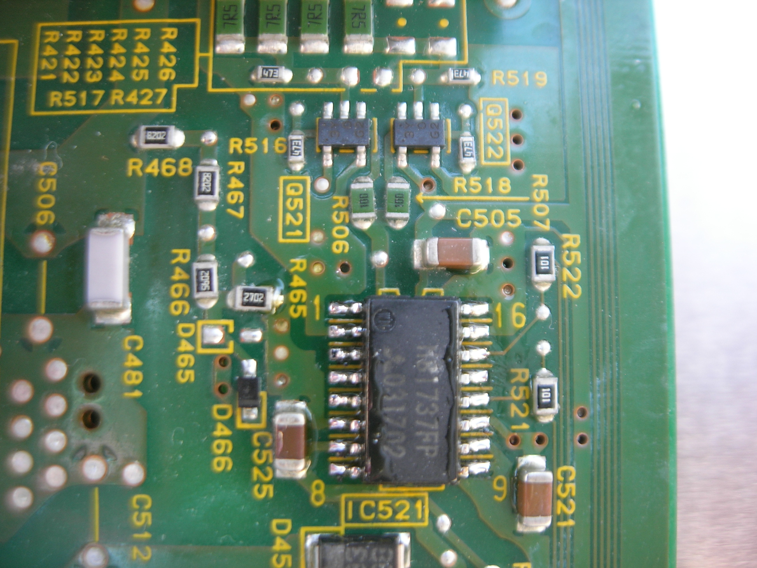

                If you can, take some shot good enough of the board so I can zoom in. Particularly around the Q661 area and IC521 area

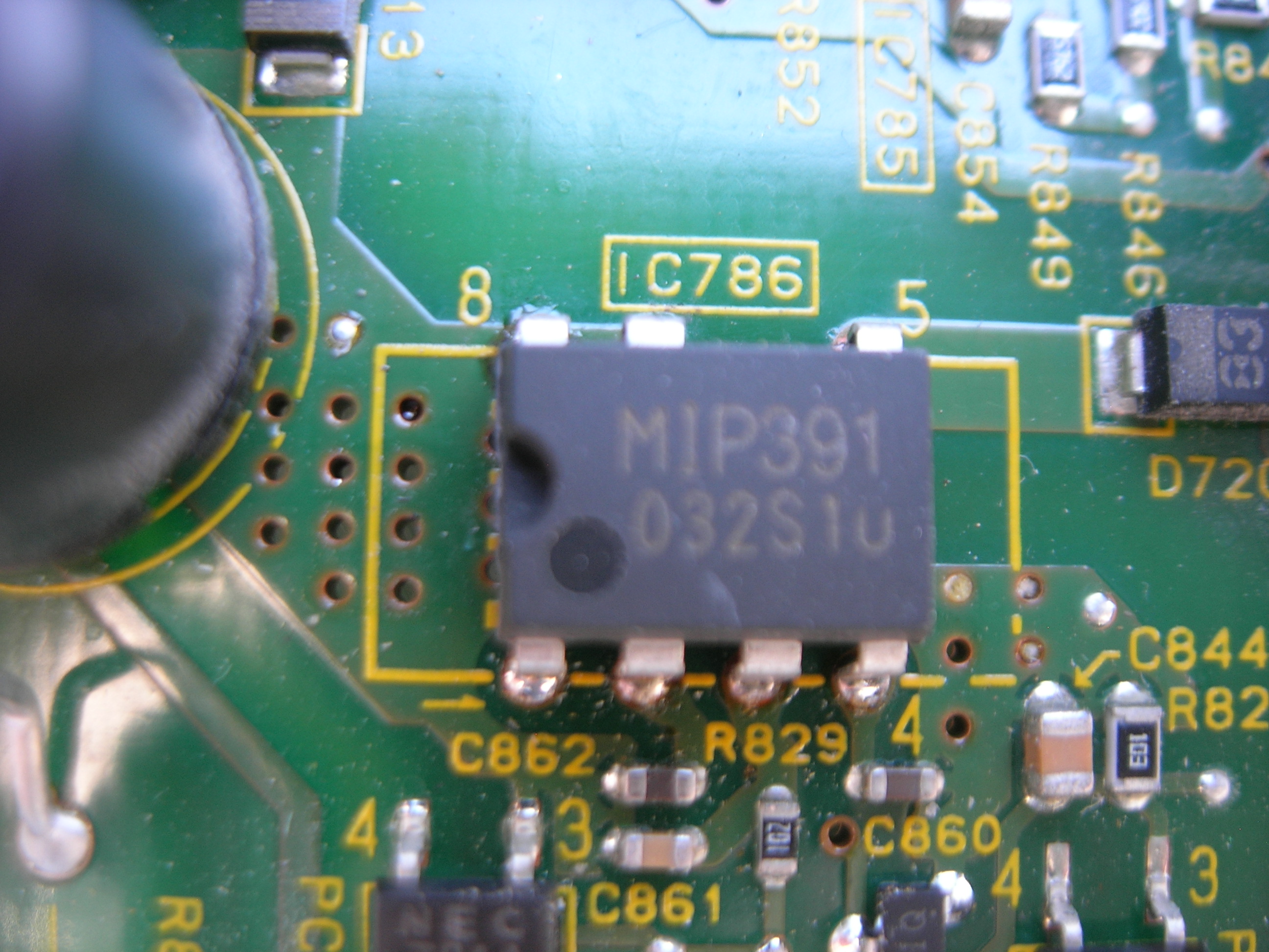

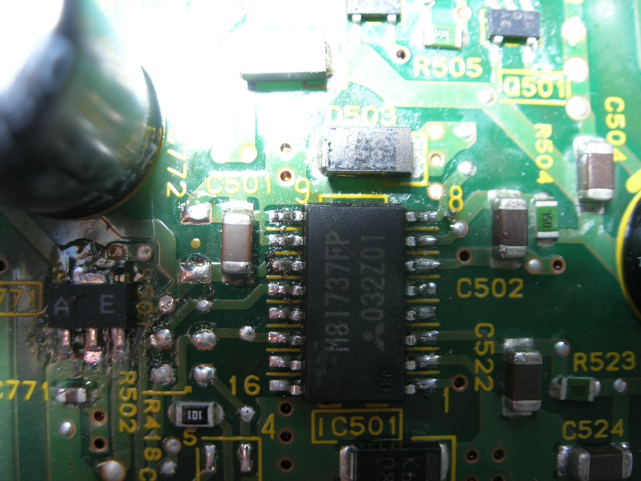

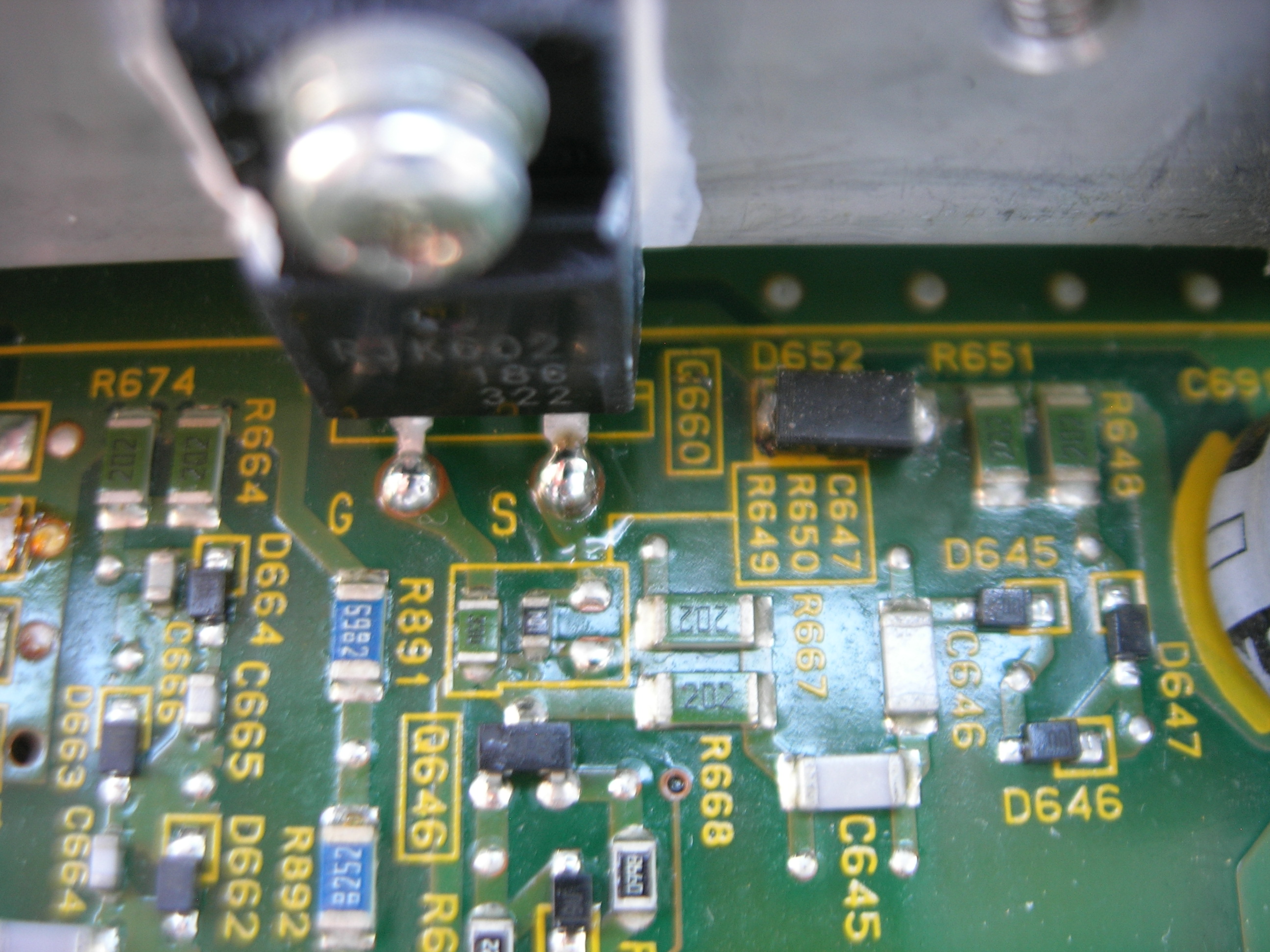

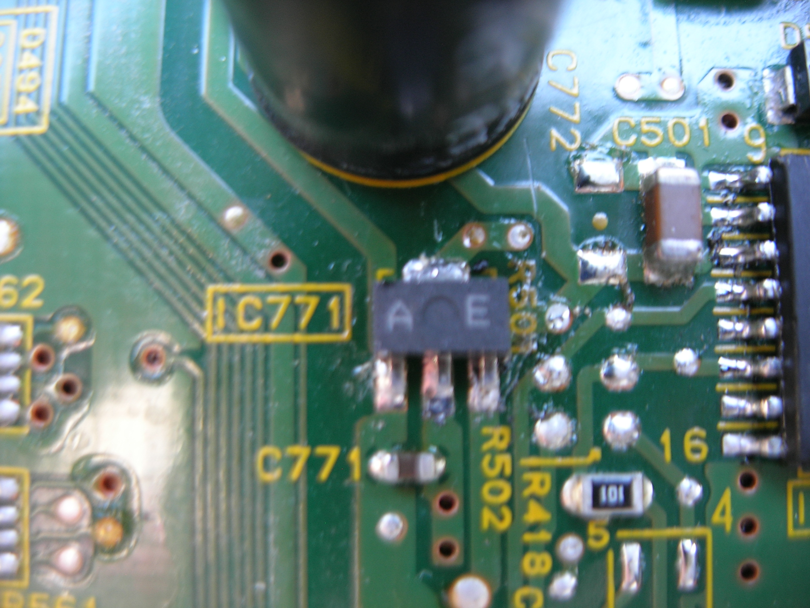

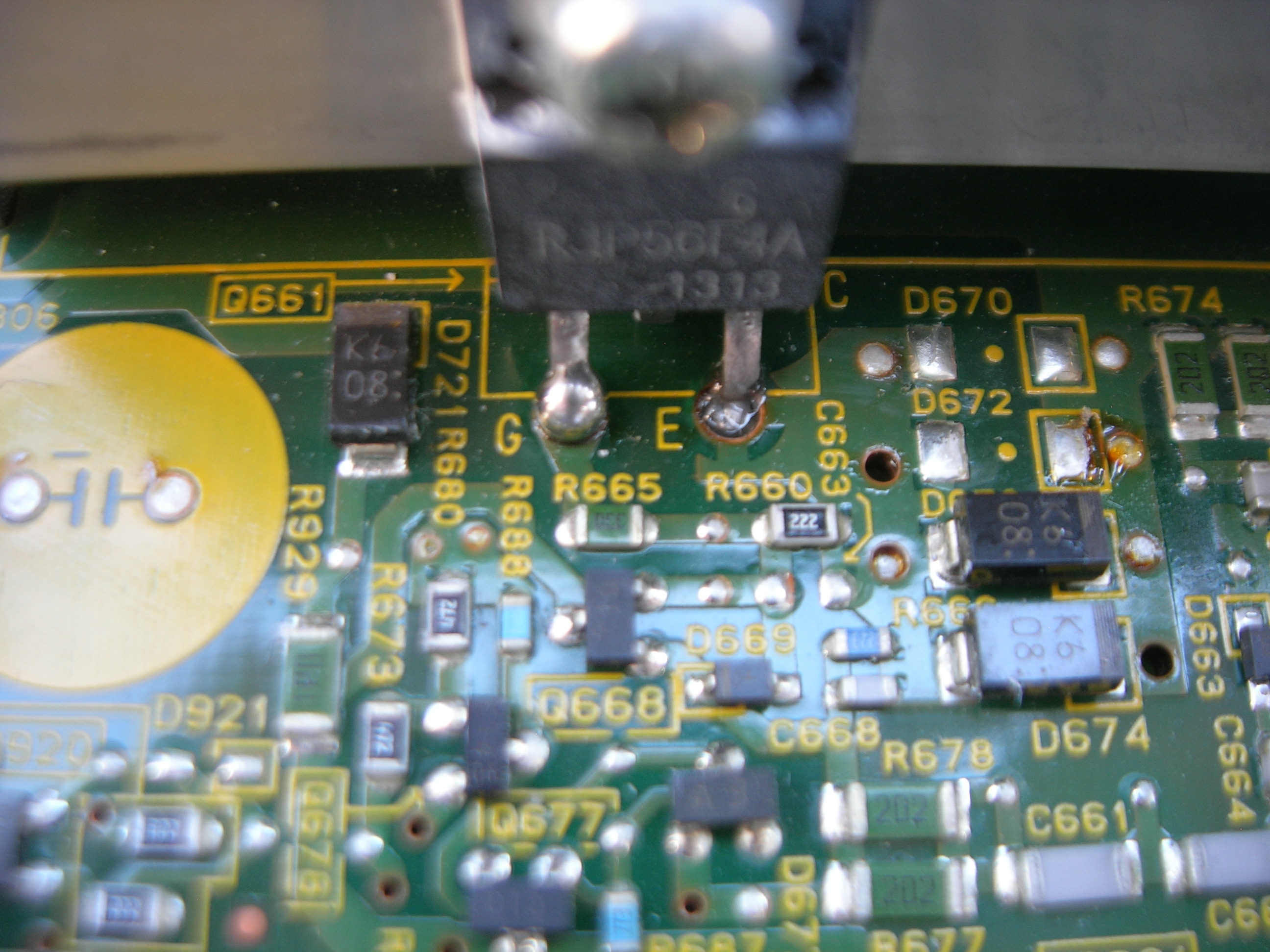

                  I figured the kit didn't didn't have everything needed and had some things not needed. I ordered separately from another source the remaining items. I hope these pictures show ok. It looks like I used a bit much solder, but it bled thru from the bottom. Sorry I wrote down Q601 buy meant Q660 the one in the picture.

                    I'm looking at it, in the meantime, Do you have IPA (Isopropyl alcohol )at all or similar?
                    Do yourself a favour and cleanup all that flux where you've worked

                      Any reason why there's a RJP56F4A for Q661?

                        So you're 100% sure all IGBTs are good, not shorted? You check all combinations of the legs? They don't always short across all 3 legs.
                        If there are any 30f125 transistors, can you resistance check between the legs and make sur they in K ohms or higher, these can fail but not dead short say around 2-300ohms.
                        On IC771 can you resistance check between the centre leg and output (left leg) as shown in your picture. I need the value

                          I usually use alcohol and a tooth brush, but it seems like the flux hardens up. I was told acetone works better. The Q661 was what was removed from the old board. Even though the packages give locations, I always write down what I am removing and from what location. Also, as I mentioned before, nothing fried when I powered it up. I checked all the diodes and transistors that I replaced just to make sure. Thanks for your help on this. I just fixed 2 50" Panny's and they are working great, but I know the 5175 board can be a nightmare.

                                  So back on Q661, I trust you still have all the dead parts in a pile? No RJP63F3A in that pile?

                                      If the board was original and untouched , and you're saying that's what was in there then it must either be a running change or the manuals are wrong.
                                      If it's original then it must be ok.
                                      I must admit I've thought about using one myself when I run out of the 630V one as it would not see that voltage ther and current ratings would be the same.
                                      So leave it if it's the same as original.
                                      handy info because I'm down to my last RJP63F3A and have a number of 56F4A which I'm also subbing for the DG502 in a board and it's fine.
                                      that would make reapiring these a bit simpler and less bits to chase .
                                      That diode is 400V , could be RF071L4S or RF101L4S
                                      You can find similar on SS boards, samsung buffer boards or ES1J would do
                                        Re: Panasonic TC-P58VT25 10 blink
                                        I did look at the old parts and it for sure was a 56. Like you said, the service manual shows a 63. Oh well, at least they are not exploding on me. I will get back tomorrow with results, now its spend time with the wifey. Oh by the way, the r551 was reading 4.7 k. I have spares, so I will replace along with the Q551. Are these common areas to look at or out of the ordinary.
