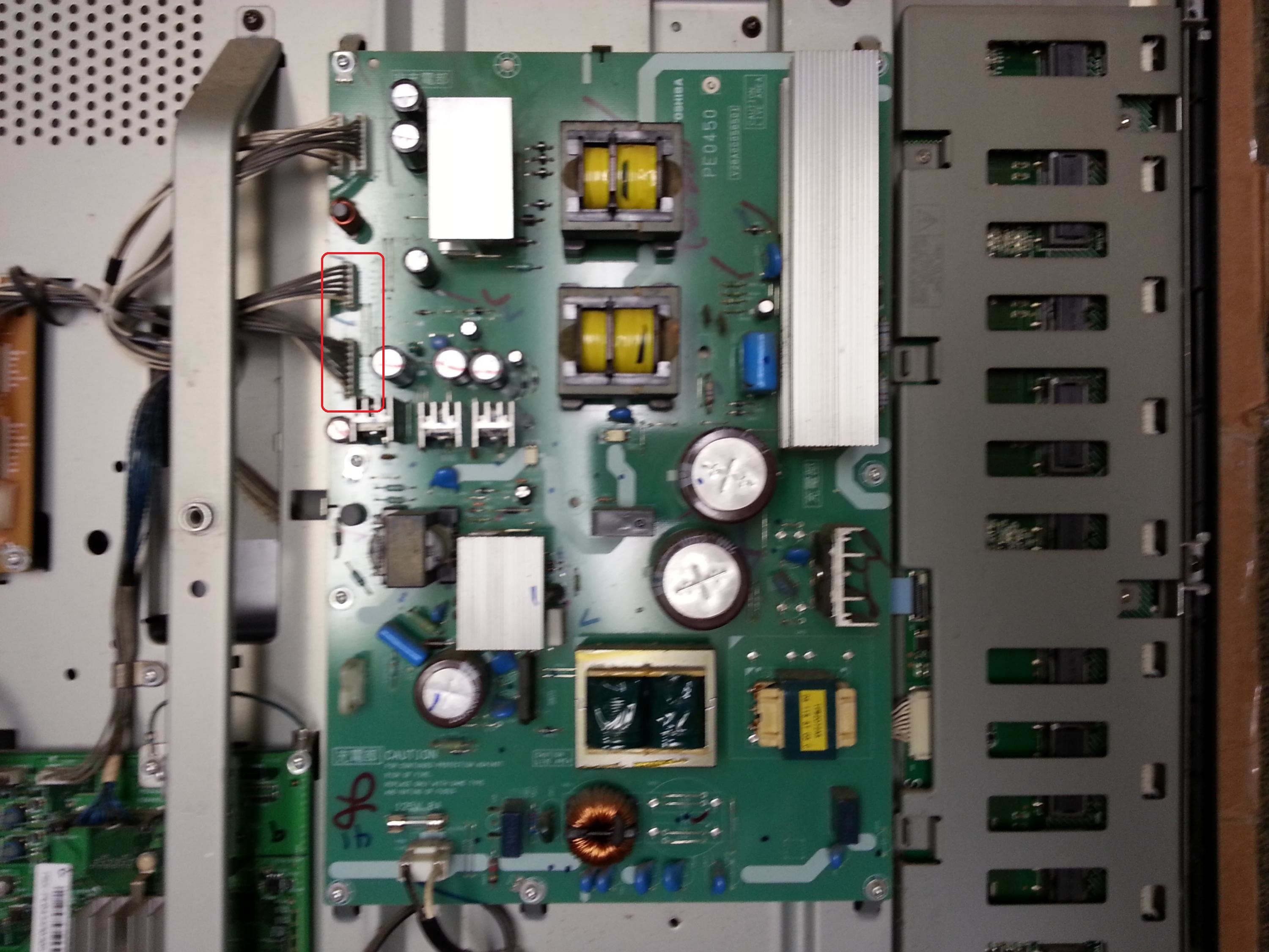

    I'm looking at this 42" Toshiba 42HL67US "Regza" LCD and it appears to power up and produce audio, but the backlight is not coming on. Using the flashlight trick, I can see the outline of the "no signal" box on the screen, so I'm pretty sure we've got video.
    What would be the best strategy for getting to the bottom of this? It's one of the older models (circa 2007), so everything is on separate boards and it has what appear to be two inverters instead of one.

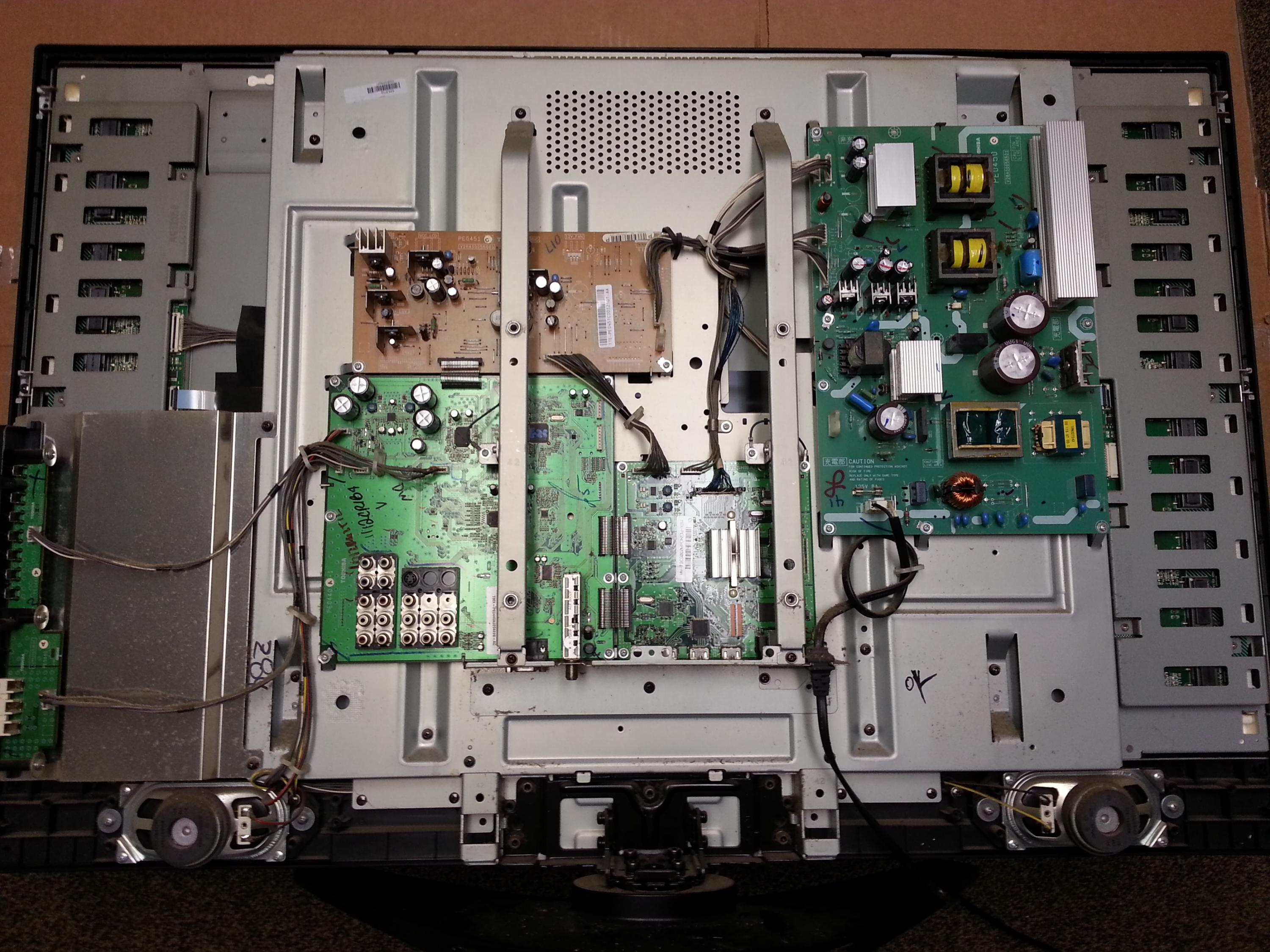

    I would find out if you do have 24VDC on the power supply board to run the inverter boards or not, if it does then check to see if the inverter board is getting the BL-ON from the main board or not.
    If you look at the back or the front of the TV in the dark room, do you see the backlights eve flash on for seconds?

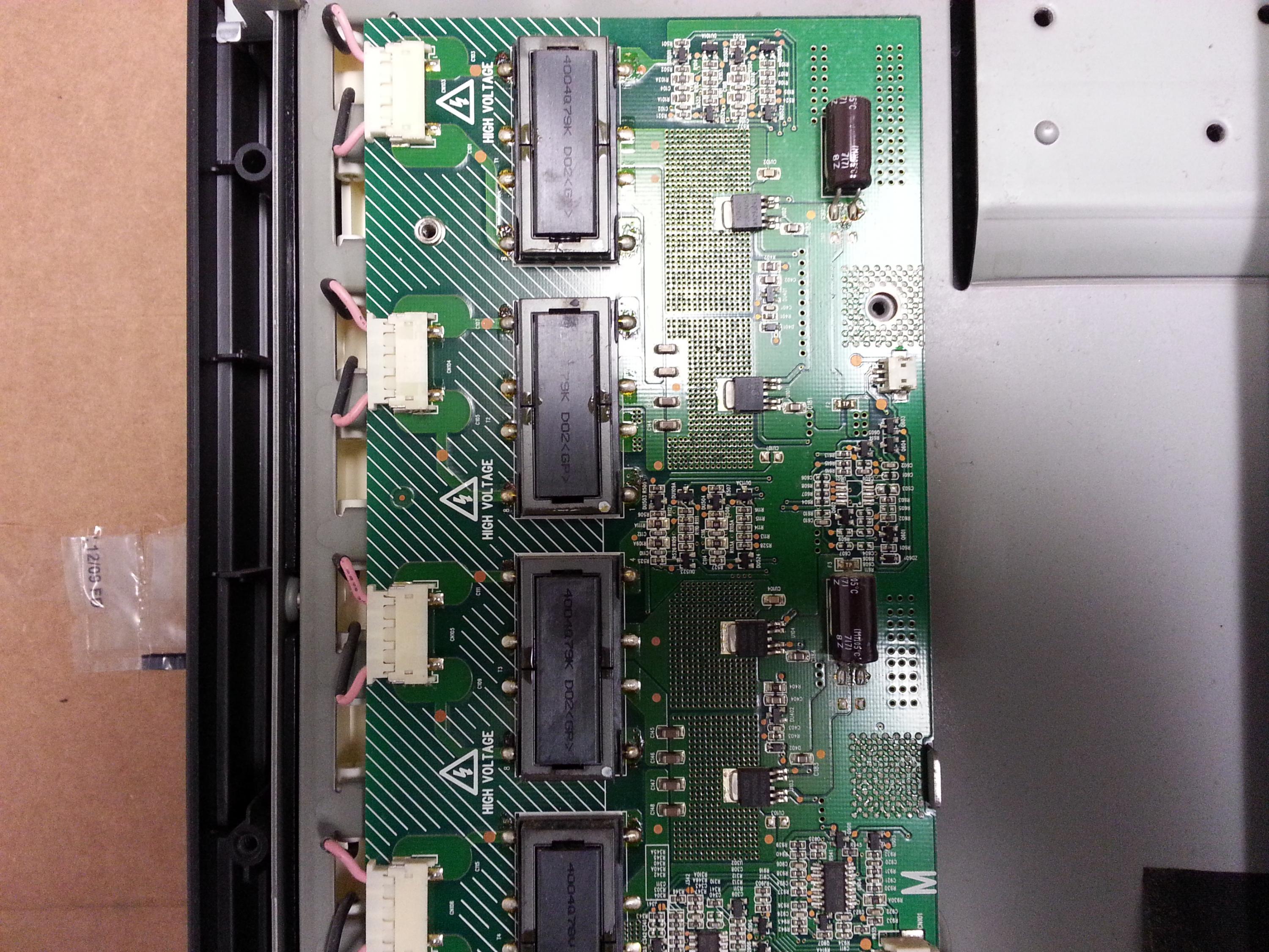

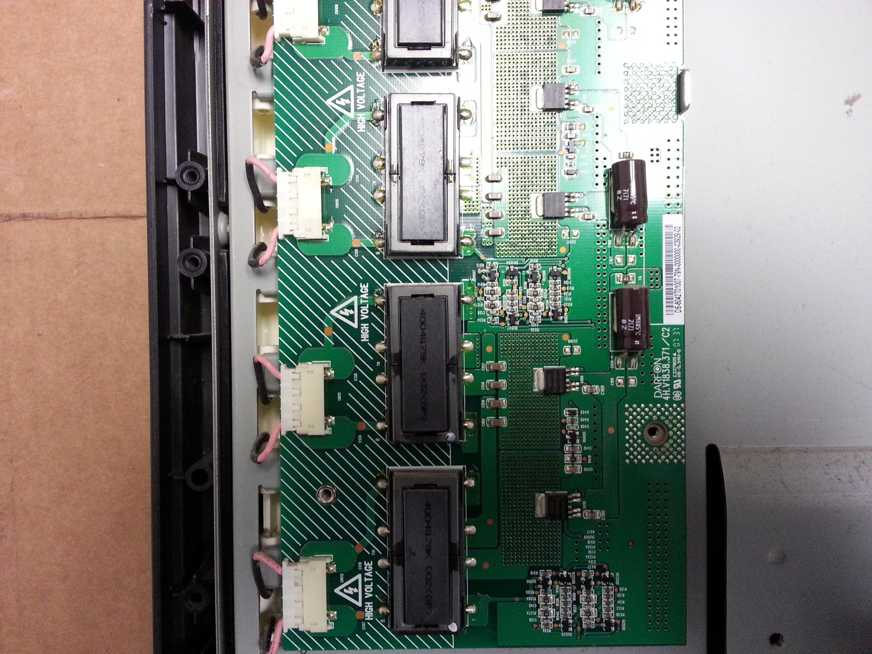

        Yes an inverter fault, I have seen these inverters with shorted mosfets. Take the covers of the inverters off and get us some images please.

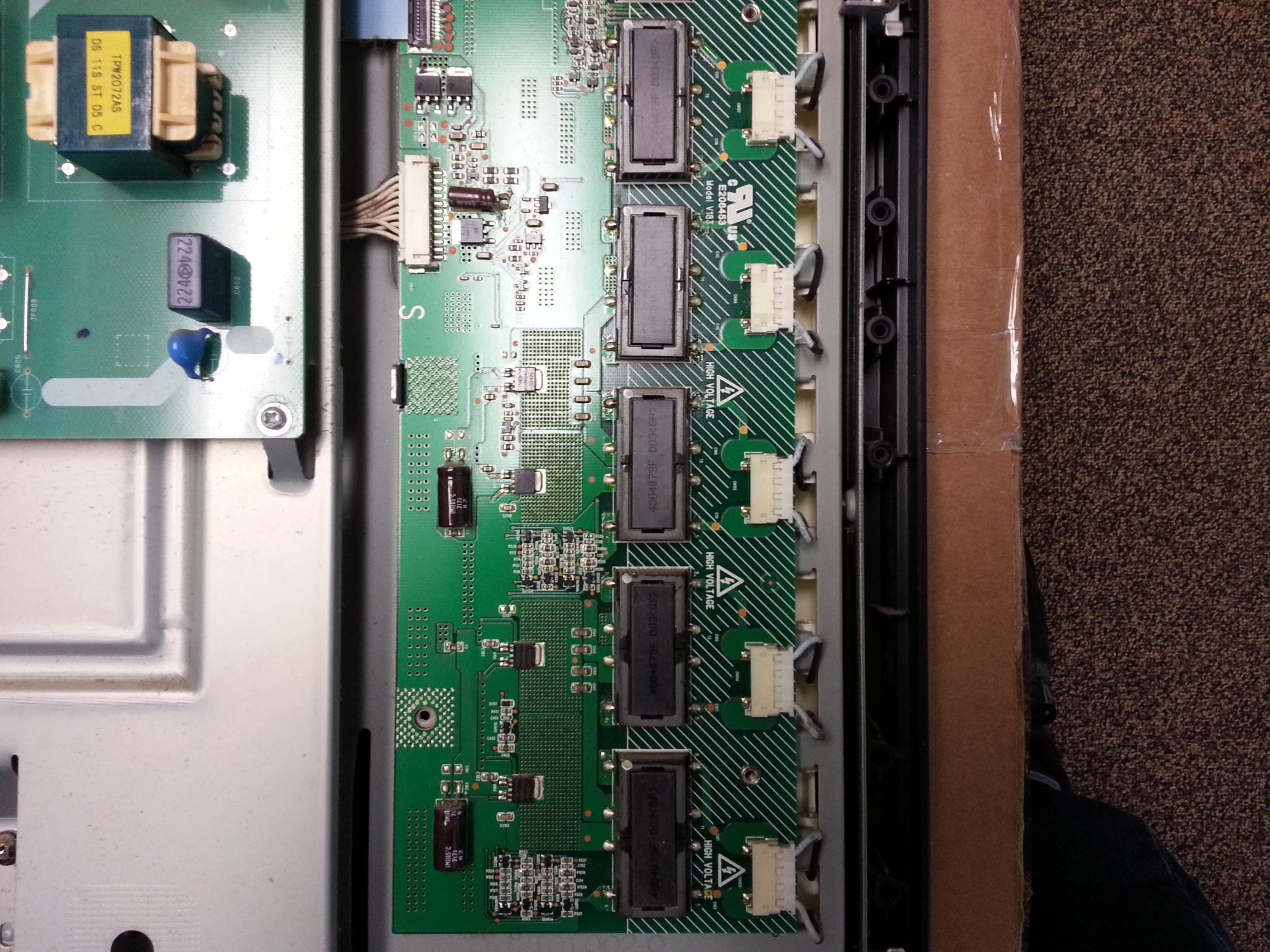

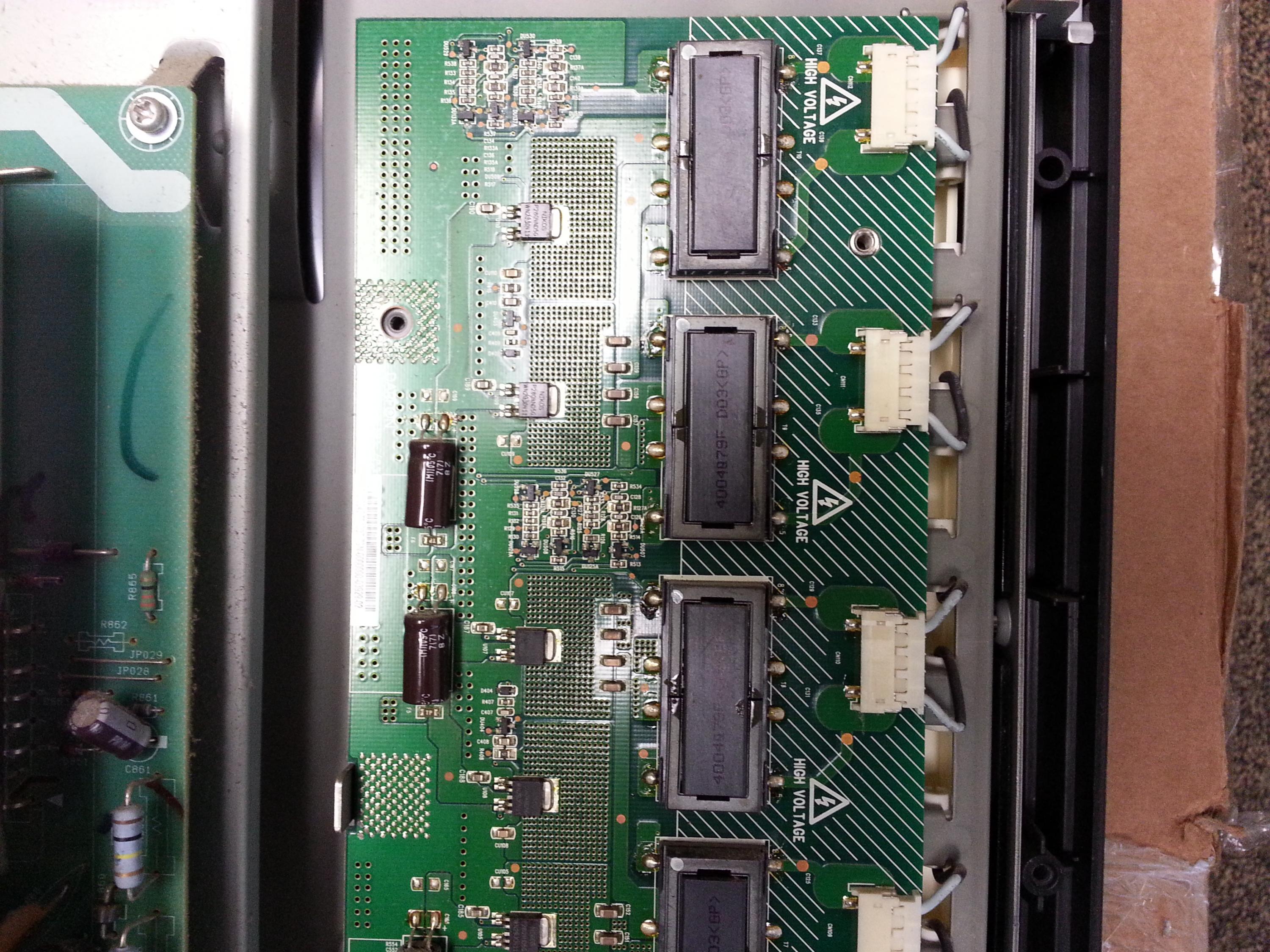

          Update

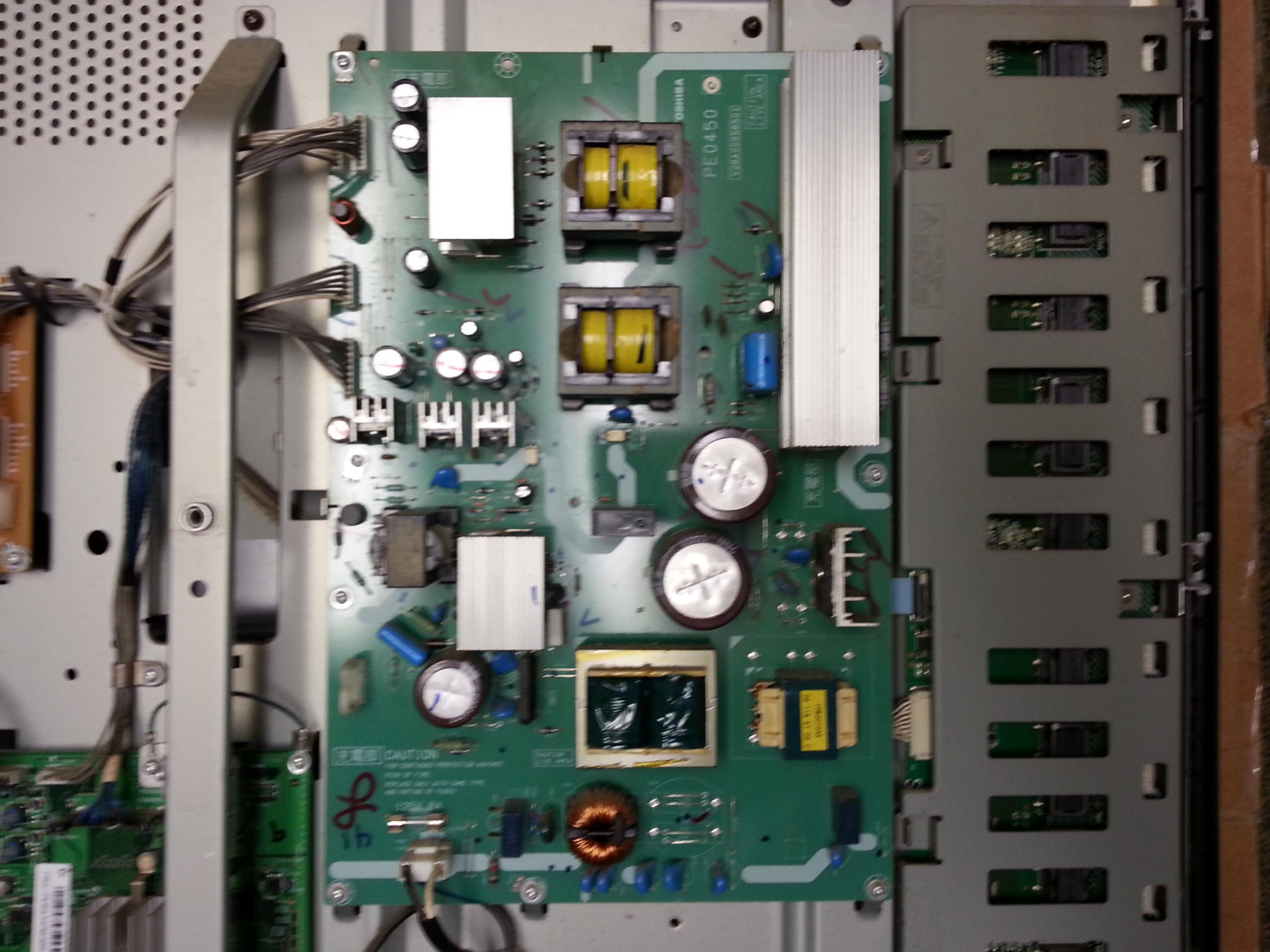

          I got the covers off and am attaching images to the post. Is there a way to test the MOSFET on both boards with a multimeter to determine which one is bad?

            Re: No backlight on Toshiba 42HL67US LCD
            You have a fuse on one of the boards marked F2. You may have more so you need to check them out with your meter set to ohms and ensure that they are short circuit.
            The mosfets can also be checked with the meter set to diode mode and check between the 3 pins (1-2,1-3,2,-3) that you have no short circuit.
            All checks carried out with set disconnected.

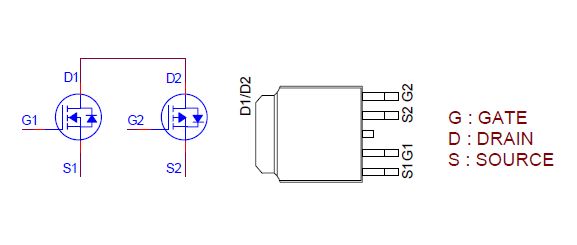

              I think the 4 pin devices with tabs are dual mosfets and you will need to check that there are no short circuits between any of the pins on each of them as ReeceyBurger123 has said.

                Lots of fuses on that board F1~F6.

                  Check the input signal of DIM into power board. If this is active, you got a faulty main board that is telling power board not to turn on back light.
                  You can force backlight to stay on by connecting INV output from main board into DIM input of power board. Can't see them clearly from the first picture you uploaded. Usually it's pin 15 and 16 of the cable between main board and power board.
                      All checked out. No shorts.

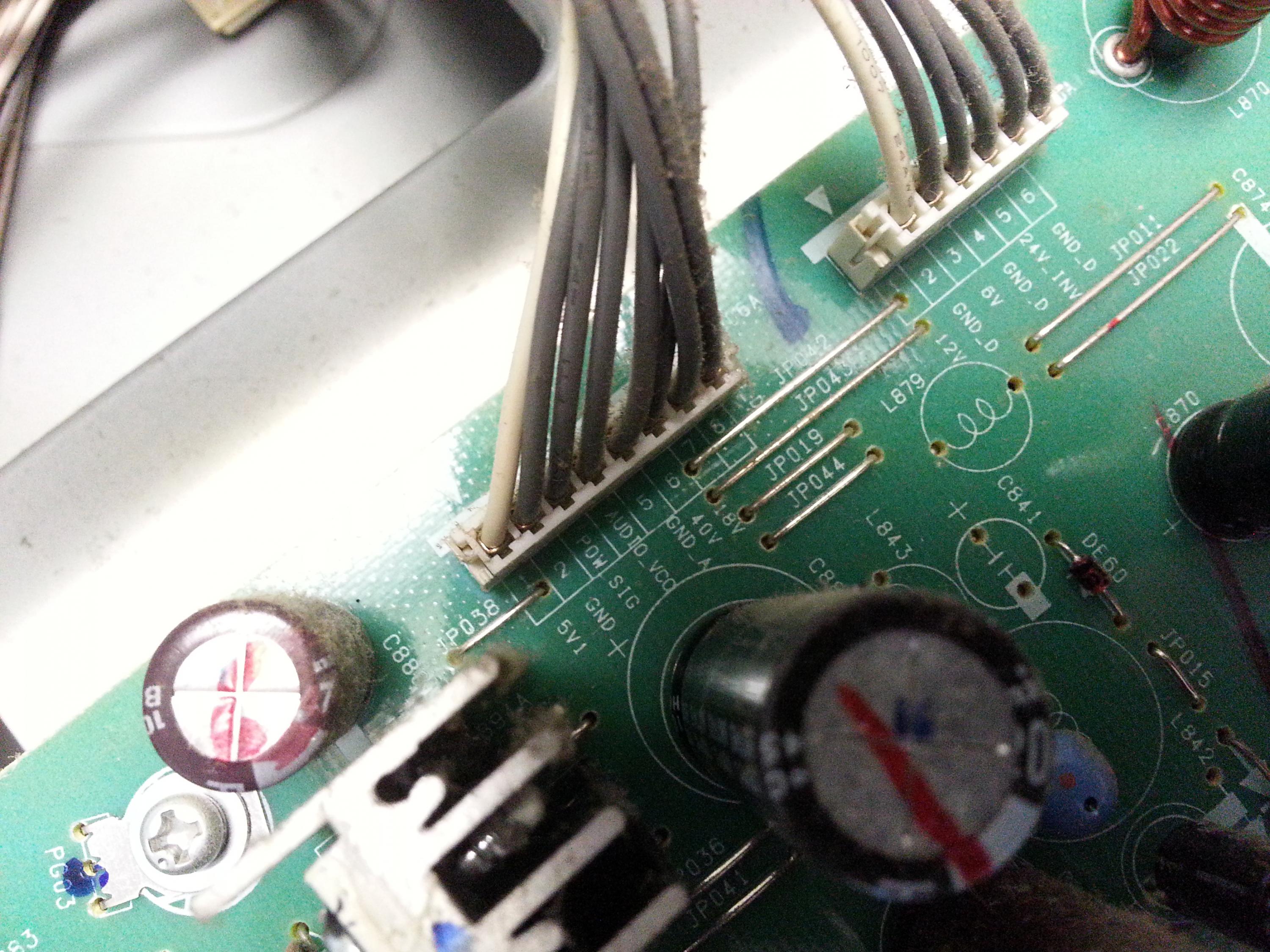

                        Can you post a clear photo of the legend written alongside these two connectors.

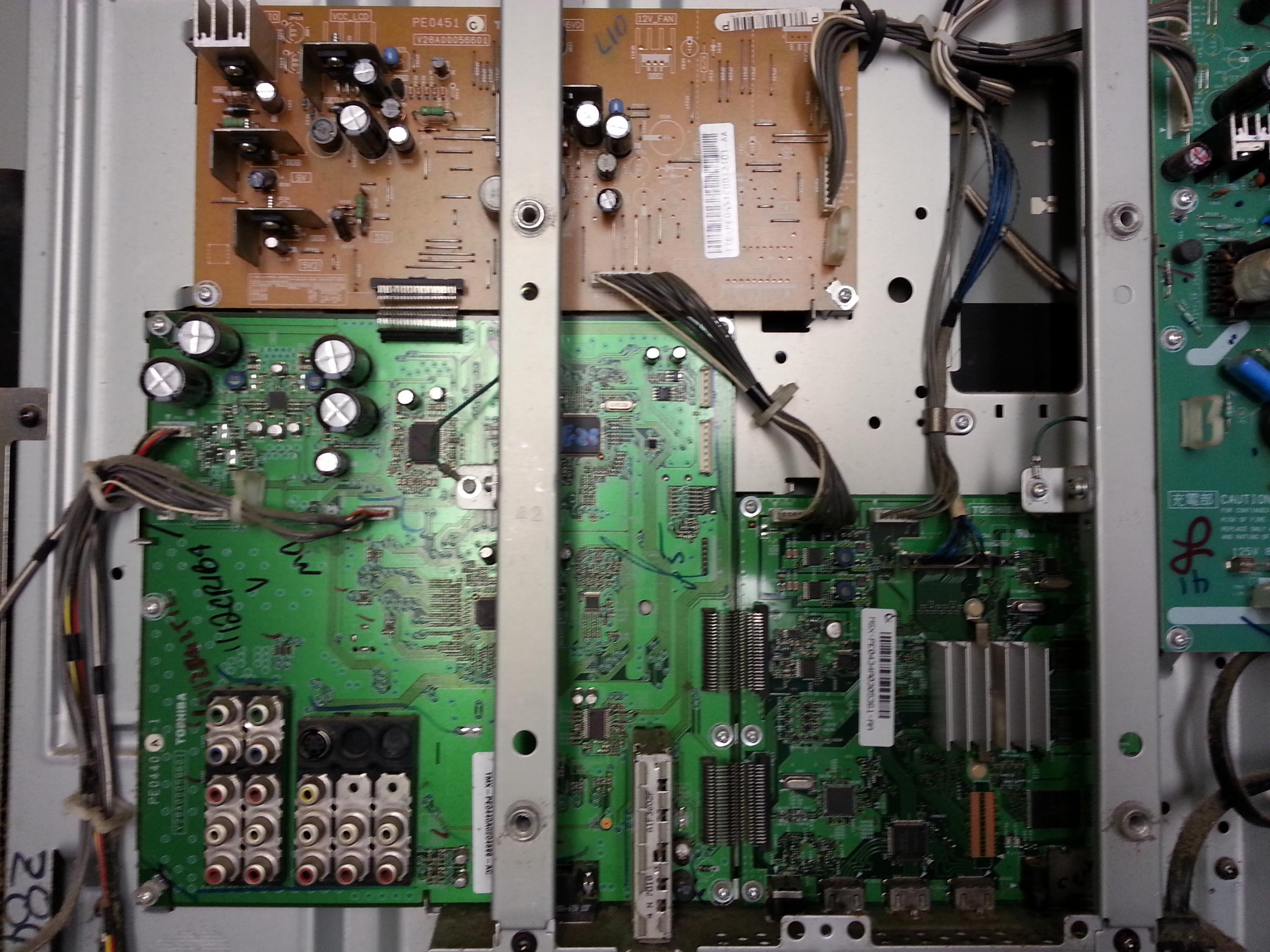

                          Are these not the sets with the strange switching-regulators on that brown board that give trouble....?
                            Yes. It will appear in the attachments section.
                            Your guess is as good as mine. Can they be tested with a multimeter?

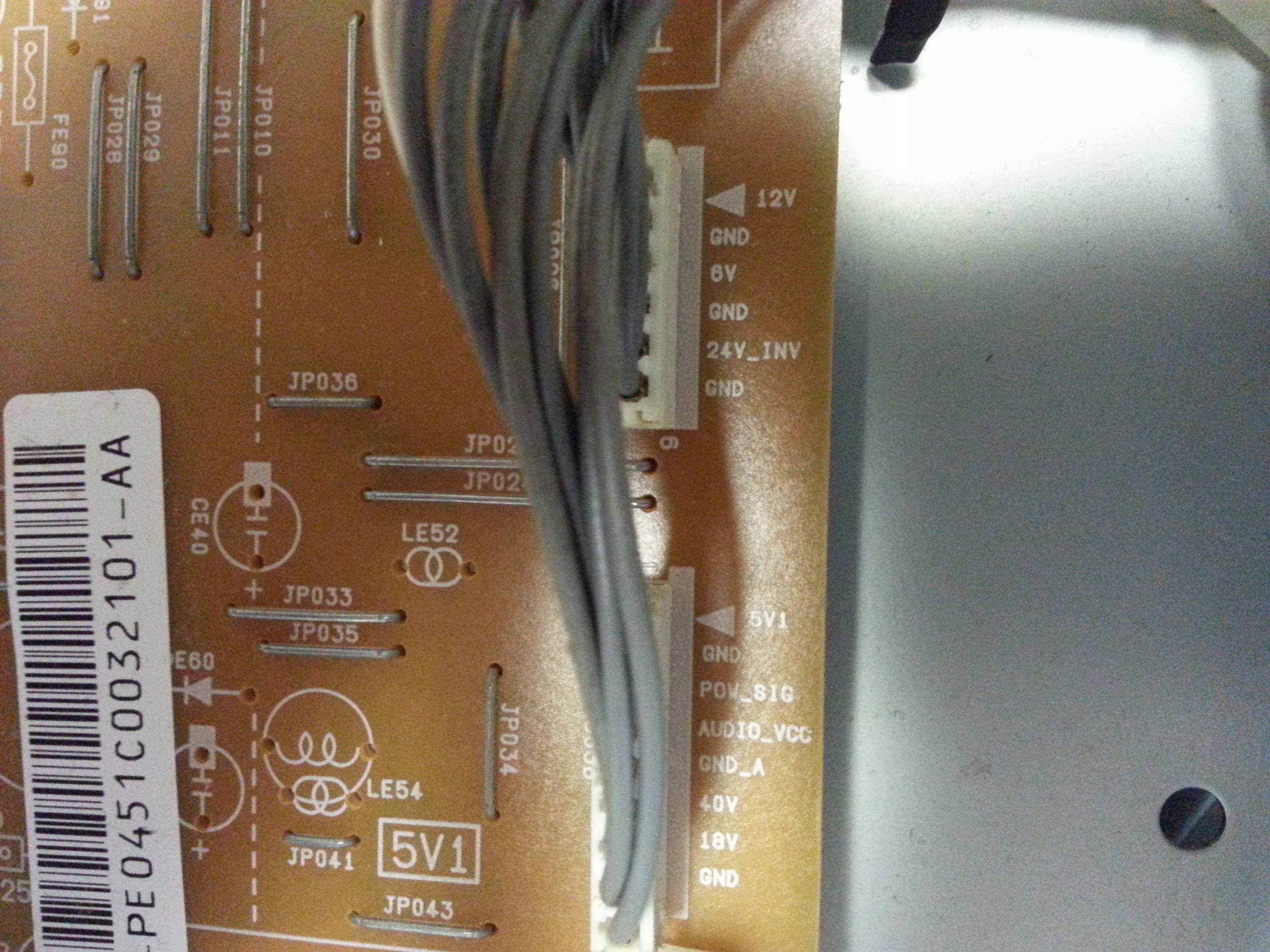

                              So the two connectors do not appear to provide any further useful information. Was looking to see if there was a Dim or something similar printed on the board but not on those two connectors.
                              Maybe it's on the brown circuit board?
                              Edit
                              Do you have all the voltages given on the connectors of the brown board or are any missing.

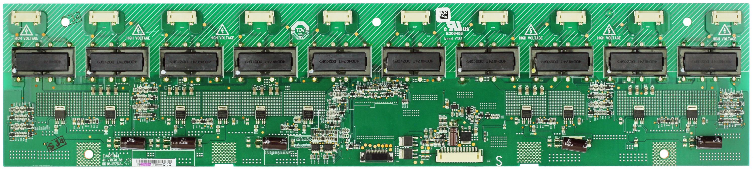

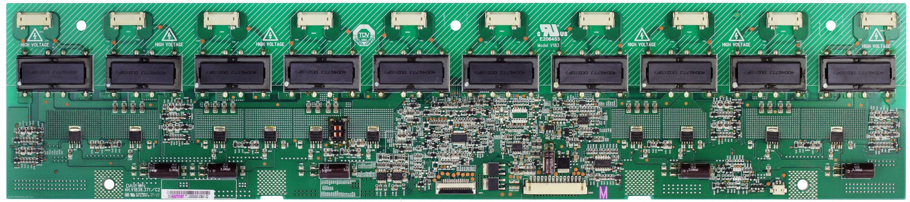

                                You have two inverter boards, both of them are the same? It is not likely that both inverters are bad at the same time.
                                    Edit
                                    A picture of the connectors is attached to this post as reference. The measured voltages are as follows (going from top to bottom):
                                    They are very similar, but one is billed as the "master" and the other the "slave". They are different enough to not have the same model number.

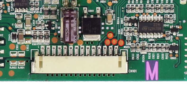

                                      Check the DCV on those 4 pads of the Master Inverter board when TV is powered on.
                                      BTW, you are 100% sure that ALL the fuses on the master and slave boards are all good?

                                        Re: measurements and details
                                        11.6
                                        ground
                                        6.4
                                        ground
                                        24
                                        ground
                                        5...........................5.1V
                                        ground...................GND
                                        3.2........................POW_SIG
                                        ground...................Audio_VCC
                                        29.1......................GND_A
                                        47.7......................40V
                                        20.6......................18V
                                        They seem in spec for the most part to me. Can you spot anything off about those values?
                                        The readings in red do not match up with the connector legend. Audio_VCC and GND_A may be switched.
