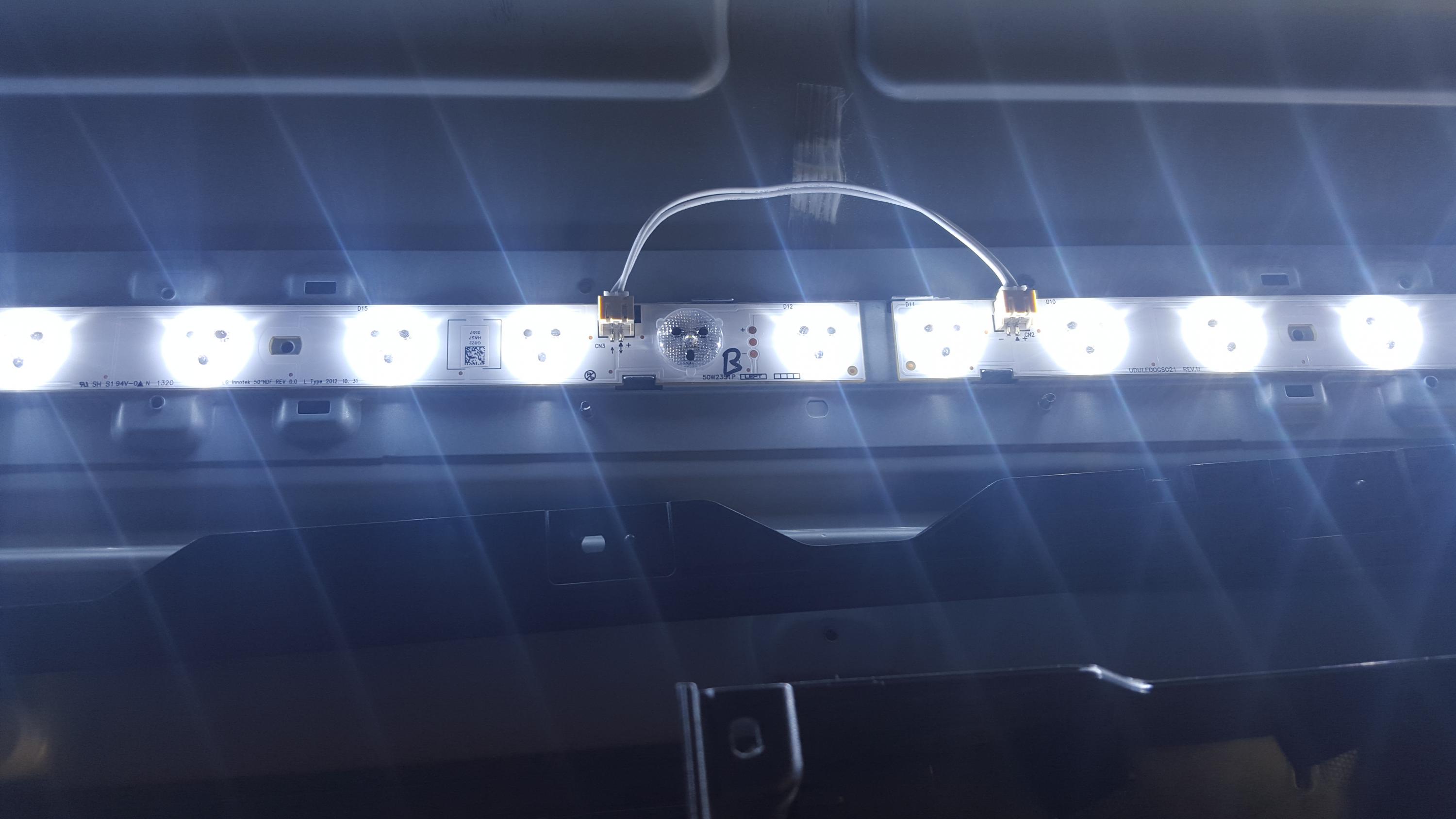

          Re: Emerson LF501EM4F turn on then off.
          Well I do know one strip of L.E.D'S are bad do I really need to test them?
          I did find a set on ebay. But they are Samsung and mine are LG. but I would change them all out to the Samsung one's. The auction does say they are from LF501EM4F.
          Would I have a problem if I changed them all?

                #67
                Is the photo from your set? If so, how did you get it to light?
                Since the LED string is a series circuit, the LED marked "B" would have had to shorted out - a rare occurance.
                Anyway, use a hair dryer to soften the glue on the lens, then slide a slot screwdriver under the lens and pop it off. Remove as much of the glue as you can while it is still soft.
                Take good high resolution photos of the LED and post them here.

                  #68
                  Yea the photo is from my set. Sometimes it doesn't come on I have to unplug and plug it back in for it to come on. When I does 10 or 15 seconds later that one led will light up too. But I do have to unplug one of the other good strip for it to work if not the lights go crazy on off on off on off.

                    #69
                    I'm guessing the black stuff is the glue!
                    But I got it off.
                    Here is a picture

                      #70
                      Measure the LED's dimensions with a set of calipers (in MM) while still on the board. It looks like the big pad is going to be an ANODE. They look like LG 100LM series.
                      It's best to remove the LED with two soldering irons. Do you have two?
                      First, use the hair dryer to heat the board to around 150F. Apply excess 63/37 solder to the two pads, then, with one iron on one side and one iron on the other side, melt the solder and using the two irons as one, slide the LED off the pad and onto the white area. Take a GOOD picture once this is completed.
