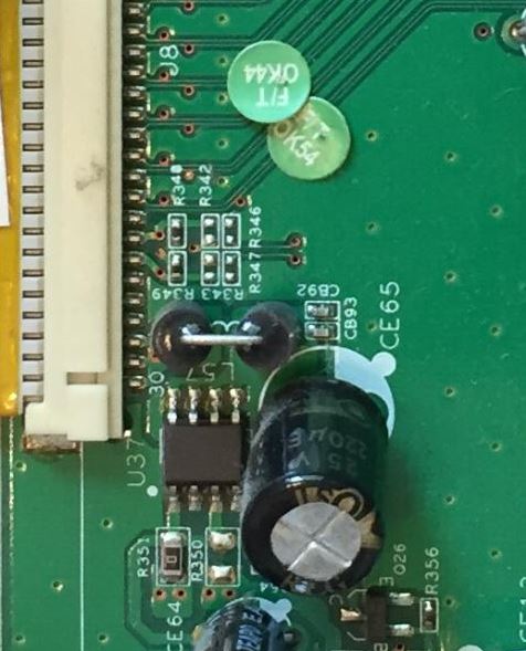

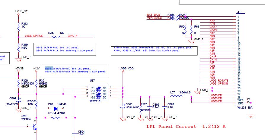

            #85
            Re: Vizio vw46l weird picture
            Hello Malachi,
            Budm was asking you to check for 12V at components R351 and L57. Does the attached picture in my earlier post ( added ) look anything like the circuit you are checking

              #86
              Do you have an IRF736 IC alongside the components you are checking?
              Edit.
              I can see that there's a U37 close to the LVDS output connector but cannot read it from your photo.

                #87
                Post #57.
                U37 is 5953GM.
                I'm too ignorant to understand schematics. Lol

                  #88
                  Could you measure the voltages on pins 1 - 8 of U37 only if to satisfy my curiosity since I suspect the mosfet is blown. It also could help others at a later date who may have similar problems.

                        #91
                        If pin one is upper left with the white dot above it, it has 12 volts as do some of the other pins on the left side.
                        None of the pins on the other side have any voltage.
                          #92
                          The MOSFET looks to be getting the input Voltage to it but it may be not getting the ON signal at the GATE pin or the MOSFET itself is bad.
