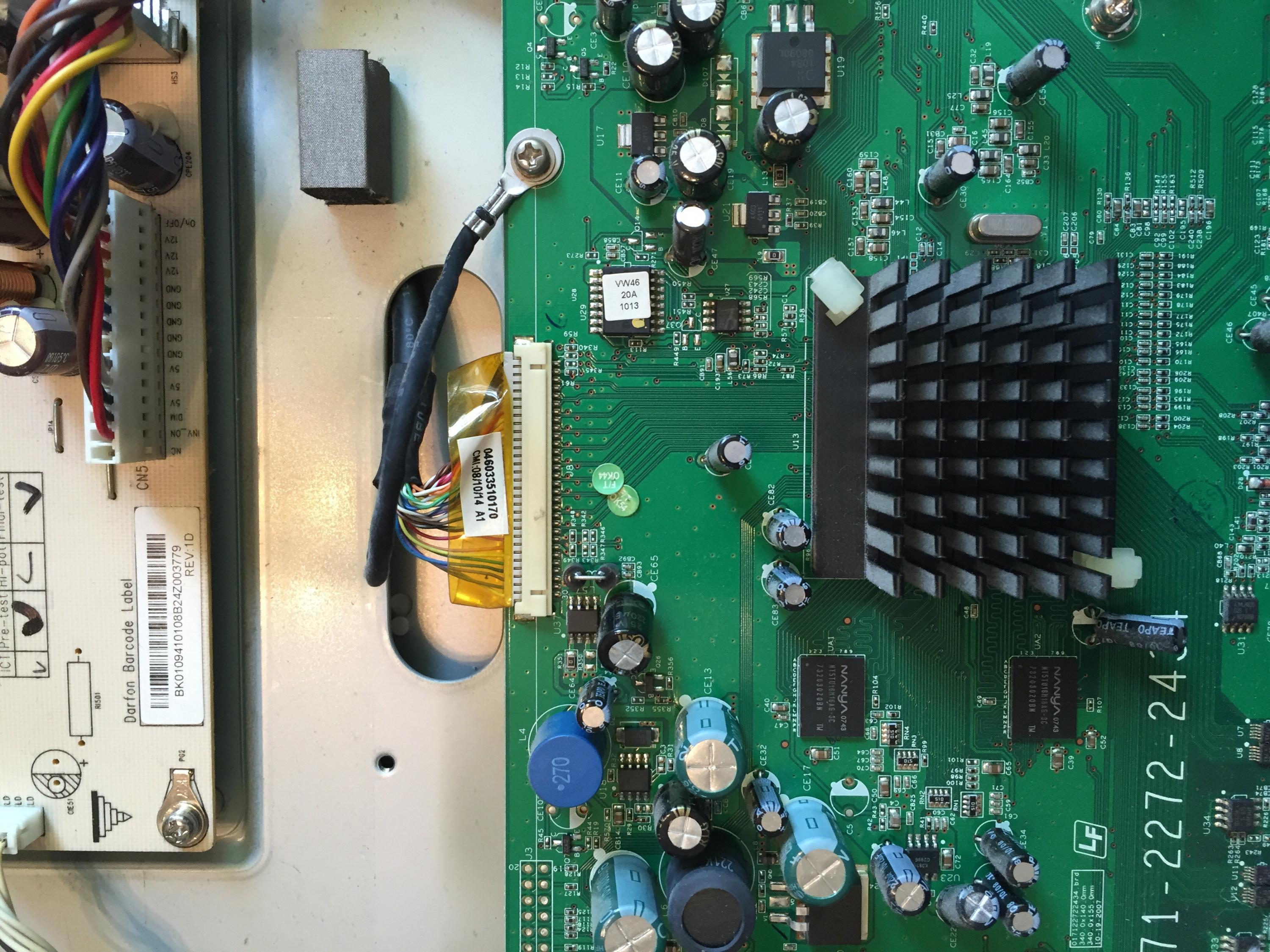

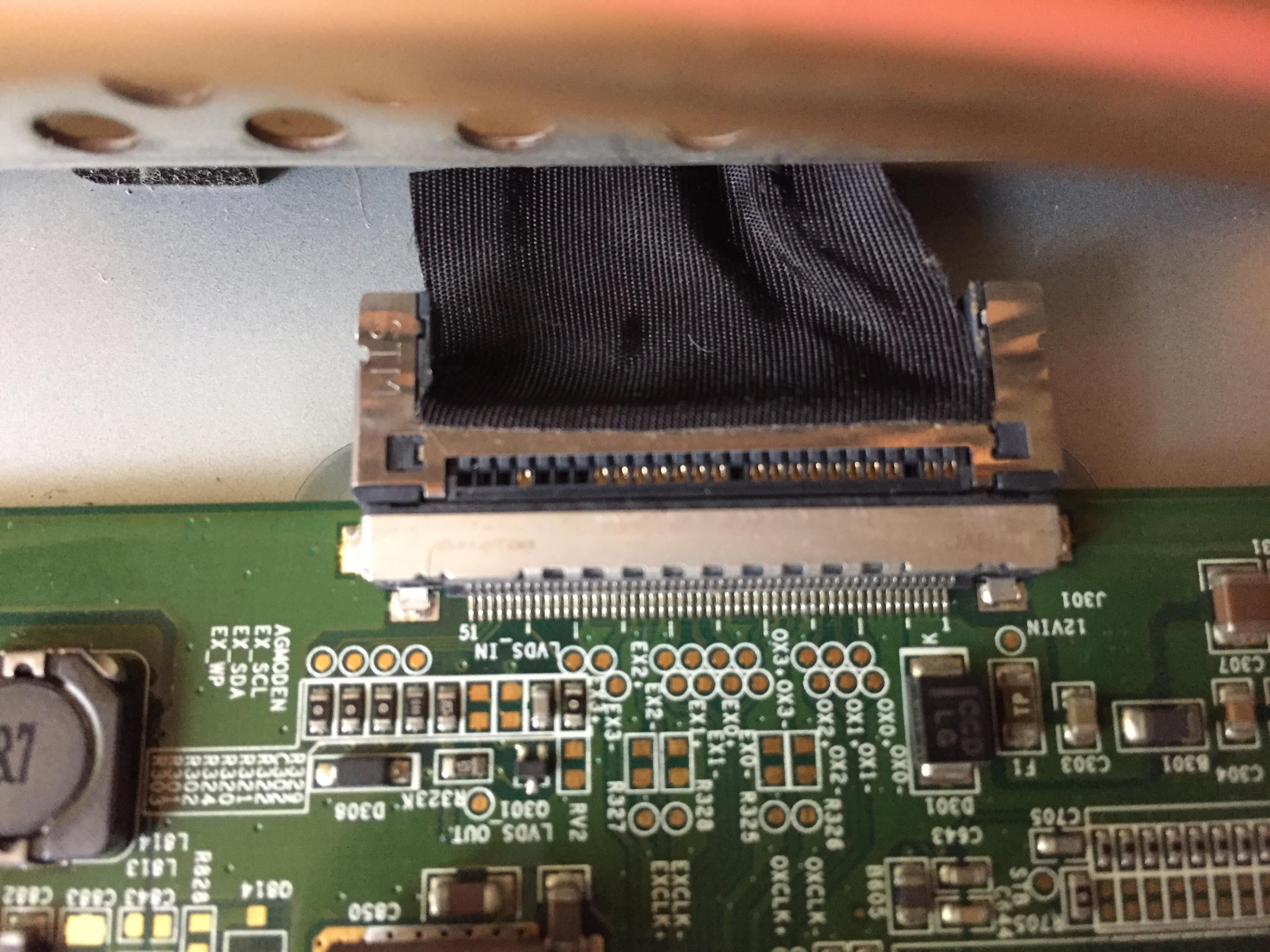

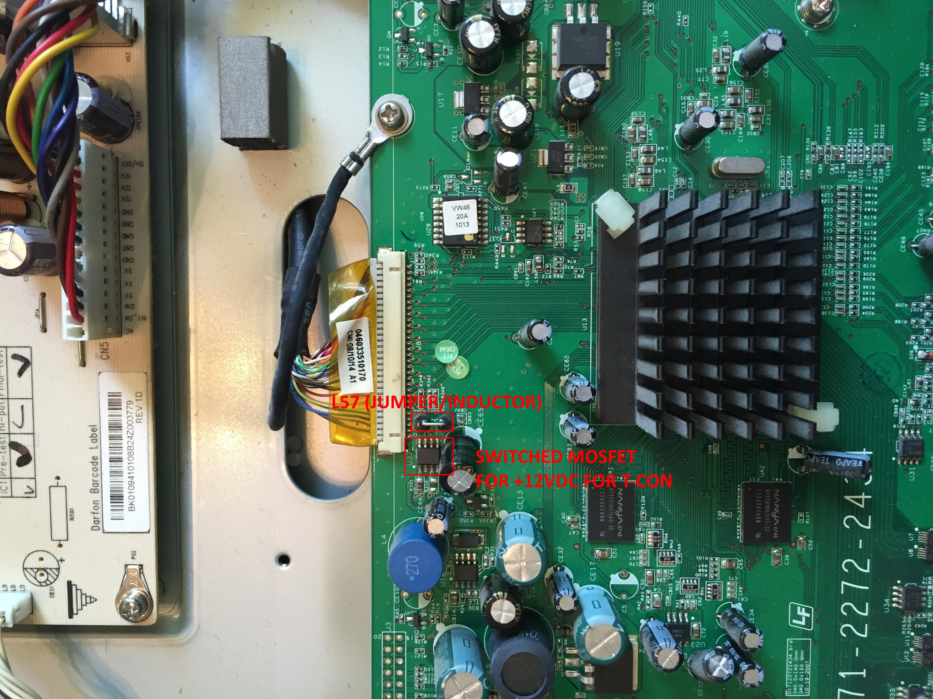

    Vizio m65-c1 picture flashing on and off on the screen
    by maricm
    HI all,
    hope someone point to the possible issue before I start buying replacement parts.
    Tv starts normal and responds to remote fine, PSU voltages mesured fine 19v was 18.9V under load and 19V with main board disconnected.
    Backlight stays on all the time,
    Sound works fine.
    screen keeps changing form black to full picture in about 1sec intervals.
    Picture looks fine with no visible artifacts.
    I have disconnected backlights and flashlight test confirmed that picture is still doing the same.
    Disconnecting left and right ribbons on...
