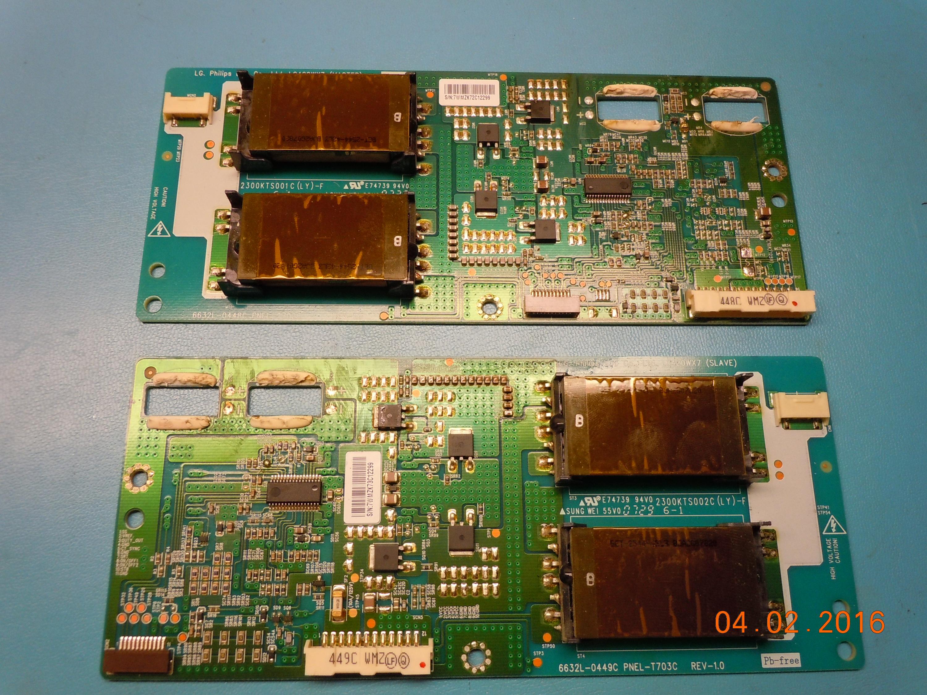

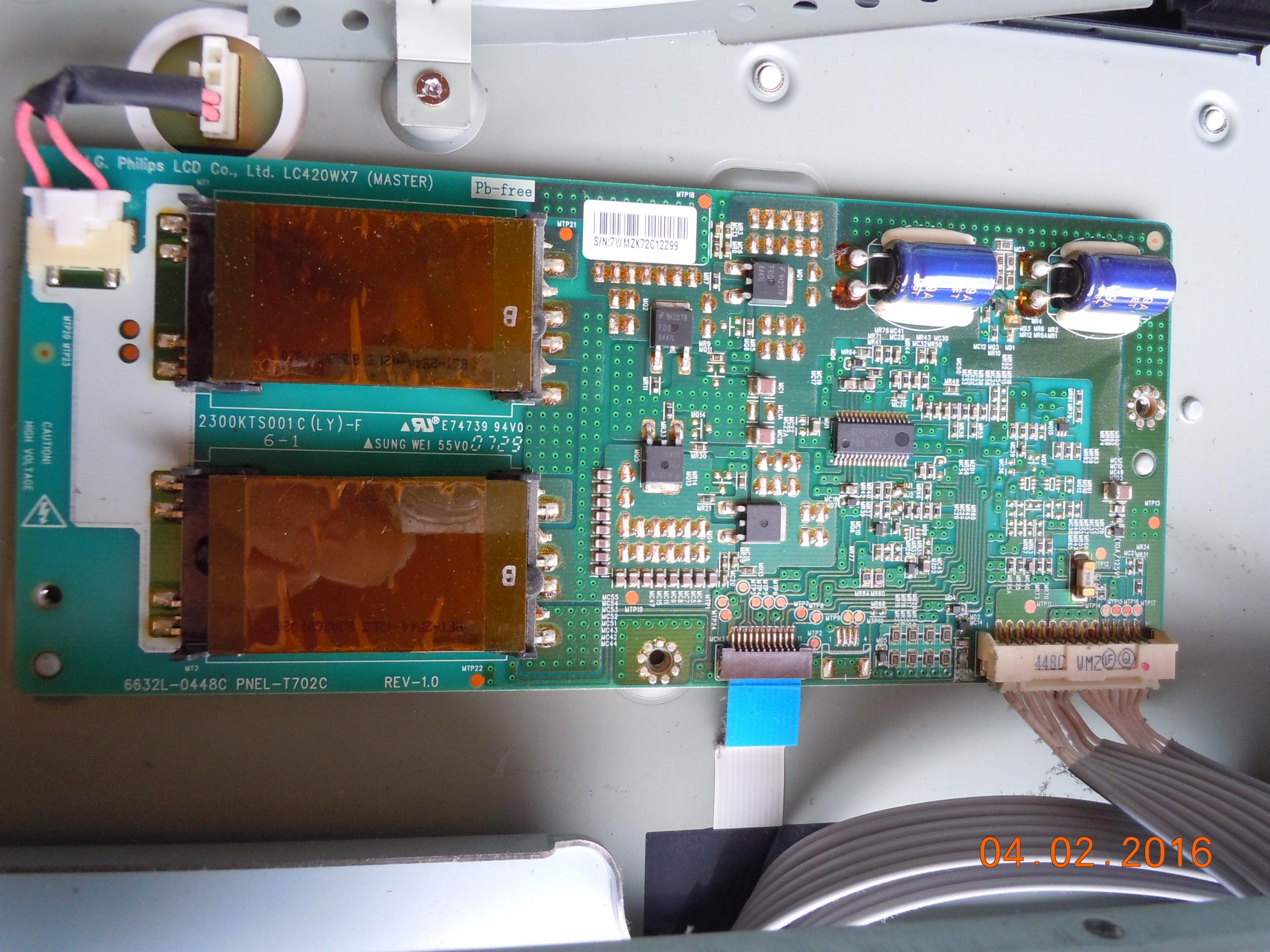

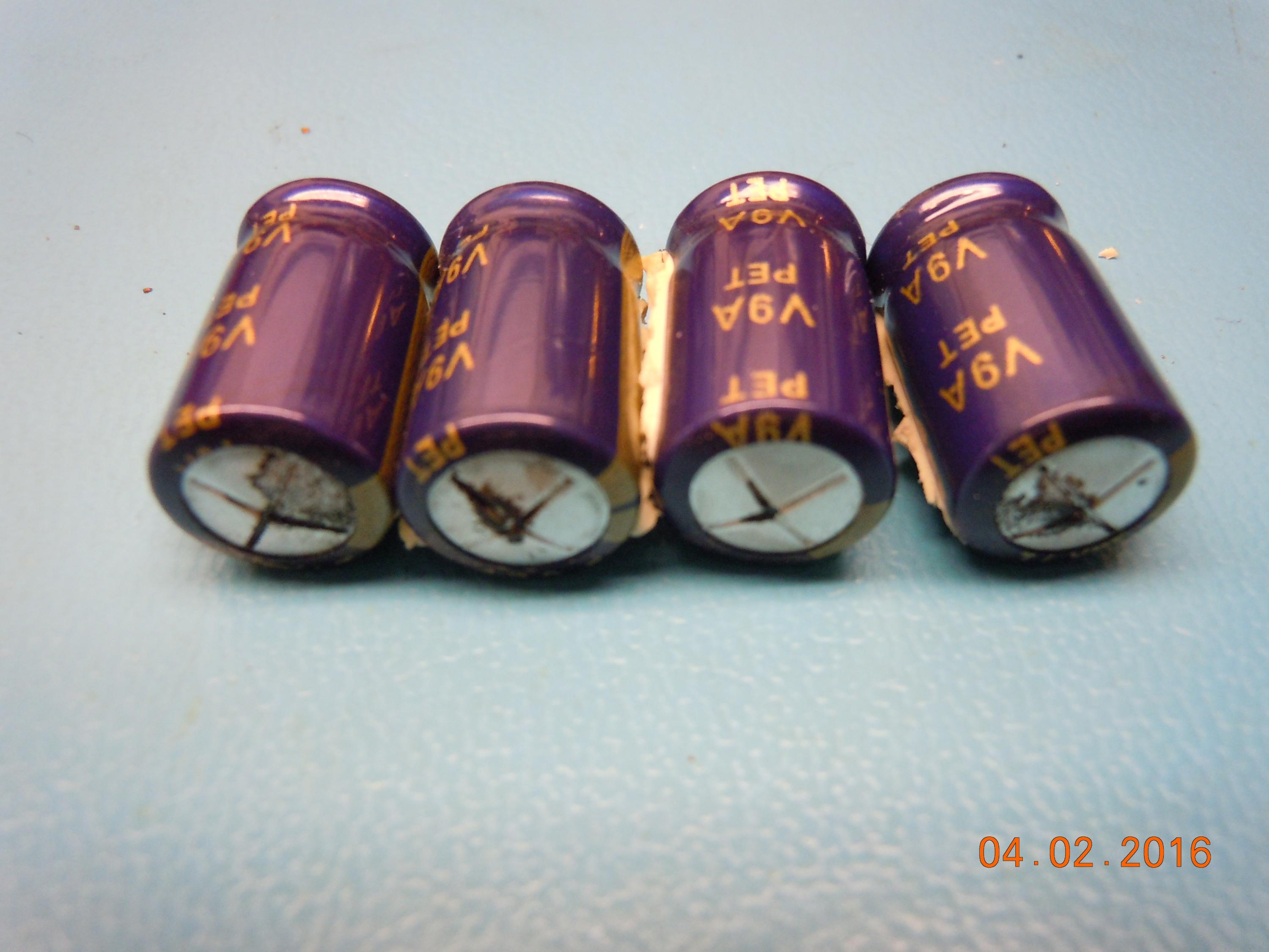

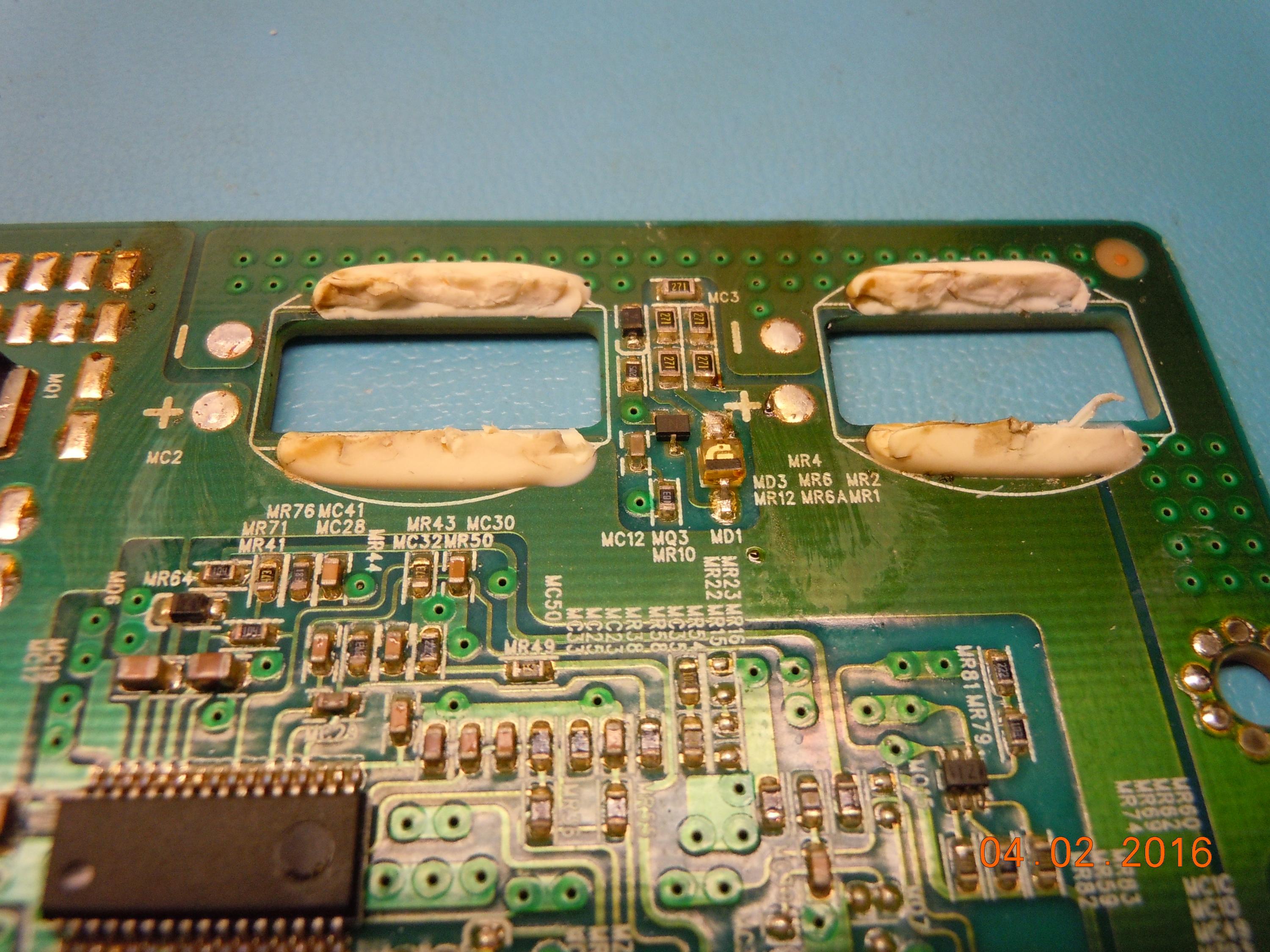

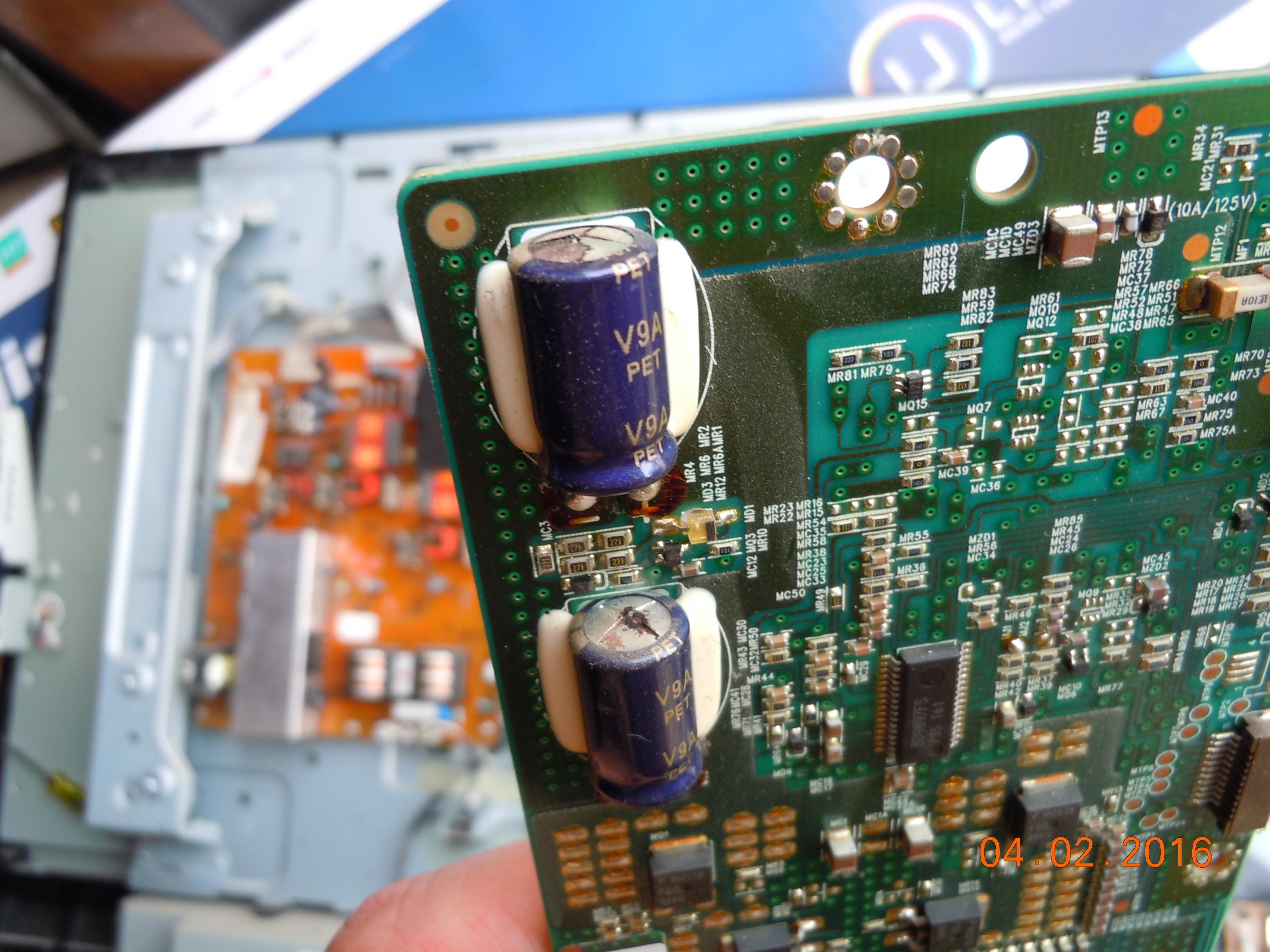

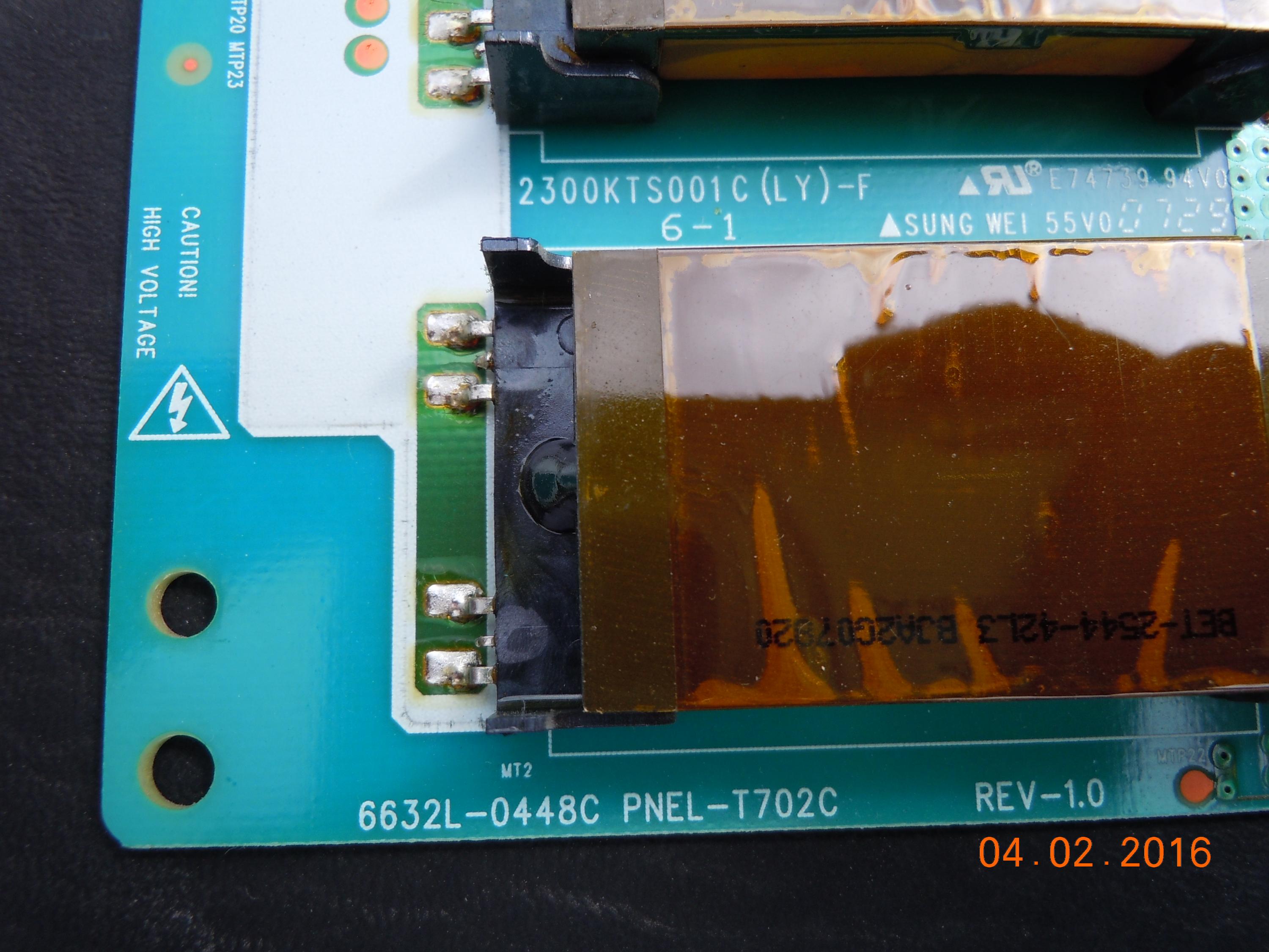

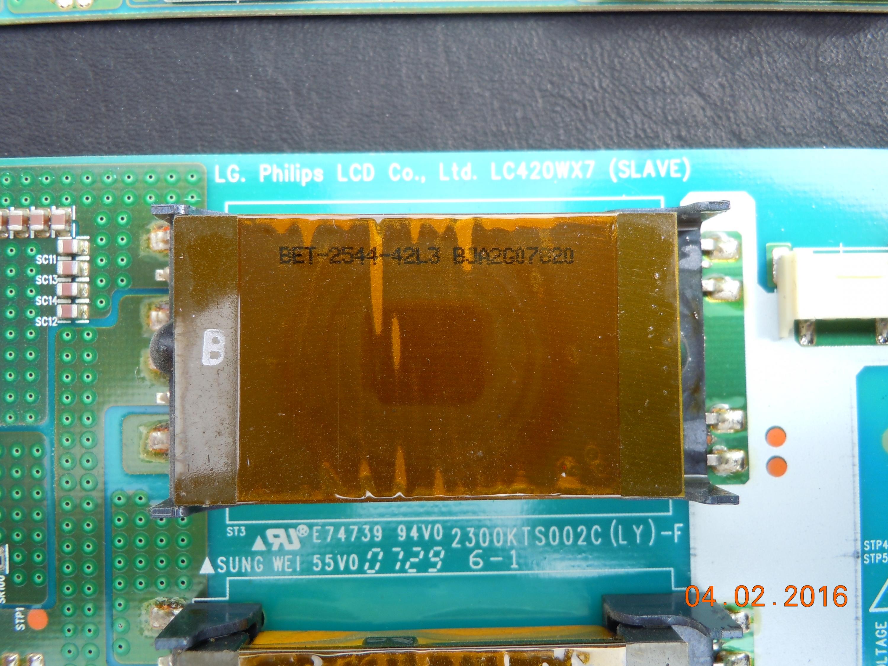

            Removed the back cover. SSB looks good but a bit dusty. Removed the covers for the master and slave inverters and yeah, caps on both are popped.
            @thoma, I looked at the links you provided specifically the second one. I did not see any damage to any of the components other than the caps.
            @ReeceyBurger123, Pics are attached. At the very least I am going to replace the caps since they are cheap. What's the worst that could happen, I'm left with where I started?
            There is also a suspect cap on the SSB near the inverter outputs. Attached as well.
            Any other suggestions before I tear into it?

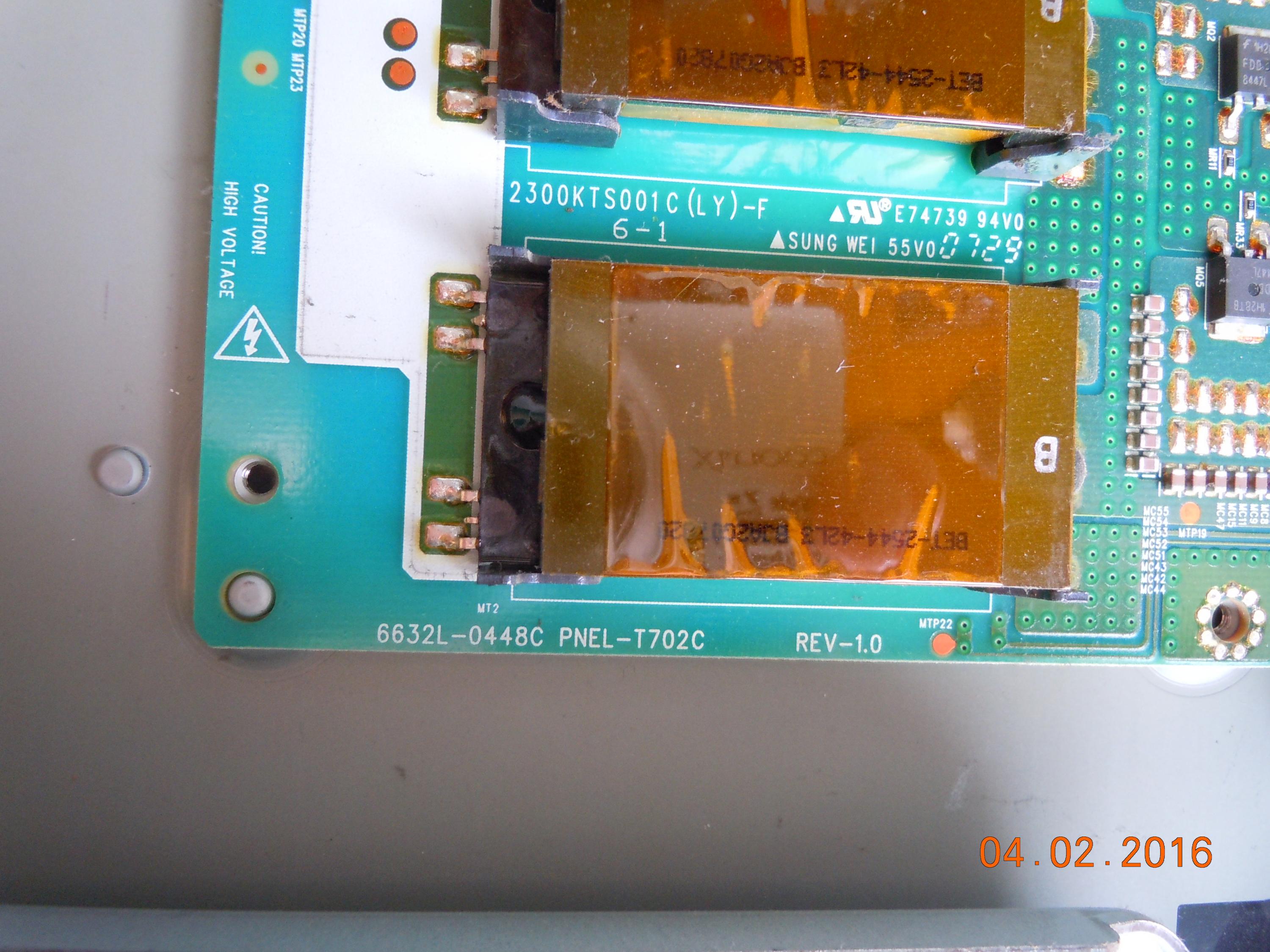

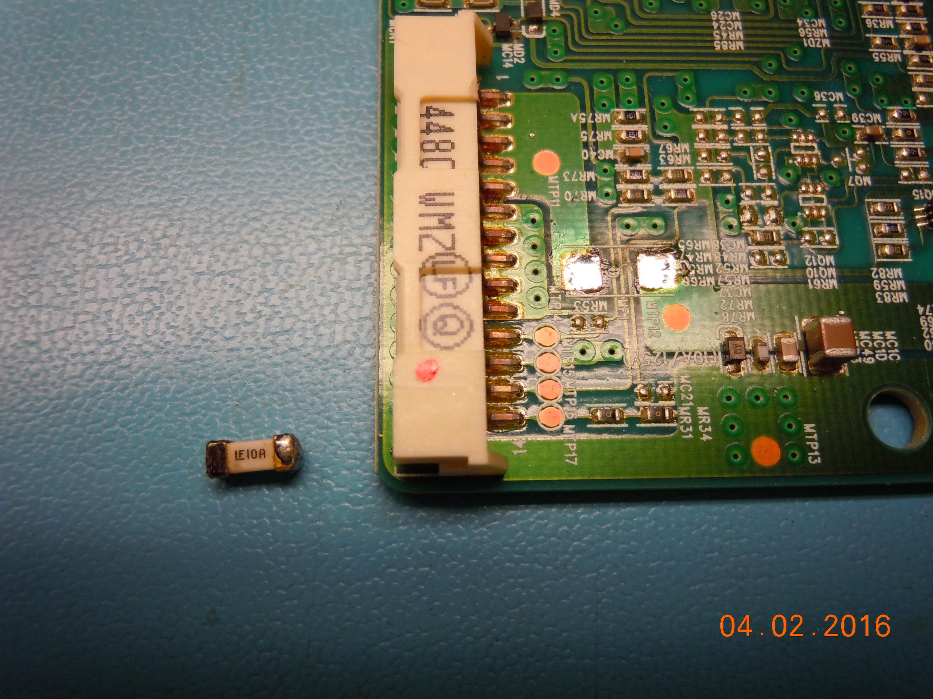

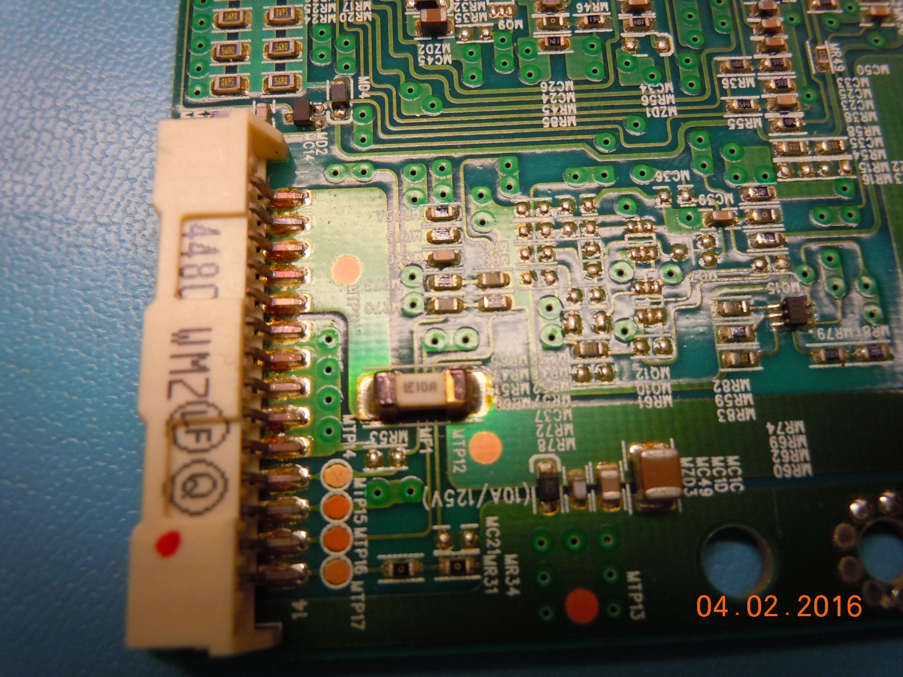

              Another quick update. Fuse MF1 is open on the master inverter. I checked the MOSFETS and none are showing a short or open.
              Does anyone have a link to the schematics or the part number for fuse MF1?
                Re: Philips 42PFL5332D/37 no backlight
                '10A' as printed on the body as sen on the pictures, made by LittleFuse.
                    It looks like it. But are you sure there is no short on the board? The two caps showing low ESR and capacitance?

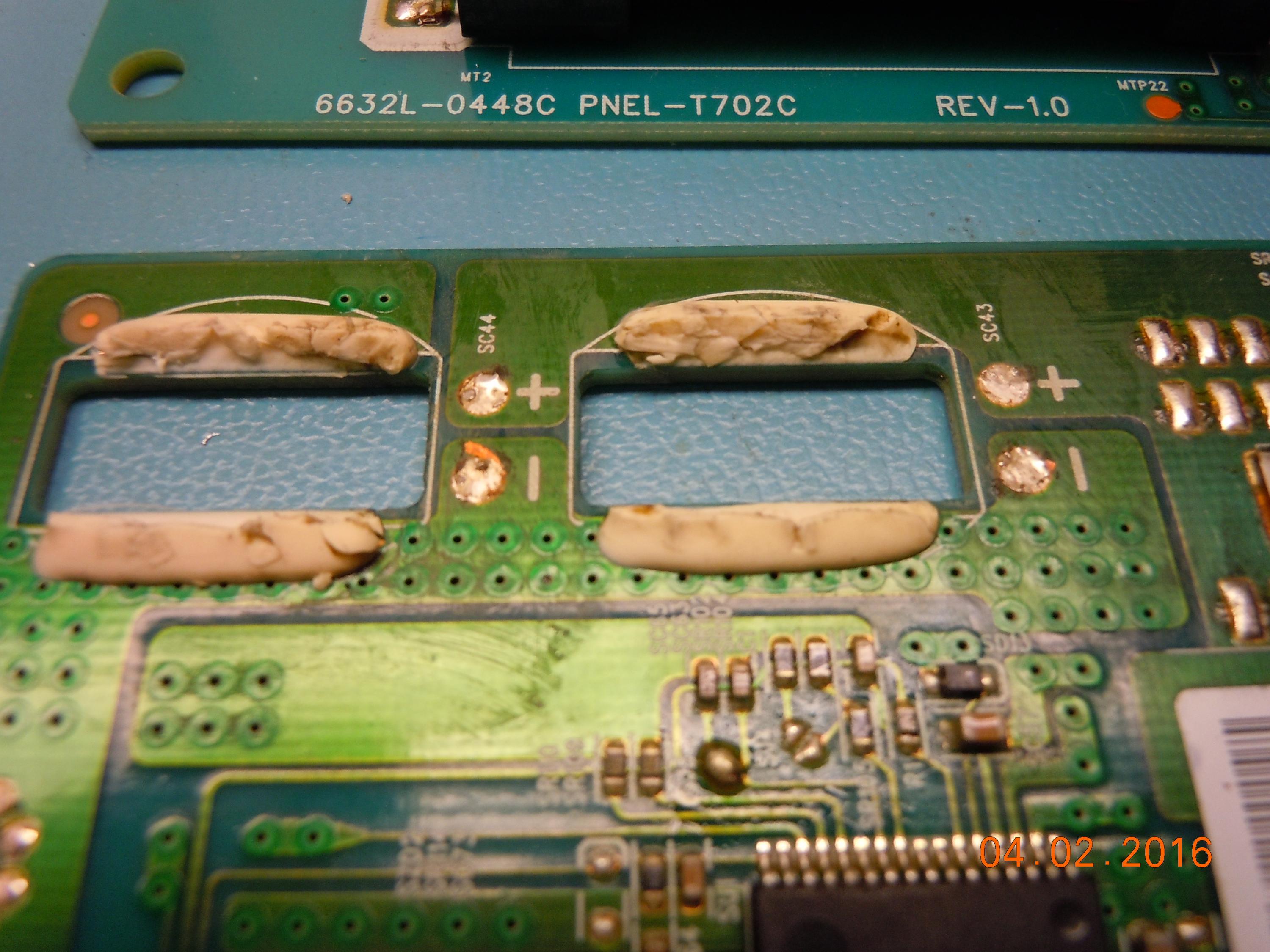

                      So far I have found no short. I checked the MOSFET's on both inverter boards (in circuit) and there is no shorts between gate and drain on any of them.
                      Edit: The two caps on both boards are shot. Domed and leaking.

                        Sam for Source and Drain too, no short?
                        Bad caps can cause the circuit to draws lots of current due to high ripple voltage and also cause switching frequency to run at the wrong frequency.

                            Double checked and correct, no shorts.
                            Pics of components removed.

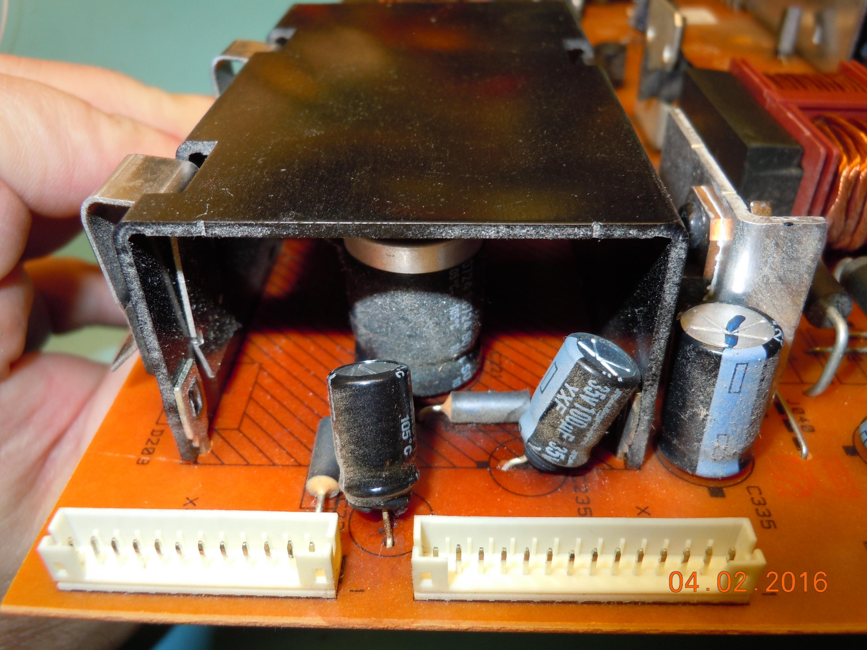

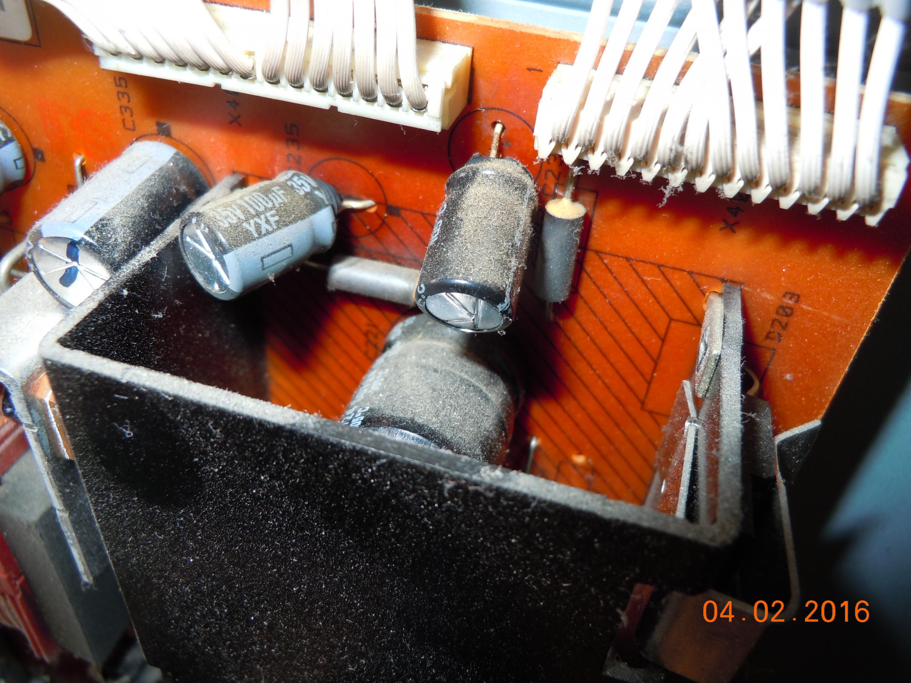

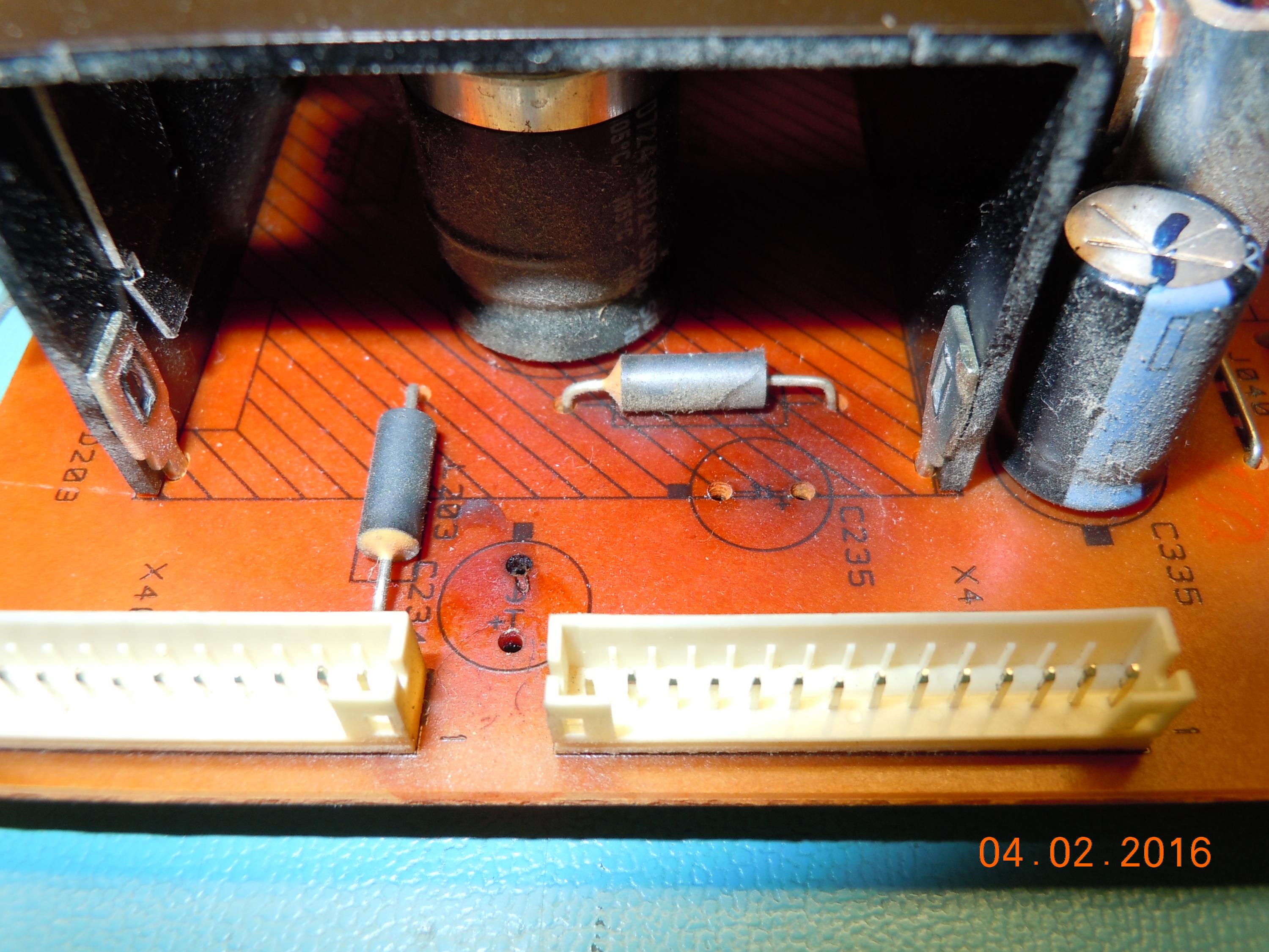

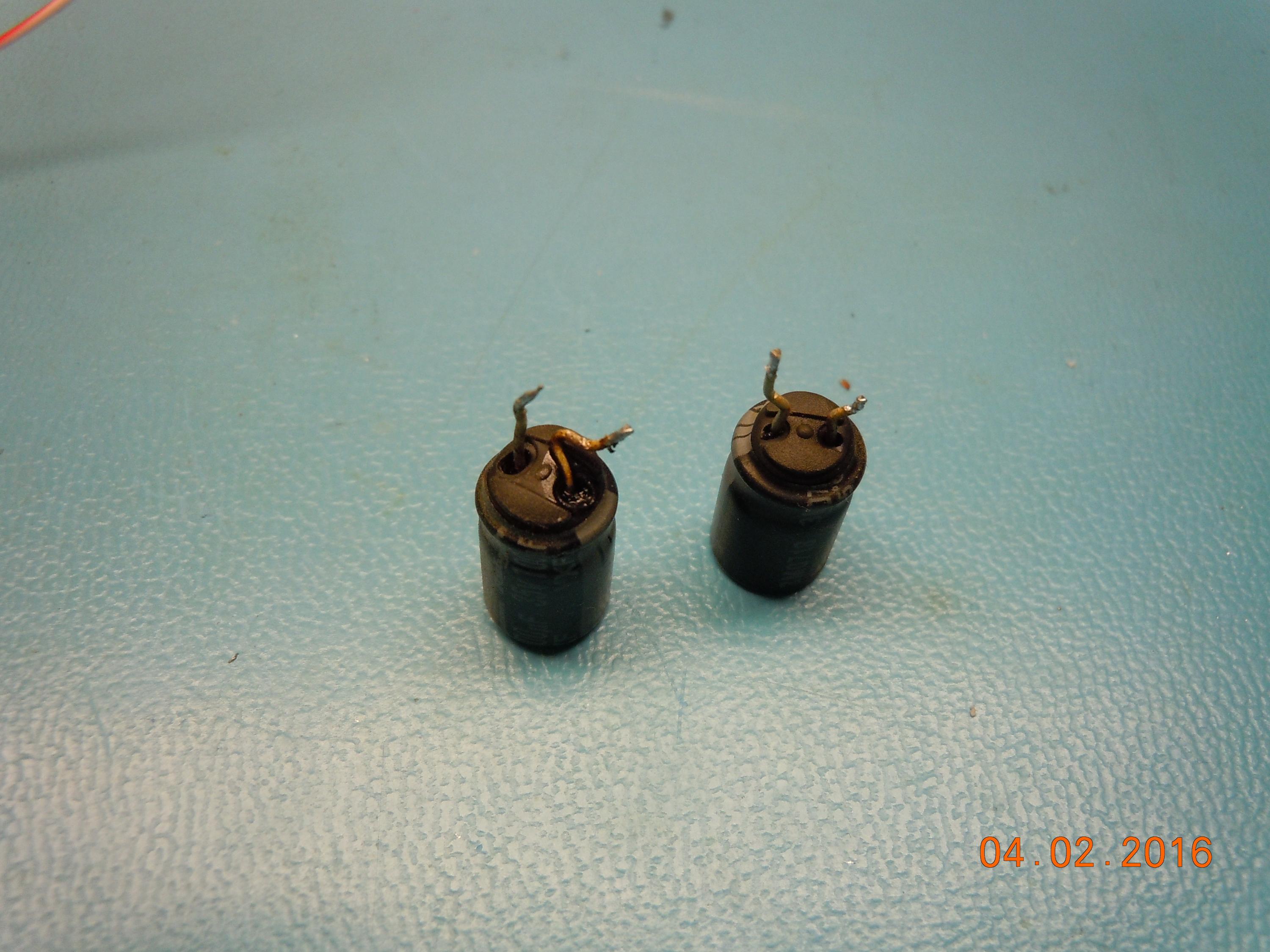

                              Another quick update and question. I removed a couple of suspect caps from the power supply board. One looks like it exploded out the bottom.
                              My question, right next to the suspect caps are L203 and L204. I can't quite figure out what they are. Both tested short but since I have no idea what they are.... Any clue? Pic's attached

                                  After talking to one of the techs where I work, they informed me that the mystery components are inductors.
                                    https://www.badcaps.net/forum/attach...7&d=1459694689
                                    The cap under the heatsink should be replaced also, you can see bare aluminum, looks like it got hot too.
                                        That caps under the heatsink look to be part of the PI filter to work in conjunction with those two small caps that have blown bottom, so more likely that the small caps had to do all the works due to bad caps under that heatsink..
