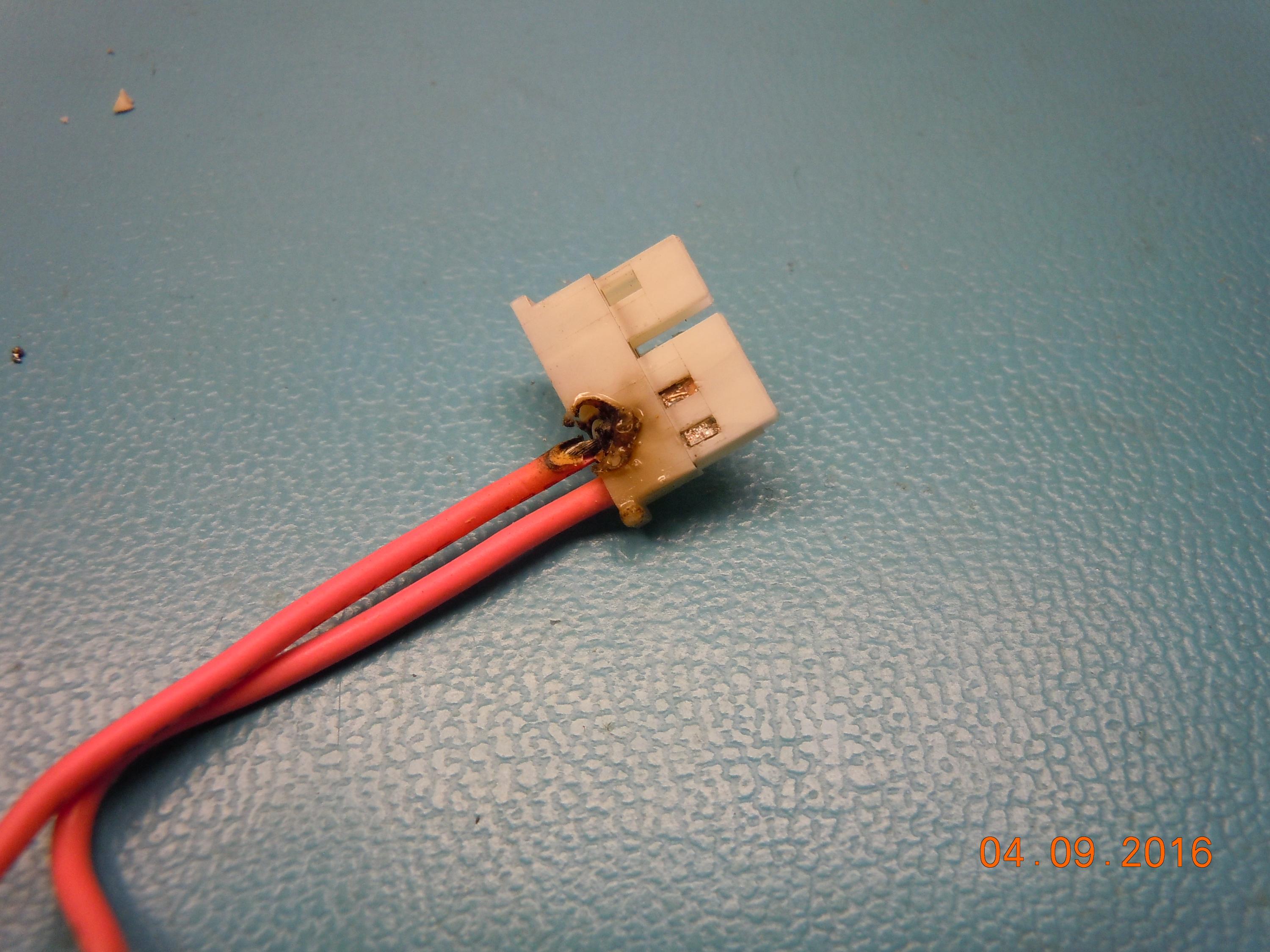

      SUCCESS!!! Replaced the caps and fuse. Discovered a short on the slave inverter to backlight. Made a quick repair and everything fired right up!!
