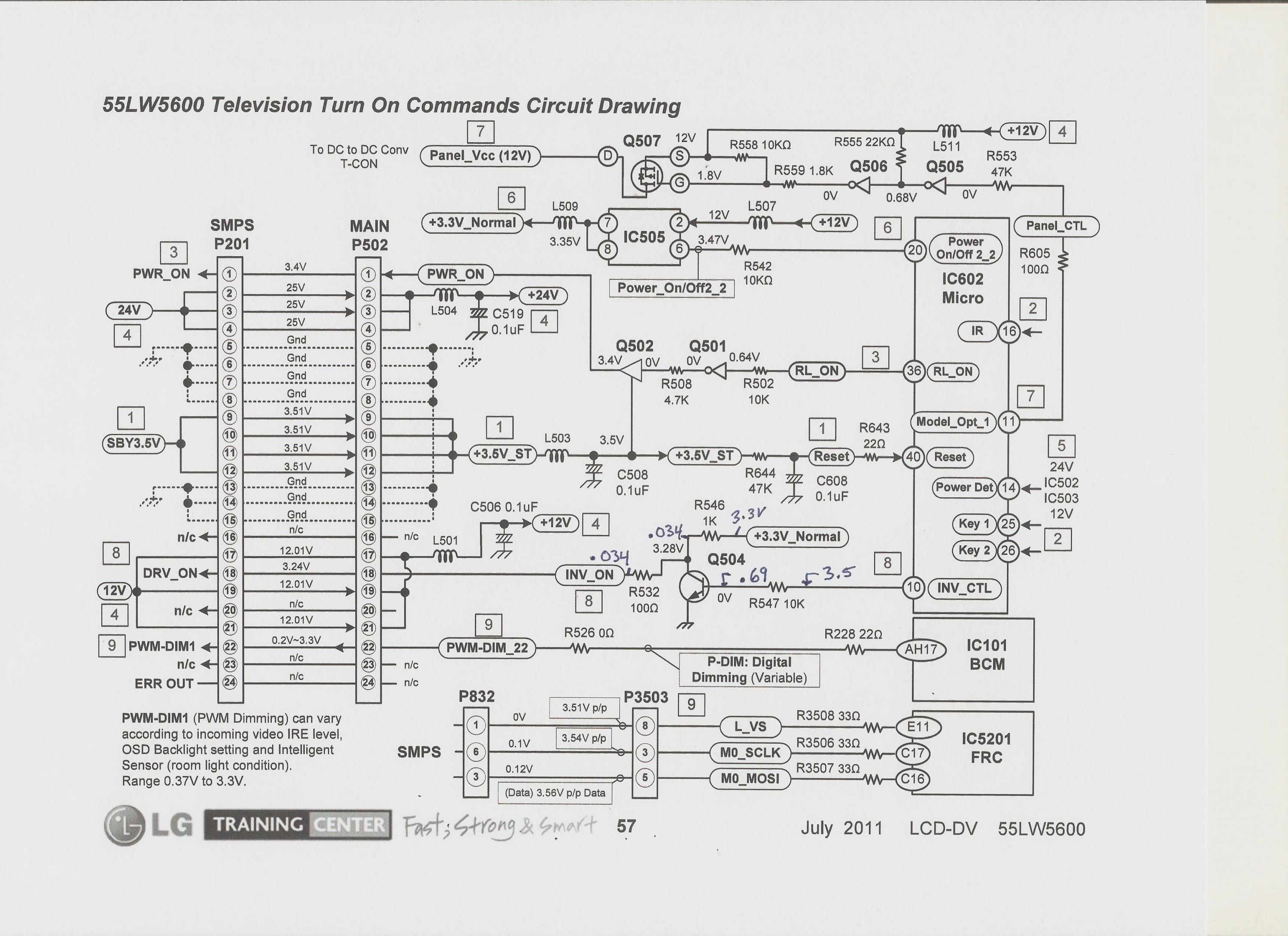

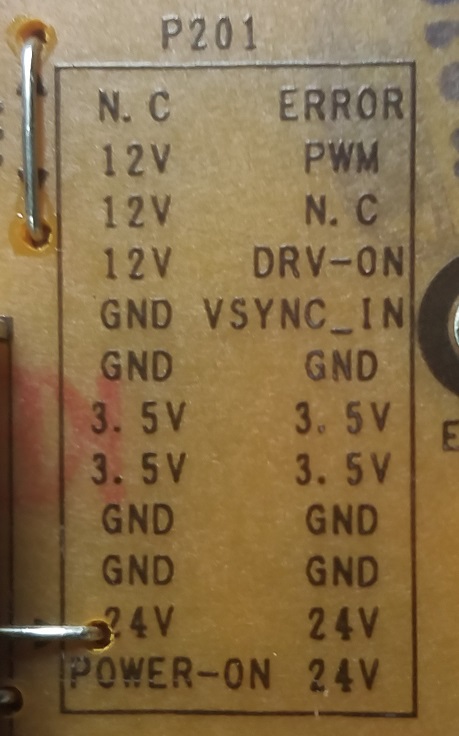

          Finally, I am back to this tv.
          Tv power led switches from red to white with no video or sound, no backlights.
          In checking output voltages of power supply, connector p201, no 24v on power-on pin (bottom pin). It reads 3.4v.
          There is the 24 on the pin right above it as also indicated by the key above.
            ignore. I misread the pinout info on the board.

                  Yes the 24 volts is okay. The other voltages are okay as well however for some reason the TV still is not turning on. I tried to follow the troubleshooting guide in the service manual that I found on the internet. After getting about more than half of the way through I could not find the remaining components that it asks you to check. If there are any other checks to be made or any tricks I can try let me know.

                    Can I get the DCV readout of all the pins for that connector?
                    Please make sure to put down the pin name and follow by the DCV reading when the TV is OFF and when the power switch is activated?
                    https://www.badcaps.net/forum/attach...1&d=1490026373
                    You have 24 pins total, you can skip the GND pins, it is also setup as odd and even pin rows so make sure you are reporting the right pins.

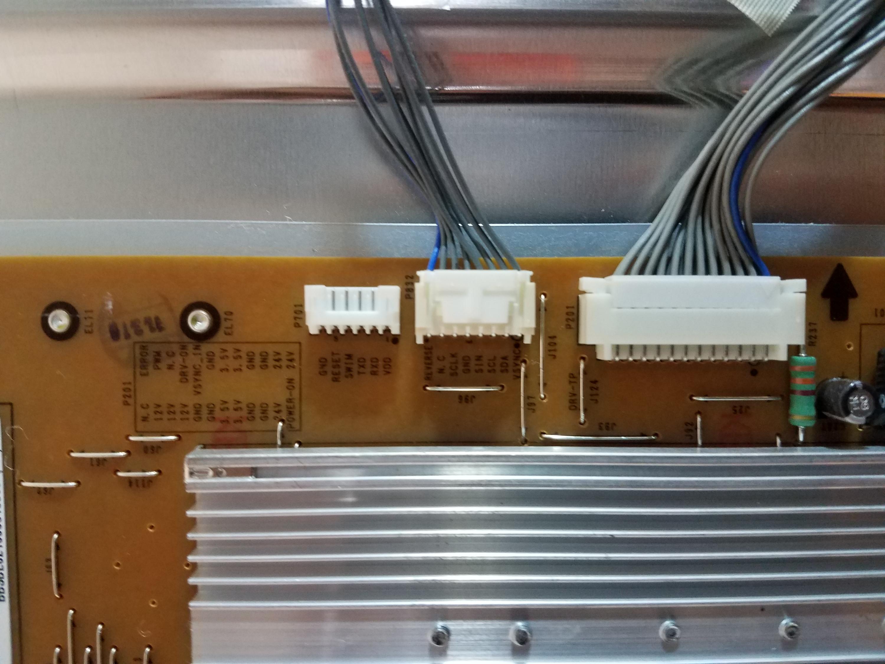

                      All of these voltages are from in the "On" state.
                      You'll also notice that the pinout from the board in inverse of that which the drawing shows.

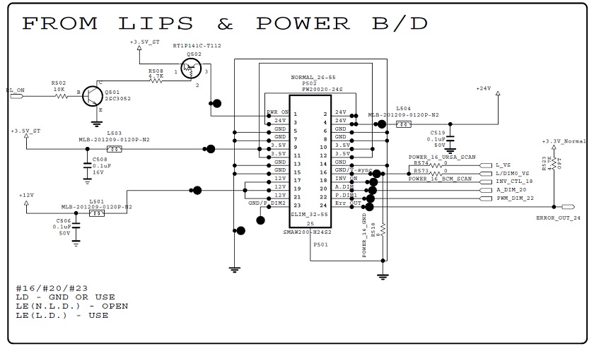

                                    Something just will not let me give up on this TV yet. I followed the jumper instructions on how to get the backlights to turn on. They and thier voltages are correct. They stay on as long as I have the set on.
                                    Now... I just using that as a starting point. The circuit never fires up the backlights. If the test has me jumper 3.5 volts to the pin 18.... then pin 18 (as shown in this drawing) should have about that 3.5 voltage for a normal running situation. This drawing taken from the training manual shows 3.28 volts should be present there on pin 18.
                                    My board only shows .034 on pin 18 when hooked up regular ( not jumpered). Please take a look at my notes on the drawing for that circuit. They dont seem right at all but where do I look next? I would assume taht IC602 is putting out the right voltage on that pin 10 (3.5) and then is Q504 isnt doing it's job? One thing that I didnt check is for the emmitter to be properly grounded as shown in the drawing. I dont know if that would cause it to be in the state that it is or not. My transistor theory is kinda rusty at this point.

                                        If Pin 18 should be at 3.5v then the transistor Q504 needs to be switched off. So pin 10 should be at 0V. It looks like the INV_CTL signal is holding INV_ON in the off state.
