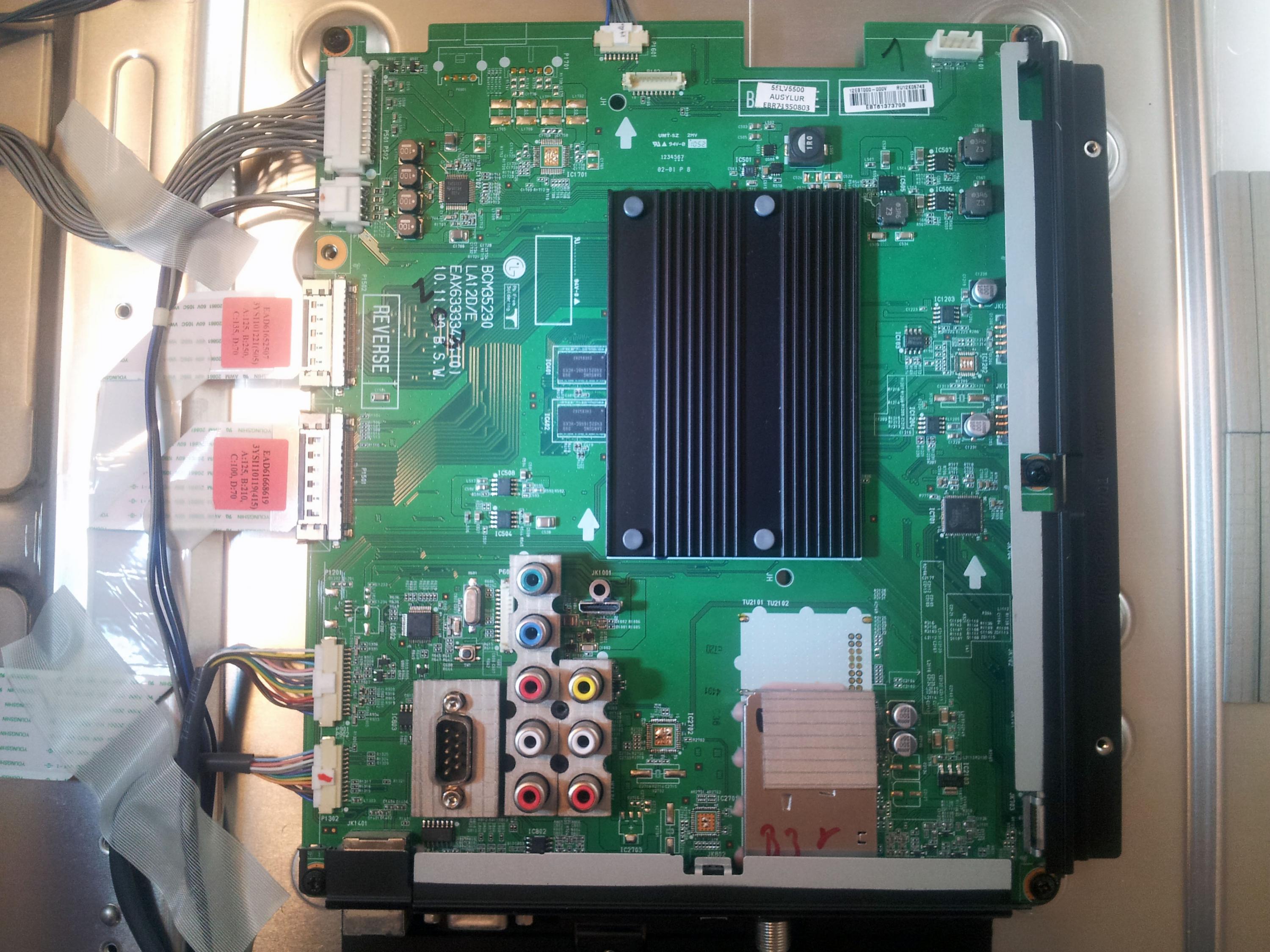

    I have a LG 55LV5500-UA led smart tv that has no picture or sound when powered on. When the tv is turned on it powers on & the lg logo display for a couple of seconds then go off. There is no picture or sound just backlights staying on. I removed the rear cover to check for popped capacitors but there were none. I would appreciate any help.
  • Hamie
    • Apr 2014
    • 1383
    Re: LG 55LV5500-UA no picture or sound
    Probably another led failure.
    Upload pictures of the boards

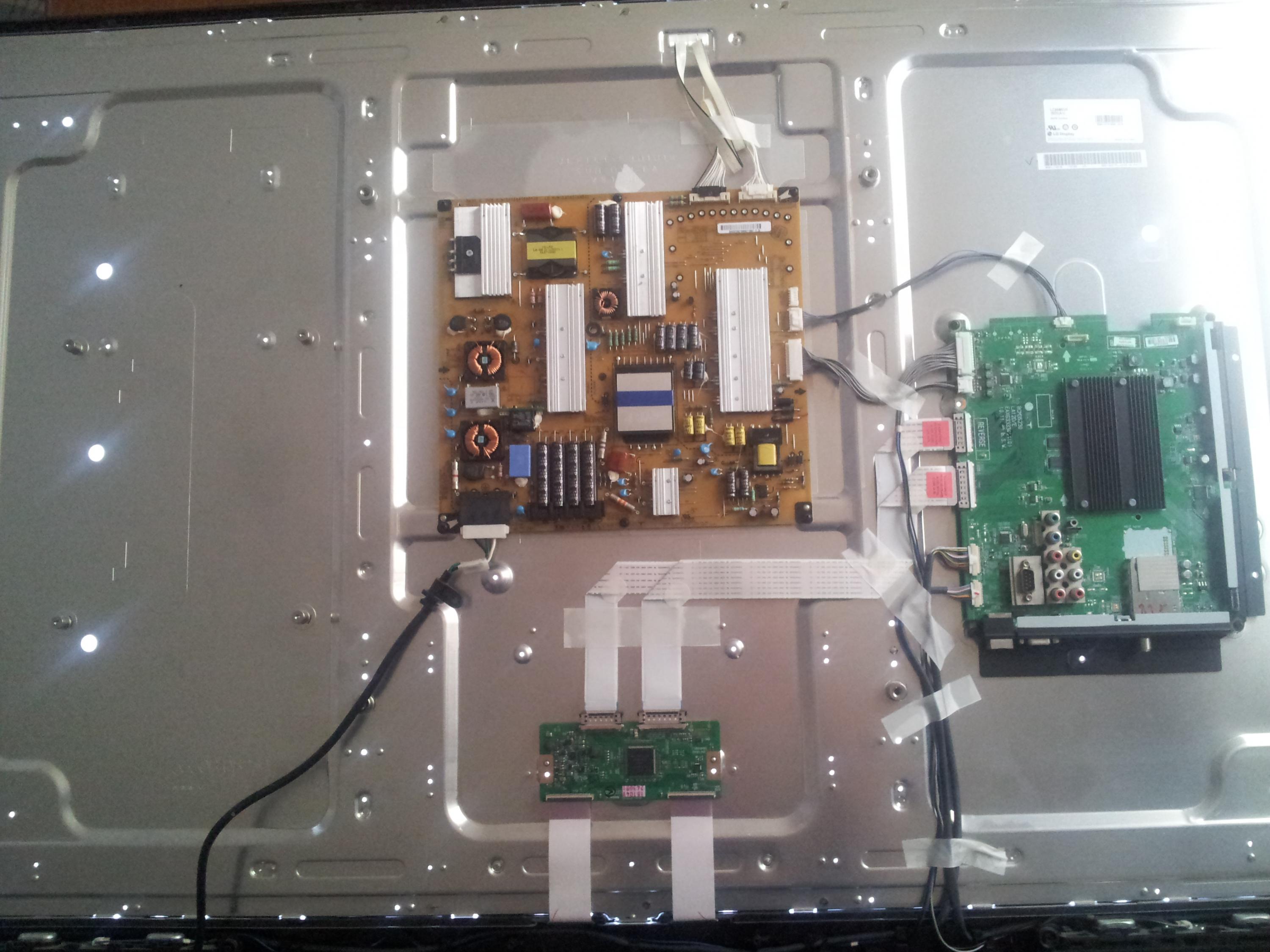

      Here are the pictures you have requested. I even took a picture of the backlights on when the power is turned on.

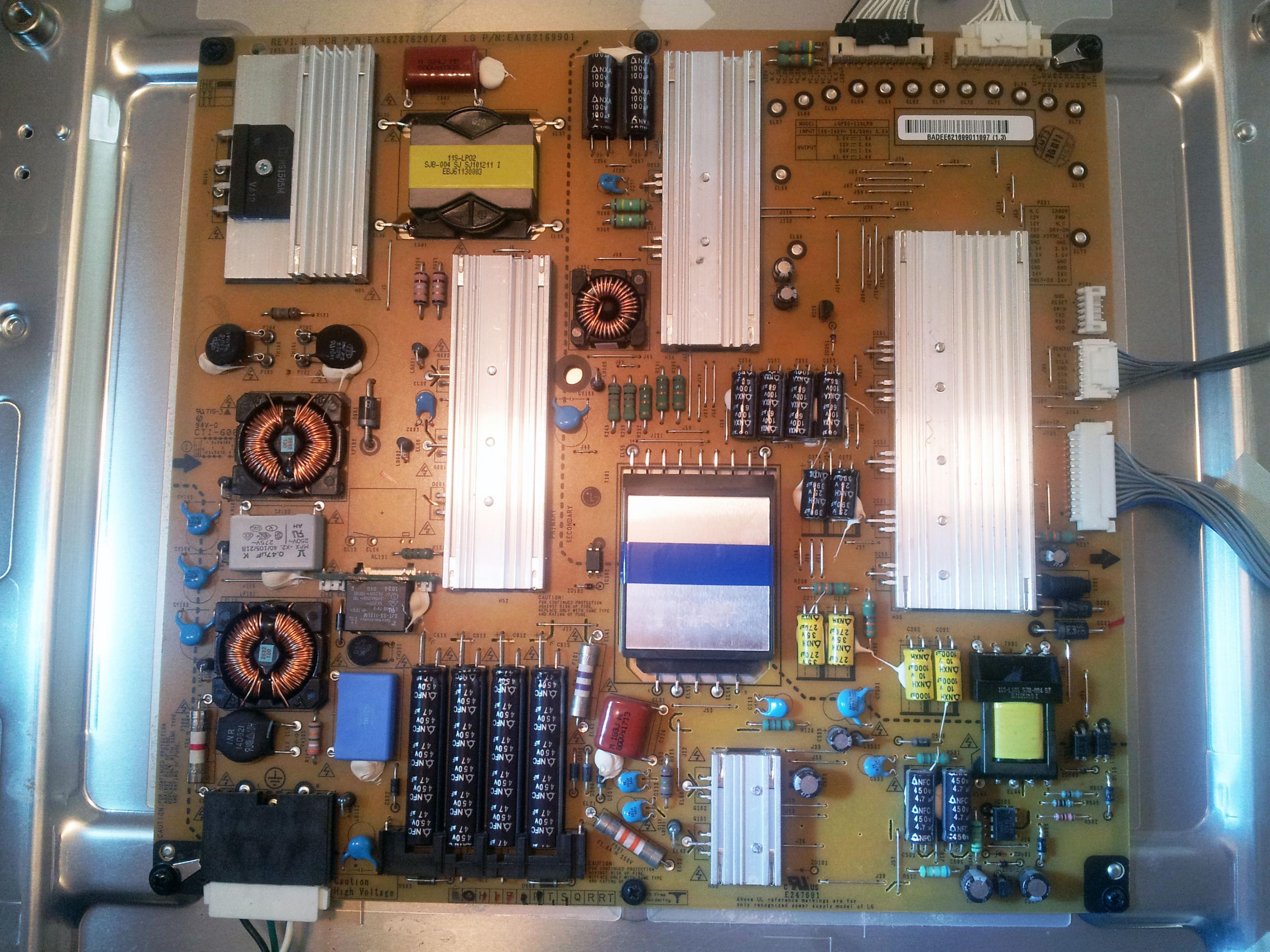

        Hamie correct, LG 55 had 2 strips, even half of one strip ligh <ou will see backlight
        first check the backlight voltage one by one, which one read higher at turn on.

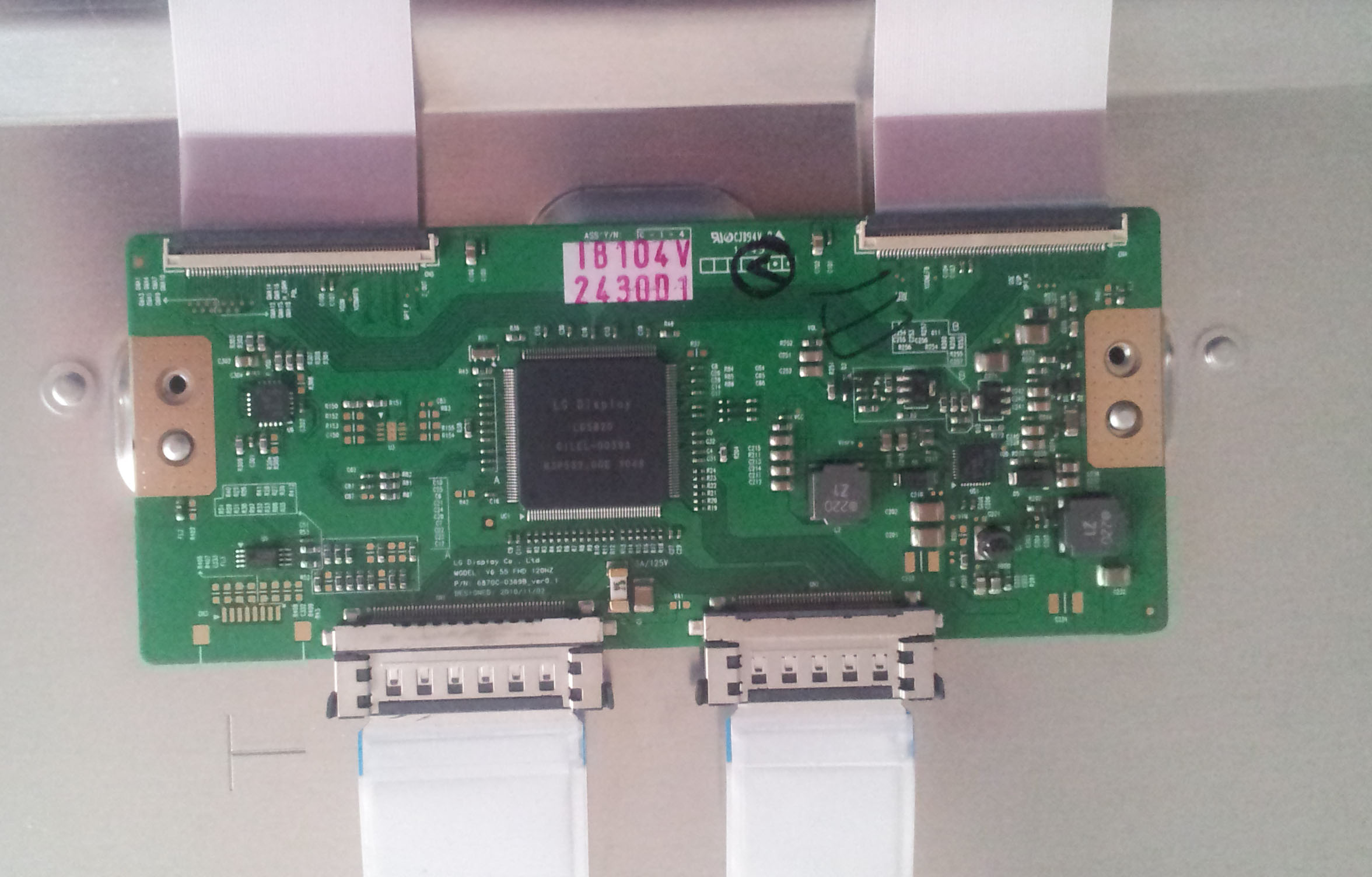

          "There is no picture or sound just backlights staying on" So the backlights are actually staying ON and will go off if you turn off the power switch but you cannot see any images on the screen?
          "lg logo display for a couple of seconds" LG logo on the BEZEL or actually LG image on the LCD screen?
          Are you getting 12 DCV (DCV depends on the panel design) on both ends of the SMD fuse on the T-CON board?

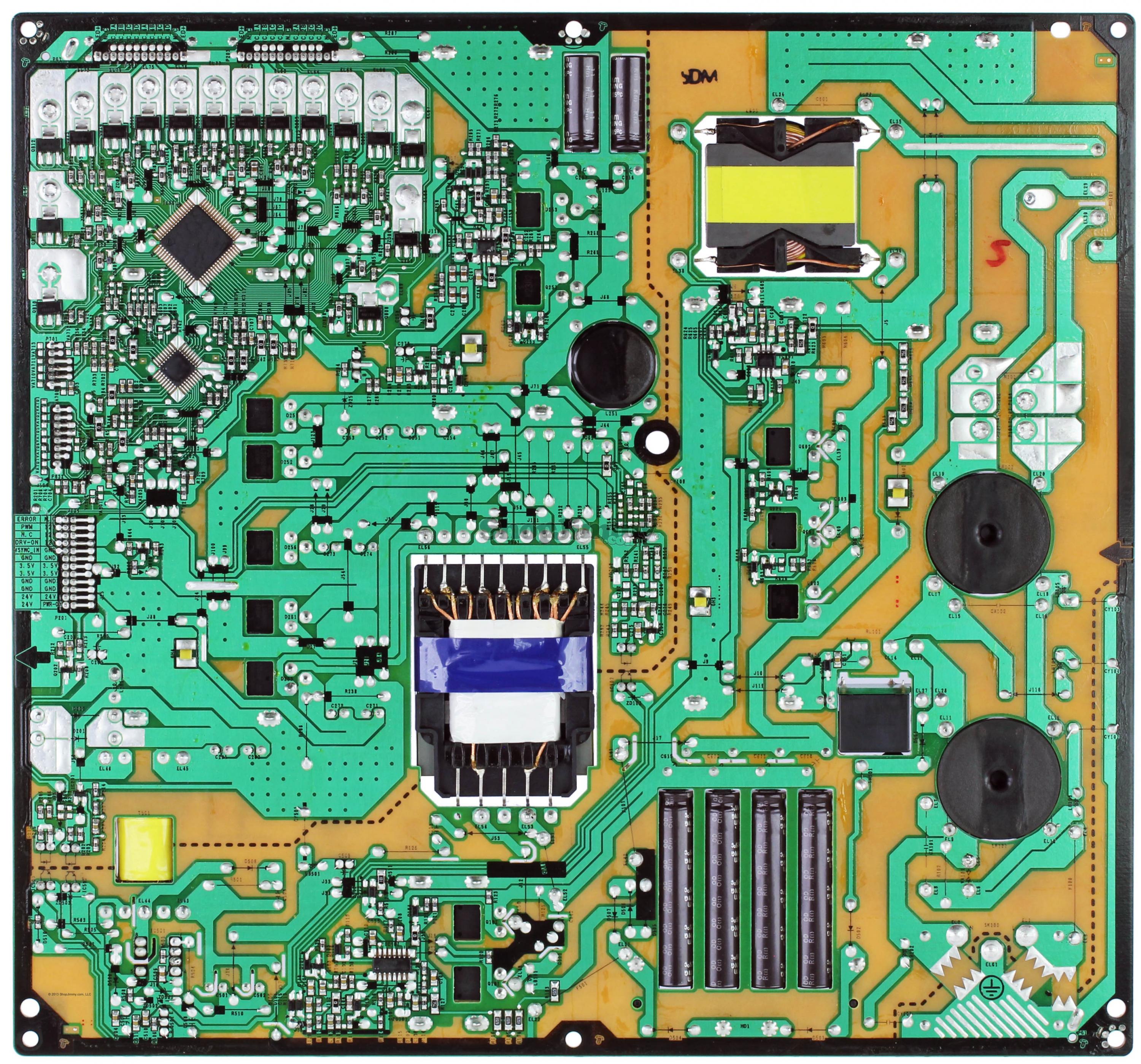

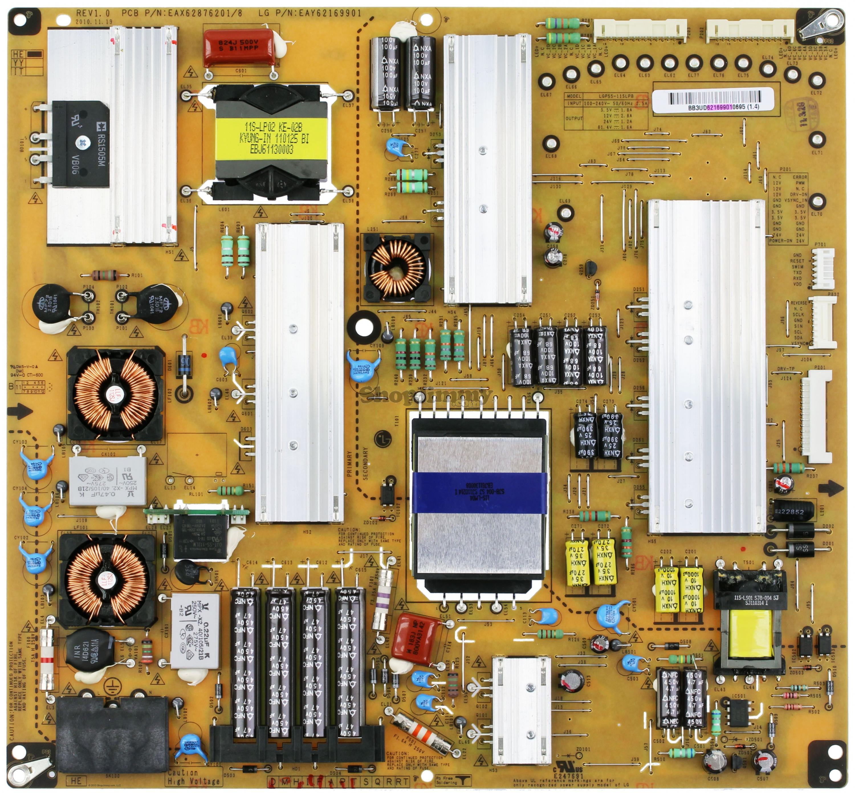

              LG EAY62169901 (EAX62876201/8) Power Supply 55LV5400 55LV5500 55LW5300 55LW5700

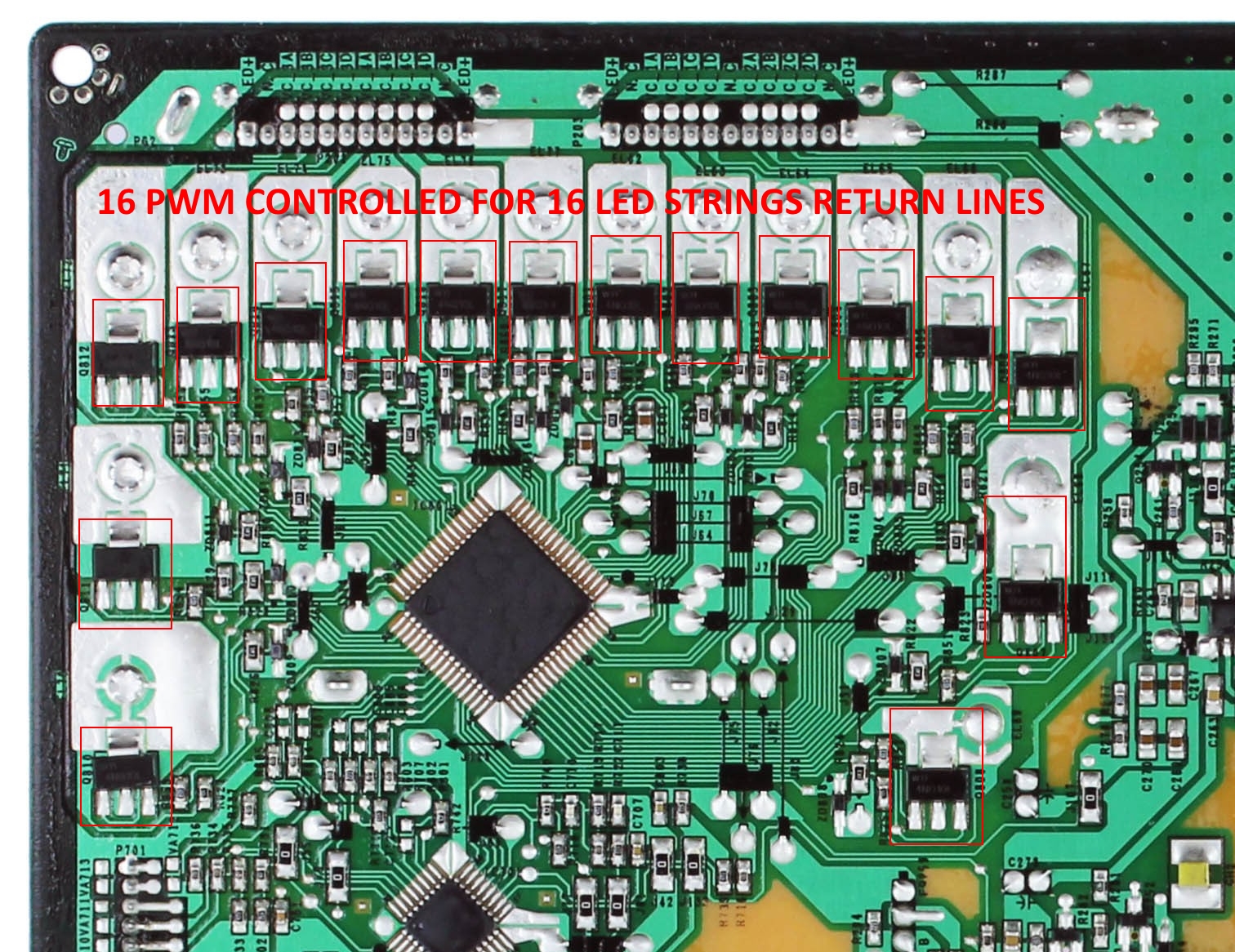

              To OP, If you look at the LED connectors, you will see pin labels as 1A~C (4 STRINGS), 2A~C (4 STRINGS), 3B~C (4 STRINGS), and 4A~C (4 STRINGS) so you have total of 16 strings thus 16 Power MOSFETs for the 16 LED Cathodes return lines.
                Yes the backlights stay on when the set is powered on & turn off when turned off. The LG logo is displayed on the screen & then disappears after a few seconds. I will check the voltages of the (16) mosfets & for 12DCV SMD fuse on the T-CON board if it has one.

                  Here are the voltages from the smd fuse from t-con & backlight voltages (each point being tested when powered on)
                  T-con smd fuse both sides 10.91 V
                  Starting from the lower left power ic:
                  1.) 12.50V at turn on then 1.6V
                  2.) 12.50V at turn on then 1.5V
                  3.) 12.50V at turn on then 1.3V
                  4.) 12.7V at turn on then 1.3V
                  5.) 12.8V at turn on then 1.3V
                  6.) 12.7V at turn on then 1.3V
                  7.) 12.3V at turn on then 1.3V
                  8.) 12.5V at turn on then 1.3V
                  9.) 12.1V at turn on then 1.1V
                  10.) 13V at turn on then 1.3V
                  11.) 12.7V at turn on then 1.1V
                  12.) 13V at turn on then 1.4V
                  13.) 12.4V at turn on then 1.2V
                  14.) 12.5V at turn on then 1.2V
                  15.) 12.4V at turn on then 1.3V
                  16.) 12.6V at turn on then 1.5V
                    "Starting from the lower left power ic:" Which IC is that? Do you mean the 16 Power MOSFETs? If those are what you are seeing, they are OK, as you indicated, the backlights STAY ON, if there was an error the backlights will be commanded to turn OFF ALL the LEDs.

                      Yes the (16) power mosfets

                        So you do have Voltage to the T-CON that means the main board did not go into standby mode otherwise the DCV for the T-CON will not be there and the backlights also stay on, but you have no image on the screen so either the main board stops sending the signals to T-CON or something is going on with T-CON.
                        Try having one ribbon cables between the T-CON and the LCD panel connected one at time to see what you get.
                          I disconnected each ribbon cable going to the screen & nothing was displayed. The backlights stayed on & now the LG logo no longer shows on the set when turned on.

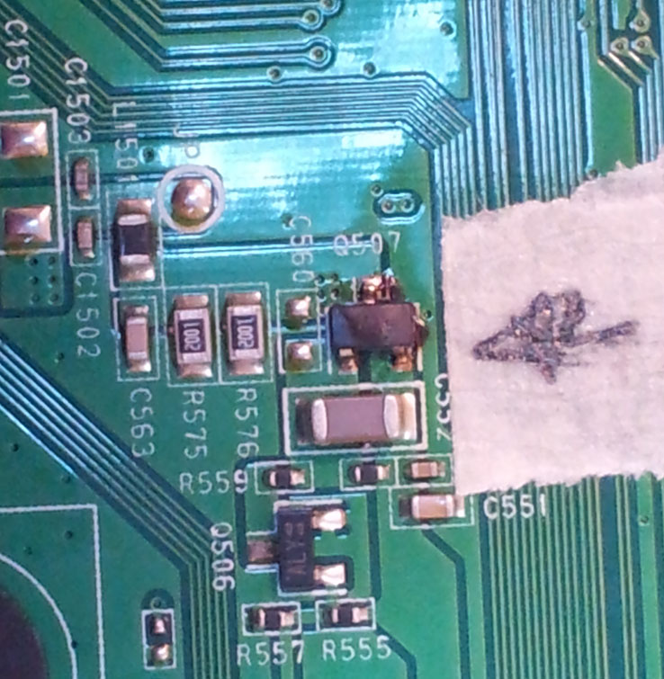

                                    I will check the ribbon cable pins under magnification & will report back. The menu doesn't show either. I did find one possible cause though when I was searching the back of the main input board. I found a burned 3-pin chip with the markings (X75A) with (16) written under it. I will upload a picture of it tomorrow.
                                      Here is a picture of the burned chip. I do not know what it is yet from the markings I previous stated.
                                        I found out the part is a "P-Channel Enhancement Mode Field Effect Transistor" & is located in the "panel power" section on the main board. I do not have one of these on hand to replace to see what will happen.
