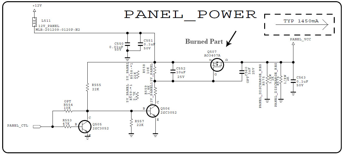

    I was able to find a schematic drawing & here is a picture of the circuit where the part was burned.
      Re: LG 55LV5500-UA no picture or sound
      That is the power MOSFET that supplies the 12V to the T-CON fuse, isn't it?
      That MOSFET is being used as a switched so for it to burn up it must have too much current draw through it so I would check to see if the load side (Drain pin) of the MOSFET has very low resistance or not.

            '6.) Checked (Q507: 12V) NOT GOOD BURNED WITH A BUBBLE ON TOP' So did you check the resistance between the T-CON fuse and GND to see if it shows low resistance reading?

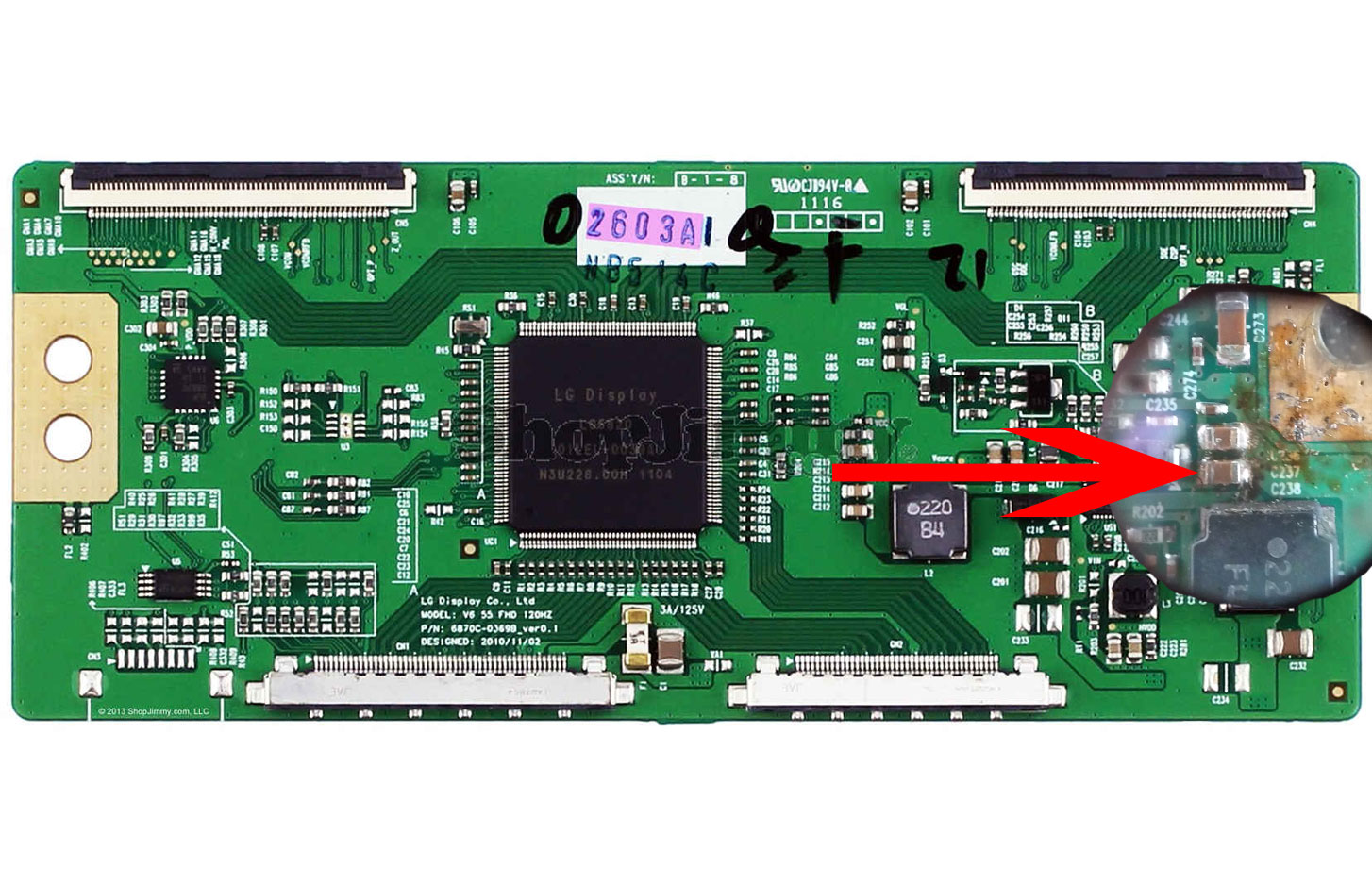

                                    I found a bad cap in the attached image. Cap reads 1.5-1.8 ohms in circuit and out of circuit. The other cap next it read the same until the bad one was removed. Which was quite difficult to remove but finally got it out.
                                    Other image is for whatever reason. I stepped on my soldering iron since I leave it outside on the concrete and work with no shoes!
                                      For some reason the first image never attached.

                                        Want to update that I repaired my 55LW5600 which had a similar issue to OP's TV. Mosfet burned out. Also a shorted cap on the t-con board. I ordered the new mosfet from arrow electronics, and removed the shorted cap from the t-con board. Powered it up and the t-con board works without the cap for testing purposes.
