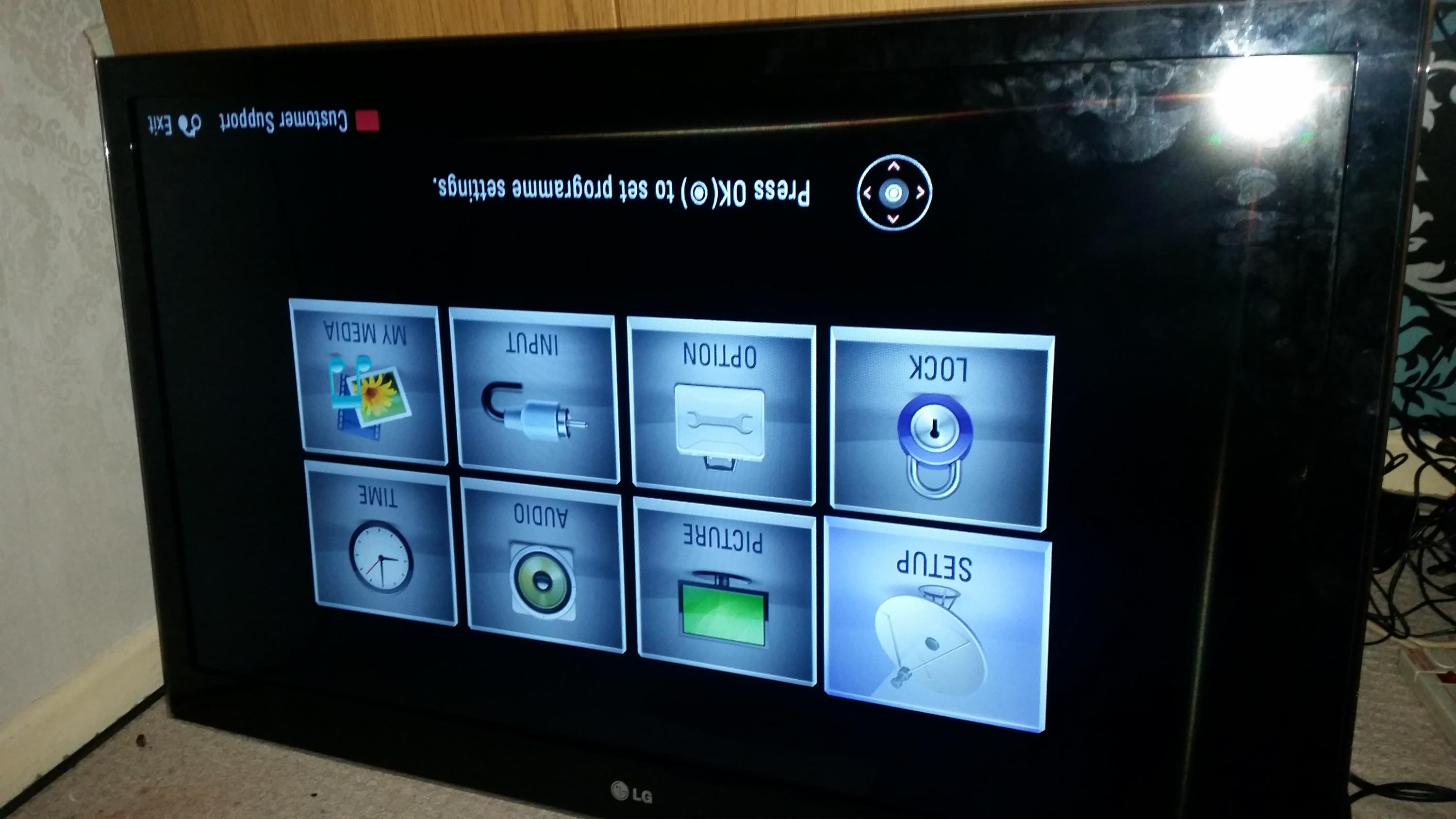

    Hi guys just got a new board for my tv exactly the same board but the pic is upside down any way to fix this

    I believe that you may be able to do this through the service menu.

        Re: Lg 42 led picture upside down
        You don't say what model LG you have or what board number you used to replace it so it's difficult to give you an answer at present.

          Sorry, its 42lv450u
          • dick_barton
            • Aug 2015
            • 6642
            • Wales
            Taken from another website:
            "This is most likely a setting that can only be altered using the TVs service menu. On LG flat screens such an option is named "Mirror" (within a sub menu of the service menu) which can be toggled on or off."
                  Hi no seems i need a service remote
                      no need to service remot menu, AZ_Adjust _ IN_StOP IN_Start can be done form any mobile phone ahd IR sender, like galaxsy S5, or from PC with DIY playing wmv files via winamp.
                      yes its mirro on now, just turn it off
                                        Fixed guys the ir app worked amazing thanks
