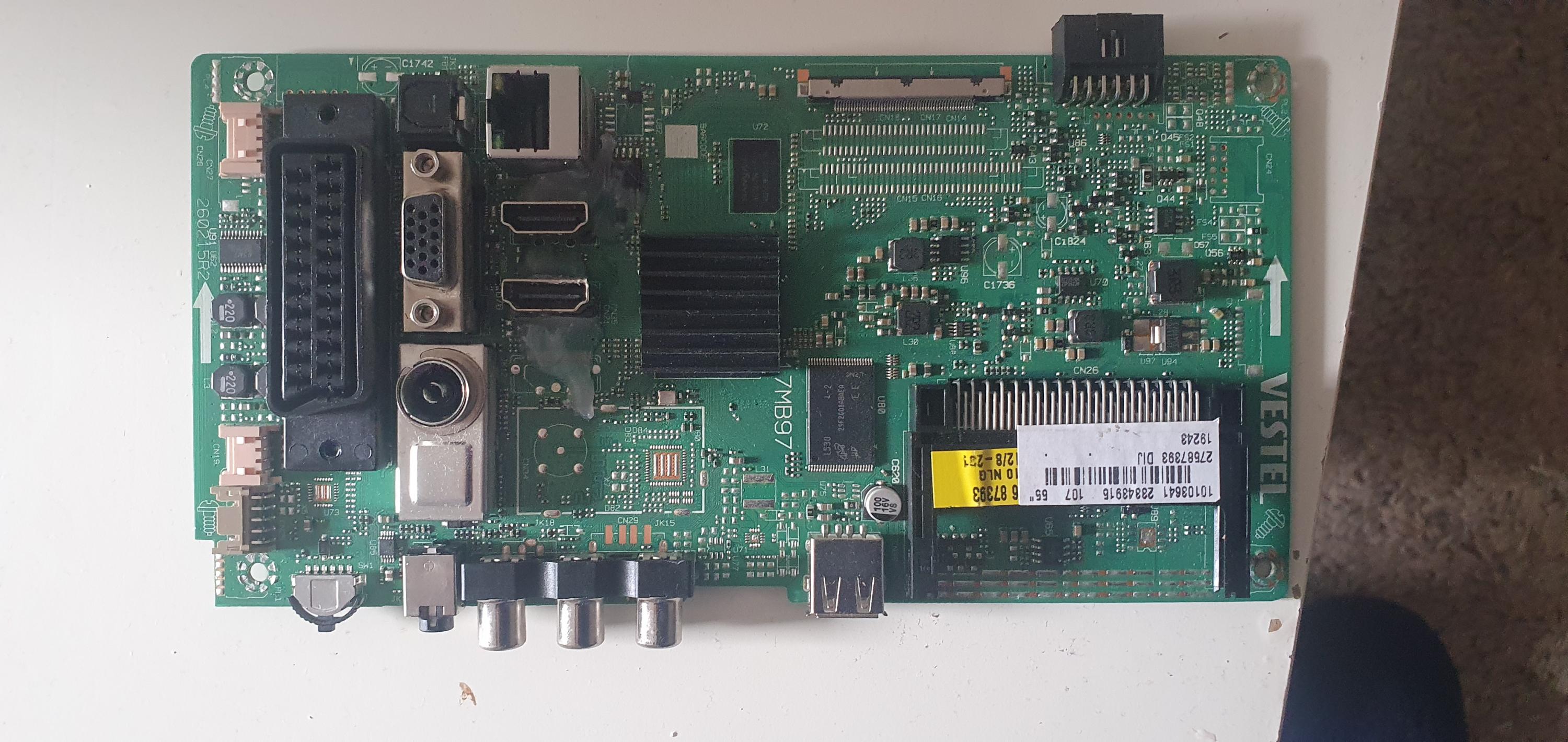

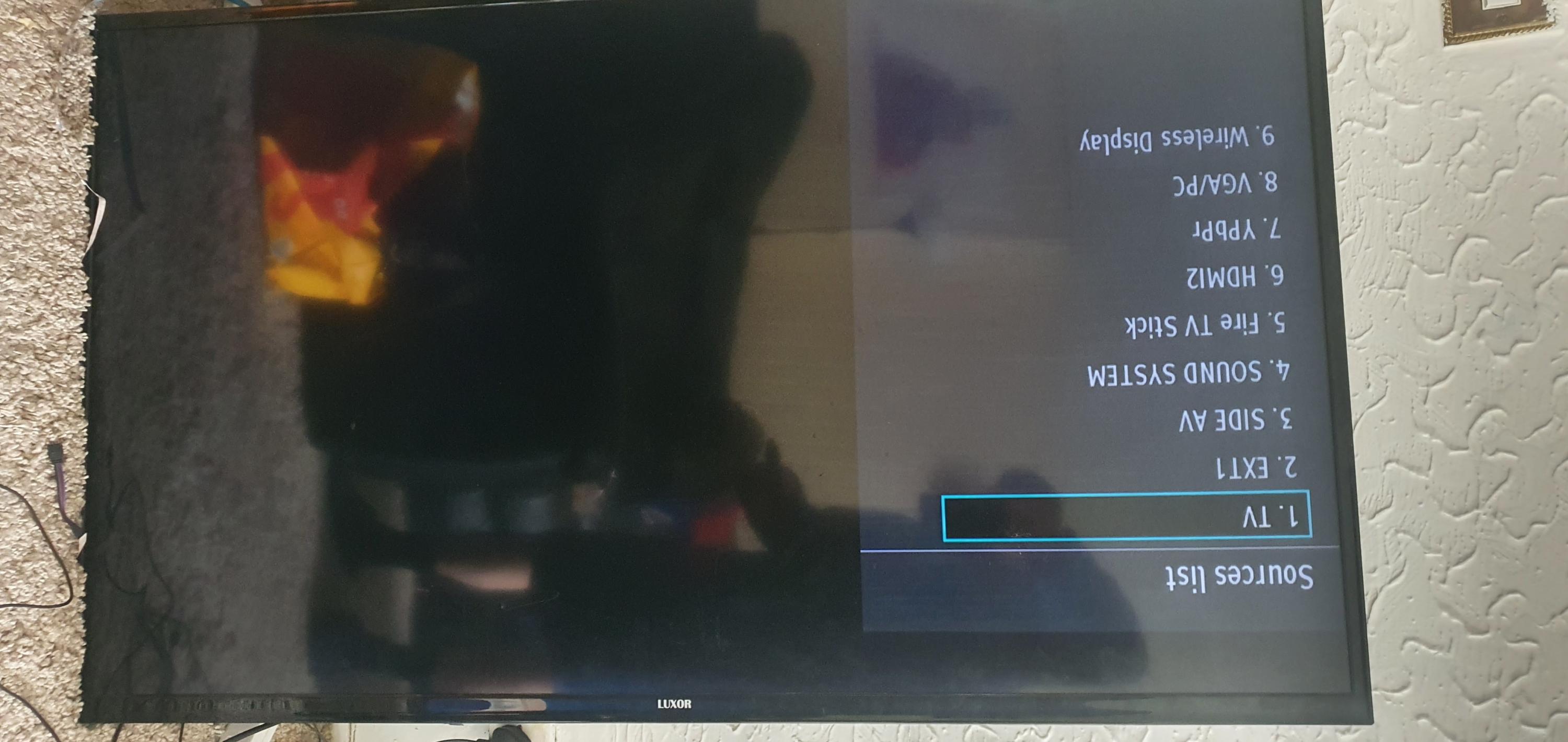

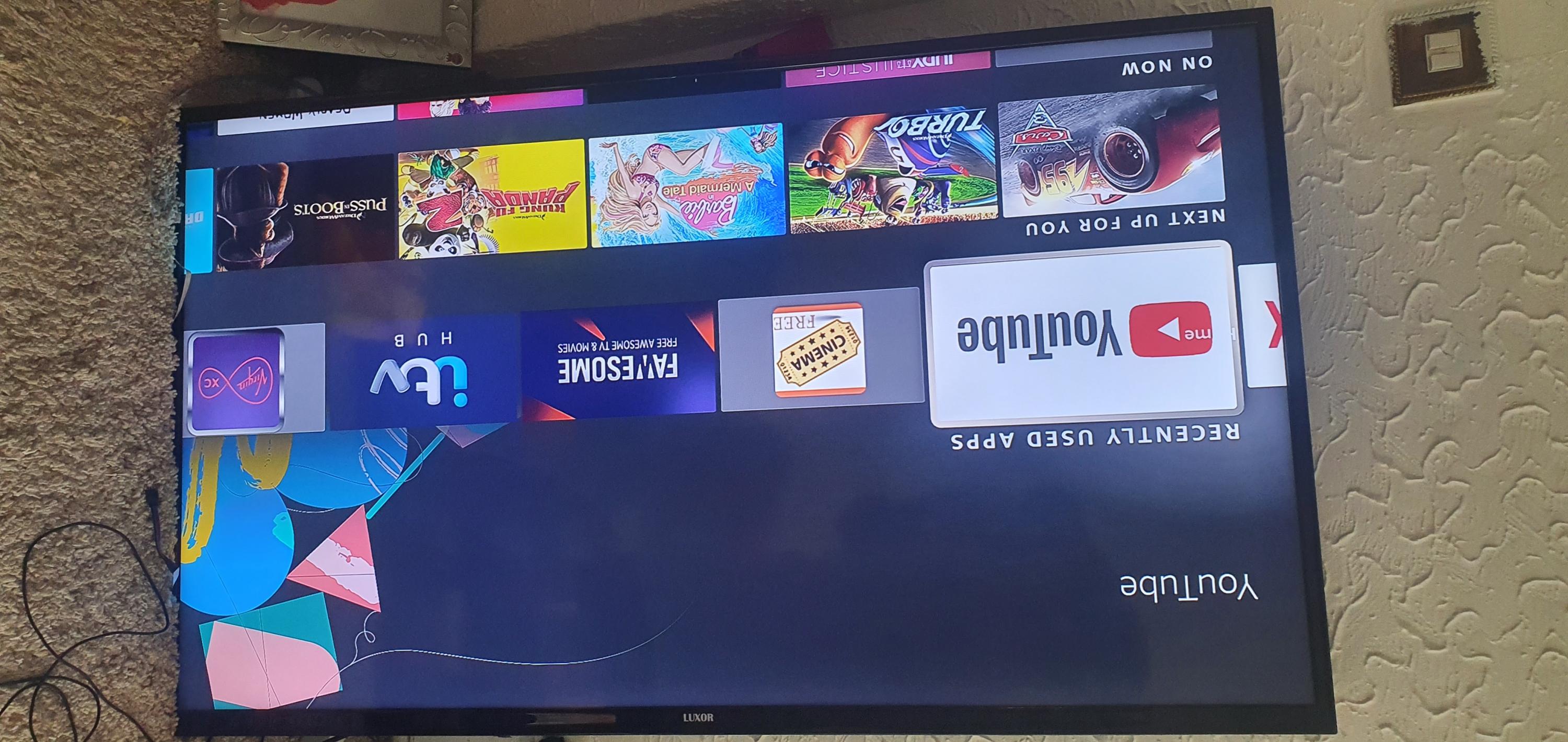

    Looking for some advice changed over the video input board due to bad hdmi ports but now the picture is upside down tried the service menu but can't find anything to do with flip the picture..
    Is there anything I can do to flip the picture or do I need to change the board again..

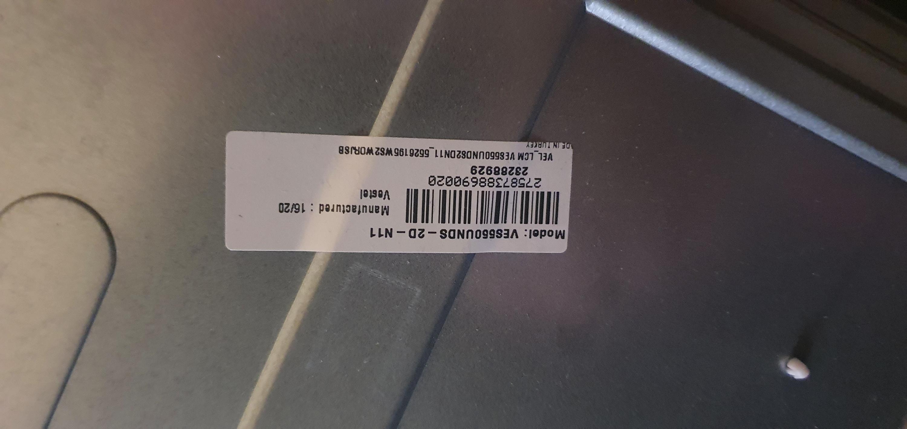

    Re: Luxor TV board input board change but picture upside down
    So I assume you have a VES550UNDS-2D-N11 screen inside your TV. If you do then if the board you have inside it is the one pictured, then you have a faulty board! As they only do one main board for that model of TV.
      when you get into the service menu with 4725 what are all the choices? factory reset might work.
              1. Format a stick with FAT32
              2. Put a folder called PQ on the stick
              3. Unzip and put the 2 files in the pq folder
              3. Turn on the TV and insert the USB stick
              4. Type MENU 4725
              5. Go to USB Operations and type OK on the remote control
              6. Wait 10 seconds and exit the menu with back/return
              7. Turn off the TV from the remote control and wait 10-20 seconds
              8. Unplug the TV and wait until the stby LED on the TV turns off
              9. Take out the stick, plug it in and turn on the TV.
                Brilliant yokoono that it sorted thanks again to this forum.. Thanks
