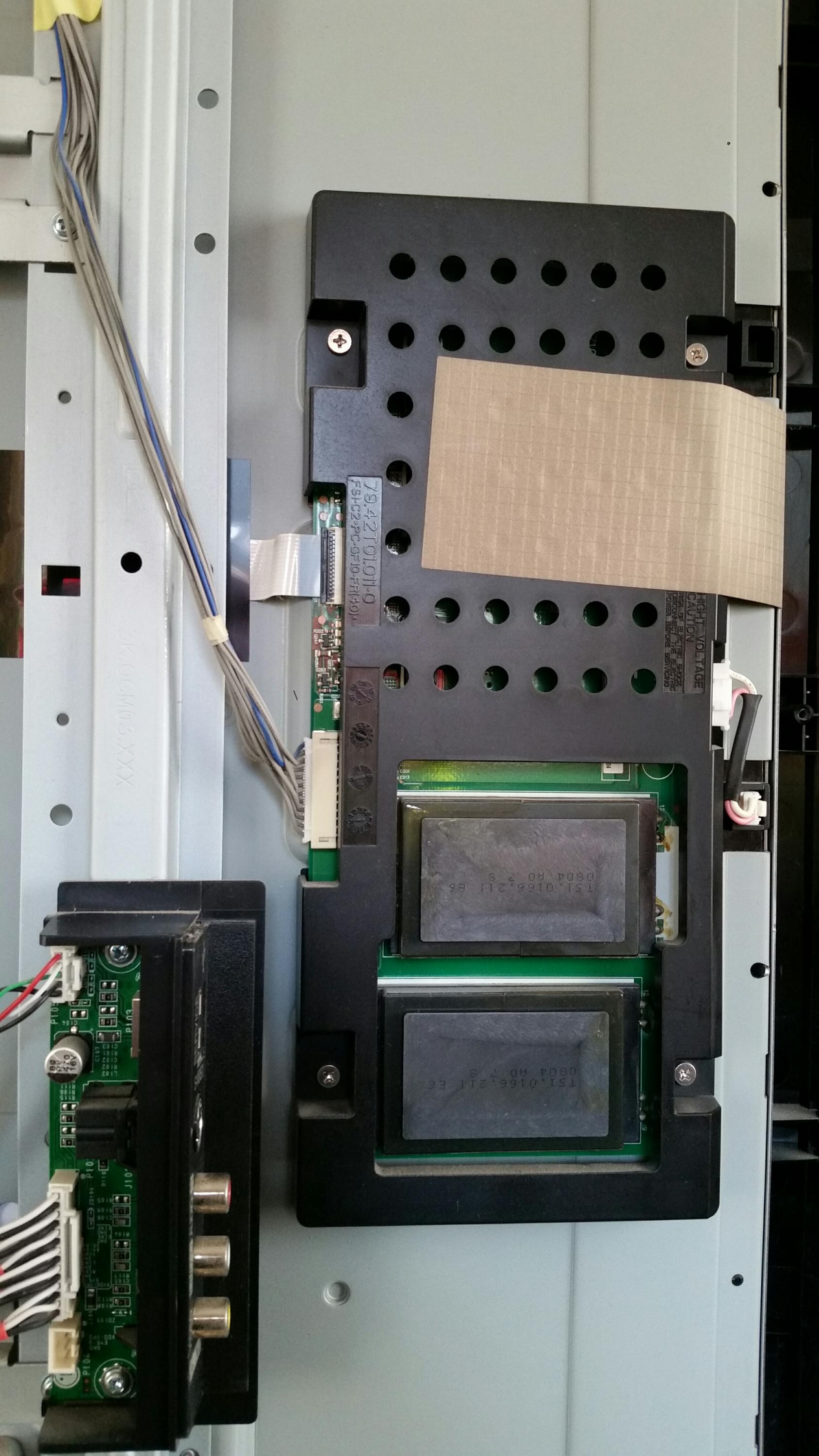

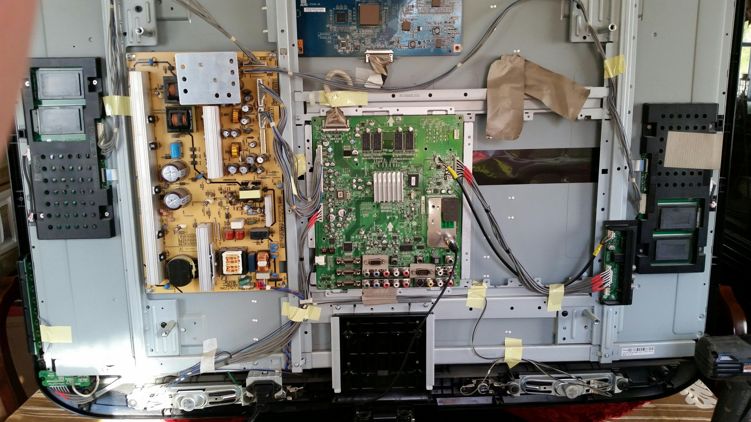

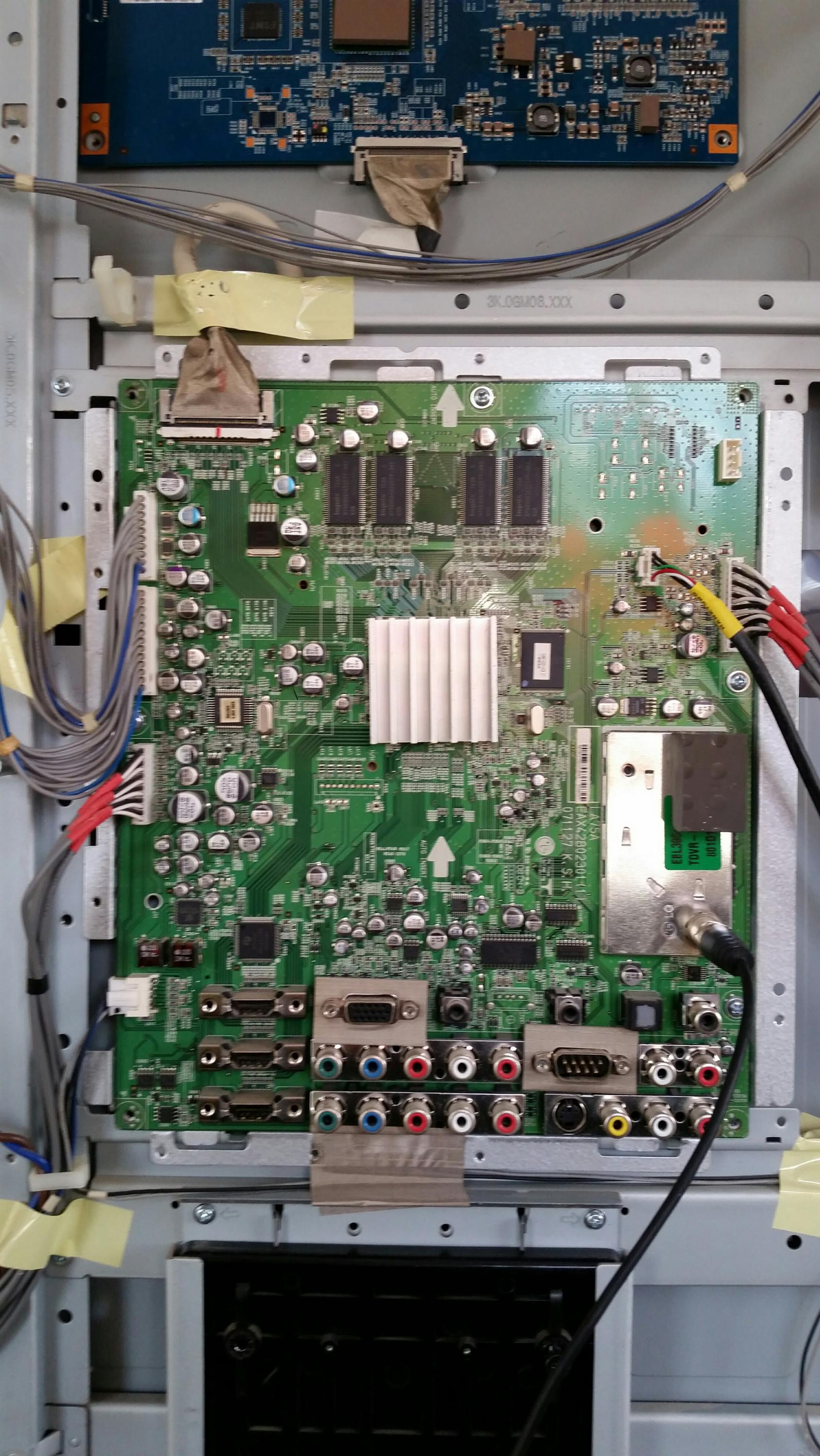

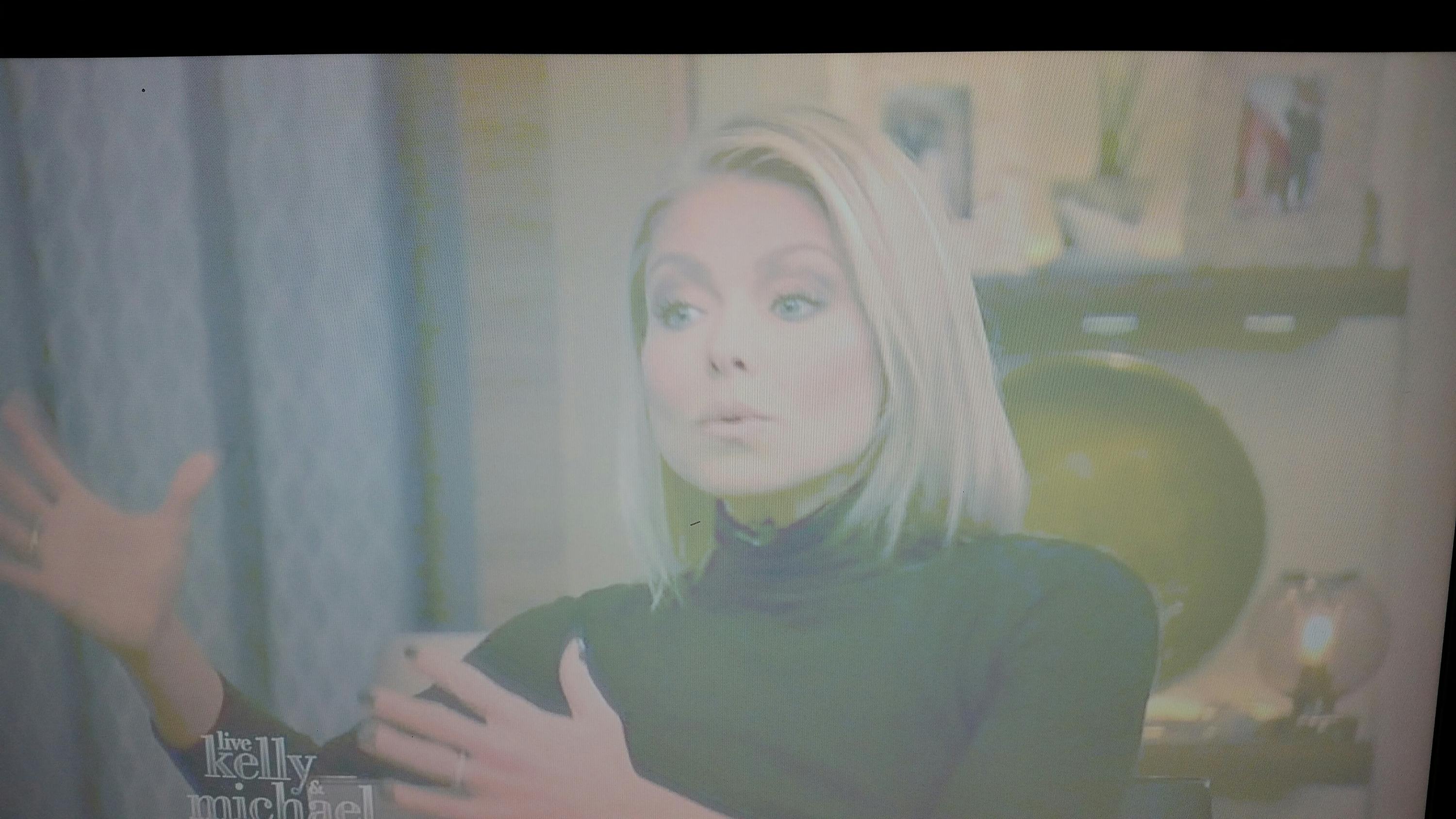

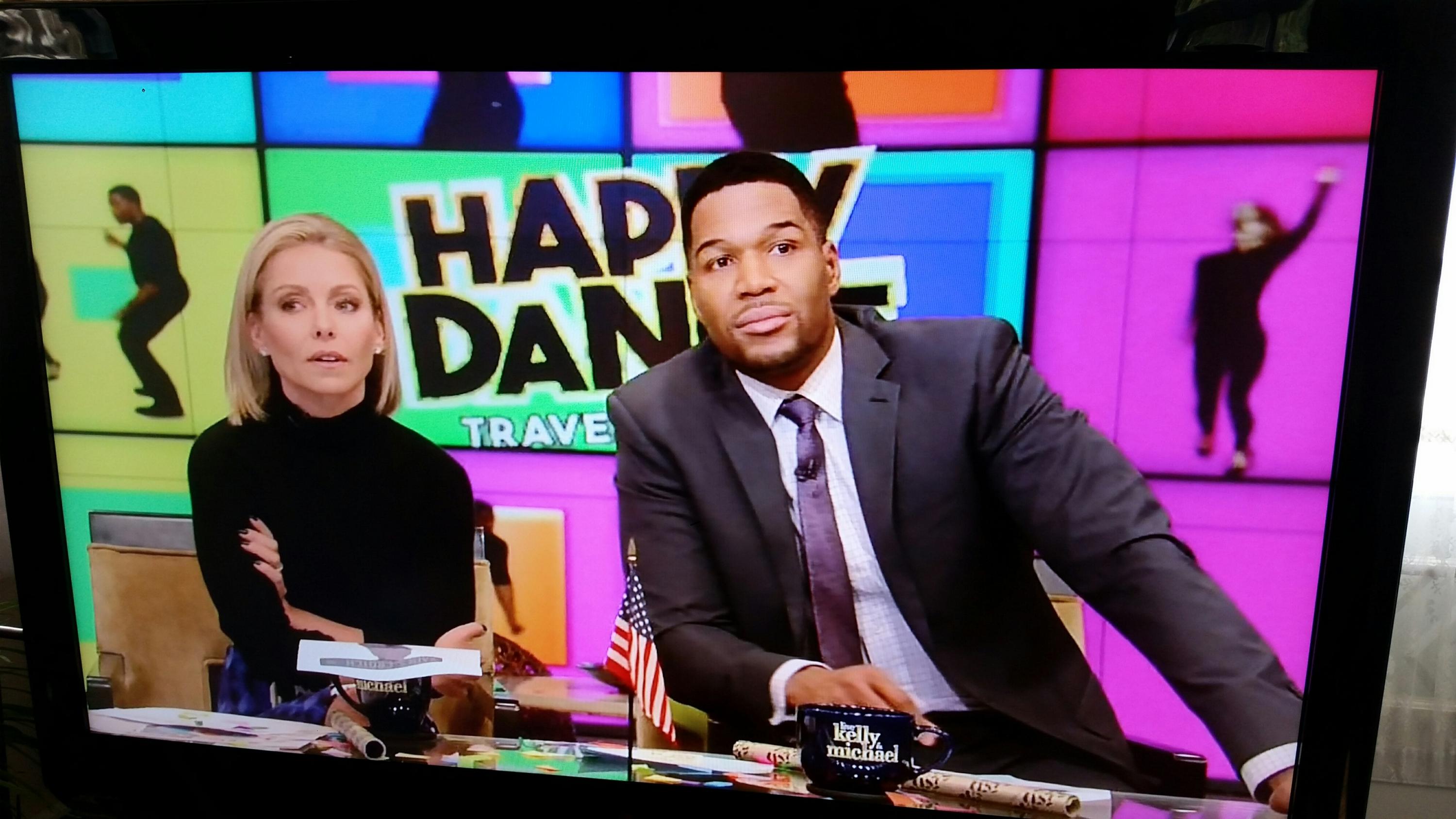

    Hi everyone I have a 42LG20-UM LCD TV and I need help Diagnosing picture problem. When the TV is first turned on everything works fine but after a few minutes the pictures slowly losses its contrast and becomes washed out. Also the power light flashes green 6 times at startup. I have started testing the power supply and everything seems fine.i have attached pictures of the components and believe the problem is either the power supply, main board or the T-Con what do you think?
    Chris
    Re: 42LG20-UM LCD TV washed out picture

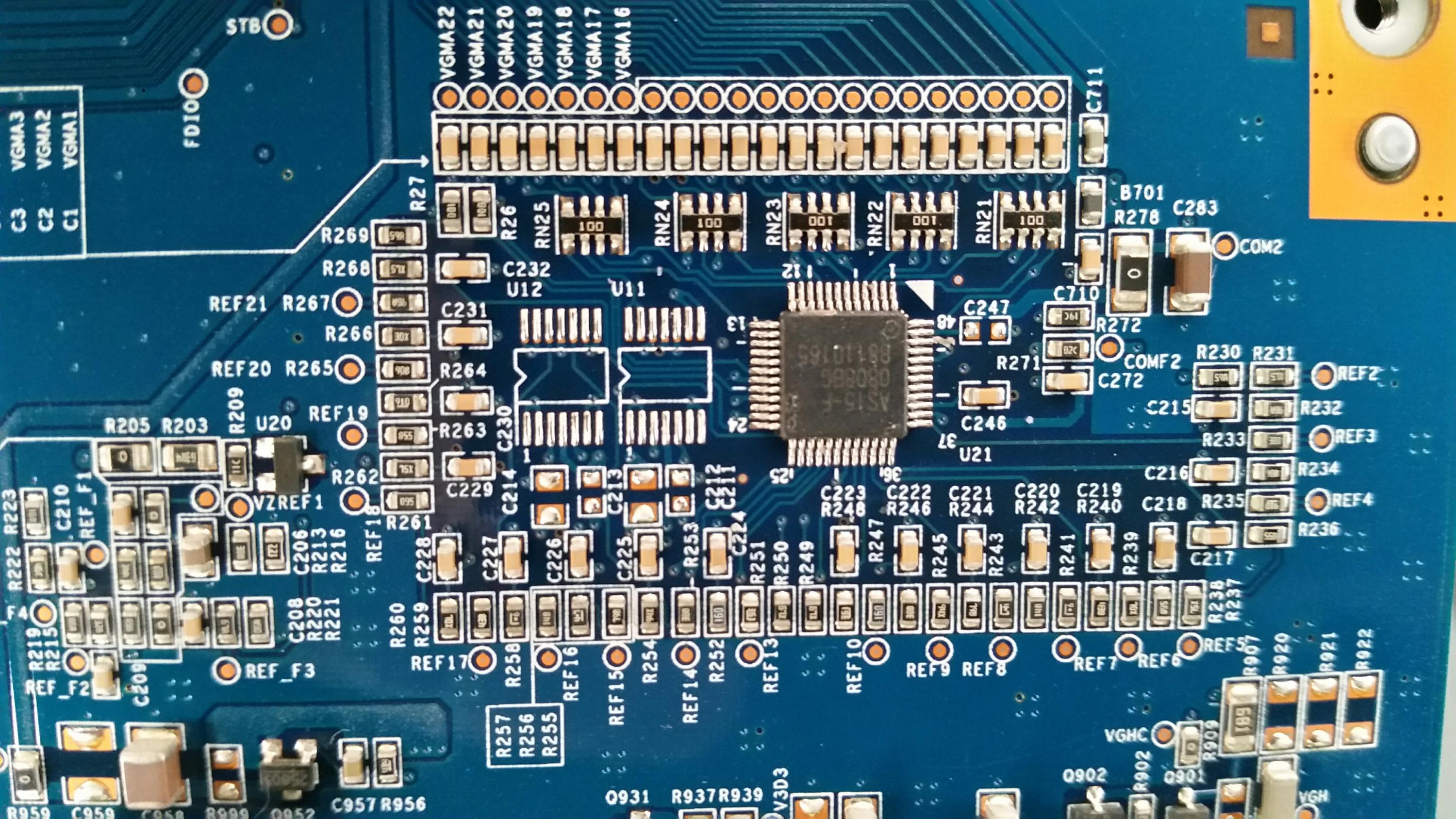

    Looks like bad Gamma Voltage, remove the Silicone thermal pad from the IC on the top right of the T-CON board to see if it is AS15 or AS19.
    You can also take the DCV readings of the Gamma Voltages at the test points on the board.

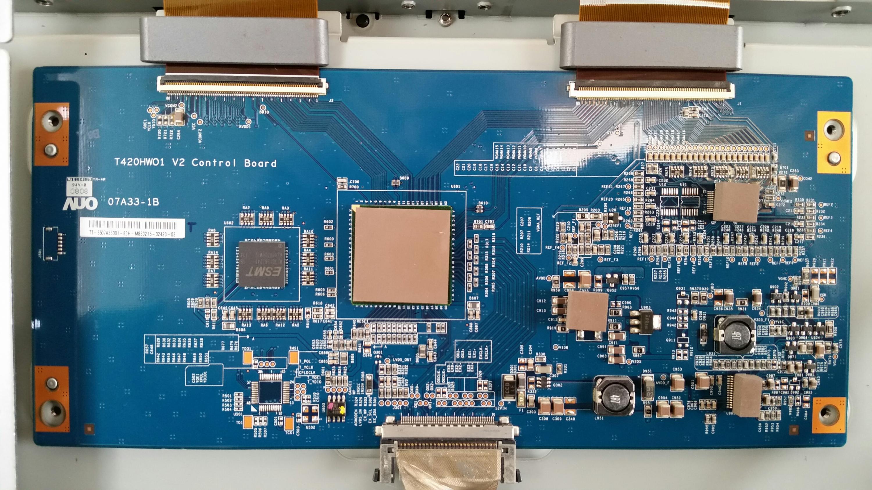

        Thank you budm and CapLeaker for your quick response. Yes it is an AS15, I had to put on two pairs of glasses to read it. how can I take the DCV readings of the Gamma Voltages at the test points on the board? What should they read and does this mean the T-Con is bad?
        • chris1sr
          • Mar 2016
          • 16
          T-Con picture attached
            OK, AS15 Gamma ref IC.
            Does it get to be to hot to touch when the screen washed out?
              No, I waited five minutes the screen washed out in about two the AS15 just felt slightly warm,

                You can replace that AS-15 IC if you comfortable doing this, or replace the T-con.

                  Record the VGMAxx dc voltages and post here like..
                  VGMA22 12.2v
                  VGMA21 11.9v
                  VGMA1 3.2v

                    Just got back to this, hear are the voltages they seemed to go up a little as the TV warmed up:
                    VGMA1 14.40
                    VGMA2 14.35
                    VGMA3 14.37
                    VGMA4 14.05
                    VGMA5 13.83
                    VGMA6 13.77
                    VGMA7 13.75
                    VGMA8 13.72
                    VGMA9 13.58
                    VGMA10 13.34
                    VGMA11 13.14
                    VGMA12 6.36
                    VGMA13 6.23
                    VGMA14 6.05
                    VGMA15 4.51
                    VGMA16 4.25
                    VGMA17 3.71
                    VGMA18 2.90
                    VGMA19 2.23
                    VGMA20 .52
                    VGMA21 .42
                    VGMA22 .29

                      Yep your As15 has failed. Try changing the Ic.
