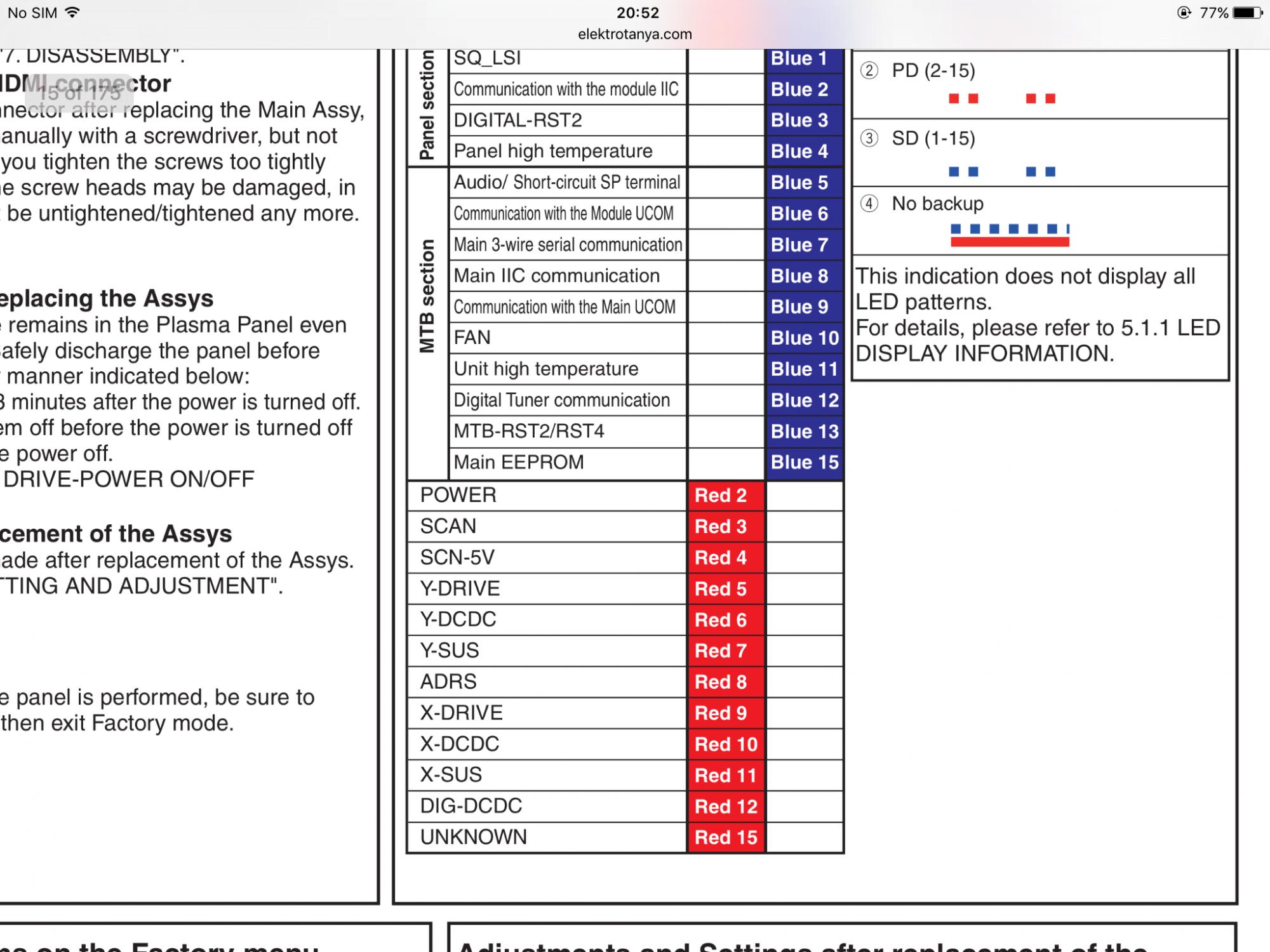

                      Re: Pioneer PDP-LX508D Won't turn on, 3 flashes from PSU
                      Not yet. Power supply is fully repaired and outputting the correct voltages on power up.
                      The new fets have not arrived yet.
                      There are 8x FKP300A fets that feed the scan pcb. 3 were fault so I removed those. Then, I swapped the remaining working ones so that I have 4 in a row on the the bottom to drive the bottom half of the panel.
                      On powerup I get 3 flashes from the red led. I suspect (HOPE) that it detects a SCAN fault because the top half fets are open circuit (removed as they are faulty)
                      On repairing cheaper tvs, i was always able to drive either top or bottom half of the screen without the tv tripping.
                      Just got to wait for the replacement fets to arrive.
                      On another note, I would have rather replaced the pcb as you suggested but can't find any for sale..
                        Fets arrive and installed.
                        TV powers up for 1/2 a second and display stuff in the top right corner then powers down and red led blinks 8 time.
                          Ohh dear that means there is a fault with the Y address Pcb aka Y buffer. Do any of the Ic's look physically blown apart ? Replacing them wont be easy as the buffers are bonded to the screen.
                            No shorts on the y buffer ICs.
                            However, there are 4 pcbs along the bottom and 4 along the top of the display with 8 way wired connectors going to each of them. All the voltages are there except the 5 volts on any of the boards.... the y main feeds the left 4 (2 top 2 bottom) and the z feeds the right 4 so there must be a common signal that kept the 5v shut off as all the voltages going in to the ymain and z sus are good.
                                cant find any blown fuses. Will look later on the bottom of the t-con when i get a bit deeper.
                                I made a bit of an assumption about the 5v feed to the 8 pcbs. Only on the bottom of the zsus does it say 5v which feeds the bottom 2 right pcbs. weird thing is, that 5v feeds (which always measures 0) are not commoned with any of the other assumed 5volts to the other 6 pcbs including the 2 bottom right pcbs. Its almost as if the label is wrong..
                                i.e the 2 bottom connects have the same labels which are identical and buzz out 1-1 except the 5v pin. Maybe they meant that pin is an address control line hence unique...
                                  Incidentally, the T-con does 8 flashes aswell (probably just mirrored onto the front red led. Strange I get a picture every time on power on for a split second.
                                    OK, forget what I said about the 5V silkscreen. I was right, its wrong! The repair manual says it is NC (strange they put the bloody wire in in all 8 connector looms as well!!! Grrrr)
                                    So, fuses or buffer ICs. Question, would the whole panel light up if any of the buffer ICs are blown?
