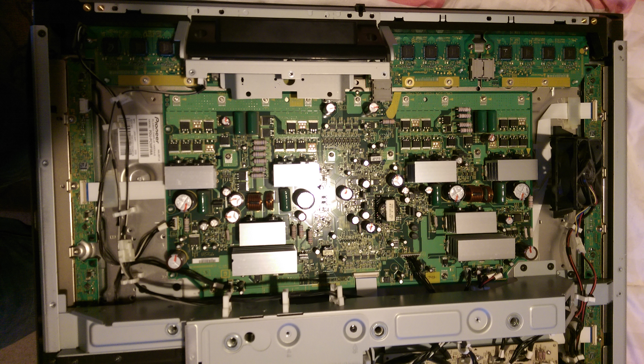

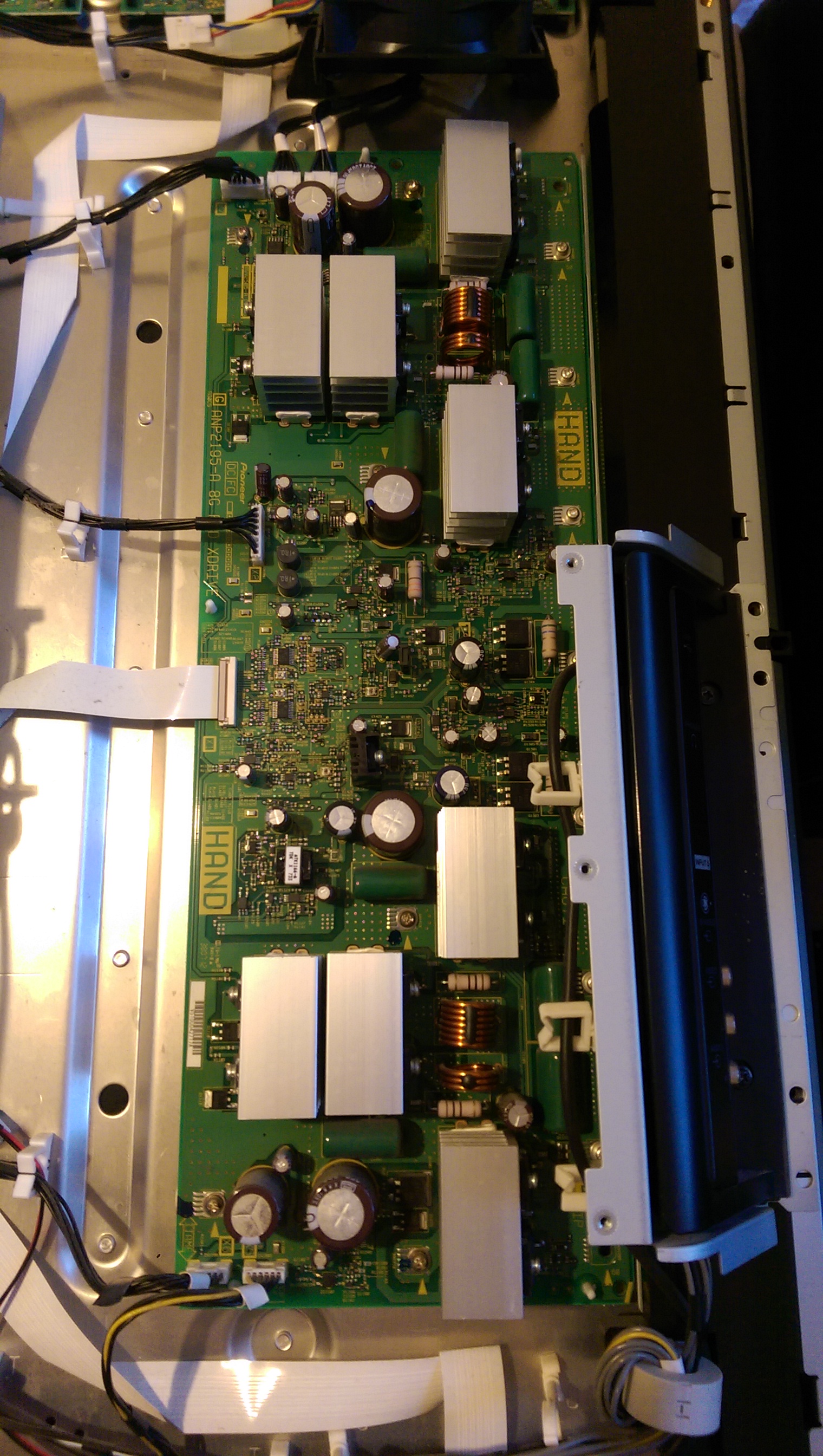

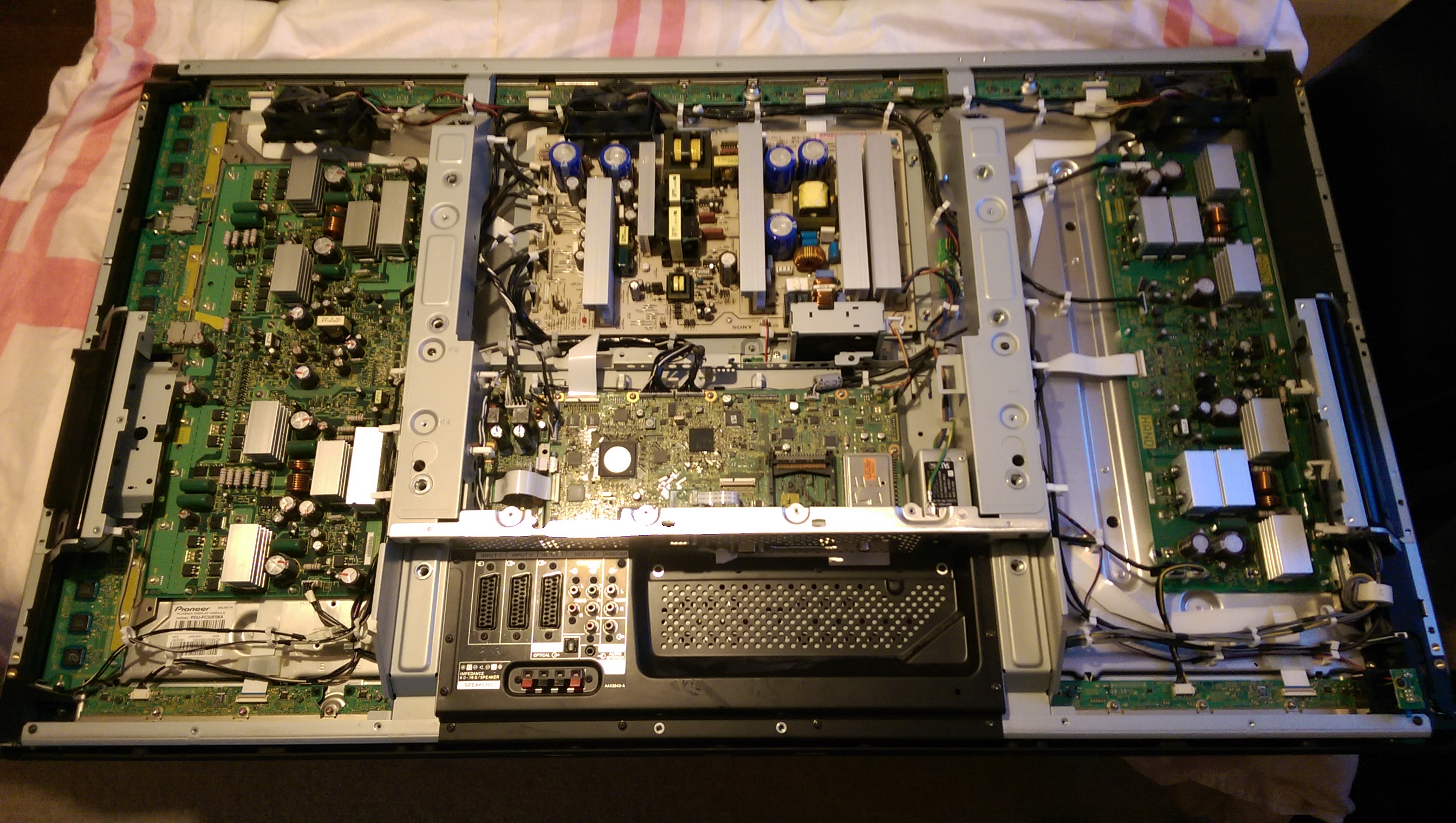

    Bought this in the hope of fixing would like some pointers.
    When i plug in mains chord I get 2 clicks from the relay. (sounds about right to me) When i try an get the tv out of standby, a relay clicks the i get 3 flashes from red led on PSU.
    |v'e done a visual inspection and can't find anything suspicious.
    There are some pen markings on some of the Ybuffer ICS??

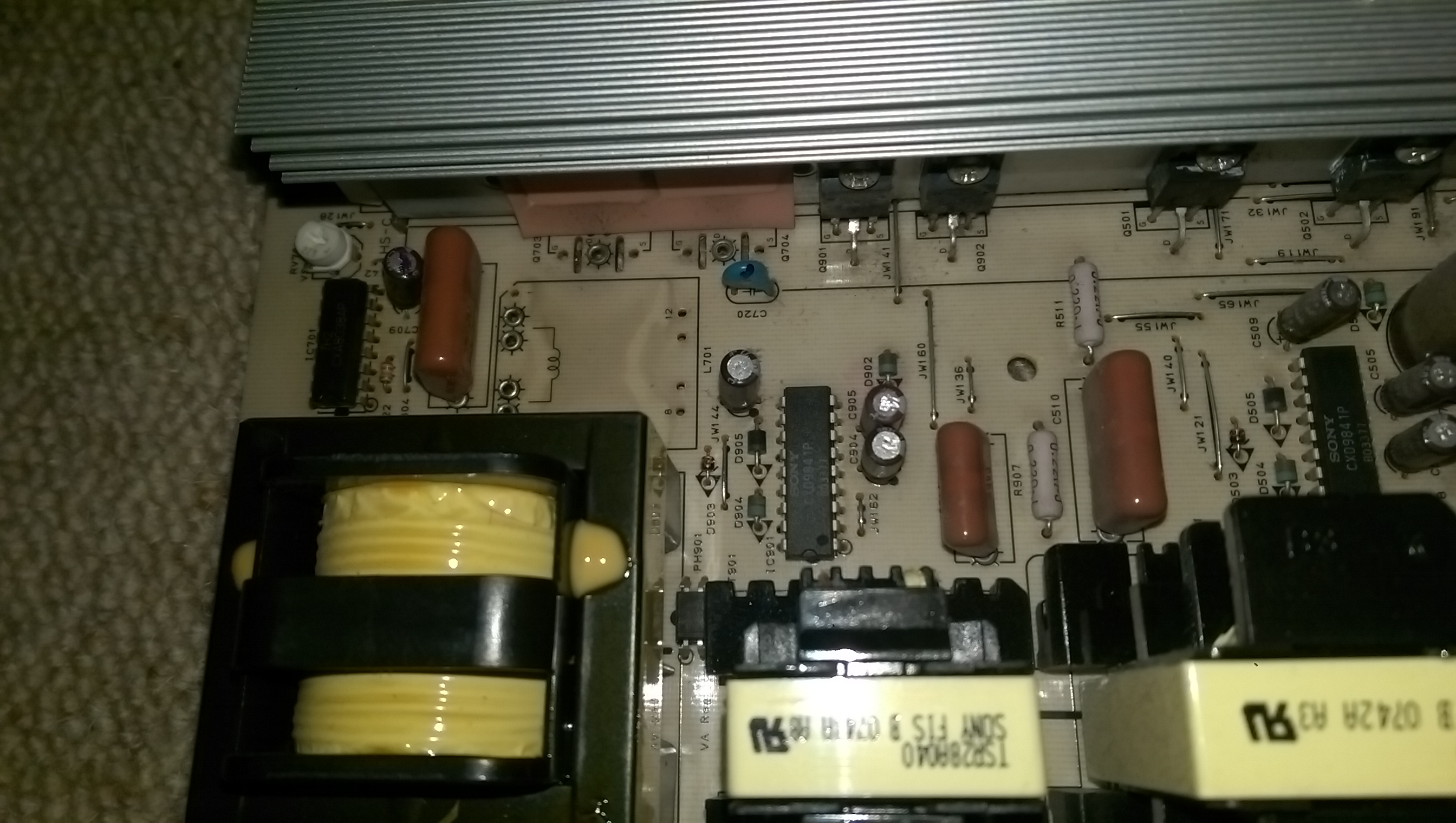

              Ok, got no VSUS even when isolated. PSU fault?
                Re: Pioneer PDP-LX508D Won't turn on, 3 flashes from PSU
                Seems likely
                • niblettr
                  • Jun 2015
                  • 98

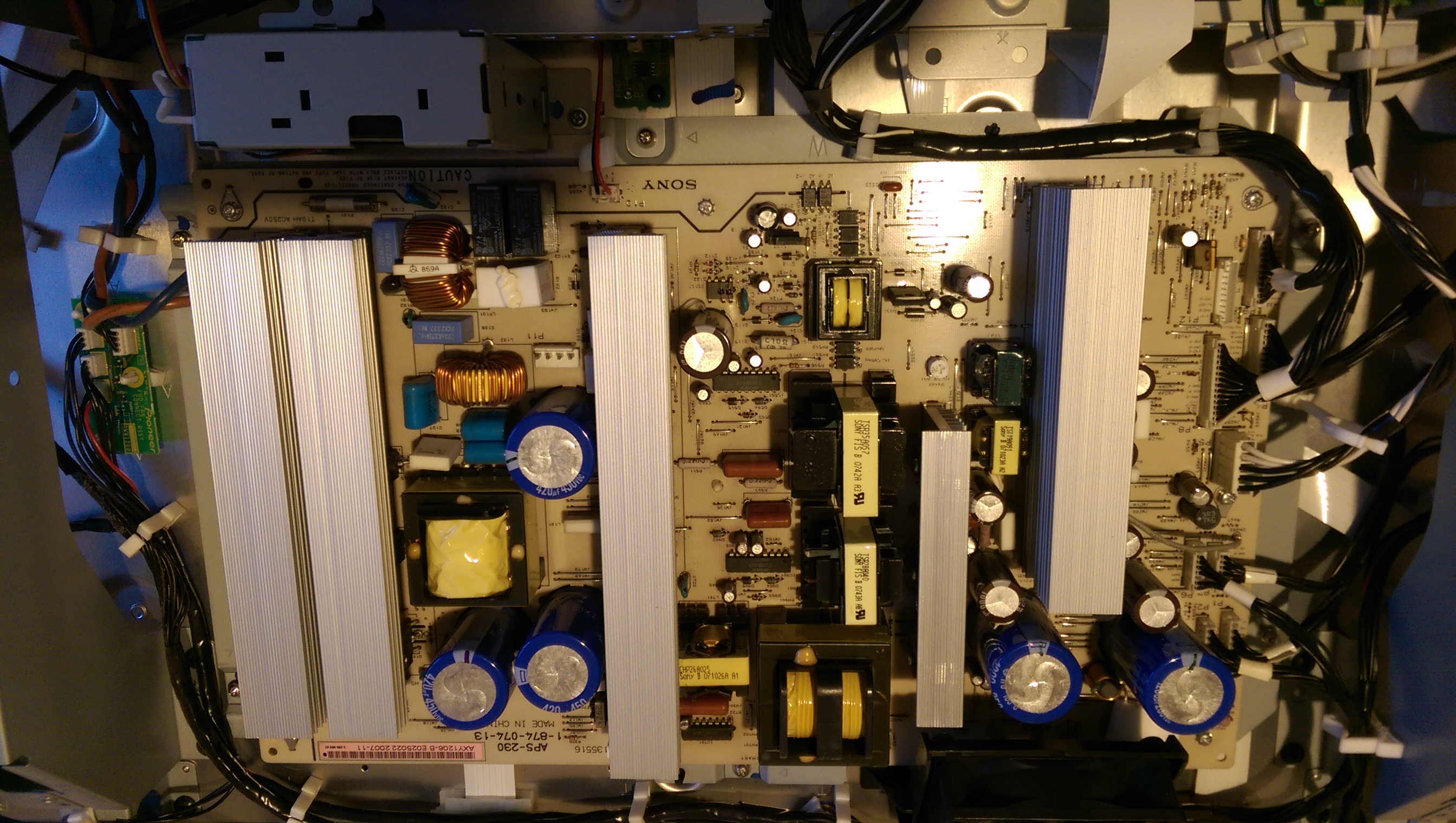

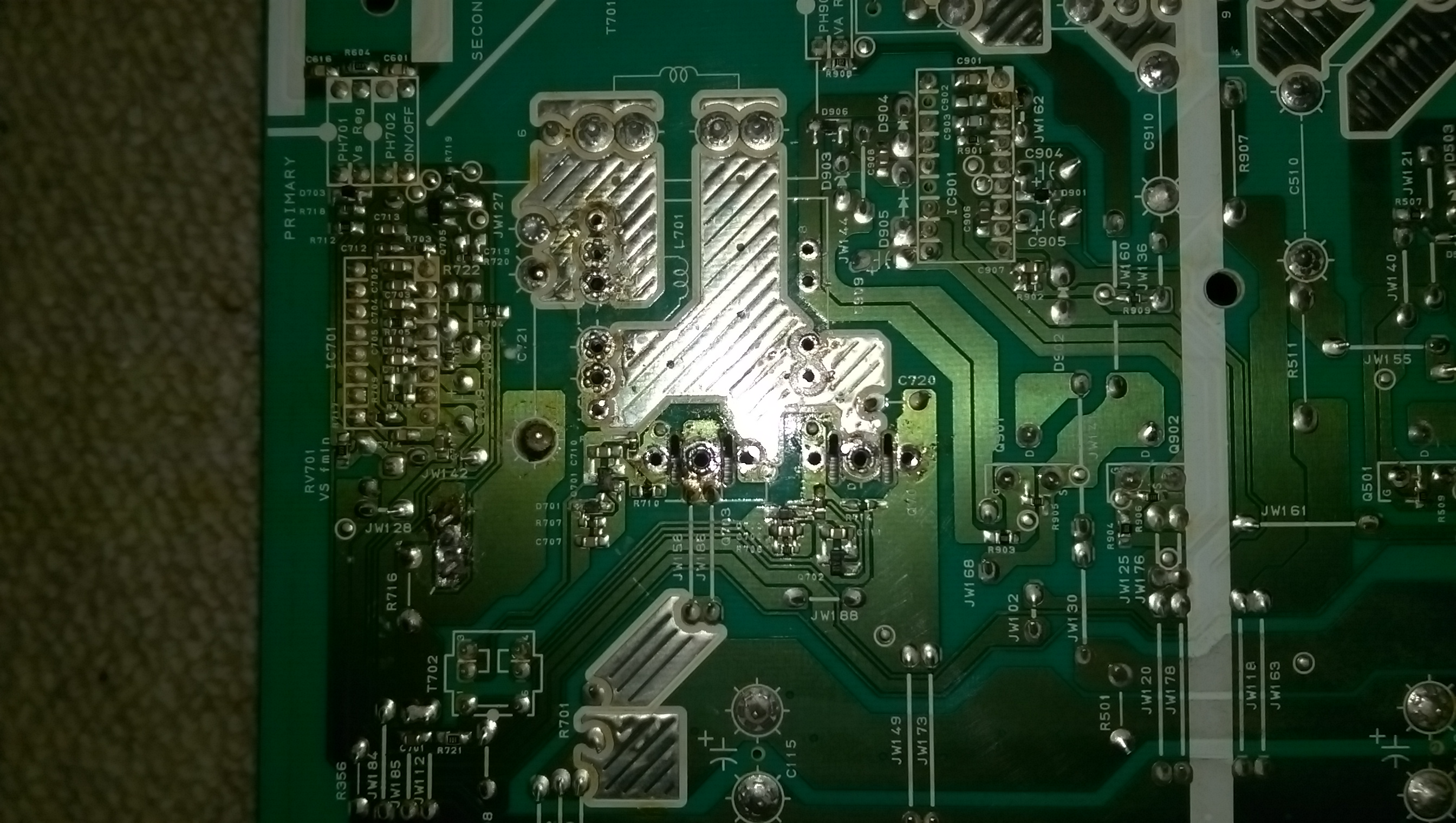

                  ok, found 2x K3314 FETS that are shorted on the middle heatsink on the PSU.
                  I've whipped them out and double checked and there are shorted. Ordered some new one.
                  Bit worried that something further upstream may be bust.
                  I checked some sot23 transitors that looks like may be driving these fets and they checked out ok but 2 diodes measured a bit odd. I got 0.6v drop in both directions....
                    You should replace the driver chip (connected to the FETs) and the fuse as well.

                      Probably just the fets quite common on Plasma supplies due to the way they are loaded at start up. Also replace the fuse and should be fine

                        You should know now that it is a bad idea to just replace the FETs! Also the startup loading isn't a big deal (just charging the caps, but there is a current limit for a reason.)

                          Alot of the time in my case the driver has almost never ever been damaged at all Tom. Normally if the Vcc and other input pins have no shorts or low resistance across them or to ground it will be ok. I personally have only had to replace 1in 10 drivers for the repairs like this.
                          It might come back and bit me on the ass but I will sort it.

                            What fuse?

                              note I also removed the transformer so that I could get to the screws holding the fets to the heatsink.

                                For me it's much higher - around 1 in 3 have shown suspect readings - although it does depend on the topology of the supply. Flyback and half bridge is more likely to damage the driver. Flyback due to high peak drain voltages, half bridge due to floating source node

                                  Thats true, I have been lucky so far but I always check them any way Tom I know what too look out for. I guess there is the cases of the controller becoming intermittent as I have had before but thats rare for SMPS tbh.

                                    Sorry guys, what fuse? Do you mean the sub ohms ceramic resistors?

                                        Normally for the Vs fets its in between the filter caps or behind the fets. It might be a ceramic style can fuse.
