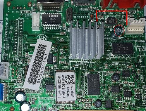

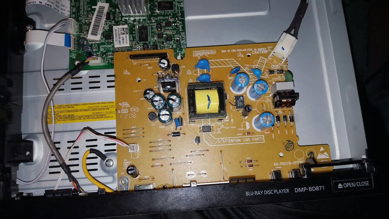

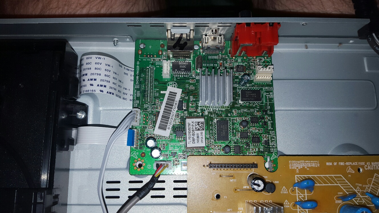

                            Re: Panasonic BluRay DMP-BD871 Freezes on hello display
                            Here are pics of both boards. If you need more or better ones I can get them
                            • Diah
                              • Feb 2013
                              • 6435
                              on photo No2, the caps look funny, and the area around like some one try to repair AV section. take close look on them.
                              try to download this update again and write it on new CD-R not other one like CD-RW. and the eeprom with label on the Photo, heat it while you play the CD,
