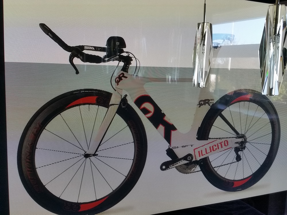

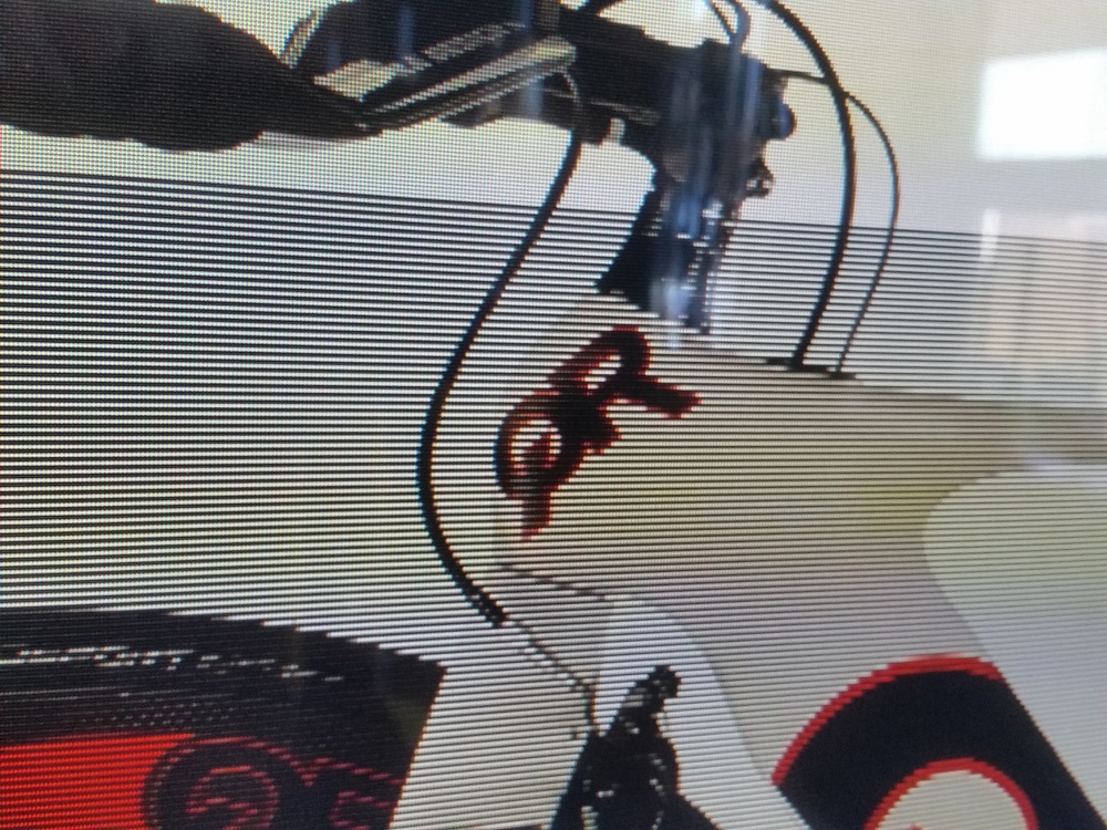

    My LG 50PS8000 Plasma are missing every second line on the lower 2/3 of the screen.
    All inputs and menu are affected
    The upper 1/3 of the screen is perfect, but he lower 2/3 are missing half the lines. One line good, next line black

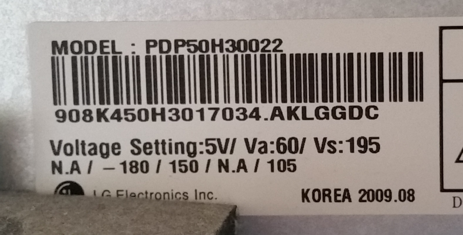

    Va and Vs is ok
    Sound ok, menu ok, all input does work
    Tried to disconnect and reconnect all flex cables - did not help.

        Looks like a bad scan driver (buffer board), if one output of a buffer IC fails you could get this pattern. I would suggest replacing the upper buffer.
