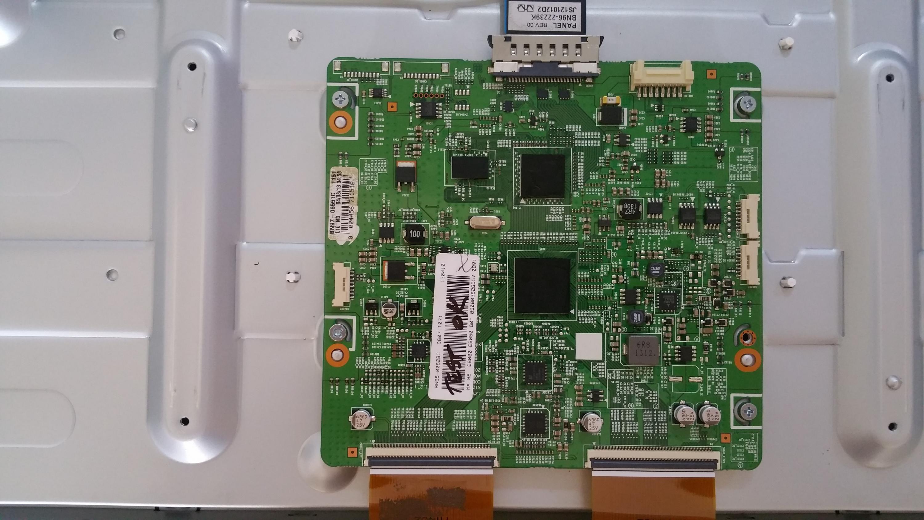

    This TV came with backlight but no image, after replace the T-Con board, TV is showing image but after 2 min more or less, image is gone (see the video).
    T-Con replaced again, same . Firmware updated, same. main board replaced, same. cables cleaned and reseated, same.
    I have 2 TV with the same problem.

    it seam the T-CON fail again.
    try to connect just one side of ribbon cable and give order menu via RC

      Looks like a bad panel. Most of the time when you get a shadow like that it will be a bad panel. It is possible that somehow the failure of the panel could have taken out the original T-con board. Try twisting the tv in the same way as if you were to ring out a small towel. Obviously do this softly to not damage the set further, but if that causes your issue to go away, you have a bad tab bonding.

          Panel fault not fixable, do not bother spending a penny on it.

                BN95-00628C T-Con usually fixes this one.
