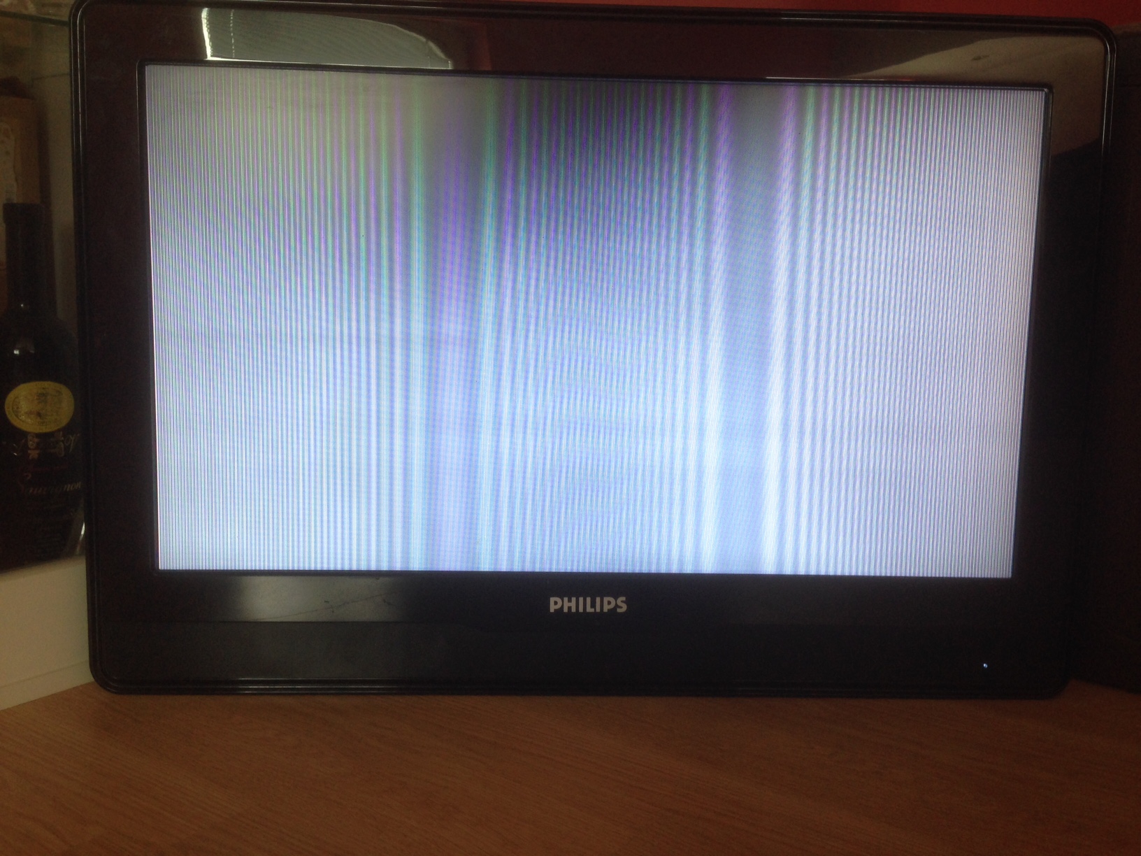

    i have this TV PHILIPS 26 PFL3403/10 and after a time when is turned off or unpluged i have some problem. When i power it on shows a slowly changing pattern of coloured vertical lines for about 10 minutes before the TV image appears. Than work perfect.
    I opened it to check if there are any blown caps, but they looks okey, i think. Any ideas how to remove that, because it is annoying to wait sometimes 10 min to tv turn on.

    take photo to the power supply, its bad capacitor at the line to provide the main board with VDC

        its not Voltage, he will find the 12 Volts, but this 12 V hat less currents where it should be 4A

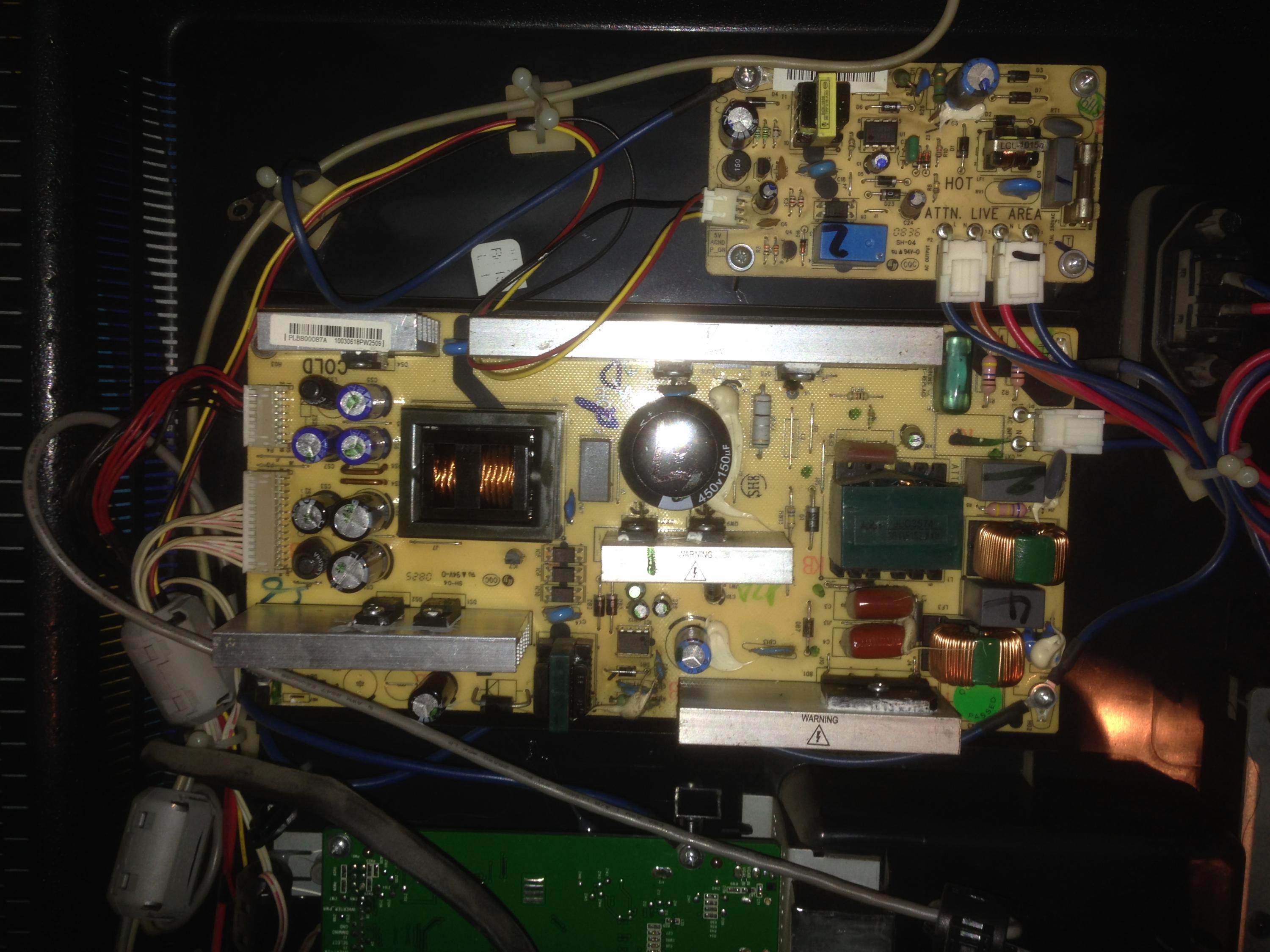

            Check your 24V/6A, 12V/4A supplies and see if one of them is low and rising while warming up.

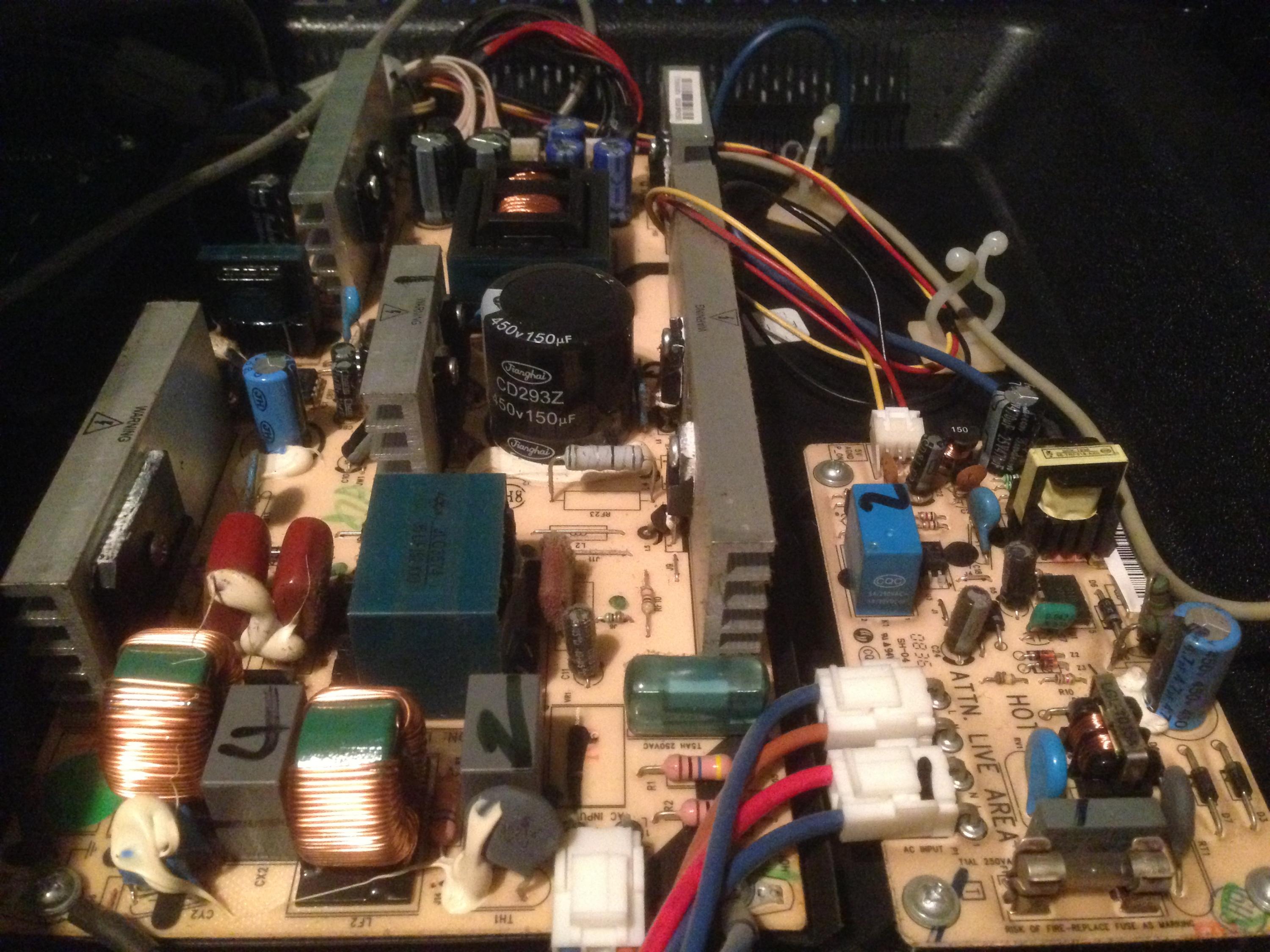

              Here is the pics of supply board and caps, this tv is so not so easy to open like other where yuo just take down back cover :P

                change all caps near the white socket photo 1

                  Re: PHILIPS 26 PFL3403/10 slow start up
                  3x blue and 3x black ?
                    black you have 4 pieces

                      Guys please ! This is a panel fault, what screen is used ? Guessing a V260B1 from Cmo ?

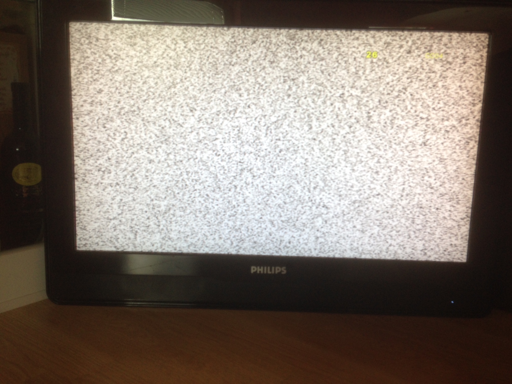

                              No it not panel fault, i place tv on stand and plug it in then need 10 min to scow picture, than can i turn on and off how many imes i want and it work, but if i plug the cable out and leave one time and than plug in back then need again 10 minutes to turn on

                                So then its a panel fault, panel fault can take ages to get working then it will work fine. But fine if you dont want to listen go ahead and waste your time checking voltages.

                                    the 12 Volts should have 4A, any less than this value it will be delay to start.. and make noise at picture. wasting time and spend penny on caps better than starting with panel which it may broken at any little human mistake.
