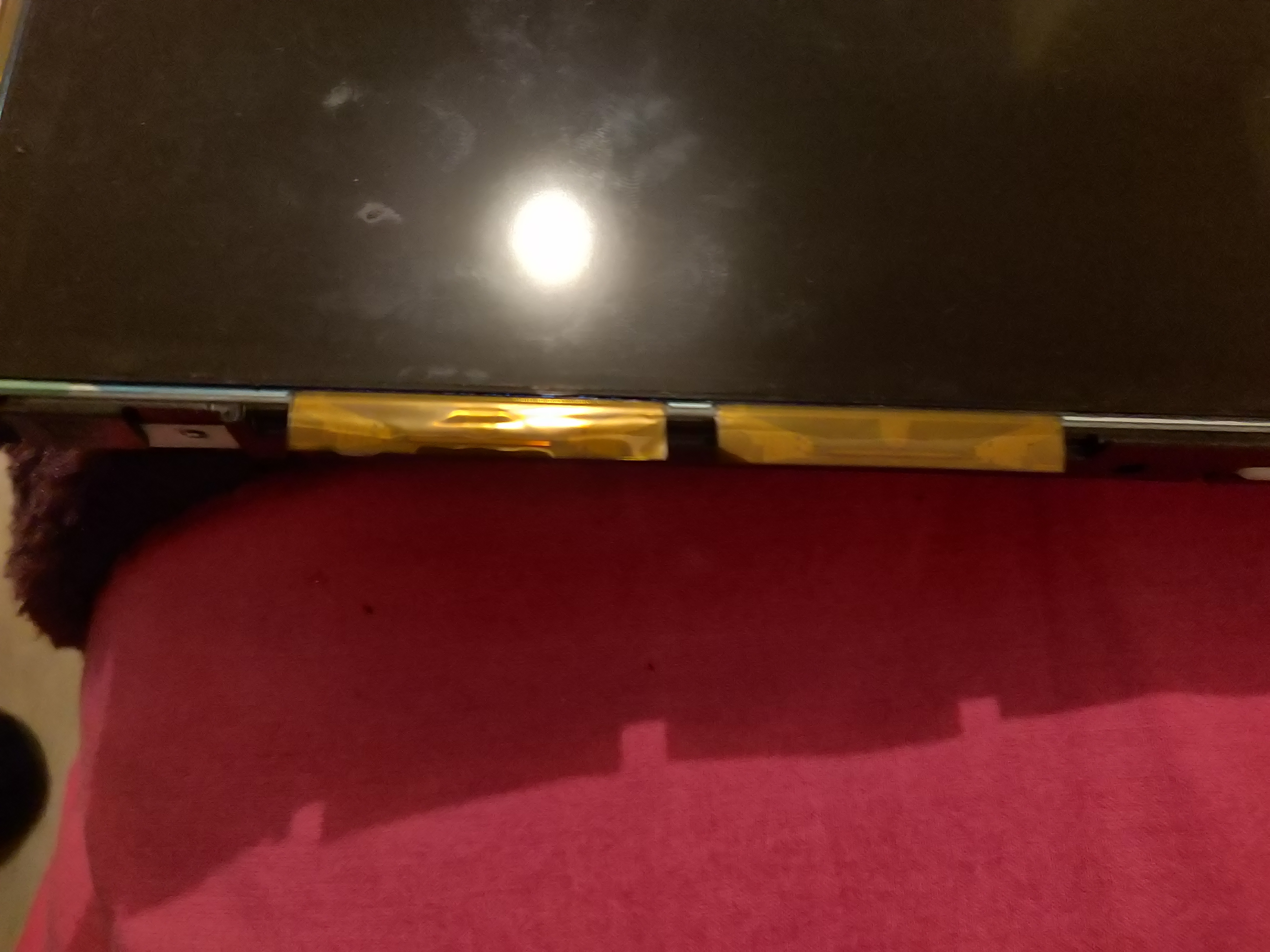

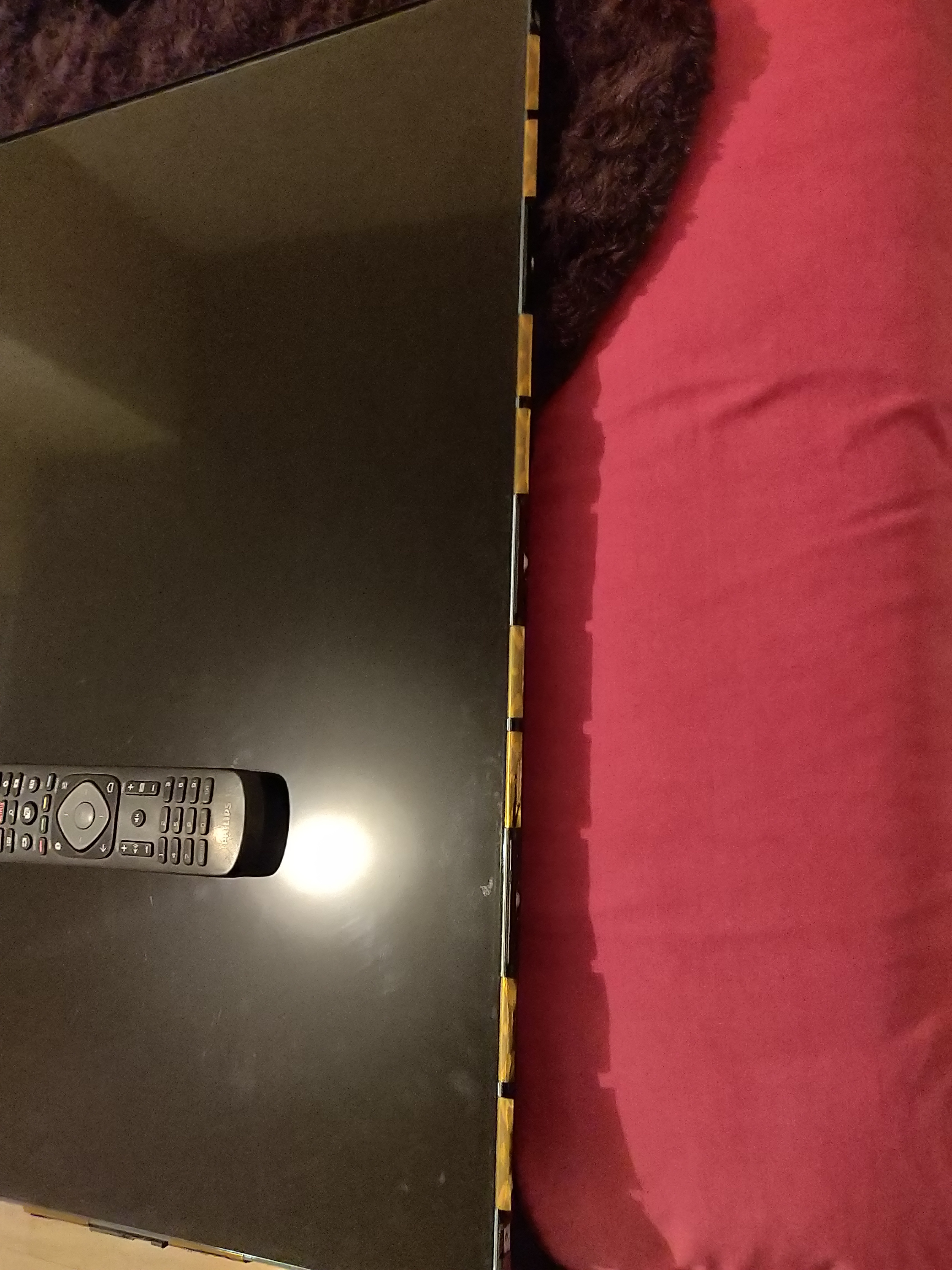

                    • Cornito
                      • Jan 2024
                      • 93
                      • France
                      Hello Biruslapio.
                      Here are the pictures.
                      4 double cof I would say.
                      • Biruslapio
                        • Nov 2013
                        • 552
                        • Brasil
                        Yes, this is correct, peel those that are from the dark side(on the first photo, right side facing front).

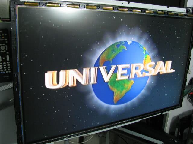

                                The problem is in the matrix, there is nothing to lose here, removing the β€œears” from the dark side can restore the picture, here is an example on a Philips 37PFL7662D.
                                If there is edge lighting, then you also need to check it first.

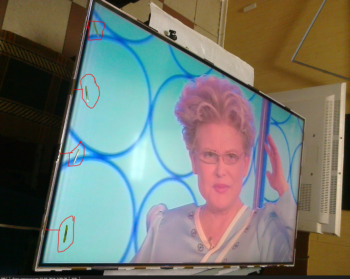

                                    I know that they are not for beauty, is it better to buy a new panel?...
                                    The main thing here is that the side β€œears” (cofs) are on both sides (if only on one side, then this trick will not work) and the main thing is to remove them from the non-working side, if you mix them up in a hurry, then the panel is thrown into the trash.
